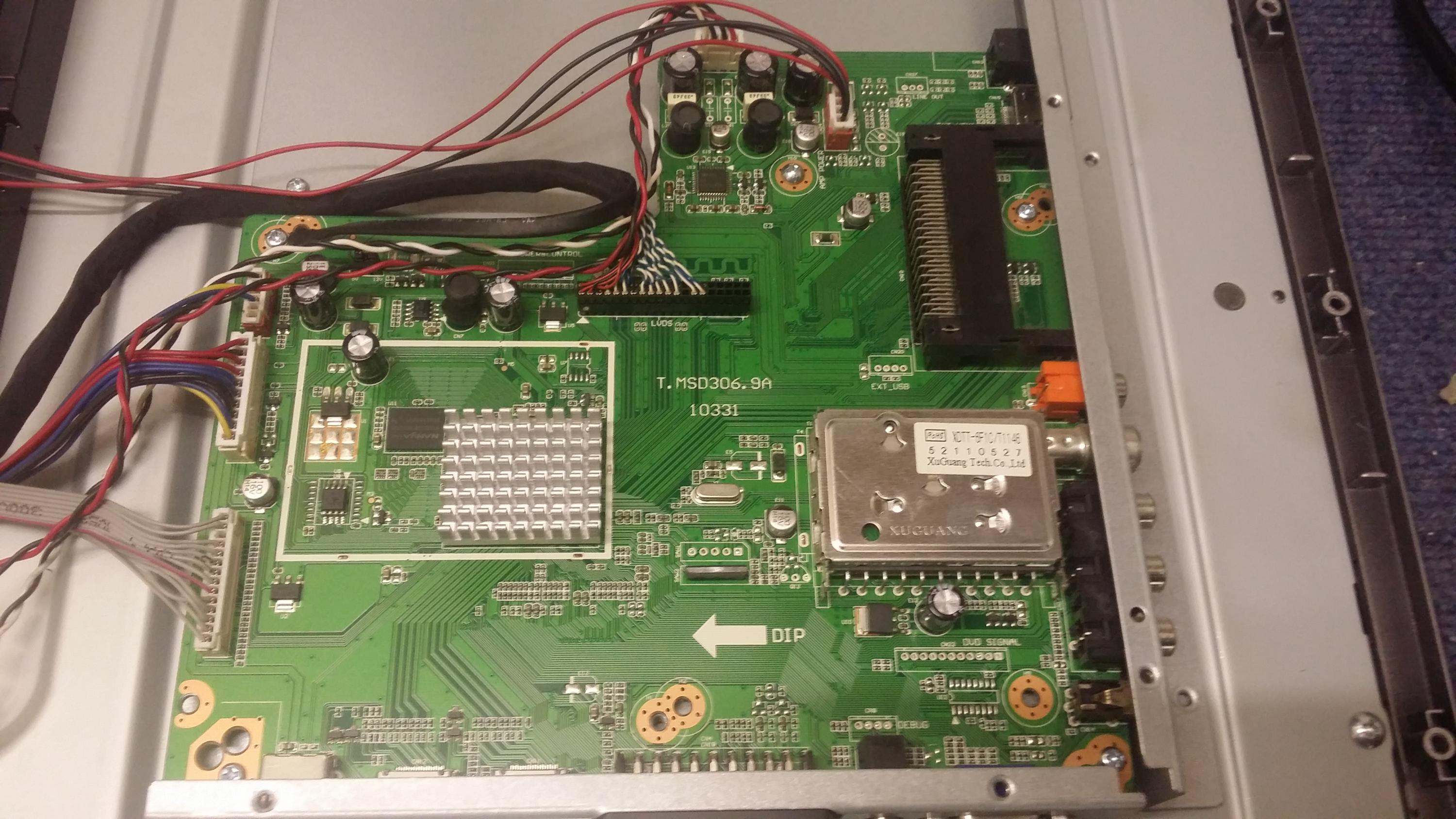

            Does it use the main board T.MSD306.9A ?
            could be the eeprom

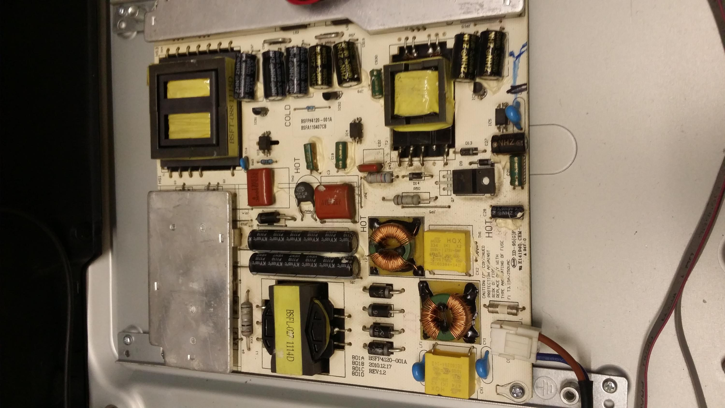

                Re: Baird TE-40LED AL no standby light
                I can't find a make of the psu looks like vestel one that I've seen before. I've added a picture of the psu and the main av board too
                  model bsfp4120-001a
                    On the power board have you checked the diodes
                    And resistors
                    Also check the big caps to see if they have any residual voltage before proceeding to check the components..
                      The big resistor at the top of the psu I can't seem to get a reading from. Would this cause the fault? I wasn't sure how to read this resistor, the green band at the end kept throwing me off, but the only way I could make sense of it was to ignore the green band and it would make it a 0.1ohm resistor? it does measure at 0.3ohm but I'm not sure I've tested it correctly.
                      All the diodes appear fine.
                                The buttons were fine, it turned out to be the PSU which I found strange because even though there wasn't enough power to fire up the tv, the 5v was there and surely that would have been enough to turn on an led?
                                Confusing, oh well it's good to go now anyway.
                                        Hi, and thanks for the reply. I just fixed the psu, I only had 4.5v that was the only reading from the power supply.
                                        The fix is very simple in my case, cold solder around the big transformer.
