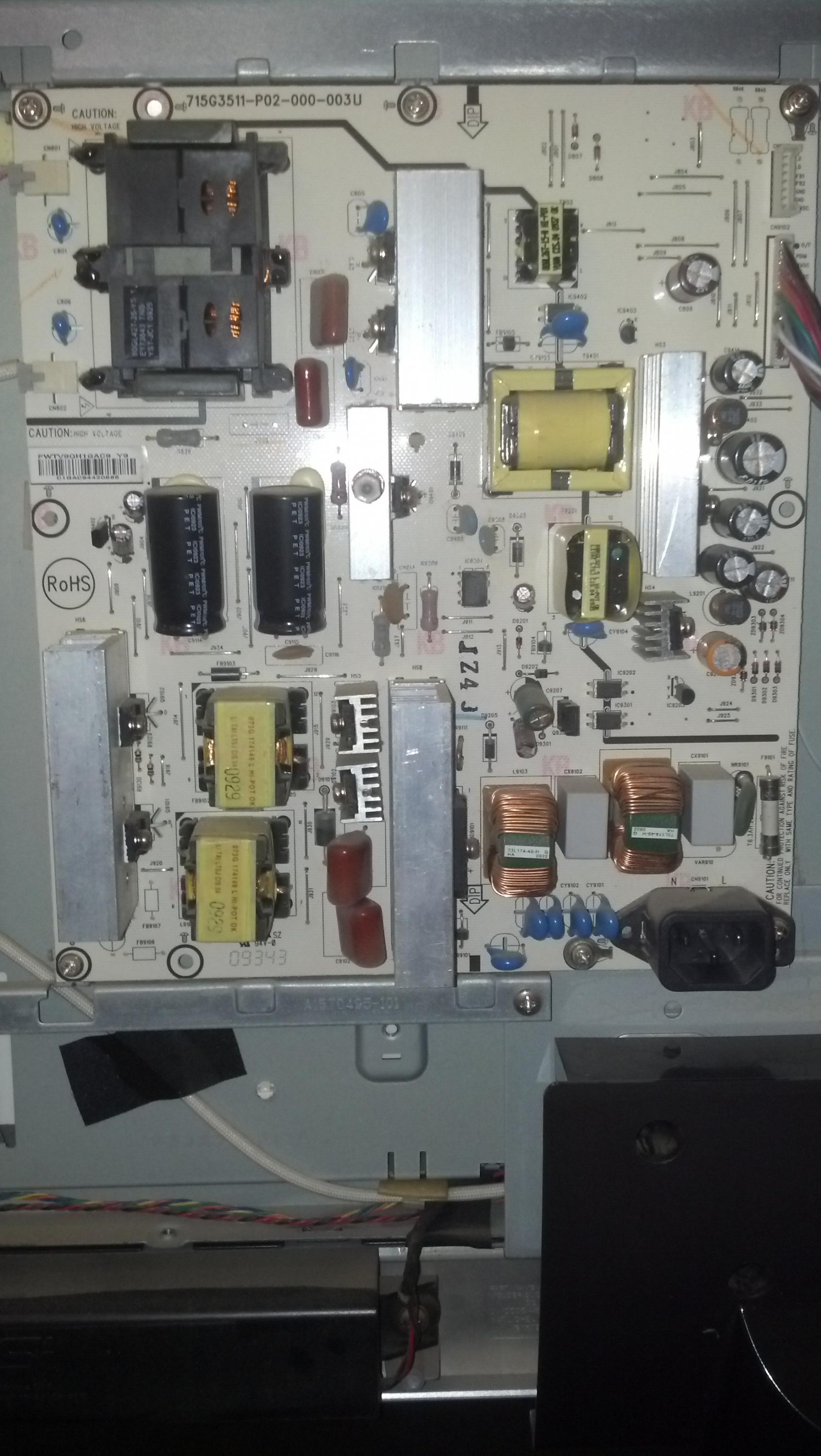

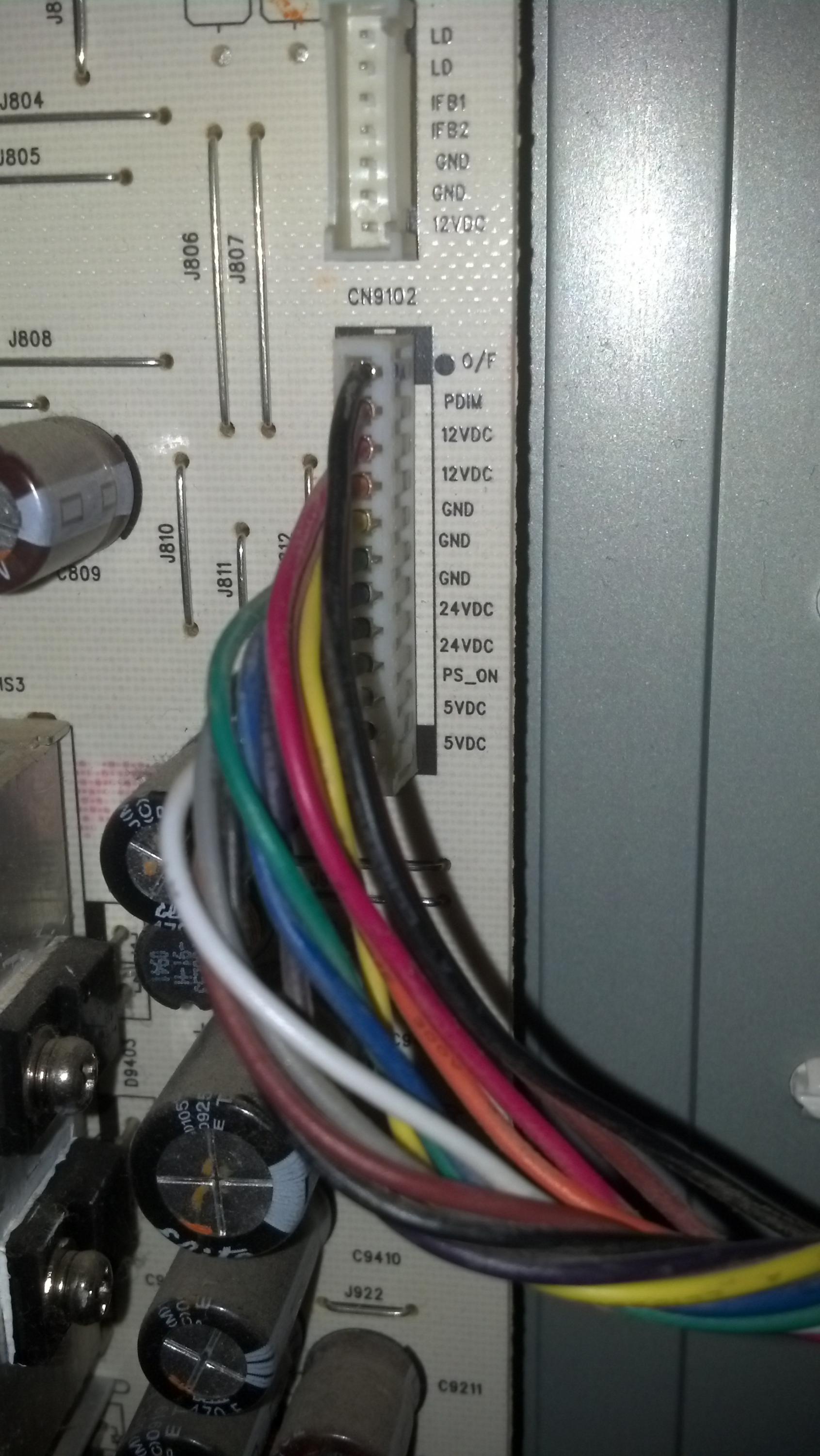

    I have a Vizio VT420M that has the orange vizio light when turned on and no backlight. Here are the voltages reading on the power supply/main board connector CN9102.
    OFF:
    o/f-.001
    PDIM-.000
    12vdc-.072
    12vdc-.072
    GND-0
    GND-0
    GND-0
    24vdc-.006
    24vdc-.006
    PS_ON-0
    5vdc-5.14
    5vdc-5.14
    ON
    o/f-.095
    PDIM-3.641
    12vdc-11.43
    12vdc-11.43
    GND-0
    GND-0
    GND-0
    24vdc-23.30
    24vdc-23.30
    PS_ON-4.99
    5vdc-5.12
    5vdc-5.12

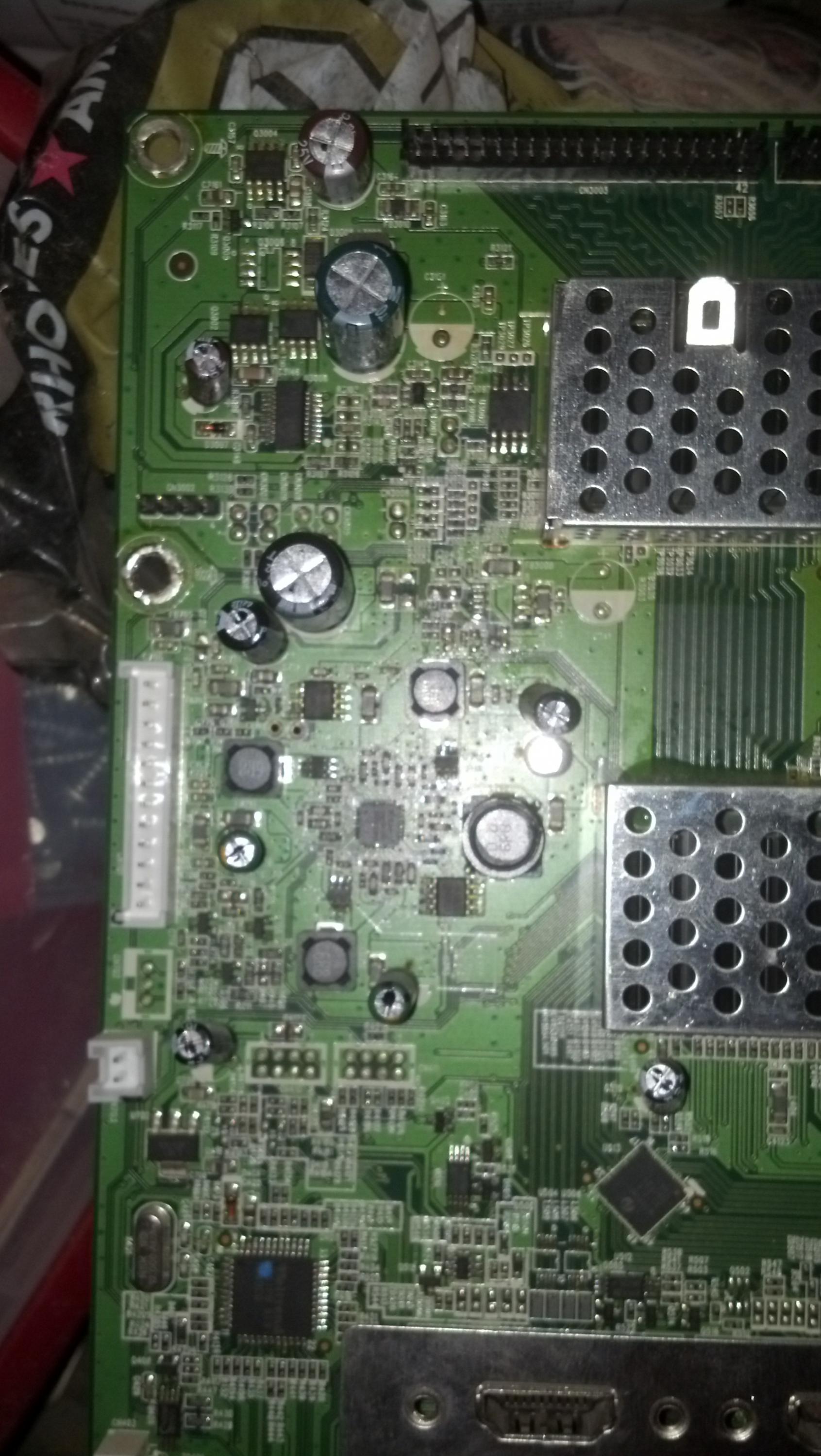

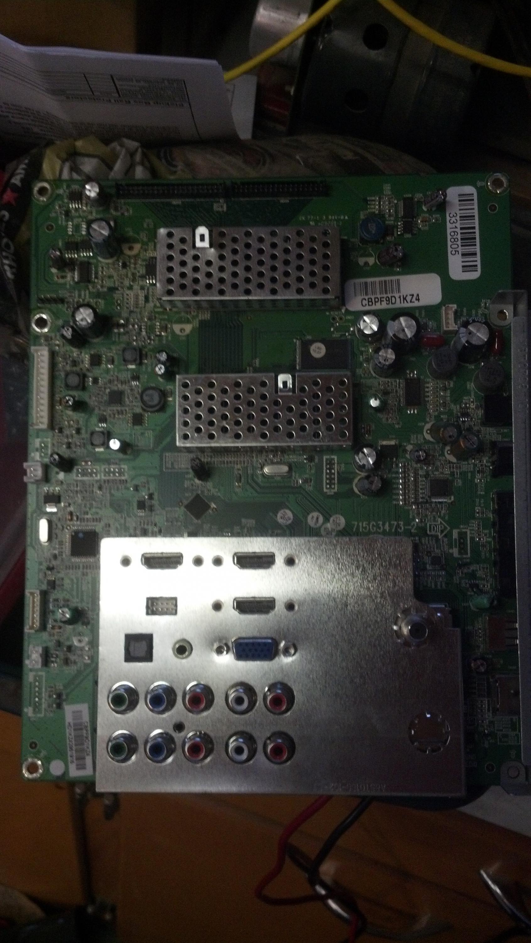

    I have tried to short the 5v line to the o/f pin with the main board pin disconnected with a 1k resistor and no luck getting the back light to turn on. The o/f pin end of the resistor shows 1.44vdc with it connected to the o/f pin and disconnected shows just under 5vdc. almost like something is drawing it down. Anyone have any suggestions of what to try? I am leading to the main board but am open to ideas. Thanks in advance.
    Re: Vizio VT420M No Back Light

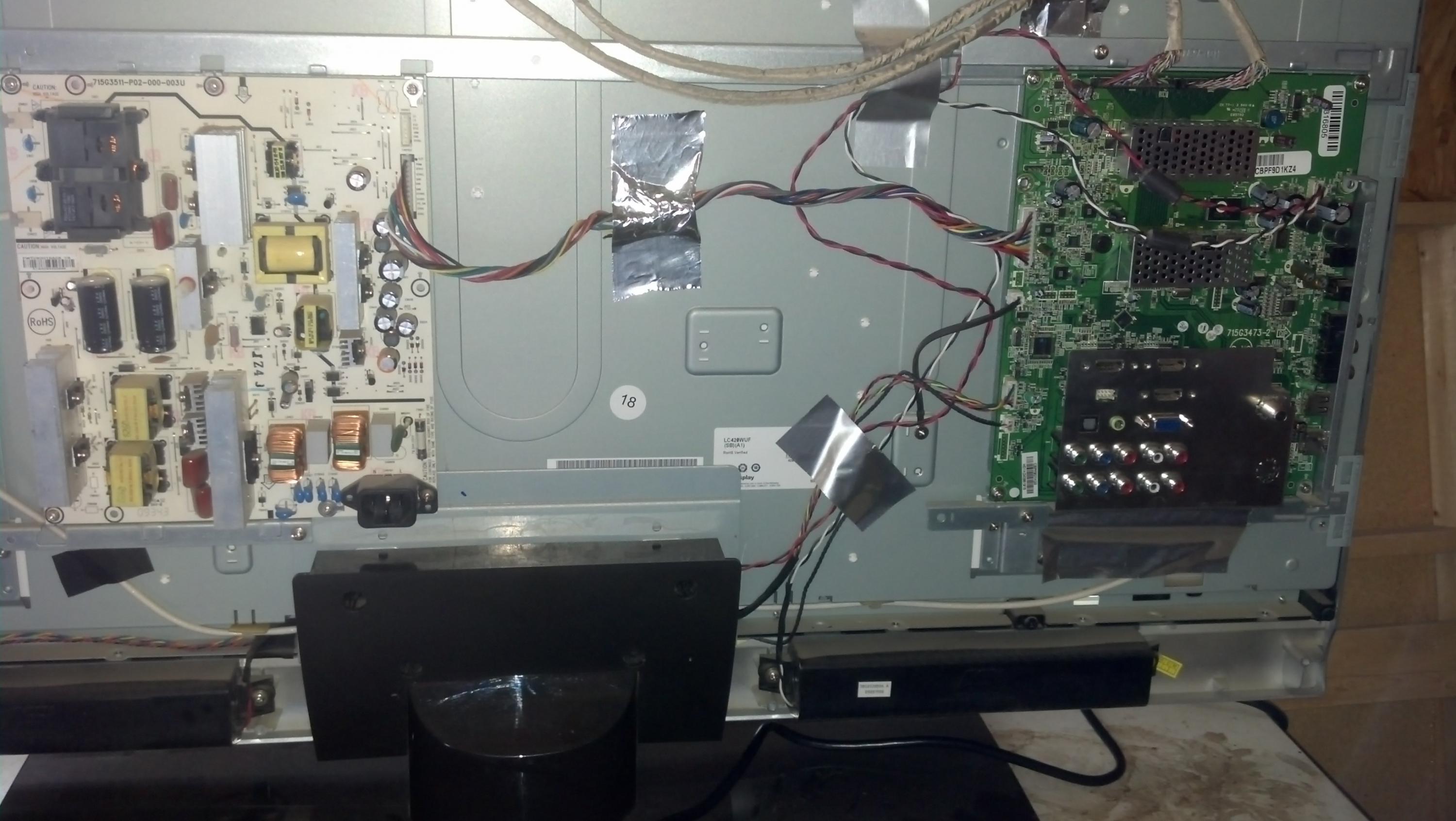

    How about the pictures of the whole back side of the TV to see how all the boards are connected together?
    • budro
      • Mar 2012
      • 17
      Pic of the back
