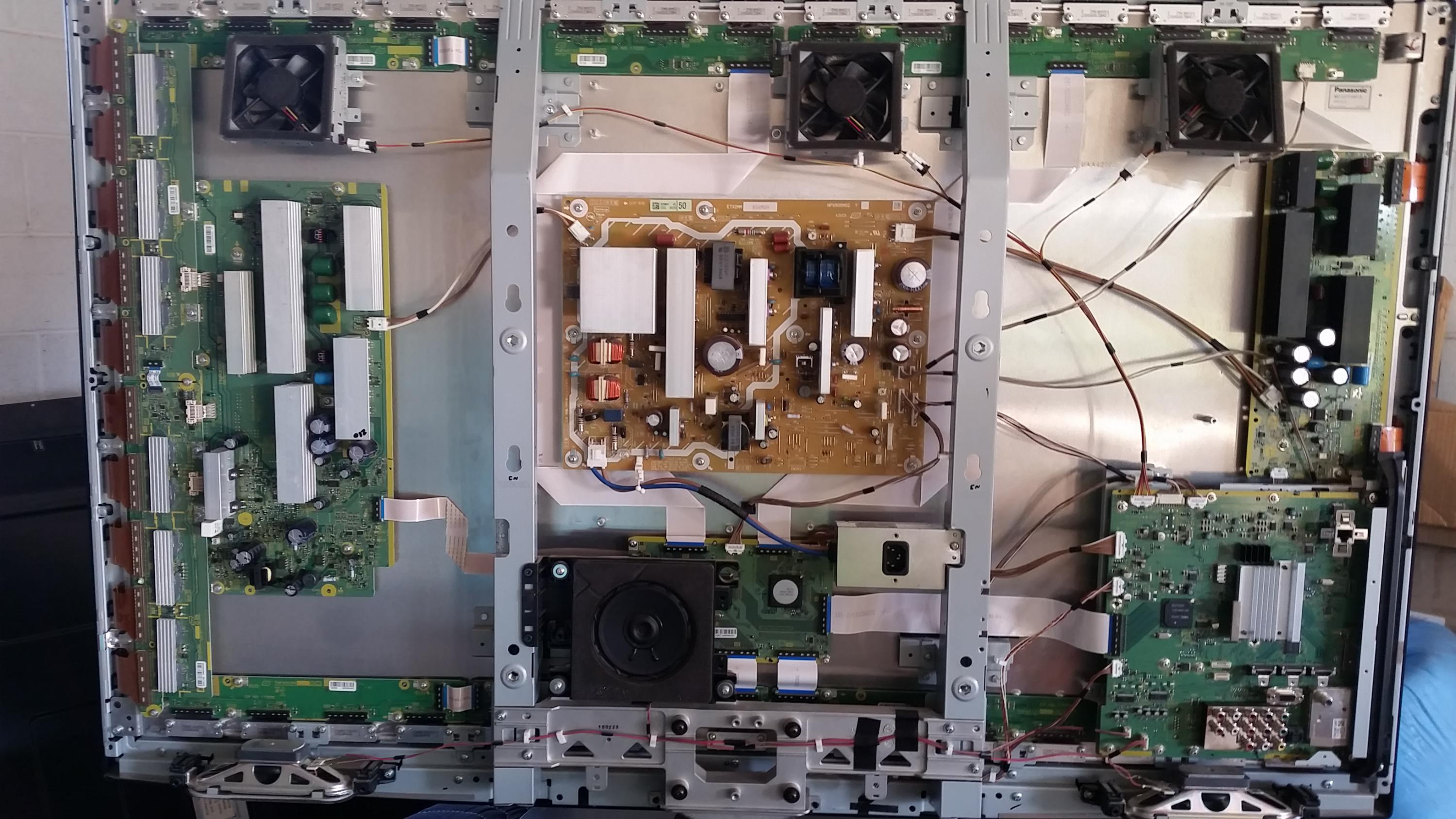

    I can hear relay clicking upon power up of set. Immediately gives ten blink code on LED. If I hold power button blinks stop. Any ideas where to find a service manual?

    yeah, but first get you a meter and check across Sc2 pins and see if shorted on Sc board, if not short check on SC , Q661 RJP63F3A IGBT ( heatsink with 2 transistors bottom left corner as mounted in TV)and see if that's short, check IC521 for evidence of burn or hole in top, check IC771 resistance centre pin to output side resistance

        SC2 pins show 1.8M ohms, not shorted. Q661 is good, however, it's twin Q660 is shorted to ground. Visual inspection of IC521 revealed no evidence of burn or hole. Could not find IC771 for the life of me..looked with lit magnifier for 30 minutes. Also found D422 shorted as well as D641 and D642.
        Checked SD card slot for any metallic objects and found none.
        That is called out in this troubleshooting guide I found as a possibility when ten blinks are evident.
        Also, there is no LED lit on SC board during initial startup or afterwards. Also no LED lit on SS board.

          yeah, ok . mixed bag of results there. could be on the wrong track, I'm assuming potential Sc failure but no LED lit and 1.8meg on Sc2 is not what I would expect so could be genuine 10 blink elsewhere.meaning SC is ok, difinitely not shorted . Suggests the vsus is not being turned on at all.
          With q660 etc, we're just checking across the 3legs to see if short. If you've gone ground to each 3 on Q660 then 1 leg is grounded so will indicate short to gnd. I have a good one here and i get a short to gnd on 1 leg.
          With the TO220 package diodes 2 legs are Anode, 1 K cathode so A-A will be short, you'd have to confirm how you're doing it.
          probably would not bother with IC771 now,
          disconnect Sc2, Sc20, ss11, backprobe p2 or p11 for vsus as it starts up. If no voltage then we'd have to follow the 10 blink flow charts.

            If relays click then immediately 10 blink could be A board sub voltages. I'd follow the 10 blink guide in that trainer.
            After Power SW ON,F_STB 15V outputs at P6’s pin 9, 15V outputs at P6’s pin 1 before Shutdown?
            If the above is true suggests A-board.
            i have a feeling if the D board is isolated from the A, it too can trigger panel on. I'd have to see if that's been tried in another VT post .

              Q660 all three legs shorted to ground. Previous owner says that he replaced A Board and SMPS with no change so he returned the boards and reinstalled originals. His wife made him replace tv..hehe

                      I have Vsus of 208 volts going to both SC and SS unplugged from both boards.
                      P6 pin 1 I have 15.9volts..PIN 9 I get 0volts. if I plug in SC and SS 0 volts at Sc2

                        When I unplug harness from A board, I have 15.9 v leaving pin9 of P board. This would sugest that the A board is drawing the voltage down.

                          I also have 15.9 volts on pin 7 of P6. Looking more like A board. Your thoughts?

                            have to think but this is somewhat interesting. Would suggest vsus is being shorted. measure resistance across SS pins at SS11 pin 1 - pin 3 (Vsus), might as well measure pin 3-pin 4 15V.
                            I don't think we should jump for the A board yet

                              leave harness off and check resistance on A6, pin 6,7 or 8 - gnd.
                              i think I need to brush up on the f15V section though, I'm more curious about vsus at this stage.

                                out of curiosity, when you fired it up with sc2,ss1,sc20 removed, what blink code did it shutdown with?
                                I know reading your original 10 blink at plugin implies F15v or related short on sub 9v or sub 5v but the no vsus with ss/sc then reappearance with those isolated suggests something wrong there too
