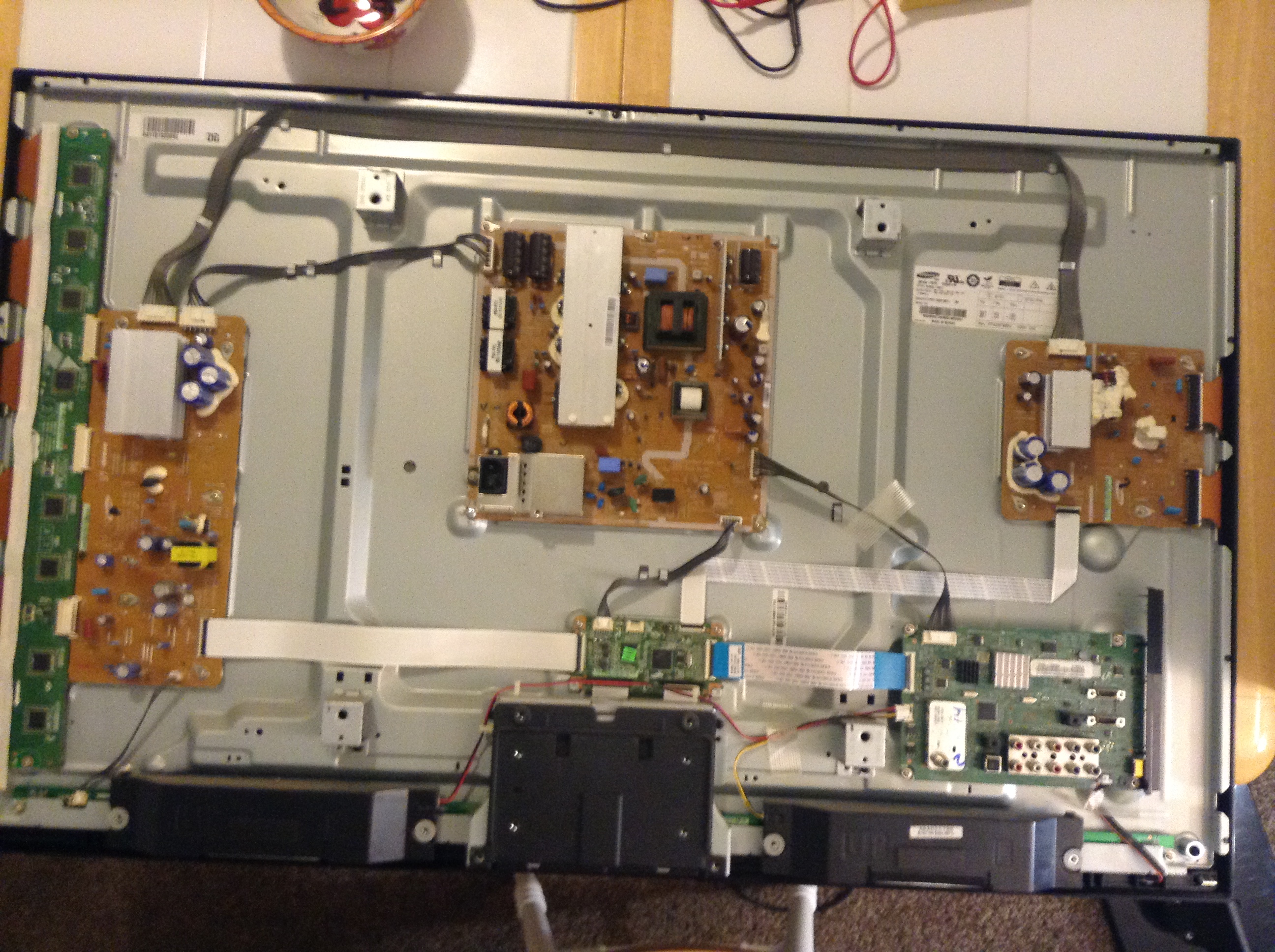

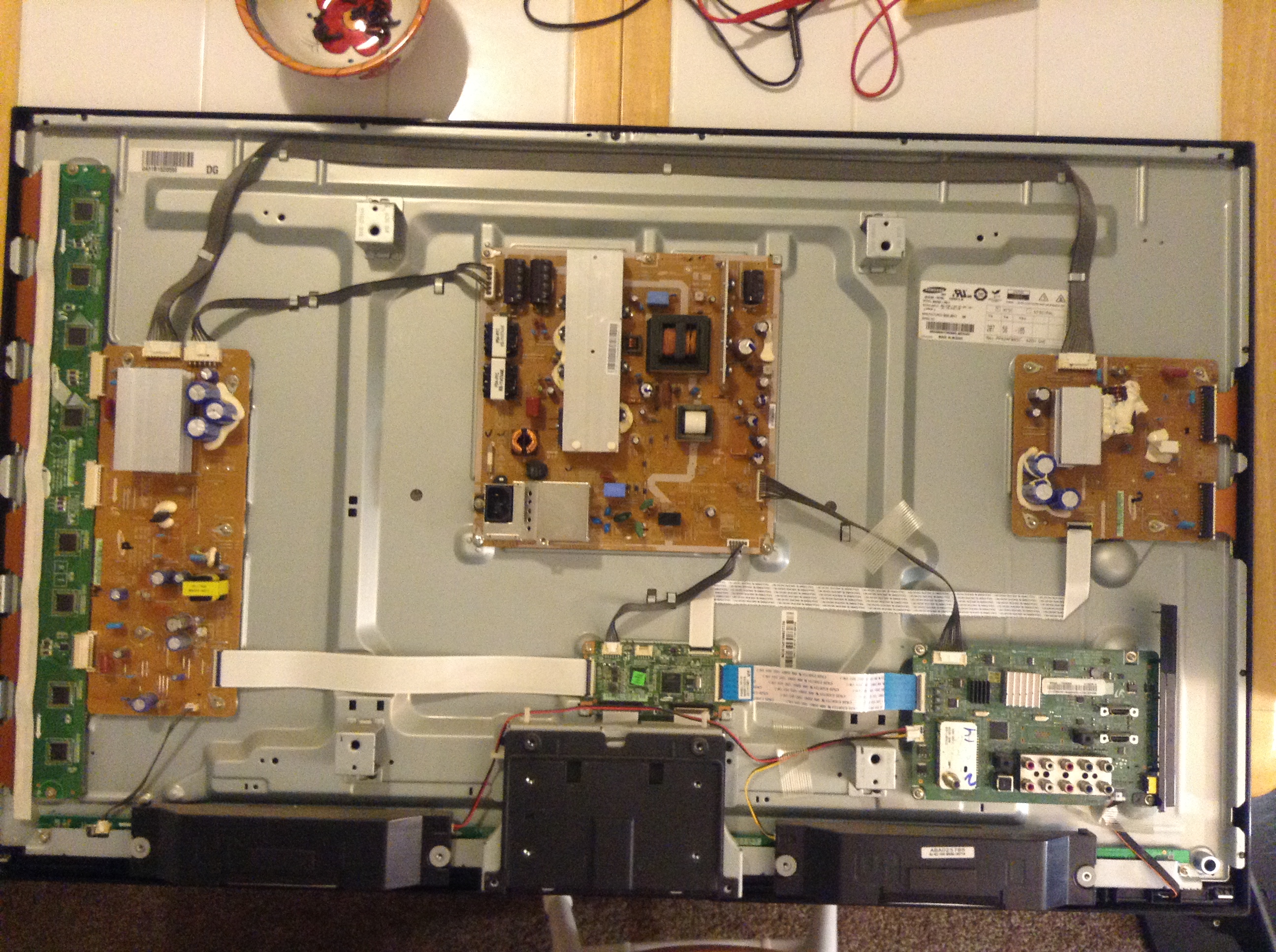

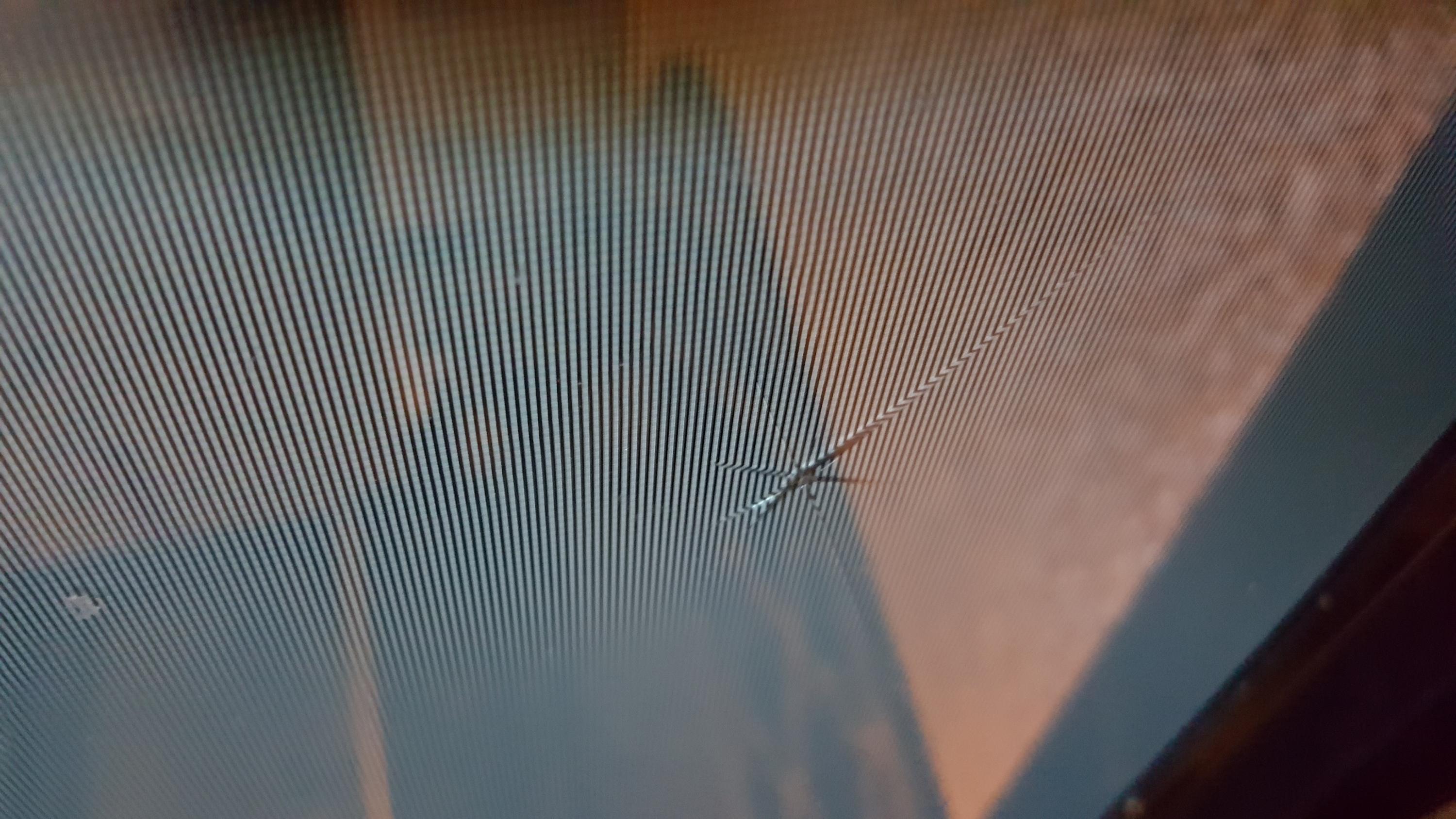

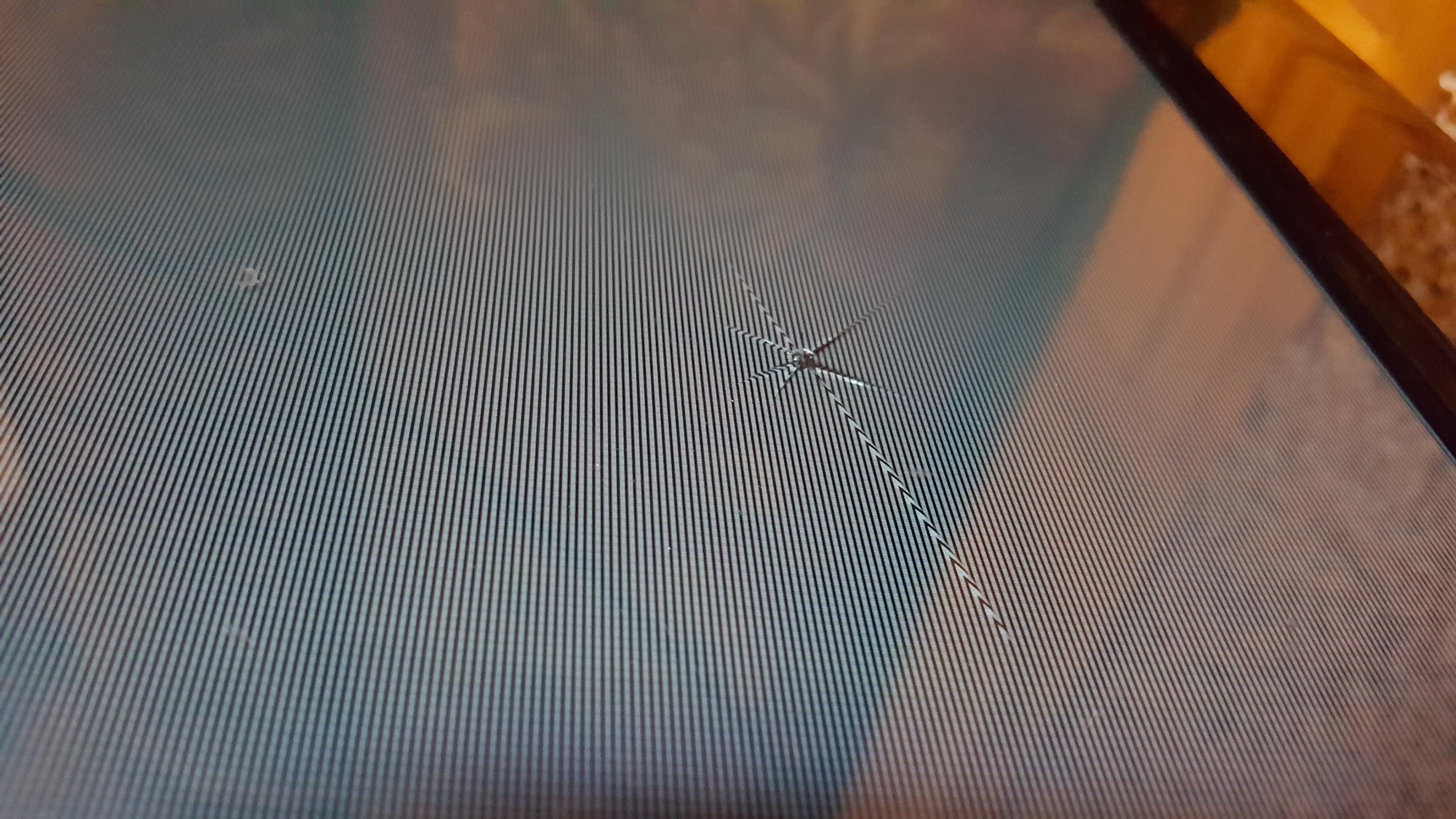

    I recently purchased a used Samsung Plasma 42” TV (PN43D450A2DXZA) from a friend and, in attempting to transport it in my car, seem to have broken it. the only physical damage is a small crack in the screen, but, when turned on, no picture appears. While I know very little about repairing electronics, I would really love to learn a thing or two and (just maybe) fix my TV in the process so I greatly appreciate your interest and patience in helping me with this project! Here's what I have so far:
    When the TV is plugged in and turned on, the red power light blinks 5 times and then goes off. No picture is displayed, but all of the normal sounds play. Also, if I plug my computer into the HDMI port and output music, I can use the TV's speakers to play sound from my computer by pressing the source button a few times.

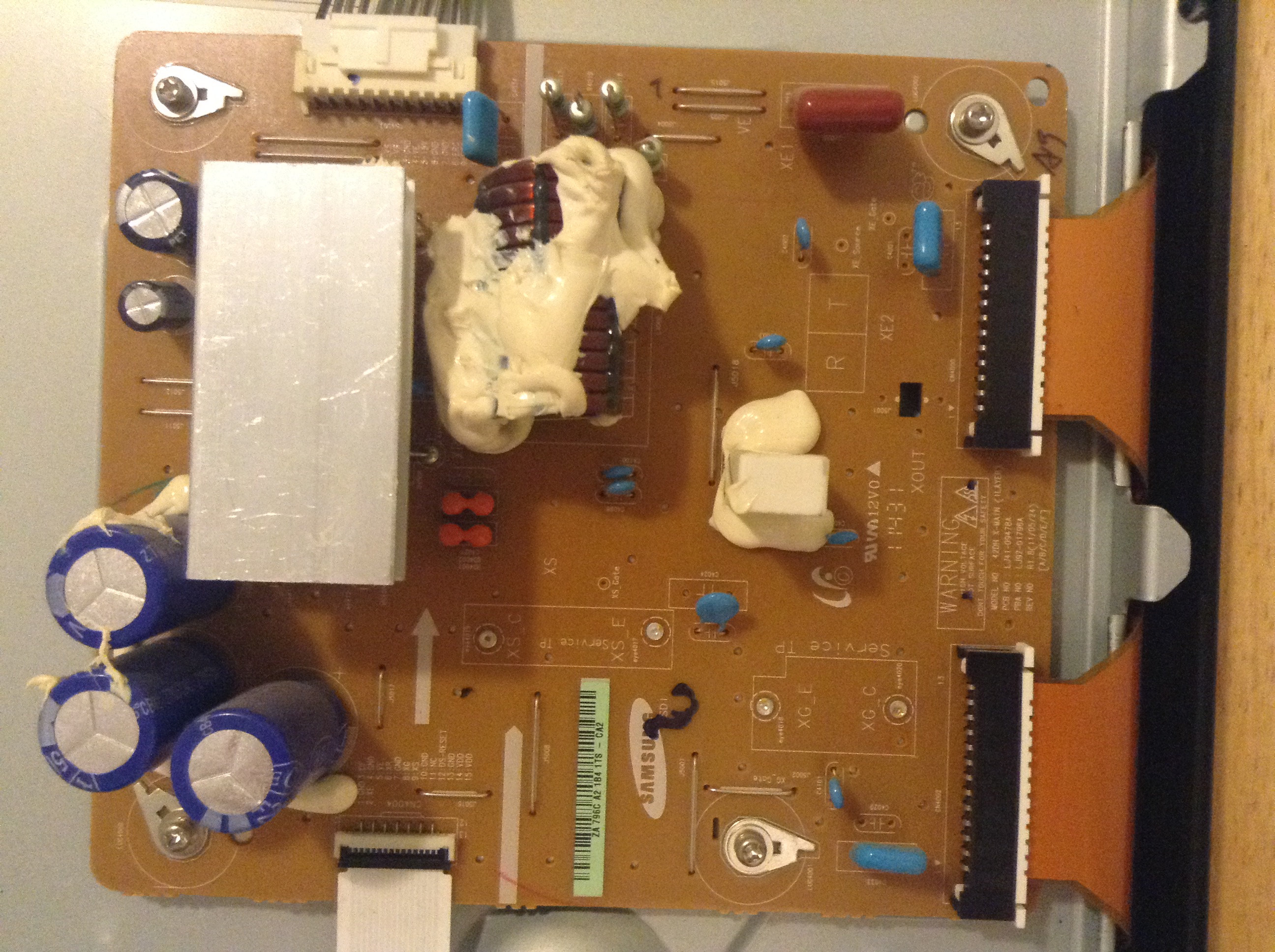

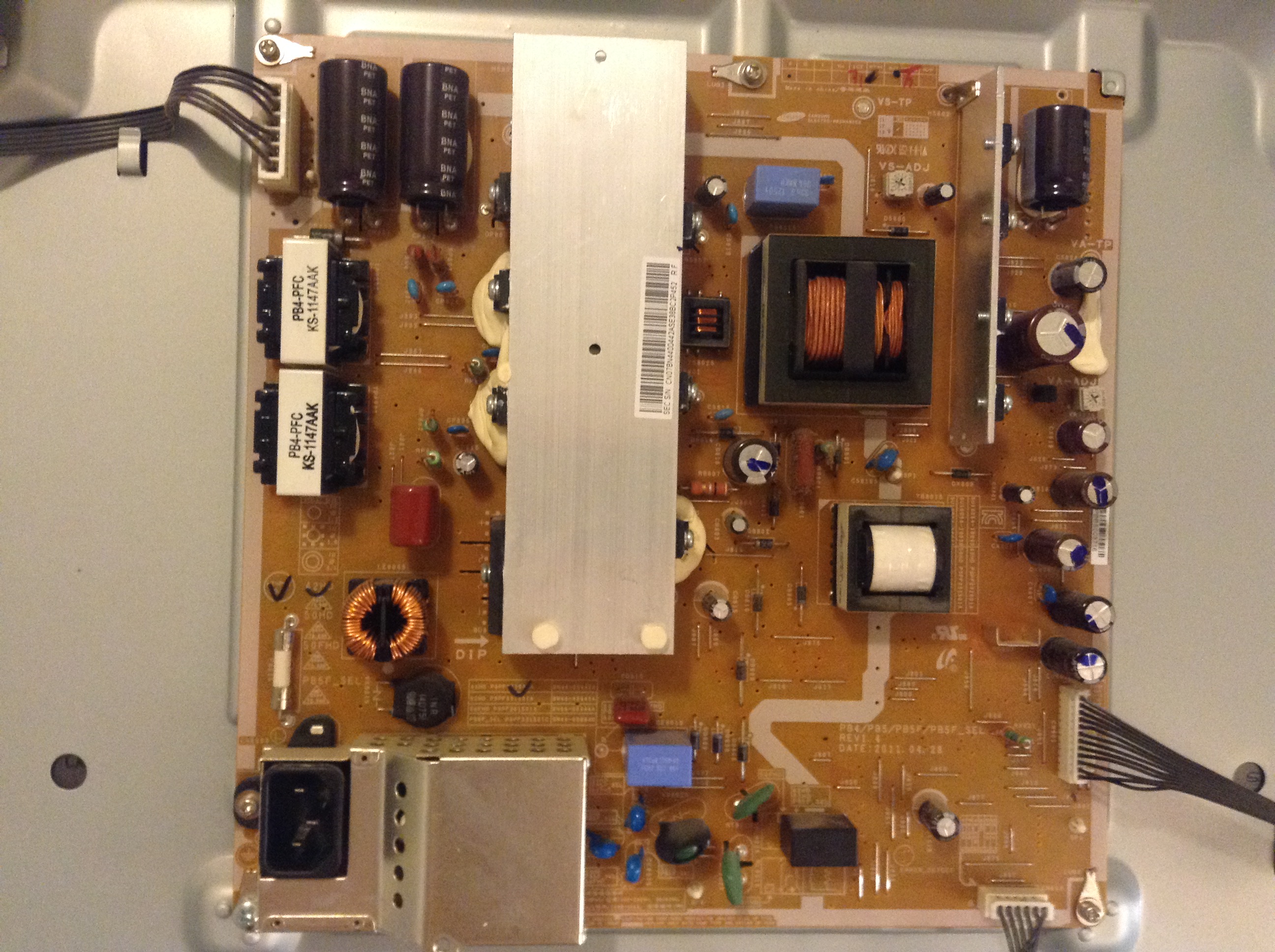

    More Diagnostics: I took the back off the TV and tested the Va, Vsc, and Vs (I couldn't find the Ve testing point). All three were normal (Va = 58V, Vsc = -185V, Vs = 207V), but Vs starts at 207V when the TV is plugged in and then quickly drops back to 0V in about 15 seconds. I've been using Tom's fast track guide (i.e., Samsung_PN43D450A2DXZA_fast_track_guide_[SM].pdf) thus far, but am not sure how to do the part titled "activating power and logic board test patterns without main board" (it's a bit beyond my electronics skills).
    What should I do next? Do you think my TV is salvageable?

    Cracked screen = dead, no way to fix it and it's done. It's now good for parts.

              Not an expert on this, but plasma screens consists two glass substrates that are sandwiched together and sealed, the air is vacuumed out and a mixture of noble gases is injected between the glass substrates. When you crack a screen the gas leaks and the screen is dead. Maybe the gas leaked little by little since the crack incident and now its dead
