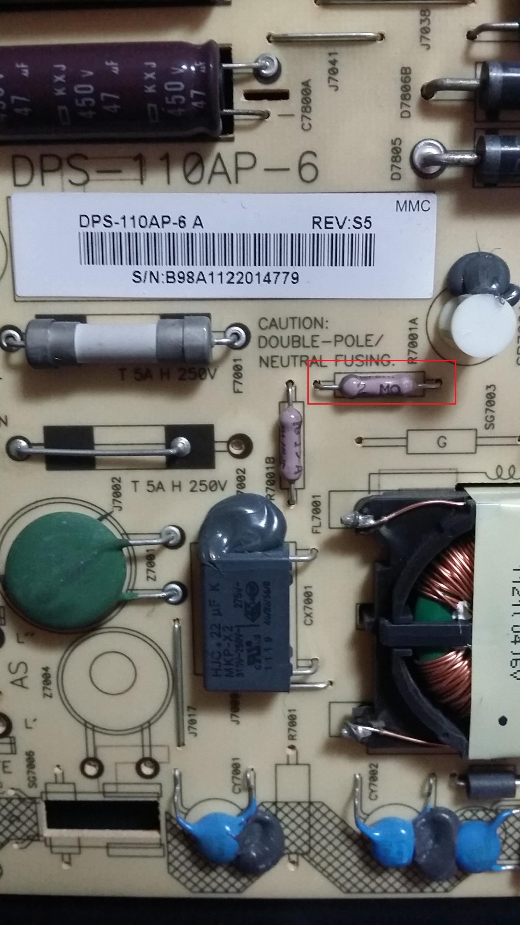

    Hi, i have a Sharp LC-40LE830M LCD TV that has no power now.
    It was turning on and off by itself a few days ago. I pulled out the plug and left it there for 2 days. Then I plugged in last night and it's totally dead with no standby lights. I suspect it's the power supply and i'm trying to troubleshoot the components in the power supply and need some advice on which components to check. Thank you.

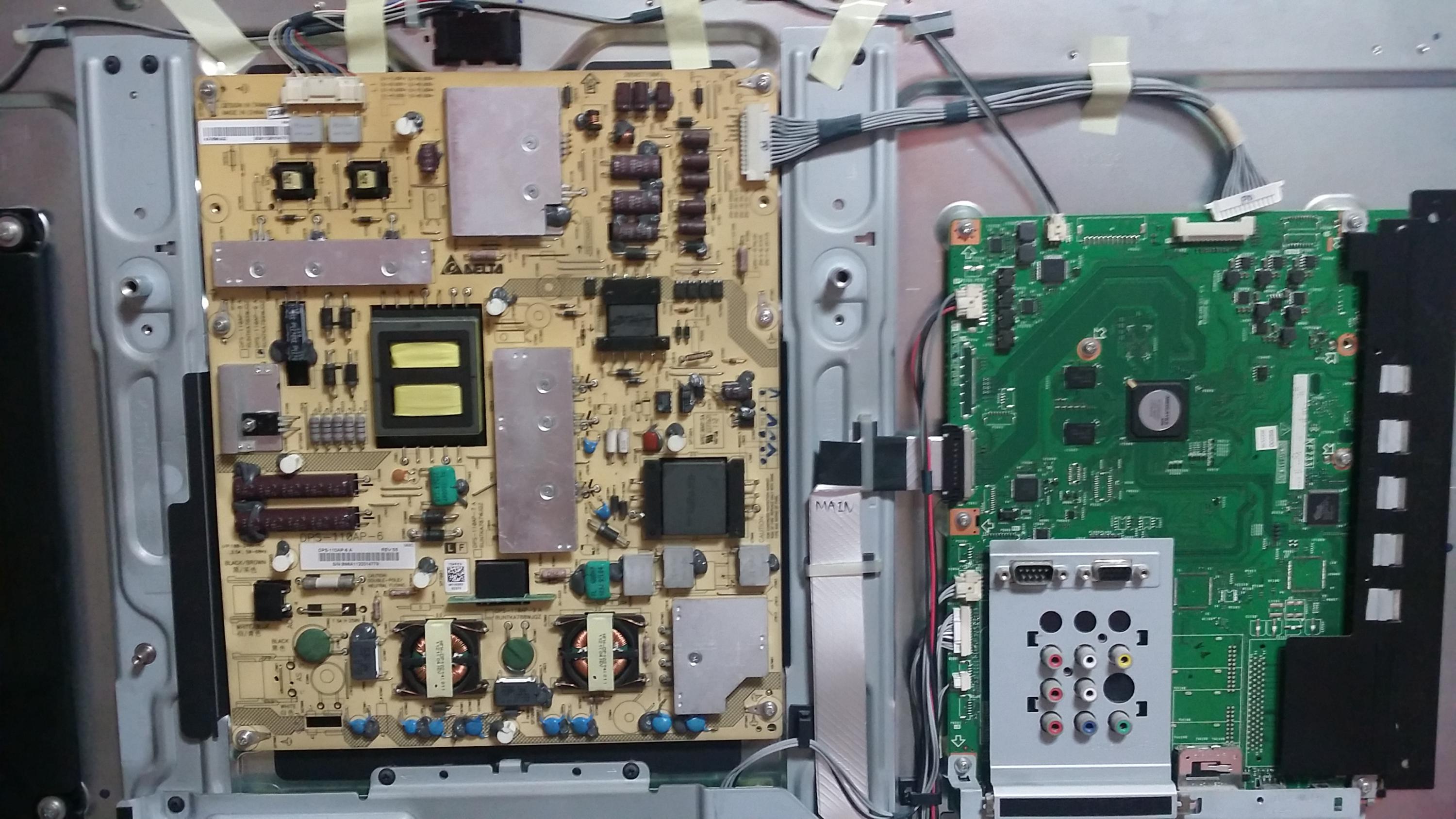

          Re: Sharp LC-40LE830M no power
          Actually, scratch that last post since we're not even sure the power supply is the issue here. Check the pins at the mainboard harness from the ps for 5v standby voltage - if you have that but no lights in front then mainboard is likely the culprit.

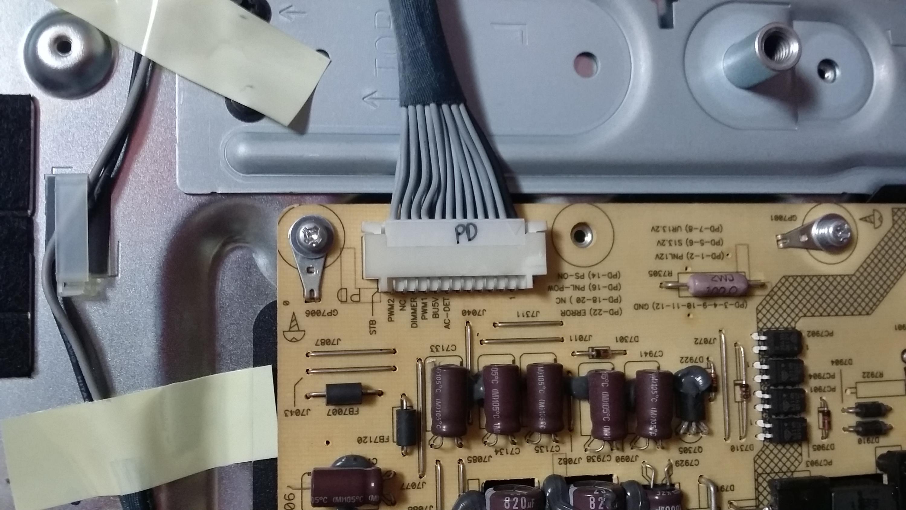

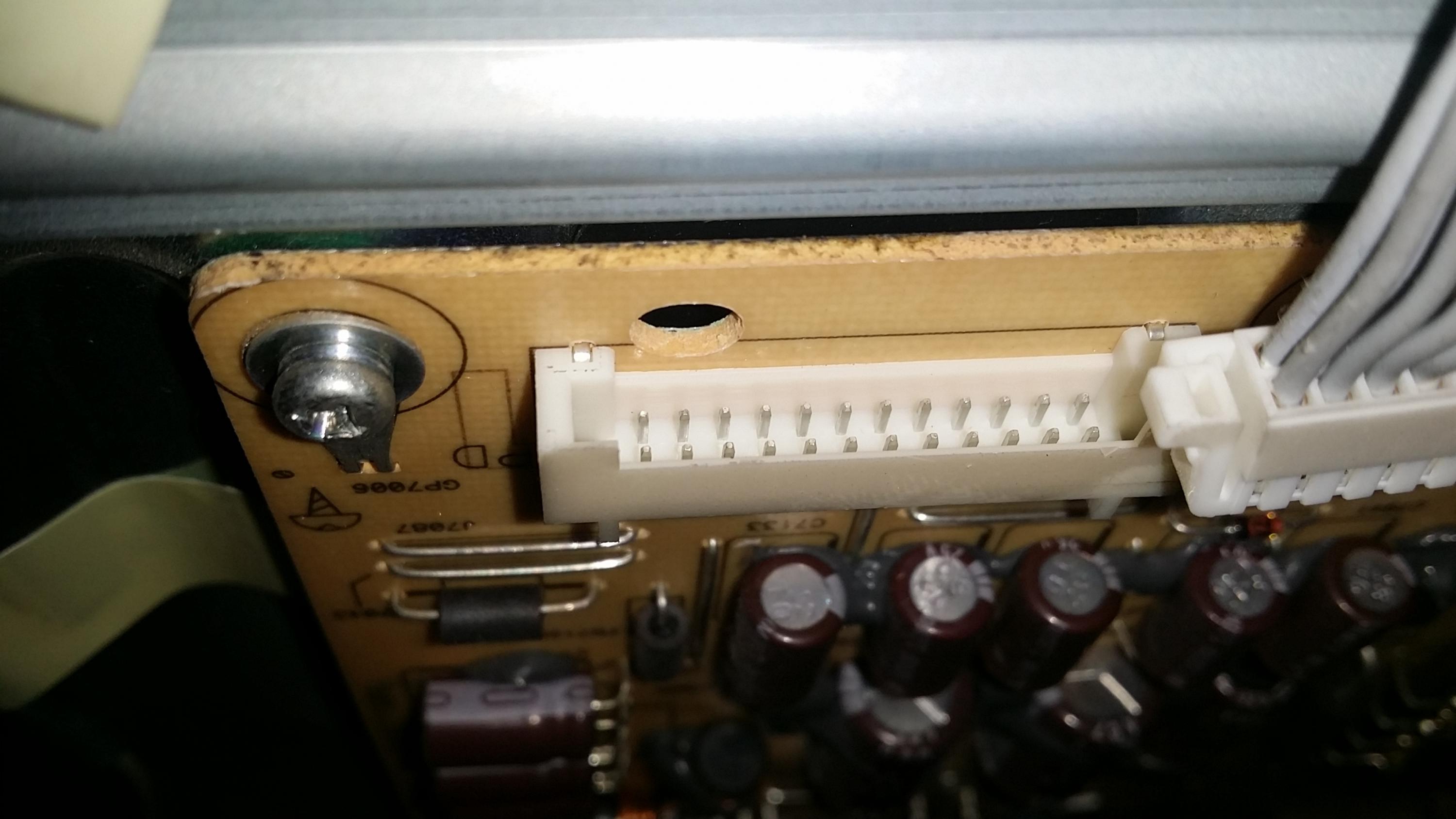

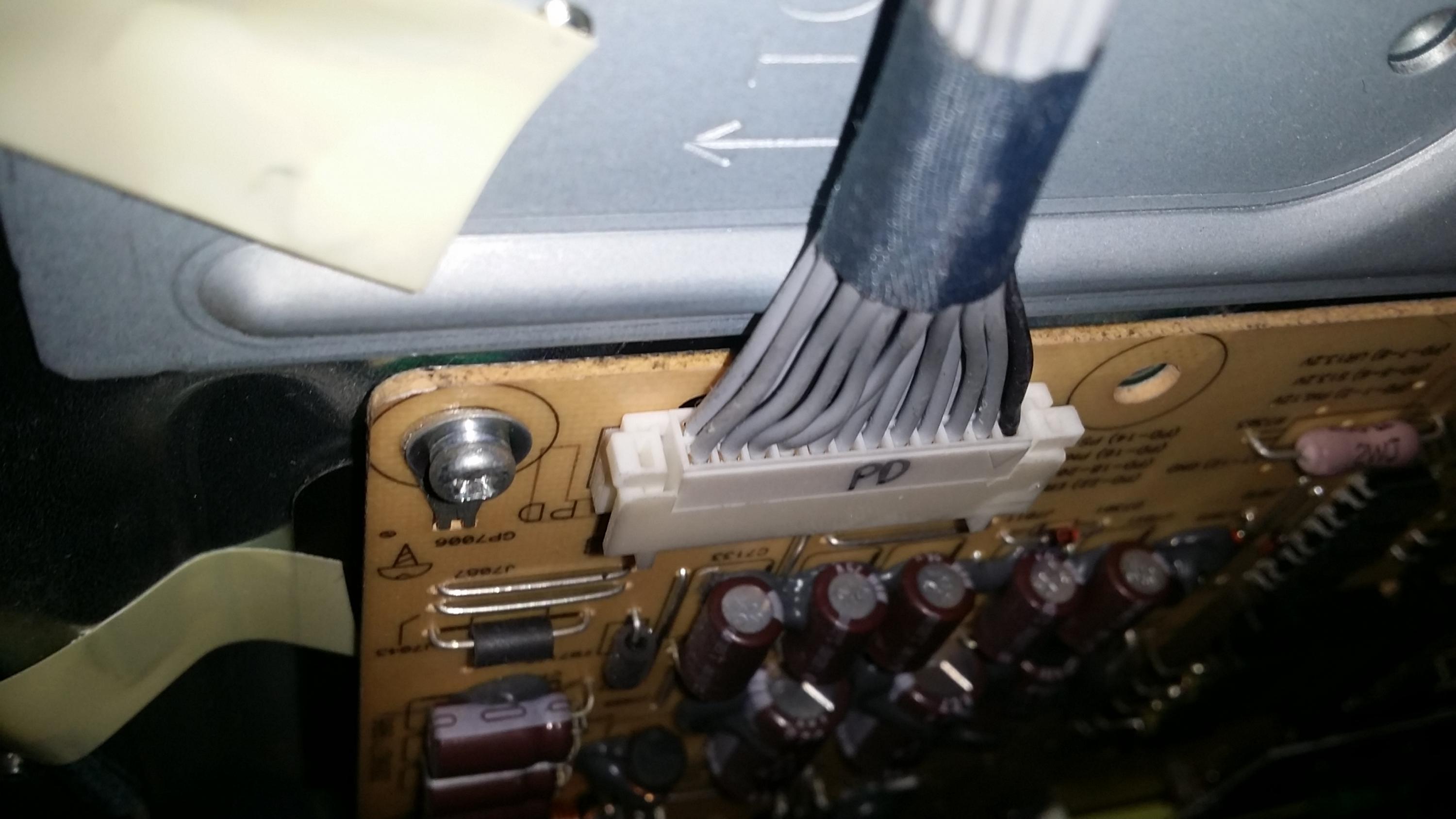

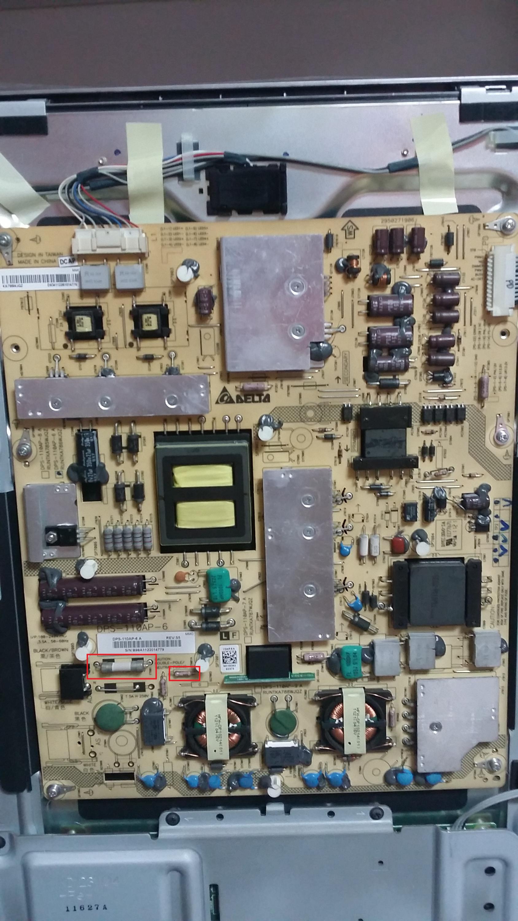

            Hi mmartell, i repair printers but i'm a noob at tvs so please pardon my questions.
            I attach pics of the PSU and mainboard. looking at the connector, do I measure the 5VDC on the metal part of BU5V? If I did it correctly, I got 0V on the meter for that.

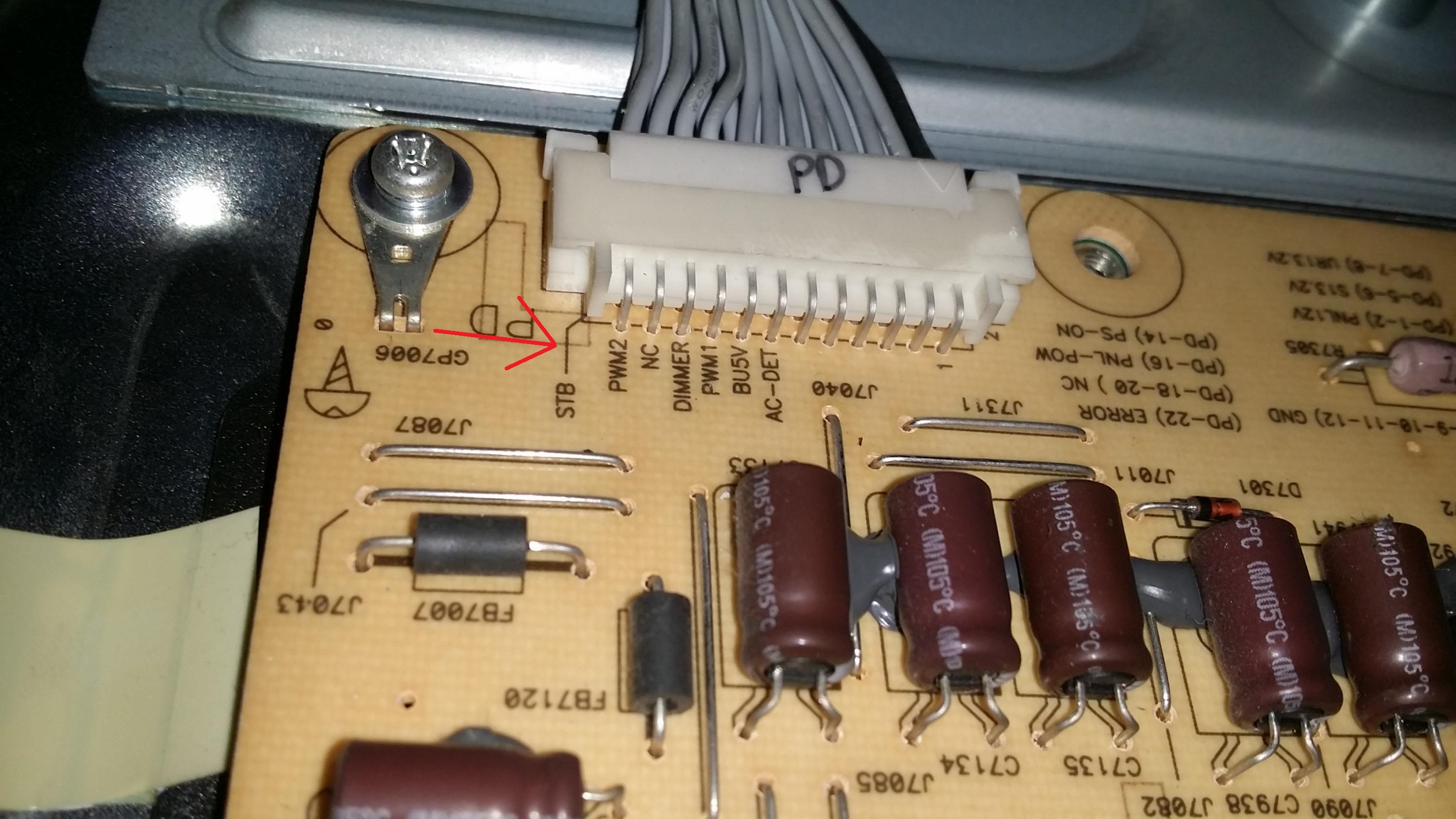

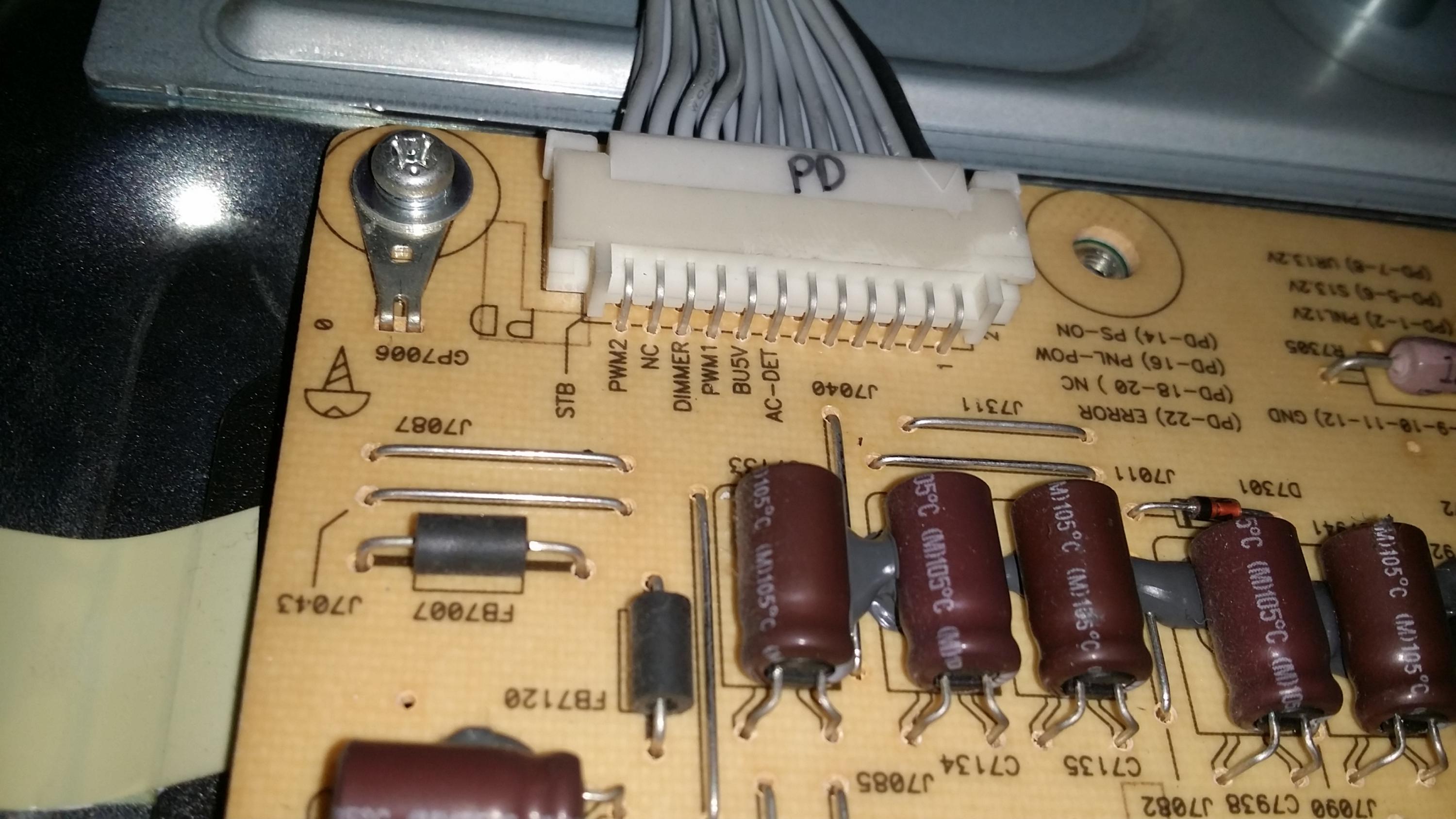

              What voltage do you get at the pin marked stb?
                hi vinceroger69, where do I measure stb? Please see photos.

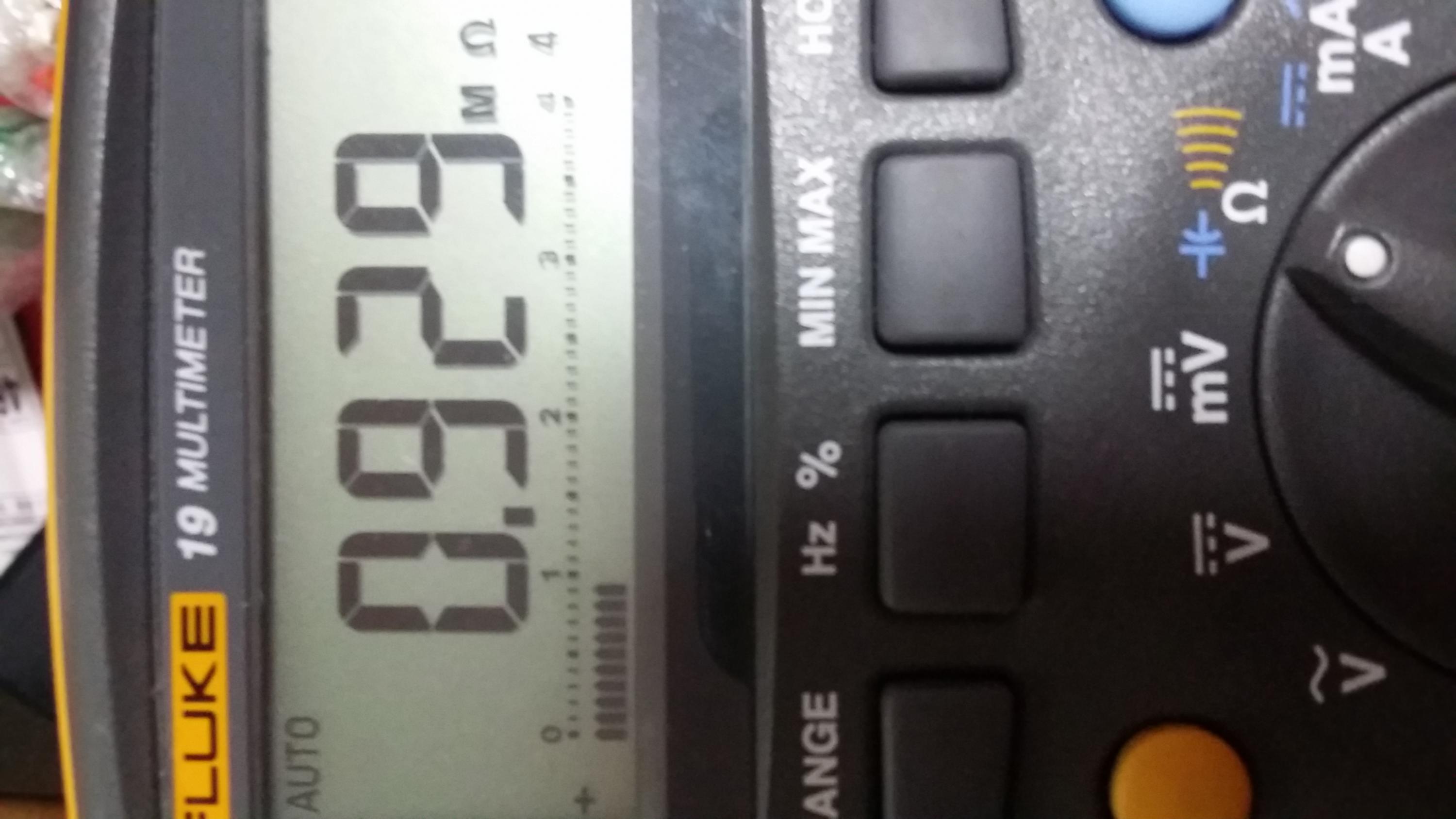

                I also measure around the resistors and found one to be below reading. It's rated at 2M ohm but i measured around 1M ohm. Not sure if this is one of a few components that needed to be changed.
                  Marked it with an arrow.
                  There are 2 rows of pins so it is the one on the lower row closest to the board

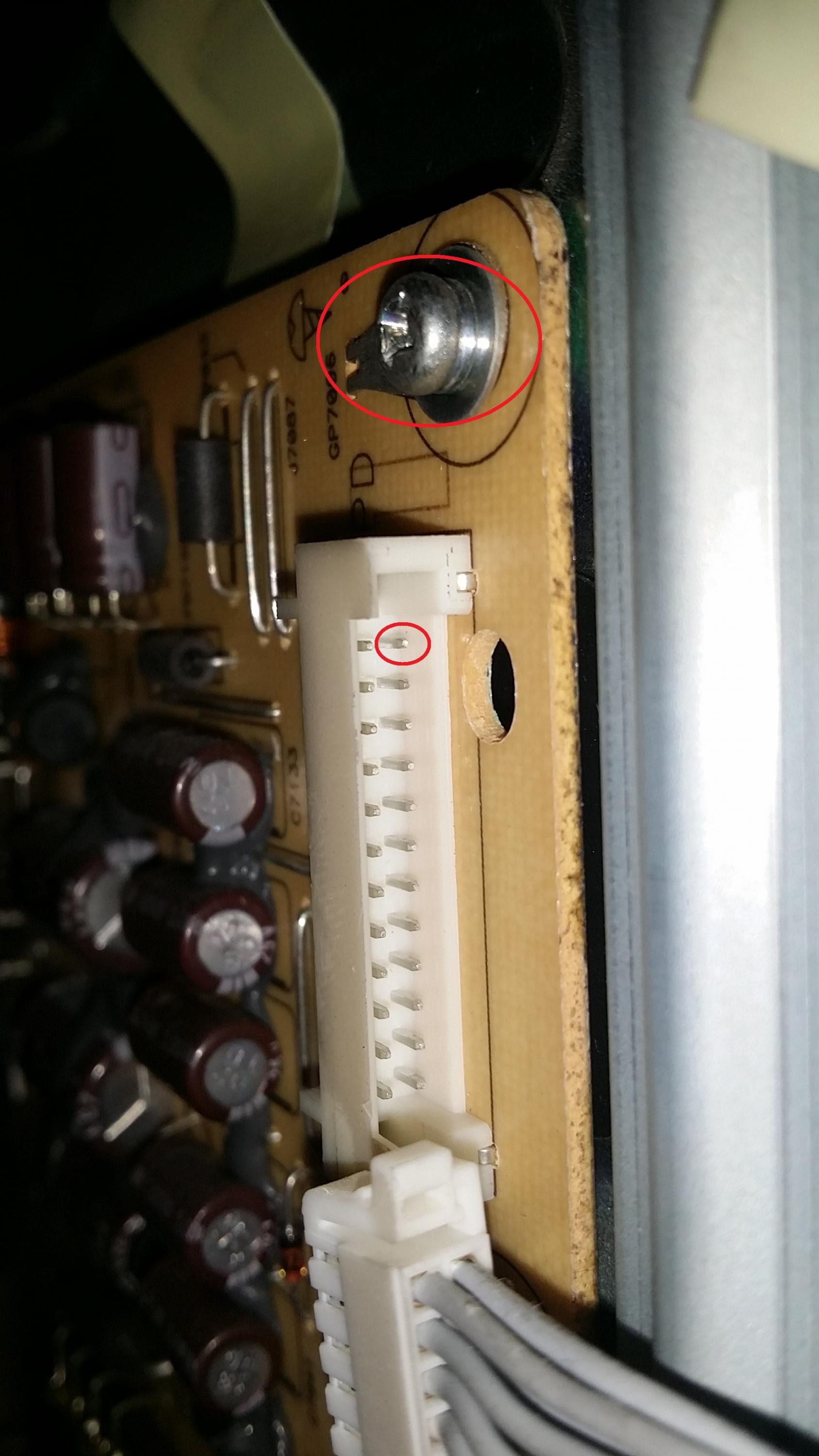

                    i hope i'm doing it correctly. i measured the pin with the circle with my ground on the screw and i got 0VDC

                          There is a white fuse with wires on by the mains input socket does that test ok?
                            you mean the one circled in red? yes, hear continuous beep on my meter. However, the resistor i circled is rated at 2M ohms but i measured around 1M ohm. is this ok?
                              It could be in parallel and read different in cct to out of cct.
                              Again VDC 600v , Can you put Red probe to + and black to - on one of the long capacitors. Careful high voltage.
                                i measured both long capacitors and got 0VAC for both...am I doing anything wrong? Why is everything 0V??

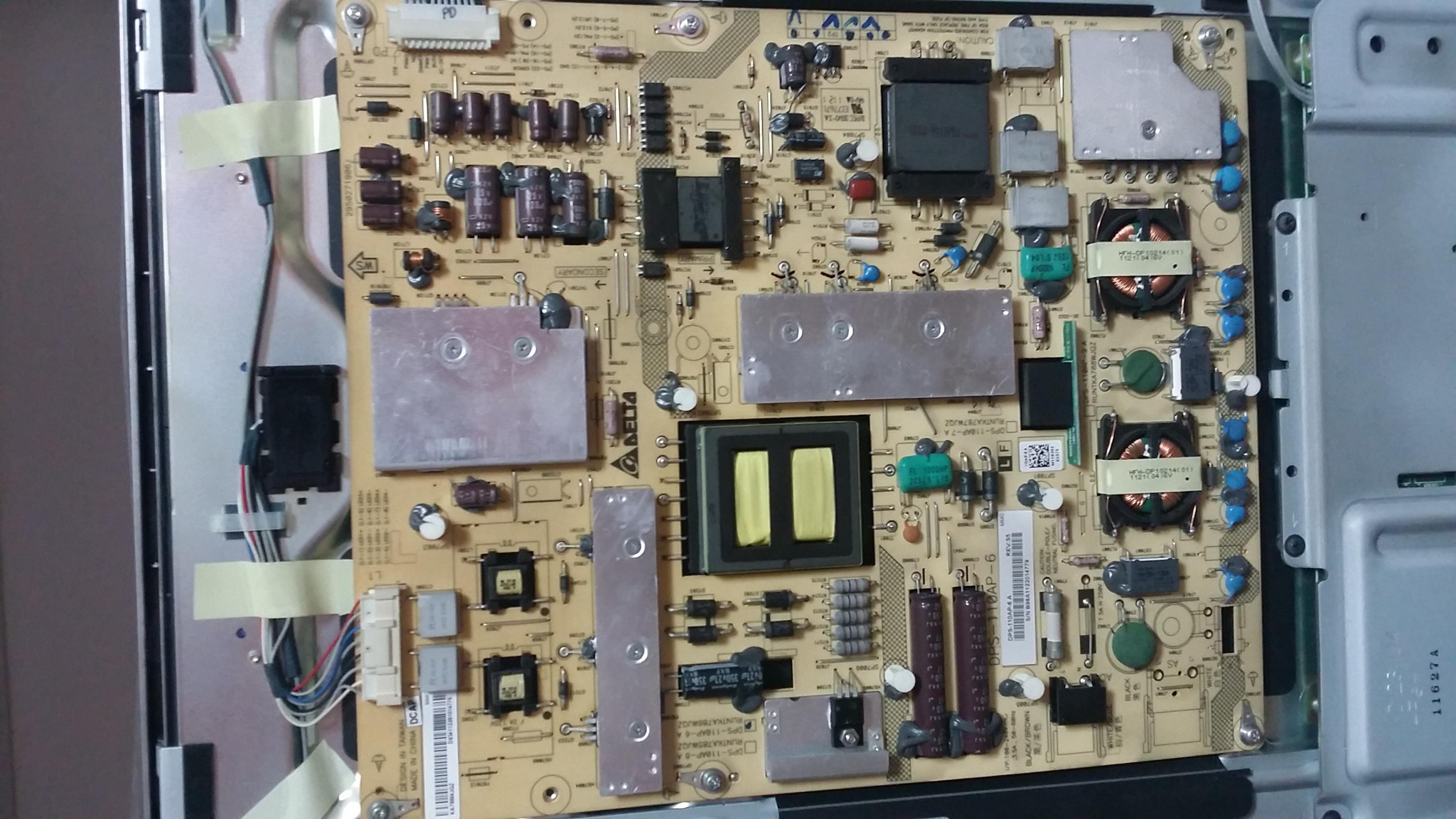

                                  You have voltage at both ends of the white fuse you highlighted yes?
                                  Can we have a photo of the underside of the board too so we can see the traces please
                                    yes, i did continuity check on the fuse and it's ok. it's not blown
