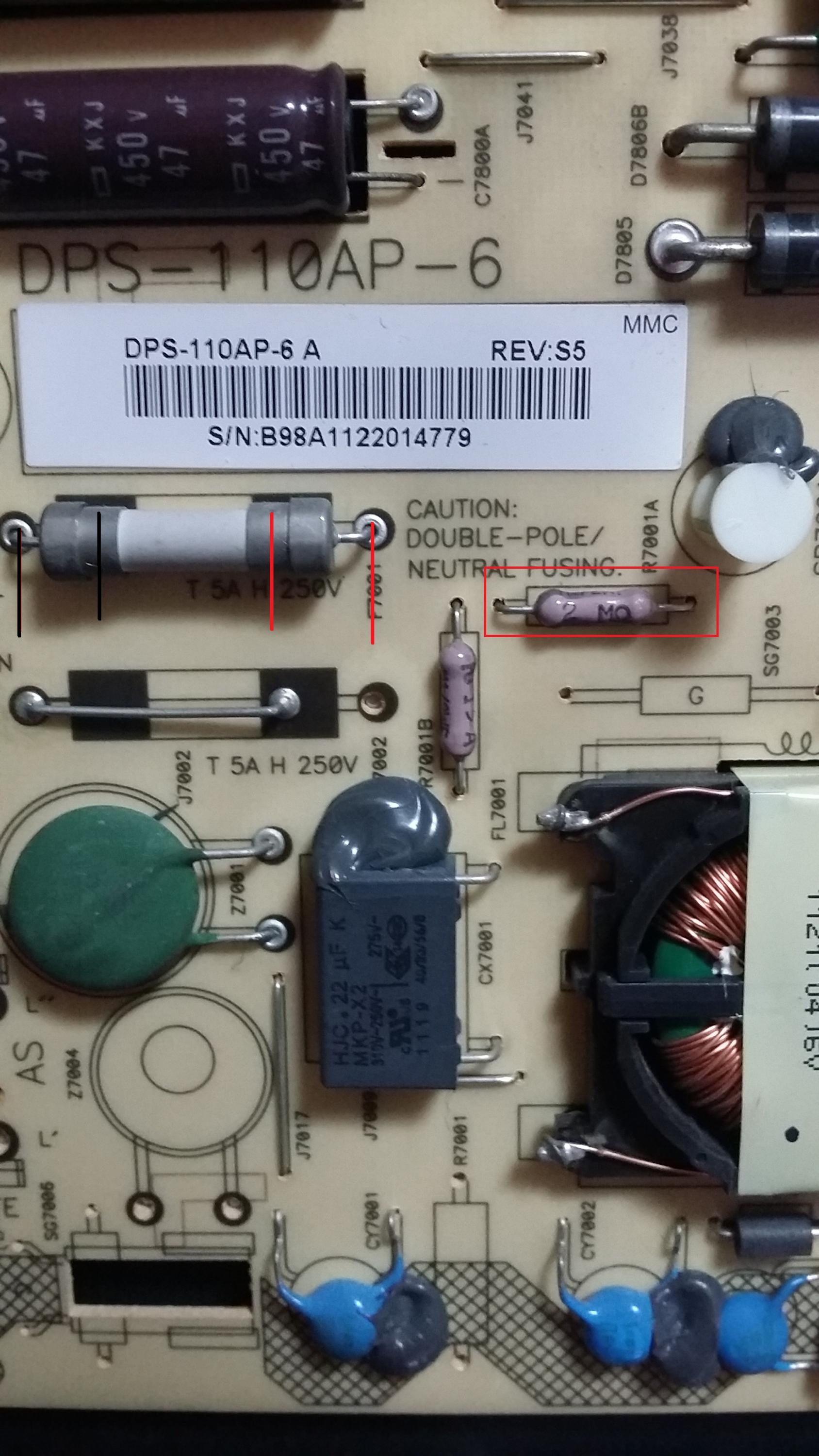

          Re: Sharp LC-40LE830M no power
          how are you testing the fuse? just to check your doing it right
            Taking the black and red lines as the probes, i first place the probes at the ends of the fuse itself then at the wires.
              Confirmation of voltage at the connector next to the fuse when plugged in?
              If you get voltage leave the negative lead at the connector and put red to right side of that fuse, Reading?
                voltage at the main input of the PSU measures 240V. I then place the red probe on both ends of the fuse and the black probe on the ground and measure both sides as 134.4V. Long capacitors still 0V
                  it reads 240V with negative end at the connector and red at right side of fuse
                      That is with meter on VDC with a probe to each leg of one capacitor correct?
                        #31
                        sorry my bad, both long capacitors measures 330VDC

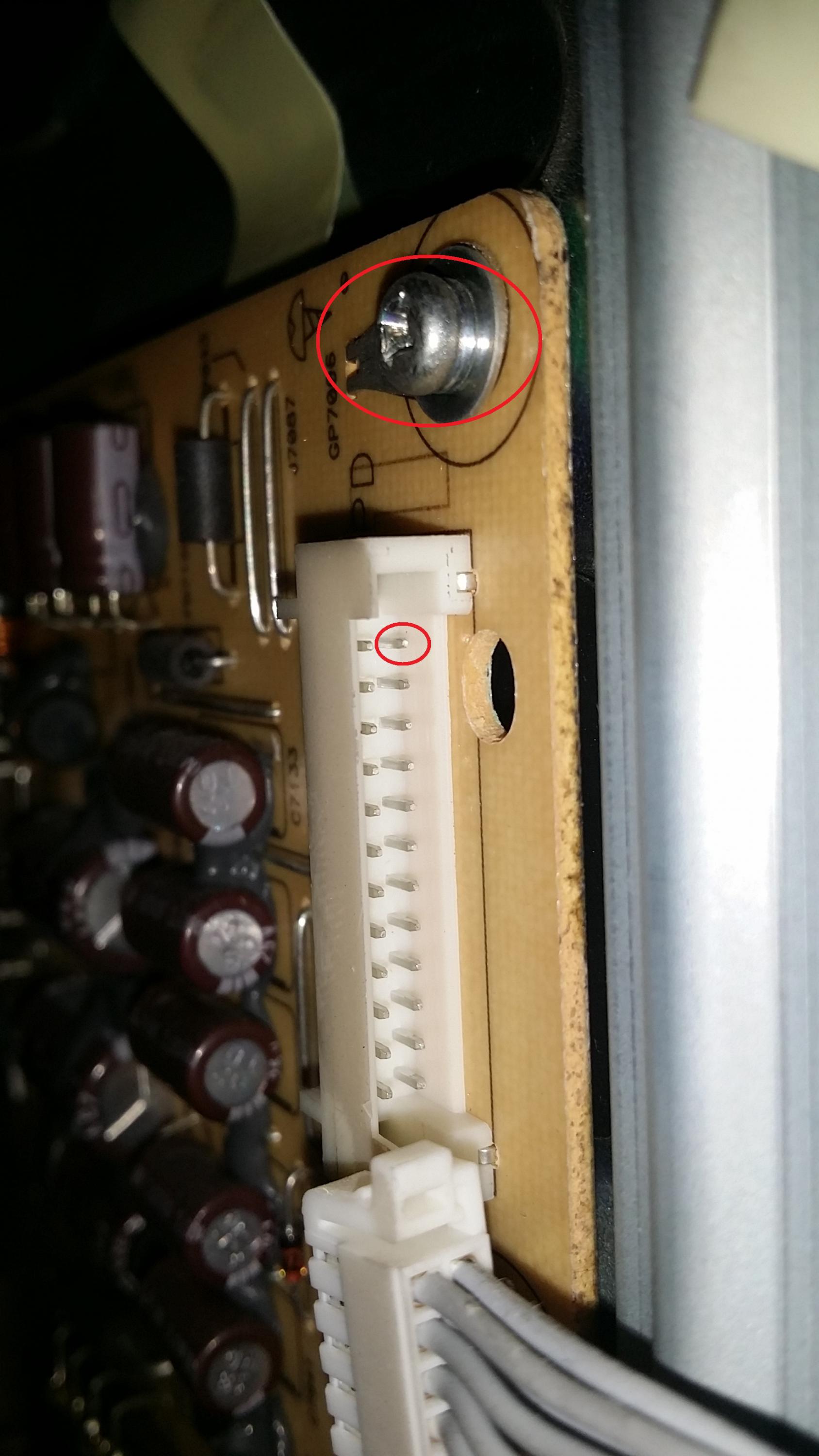

                          Ok lastly can we double check the STB voltage at the connector mentioned earlier please... As we have had inconsistencies in readings
                            #33
                            i got 0 VDC at the point circled red
                              Ok this is the point a Schematic would be very handy but not finding one anywhere.
                              You will need to get a good clear photo of the underside of the power board so it is possible to see all traces and read and markings clearly.
                              I am useless at tracing out circuits so someone else will have to take it from here, our member budm is very good at this and hopefully he jumps in when he comes online.

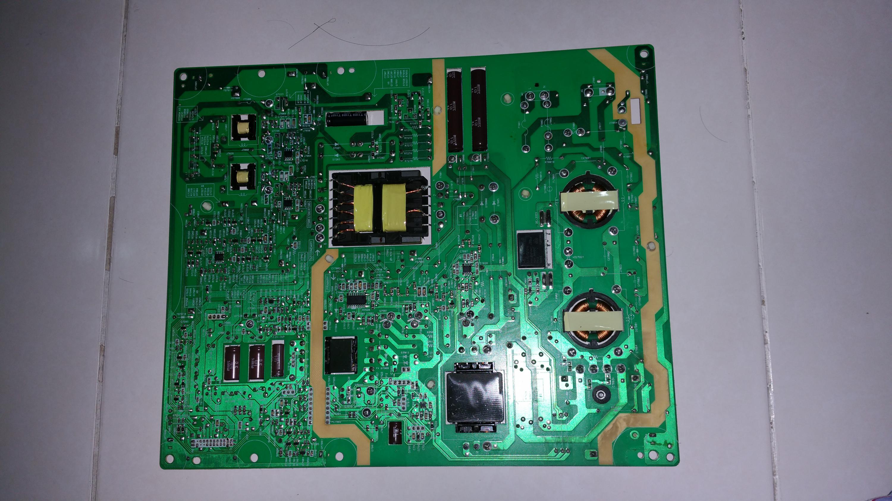

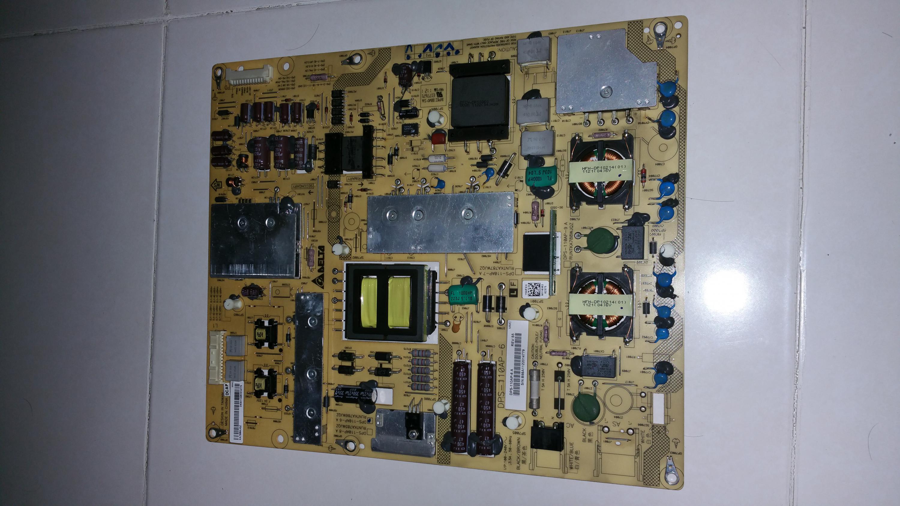

                                  Couldn't sleep without taking the pics...so here they are.
                                  Any advice will be much appreciated. Thank you.
                                    Do it outside, in sun light.
                                      #38
                                      There is a secondary side of the power supply, marked with that thick line. You use the black probe on the mounting screw. On the primary side, the black probe, goes to the negative of those big capacitors.
                                        #39
                                        hi tibimakai, thank you for your suggestion but is it possible to circle on the board so I won't make any mistake as i'm a noob in troubleshooting tv. Thank you.
