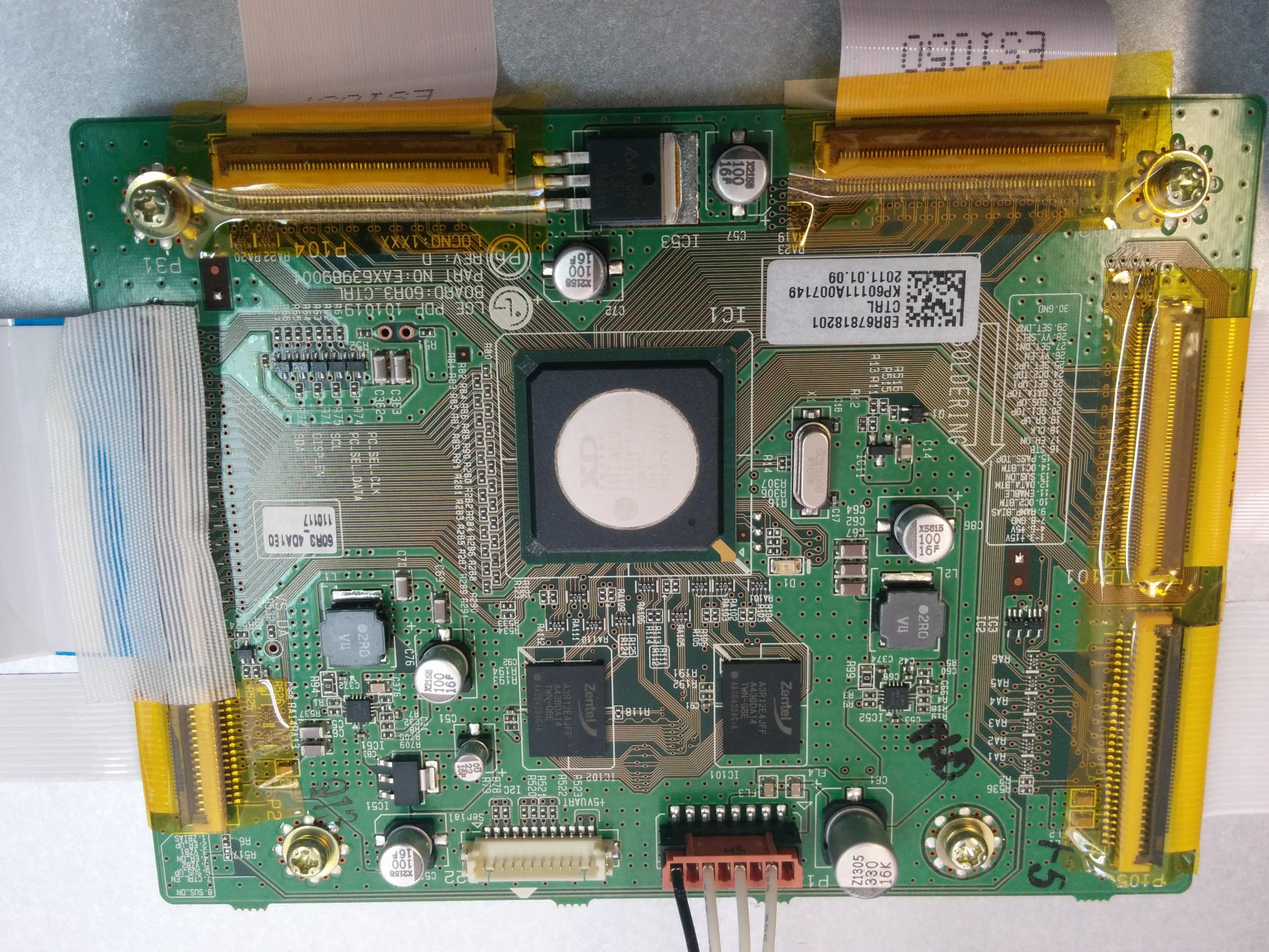

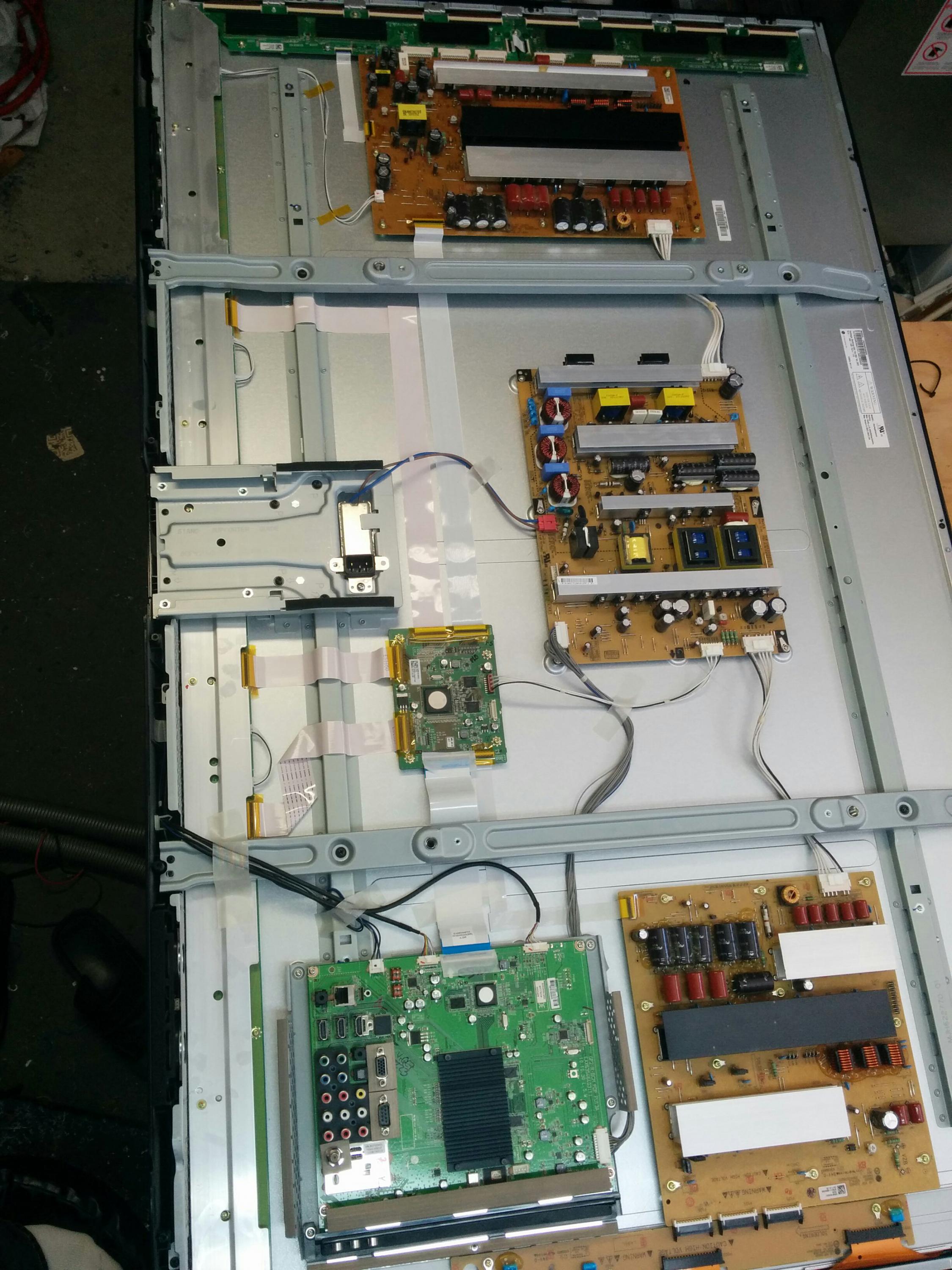

    I've always curious about component level troubleshooting and opportunity presented itself with this problem on my plasma TV. I would love your help in helping me diagnose and fix this. What I've observed so far:
    Broken behavior:
    - Everything connected, powering on produce a quick white noise and turn off immediately
    - When i disconnect Y-sus, powering on has constant white noise but no picture. TV stays on
    - When i disconnect just X-sus, powering has constant white noise and blotchy black and white on screen. TV stays on
    - When i disconnect both, same behavior as disconnecting Y-sus
    Observation
    - All capacitors looks normal, no budging but i haven't test each one individually

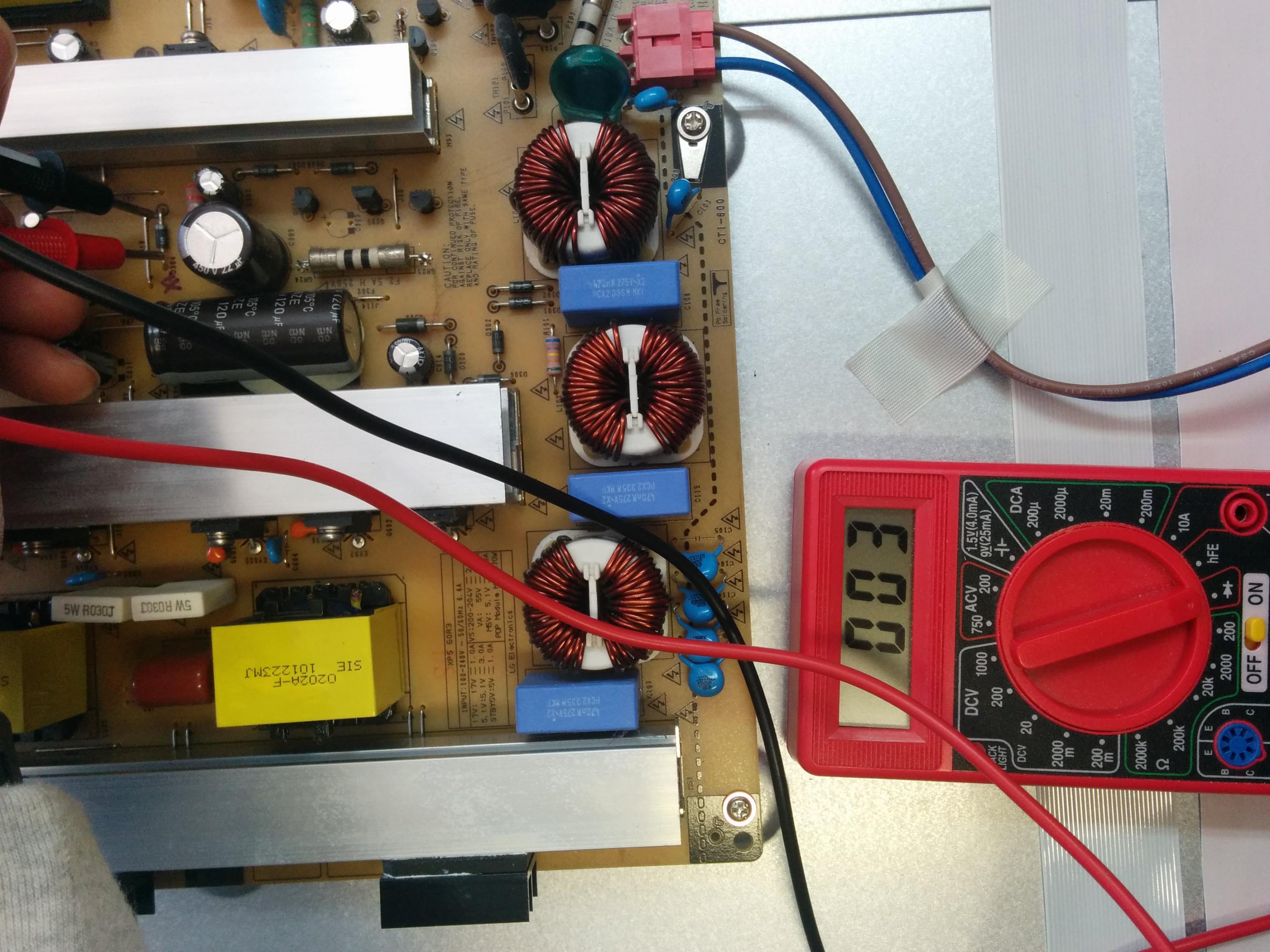

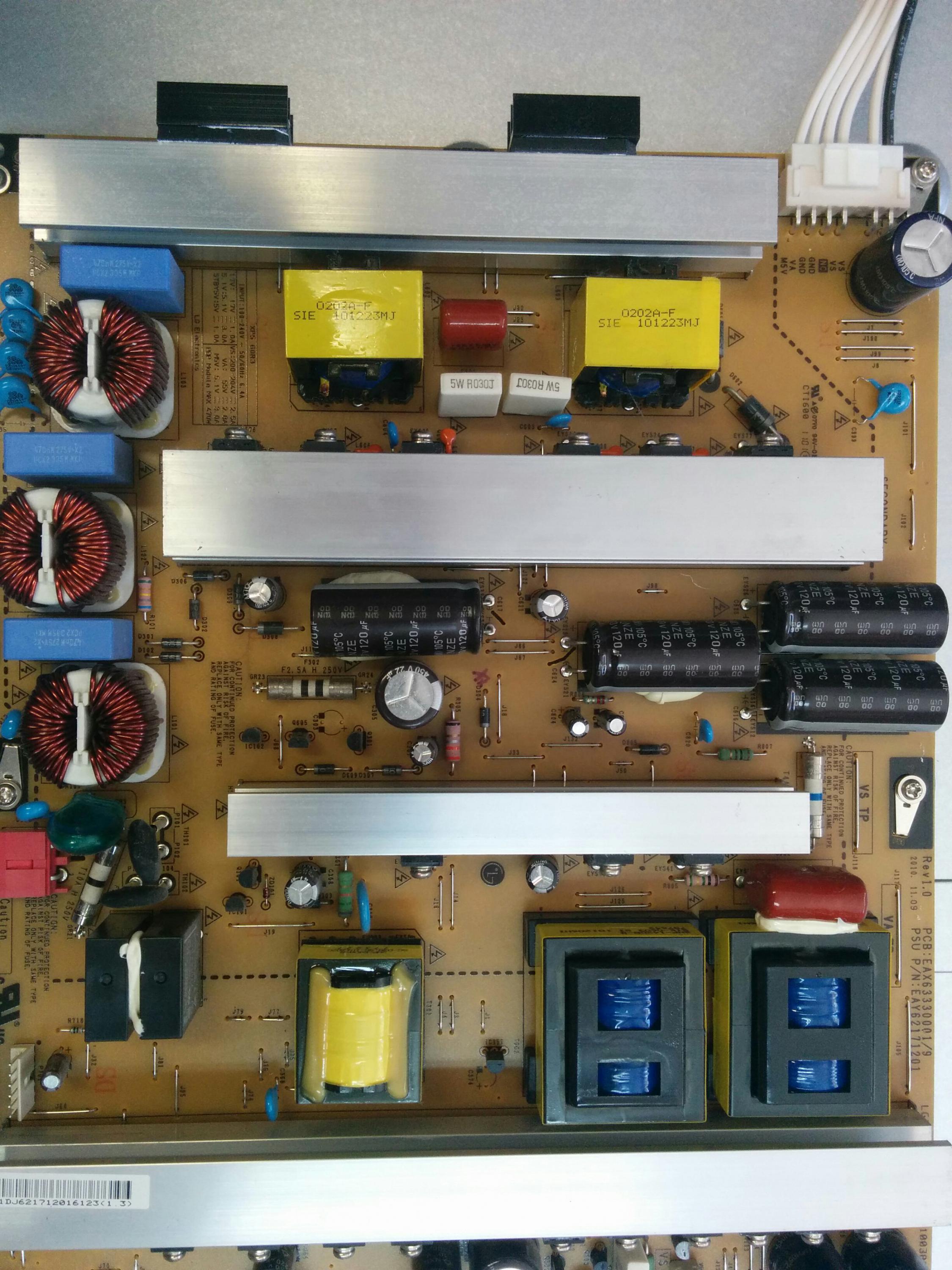

    - I tested the diodes on the powerboard and found one leaky one(multimeter show 4-7 both ways instead of normal 500-700 fluctuation, and 0 on reverse see pic).
    - Tested the fuse and they seem to be ok
    Question:
    is it the y-sus or the power board with the malfunction diode?
    Haven't taken the diode out yet, but where/which replacement should i get?
    What else should i test for?
    I'm new at component level testing so detail instruction/reference would be appreciated.
    Thanks!

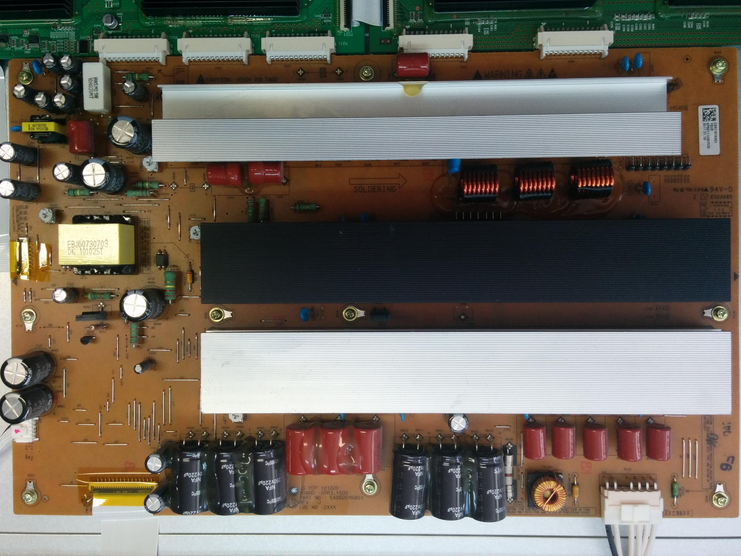

    by x-sus i mean zsus(sticker on right board)
    1. update* When i disconnect Y-sus (Zsus connected), powering on has constant white noise but no picture. TV stays on *for about 2 minutes then turn itself off again*
    going through tutorial in https://www.badcaps.net/forum/showthread.php?t=18542&:
    2. I checked the fuse (FS103) on zsus and it seems blown. touching the ends flash a random number on dmm and shows 1 leftside after. zsus FS104 is ok.
    3. ysus fuses FS101,FS102, FS103, FS104 are ok (.5 values).

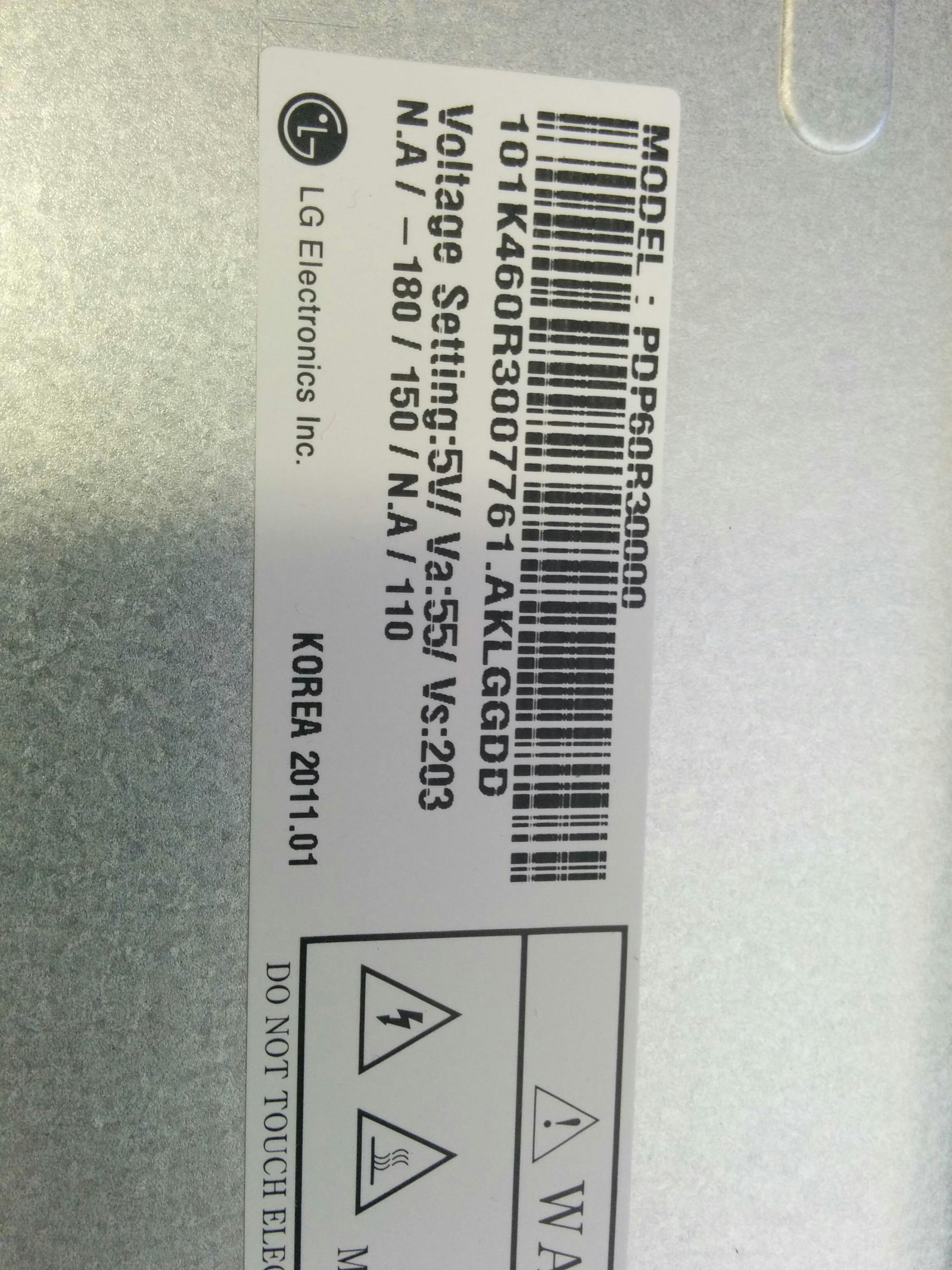

    4. Vs and Va from power board is same as spec (Vs 203, Va 55)
    Vsc and Vy- and Vzb, I have black probe touch metal plate and the red probe touch the +/- point where it says + Vxx -. Is this the right way to check voltage for these?
    vsc and vy- seems low at these points
    5. Vsc+(66), Vsc-(83)
    6. Vy- (83) Vy+(96)
    7. Vzb is 0!
    So from finding #1,2, 7. is zSus the problem? solution: replace the fuse in #2 before trying to replace zsus?
    What does #5 and #6 low Vsc,Vy mean?
    Please advice before I proceed . Thanks!

          Vsc and vy- matches sticker. vzb, however, is 0. is it because of the blown fuse FS103?
          * vsc =150
          * vy- = -180

              Probably blown igbt's on the zsus board. Replacing the fuse will just blow it again and possibly cause more damage. Use your meter to check for shorts on the devices attatched to the heatsinks.

                Check the solder points on the inductor coils on the Y-Z boards, these are known failures on this series of plasma panels.

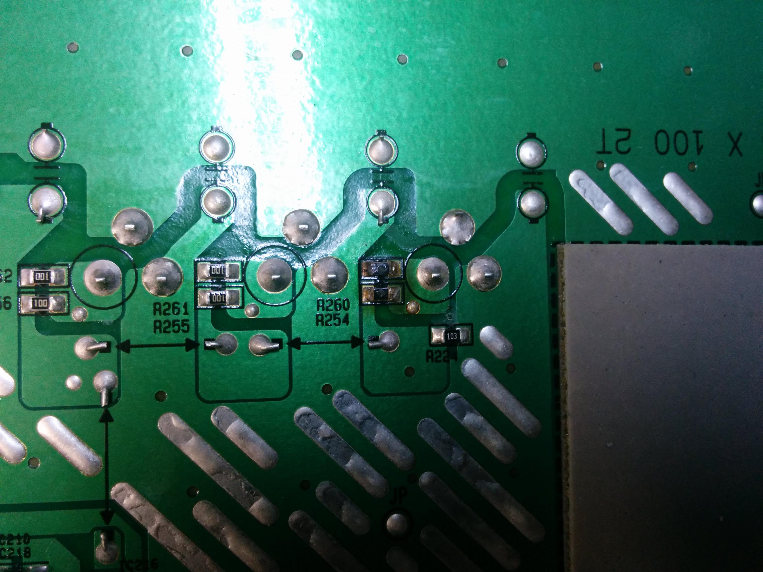

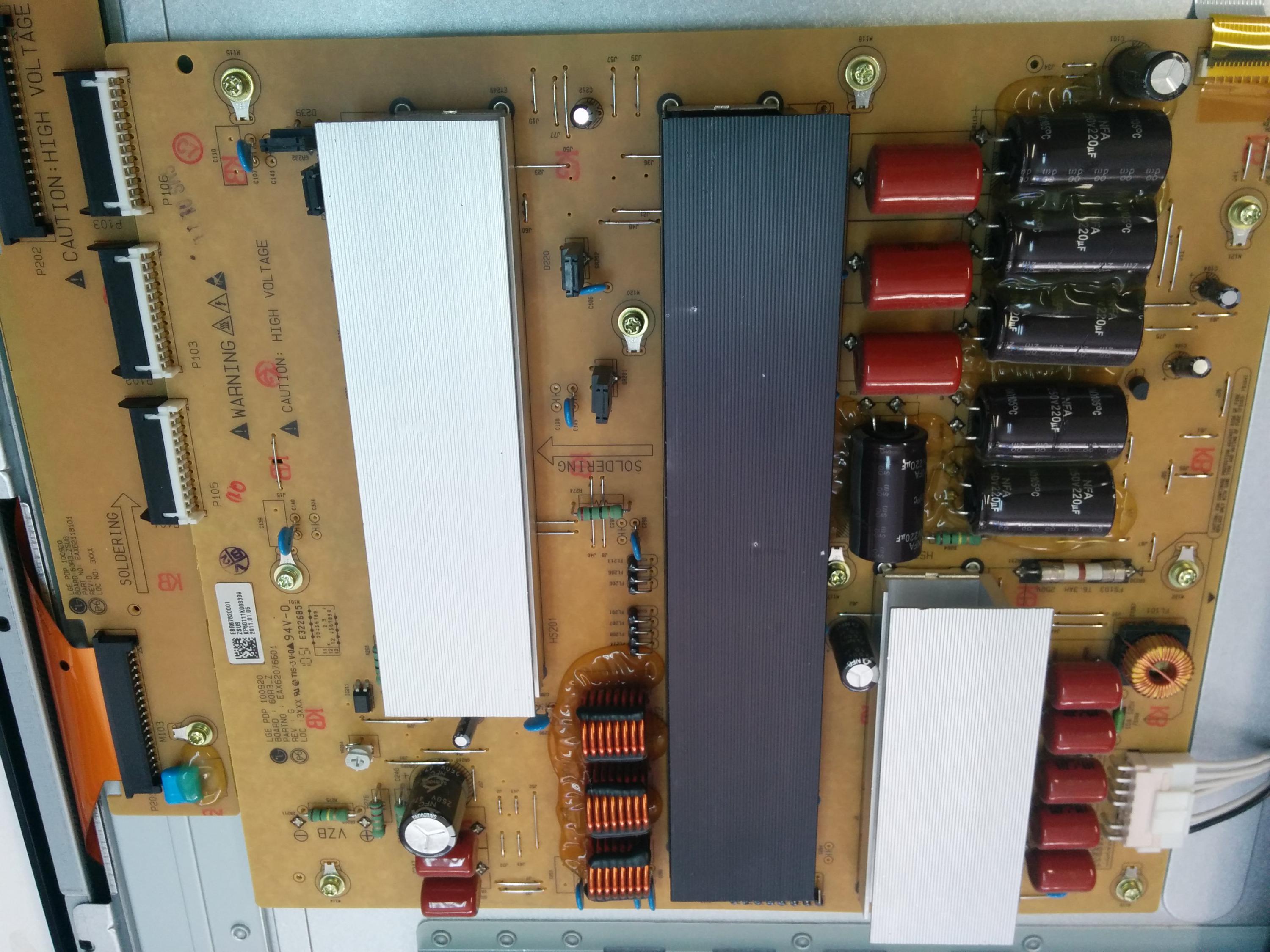

                  took out the zsus board. found these two burned-looking small chips that's right under Q212 at the white right heatsink. What are they? replaceable or do i need a new zsus? Thanks!

                    I'm going to suggest they were 2 x 10 ohm resistors, just probe all combinations of 2 legs in diode or continuity of that transistor and see if shorted. then do the same in resistance and post up the readings.
                    are the other 2 devices next to that transistor the same transitor type i.e the part number stamped on the case?
                    Do you have any scrap boards you could maybe pinch similar resistors from with 100 stamped on them?

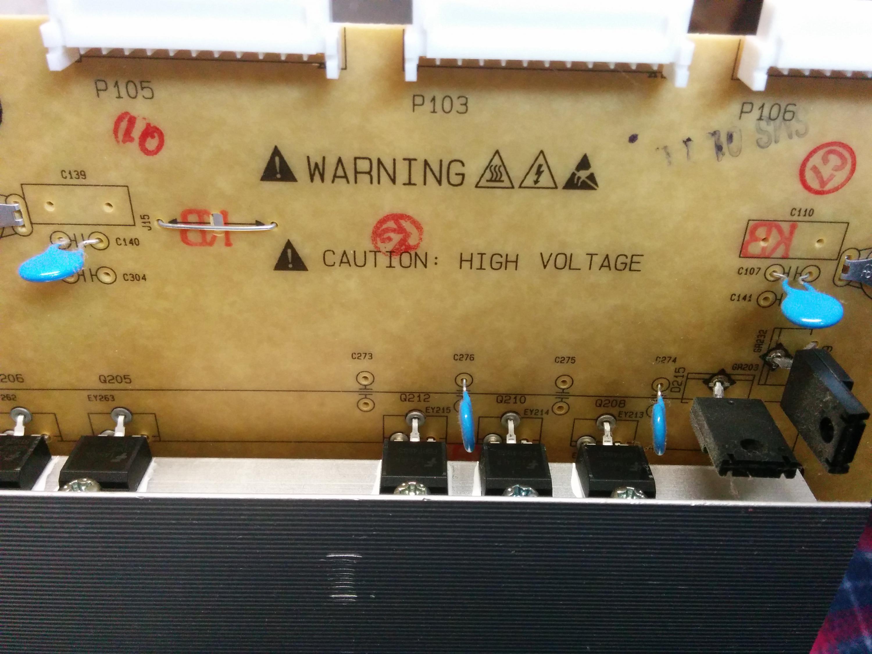

                      Actually I think I can just make out FGPF4533 x 3
                      http://au.mouser.com/ProductDetail/F...Qq3Co0Tw%3D%3D
                      • tw2005
                        • Oct 2011
                        • 6458
                        Re: Troubleshooting LG plasma TV 60PZ550 no picture, auto shutoff
                        those 3 will be working in parallel

                          part number on q212,q210,q208 is fgpf4633. diode mode all 3 chips beeps(shorted?) on various prong touches 004-018 range values. The other set on the same heatsink is silence.
                          on omh, values are about 9.6 when touching the legs

                              I would not bother, they sound shorted. You could start with removing that transistor with the burnt resistors, then retest the other 2.

                                I need you to be specific, are we talking the resistors or transistors? A 10 ohm resistor will beep and read close to 10 ohms, it's the "Q" device you need to check
                                    reading is for the 3 legs Q transistors

                                      These reading is for 3 leg Q transistors. Touched black on right leg, red on middle or left legs. all 3 Qs show similar values
                                        ok, you'll need a new zsus or could see if you can get lucky with this one trying to repair it.
                                        I'd remove that transistor that those burnt out reistors are andthe resistor too, then check the other 2 transistors again
