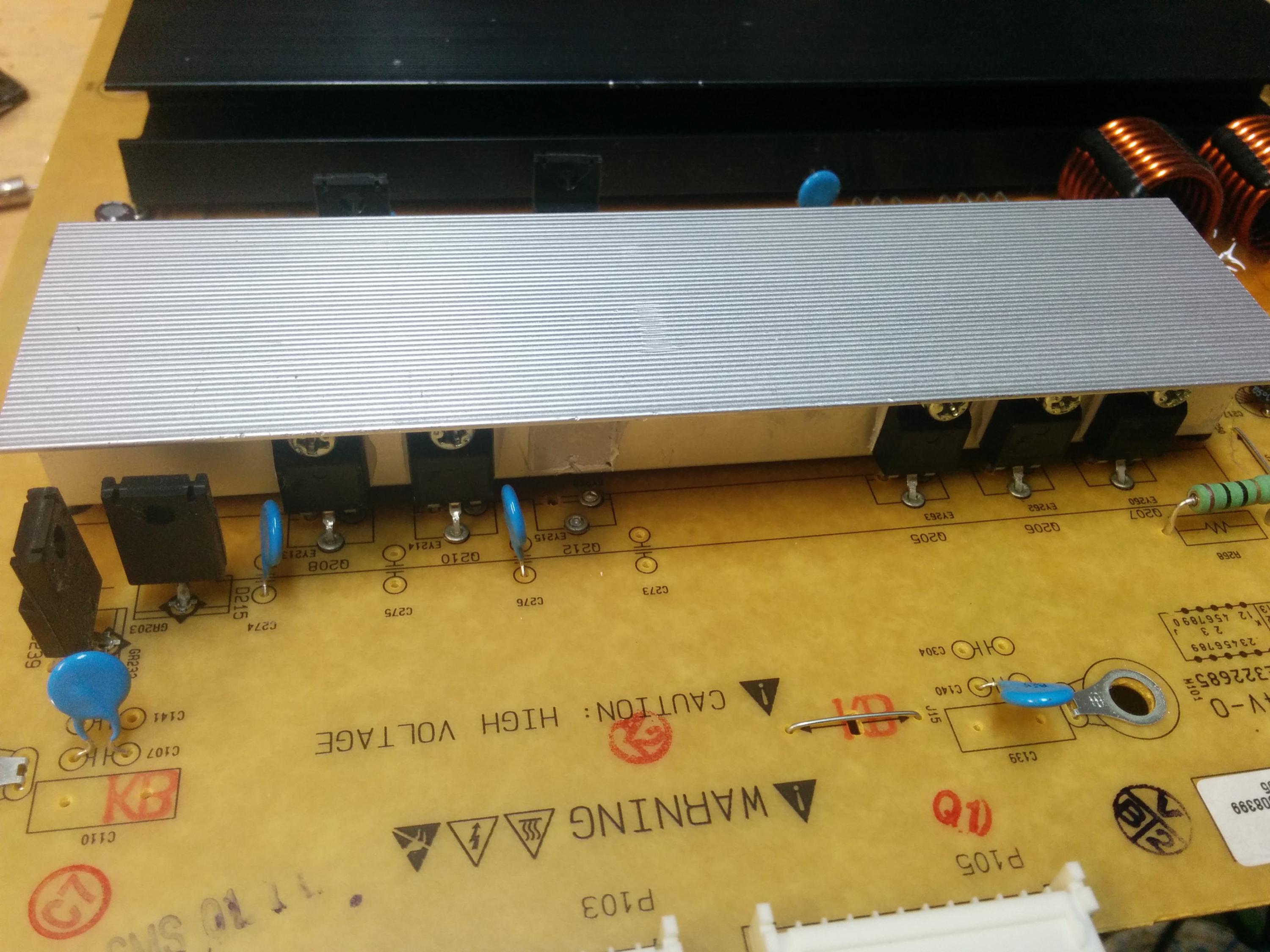

    Seeing thats the Gate Drive resistor (parallel 10 ohms, meaning 5 actual) and they are fried--Whatever is Driving that gate circuit would have been killed by the IGBT going short and shoving 200V up its ass!
    Check the driver transistor pair and any inverter/gate/buffer attached to the gate-circuit, or just replacing the three IGBT's and two 10 ohms will be Very disappointing!

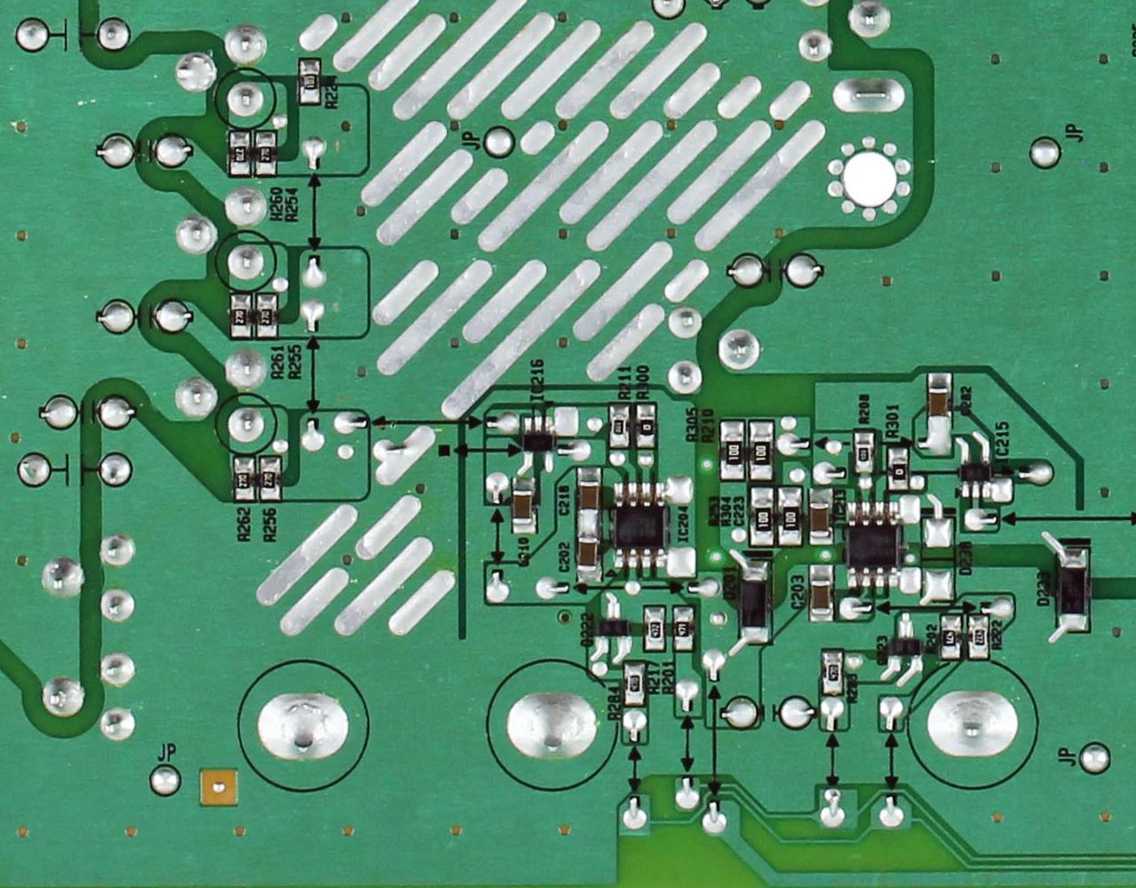

        Can you please elaborate? I'm new at this . attached is the circuit around this heatsink, what else can i check?

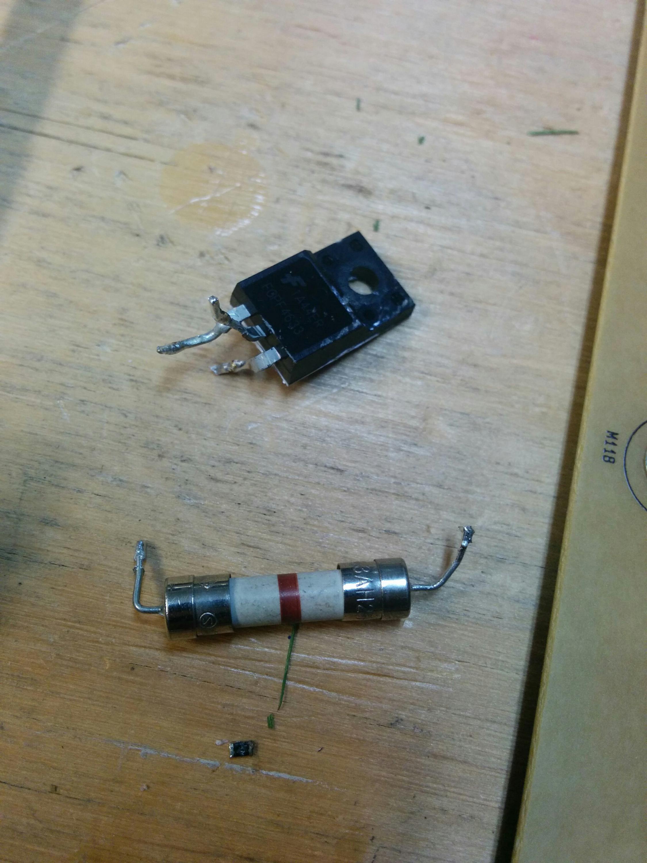

        Took out Q212 and the two burned resistors. Q210 and Q208 is no longer shorted. they stay open(read 1 on left side) when I touch the legs.
        where can I get 6.3ah250vp fuse replacement? (open fuse is blown fuse right?) Also, can the fuse holder be removed? they don't seem to budge. I had to unsolder the fuse holder but they still don't want to let go of the fuse.

          that's an axial mounted fuse, that's how they're made with leads.

          The other bits Allistair is referring to is that cluster of parts in that image I put up. you can see the drive cct

                  I can't be sure what the 4th item is but I'd check Q205,206,207 and D215,239 for short.
                  It might also be worth trying to cleanup those ICs in that drive cct and identify the part numbers.

                          For educational purpose, the drive cct is the lower right clusters in post #22?

                            I wonder why only 3 resistors when each has 2? anyway looking at your board it does appear just 2 will be needed.
                            And yes, drive cct as you stated and it was intentional when I cropped that to have that visible for reference so you had an idea what other bits to watch for.
