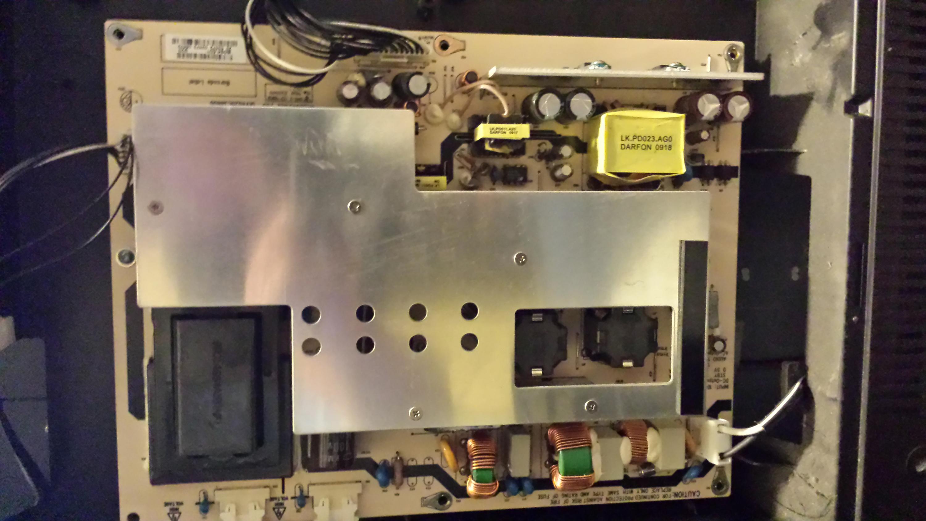

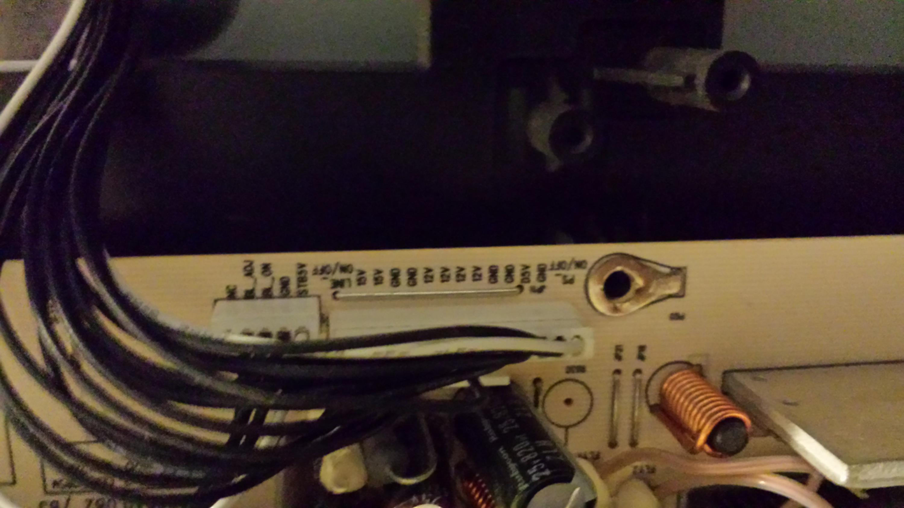

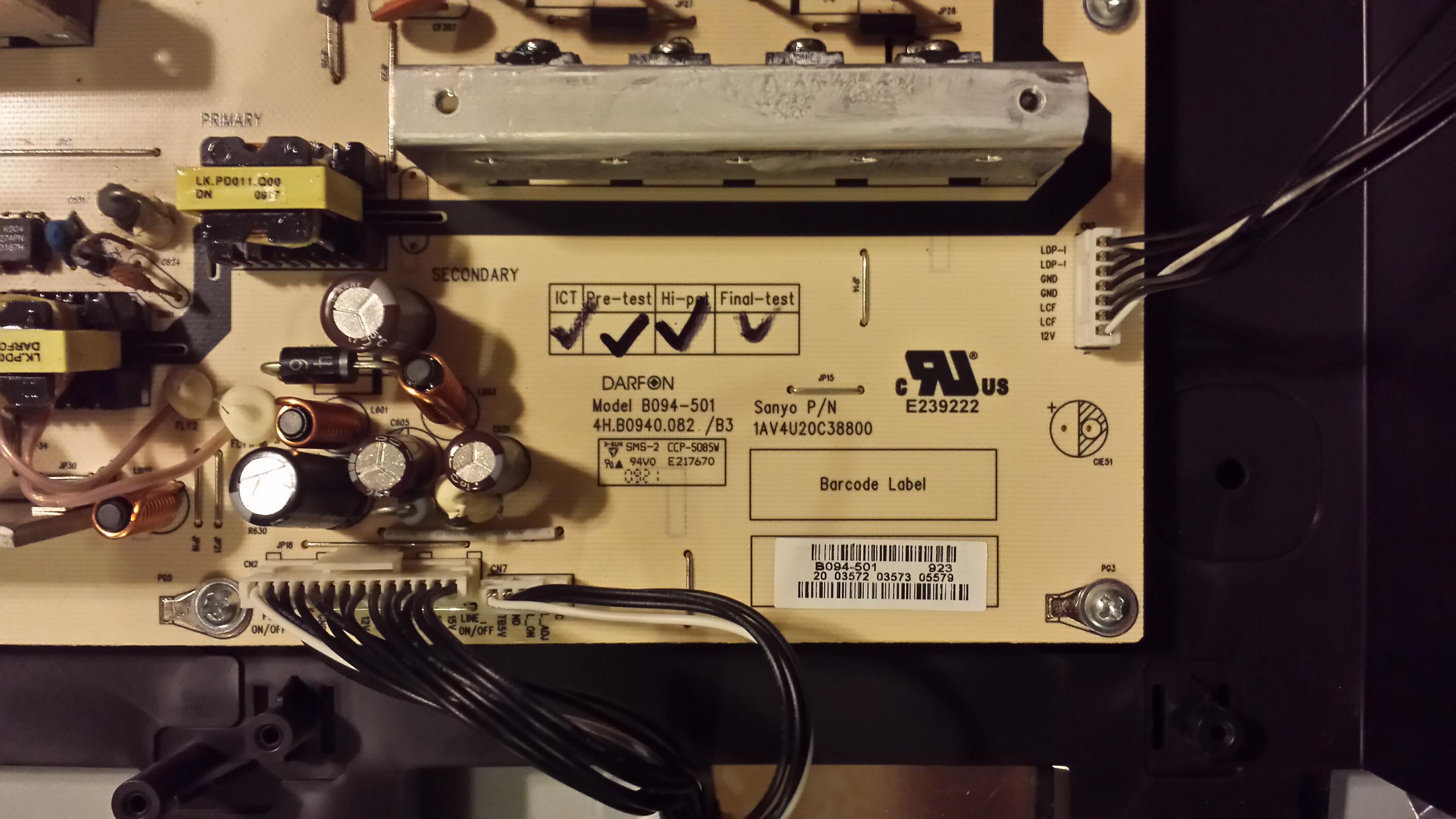

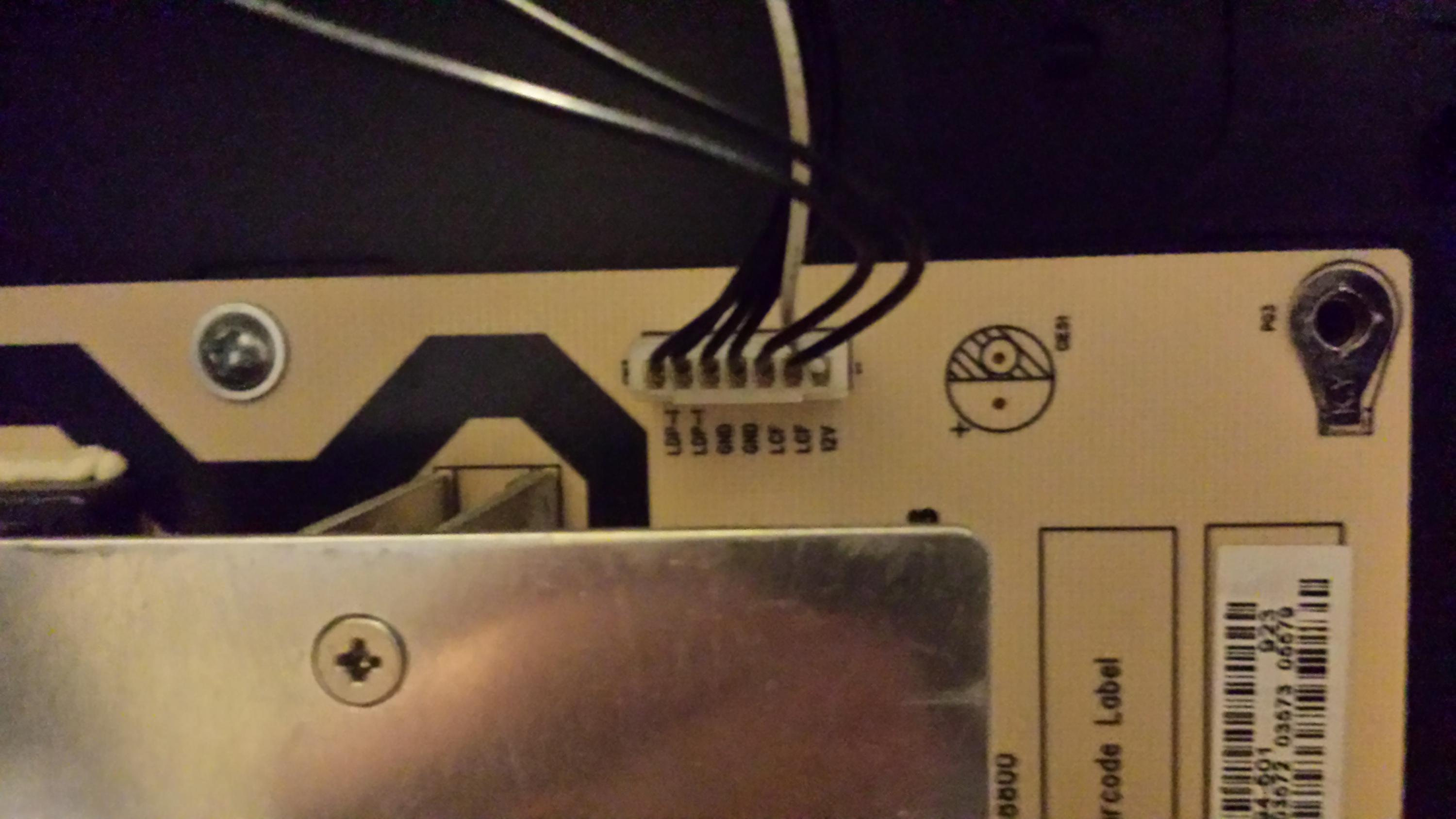

    Re: Sanyo DP46849 Backlight Issues

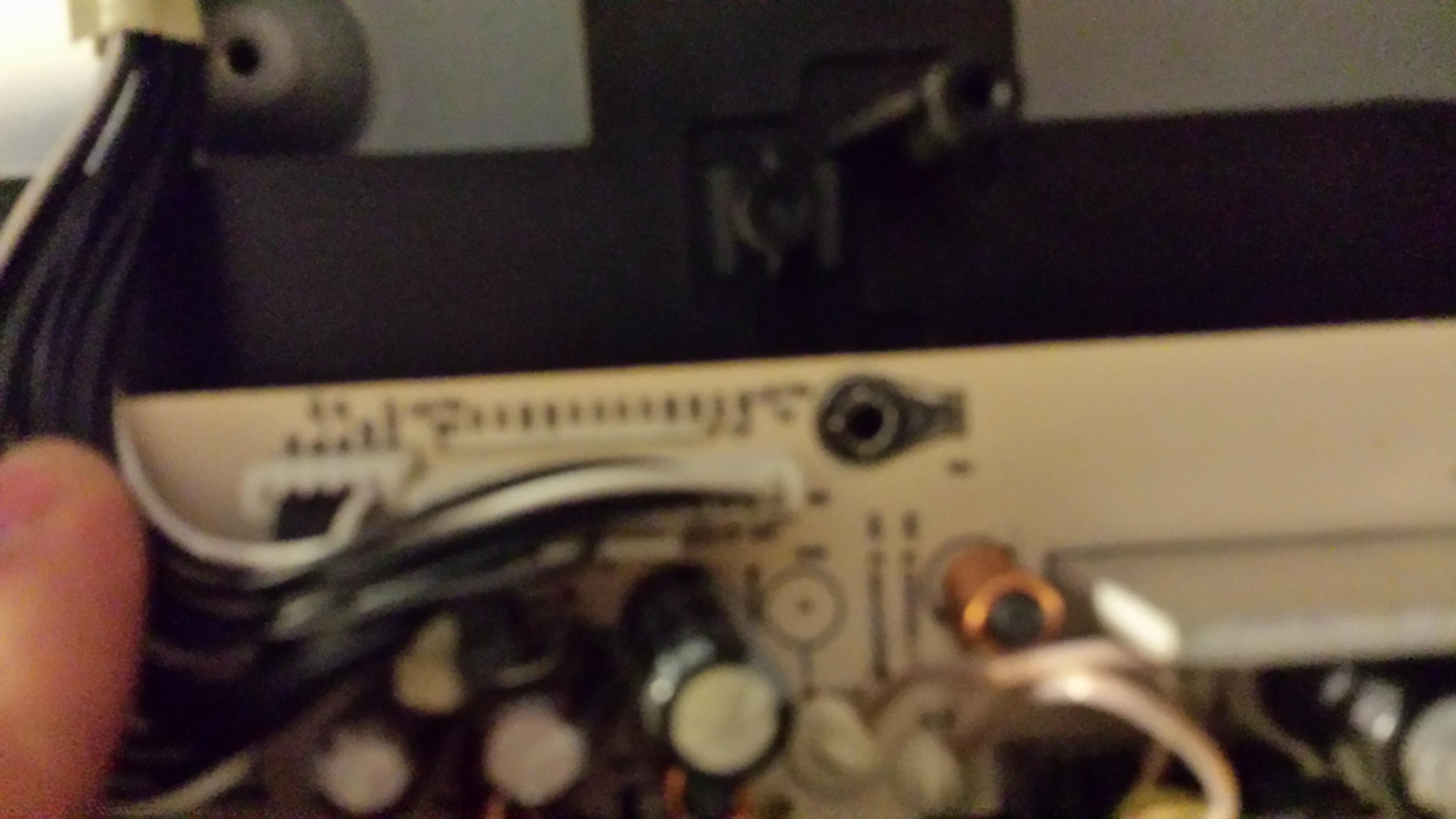

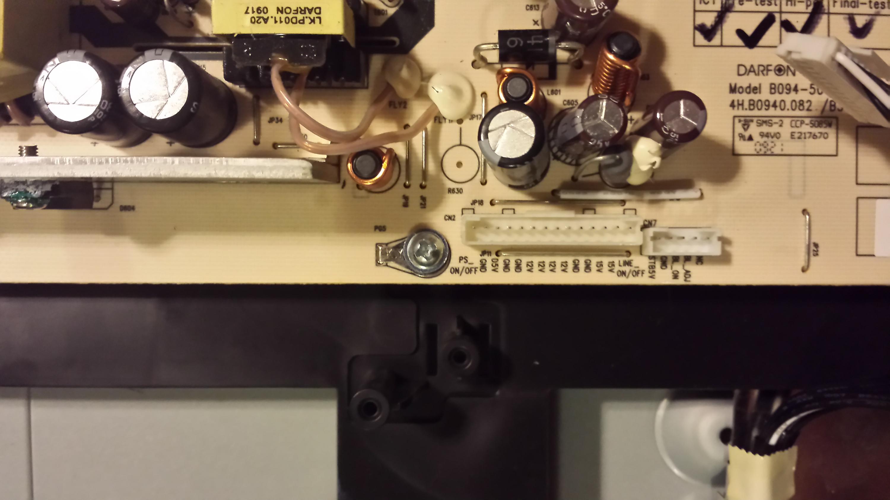

    Pictures of all boards and overall layout, Get a clear picture of the labels next to the connector going from the PSU to main.
    We will be going through some voltage readings with a DMM to see what is dropping out when you lose the backlights
      Ok, I work till 10:00, but took some pictures before I left. I'll take it apart more tonight and get more.

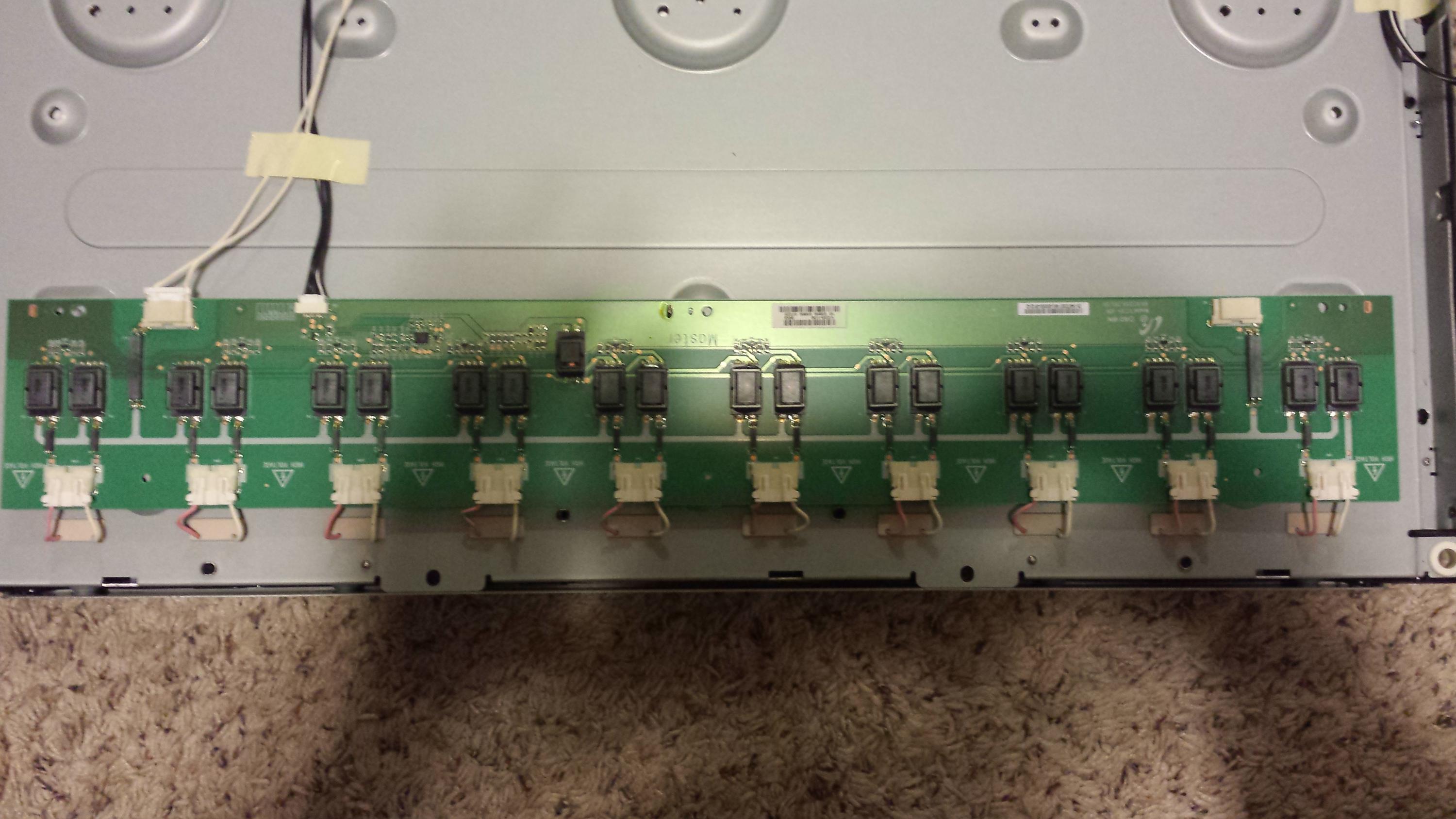

        Its almost impossible to test the invertor board on this unit. The Power Supply and Video Boards bolt to the back panel and the Invertor Board bolts under the panel. Testing while powered up is going to be a task. Taking new pictures now, because I realized that some were terrible.

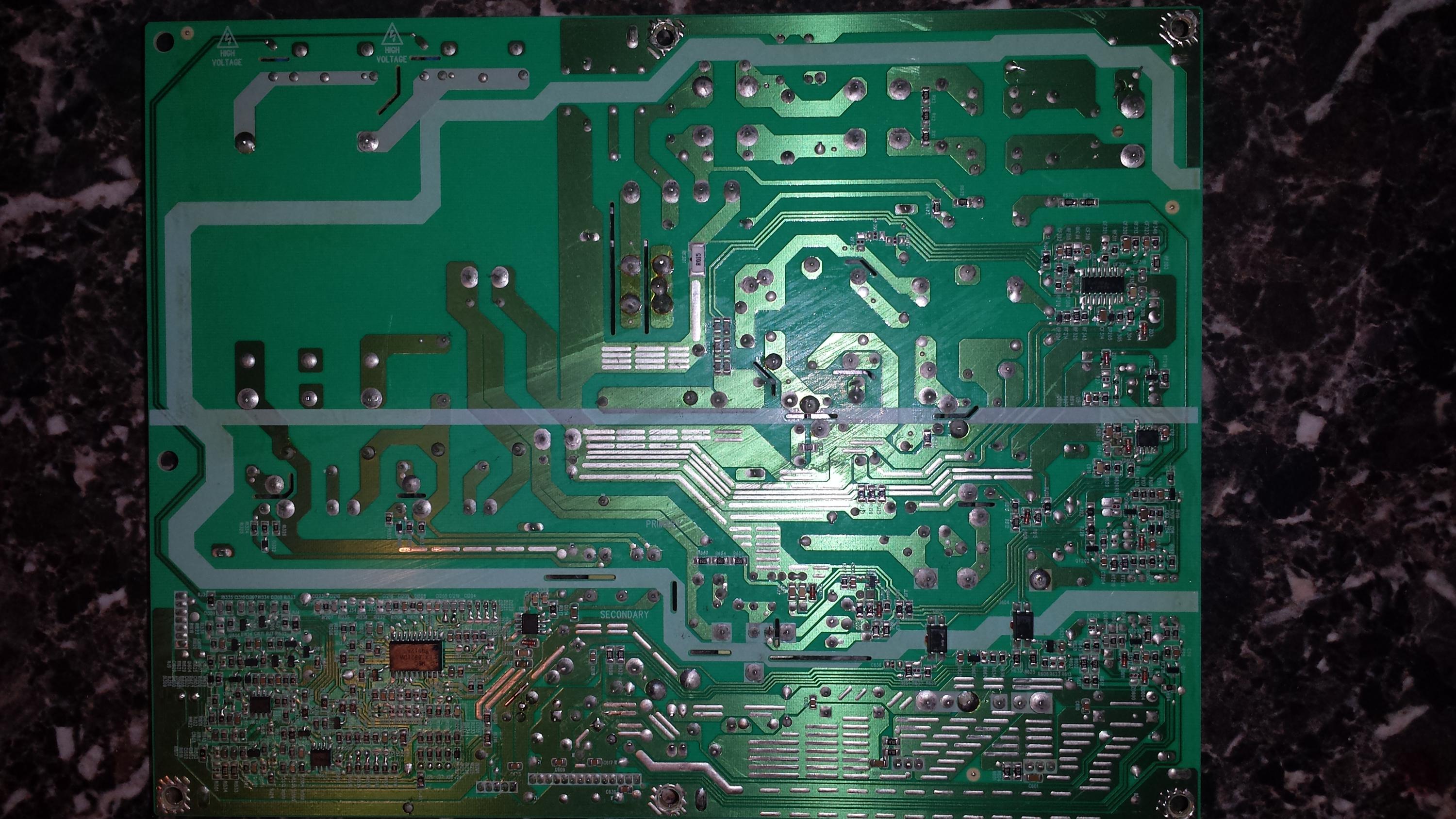

                    • Thorsbolt

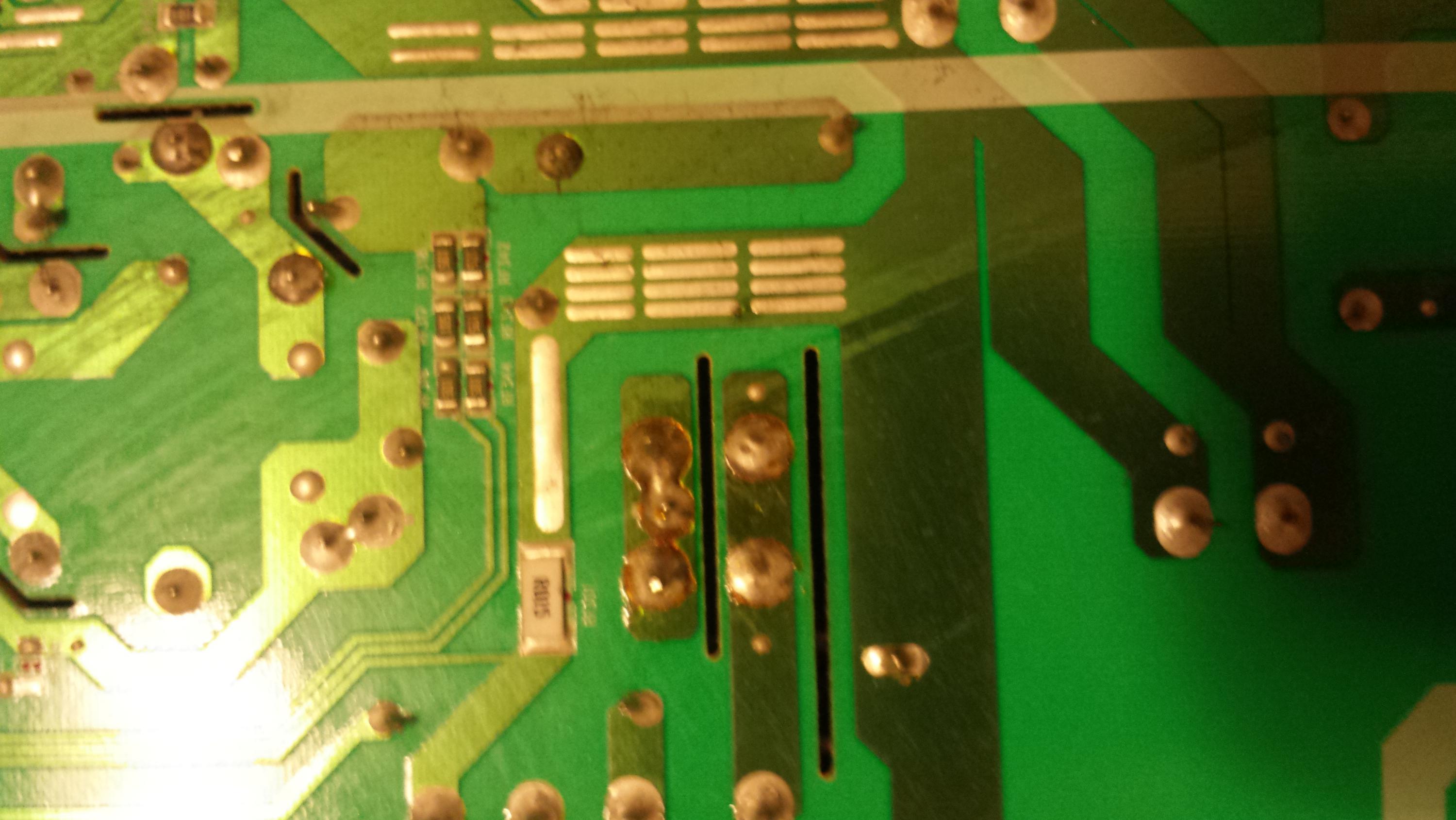

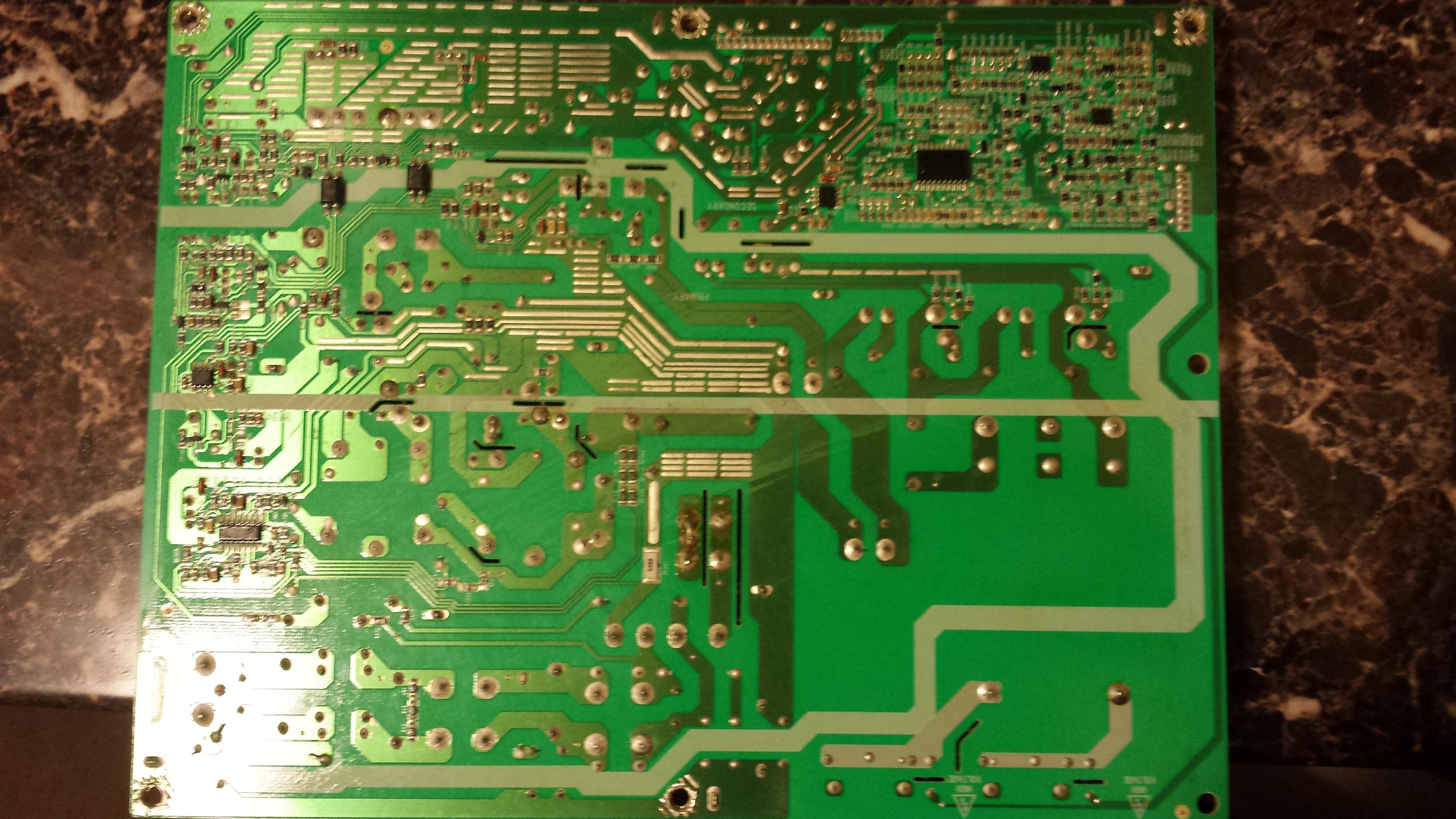

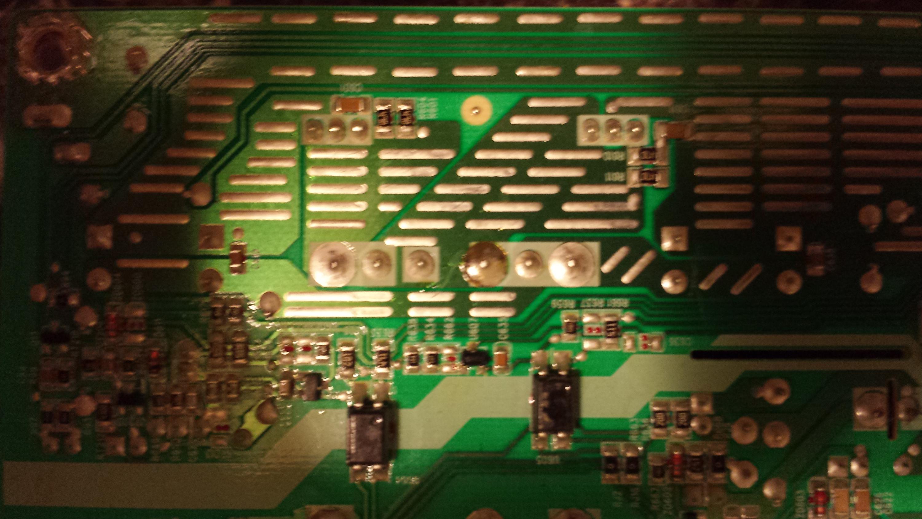

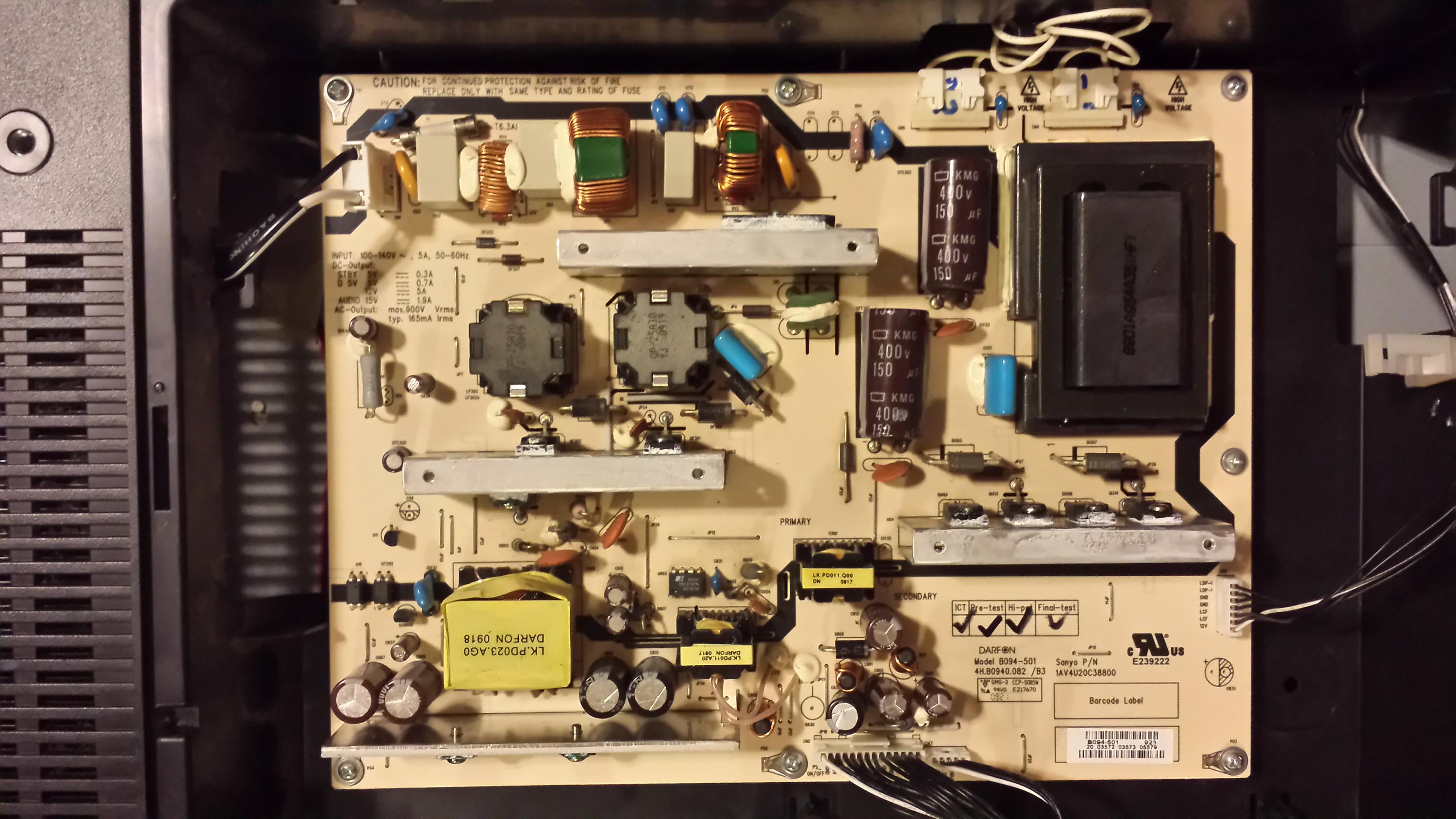

                      • Thorsbolt
                        • Mar 2015
                        • 22
                        These 3 are of the back of the power board. I see no compromised solder but I did see too slightly discolored spots.
                          • 31287
                          some bad joints there.
                          look for faint rings around the joints like a halo
                          • Thorsbolt
                            • Mar 2015
                            • 22
                            Well I can see alot of bad solder joints, what I also see is what look like something was spilled on the board. What should I use to clean it and should I focus on fixing all the solder joints or getting a new board?
                              • 31287
                              fix the joints and then clean the flux off with IPA
                              fixing joints costs nothing, so it's always worth a try.
                              • Thorsbolt
                                • Mar 2015
                                • 22
                                I fixed some solder and cleaned the board. TV still shuts down, but I am able to access the invertor now when it's powered up. Any further testing?

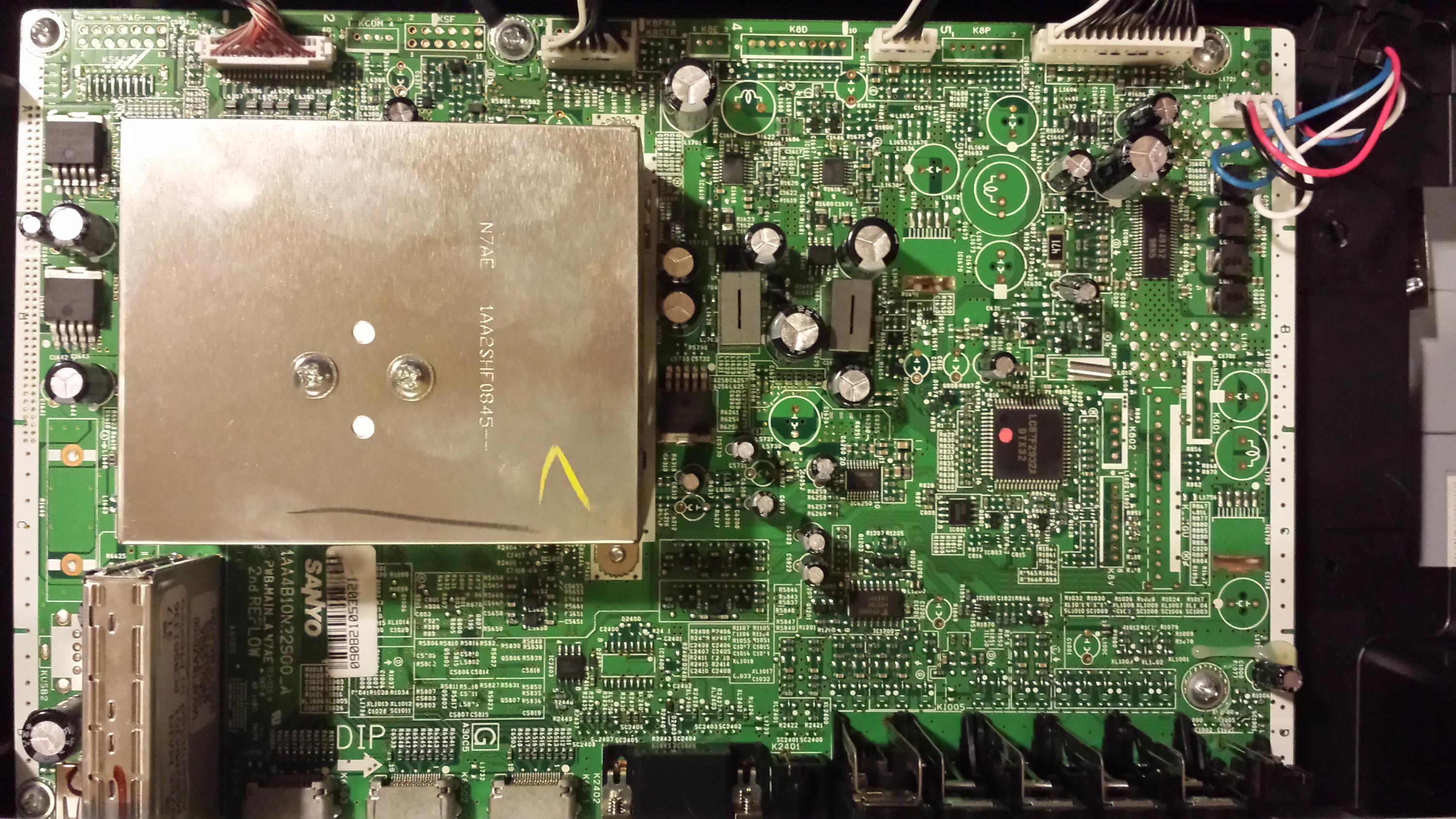

                                • Thorsbolt
                                  Also the three steel bars get exceptionally hot on the back of the power board. Like they'd burn you. I'm pretty sure the for heat dissipation. But should they get that hot?

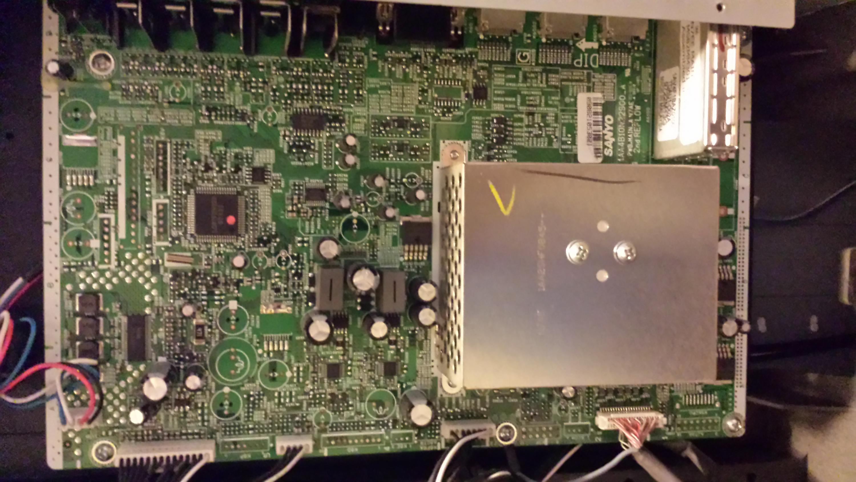

                                  • Thorsbolt
                                    • Mar 2015
                                    • 22
                                    I ran a very low CFM fan over different boards to keep them cool and found the Main Board beneath a heat shield is getting to hot and shutting it down. It seams a finned block of metal had afoam strip on it to protect the board... It was holding heat. I removed it and the TV stays on. I'm still monitoring it. I will send a picture.
