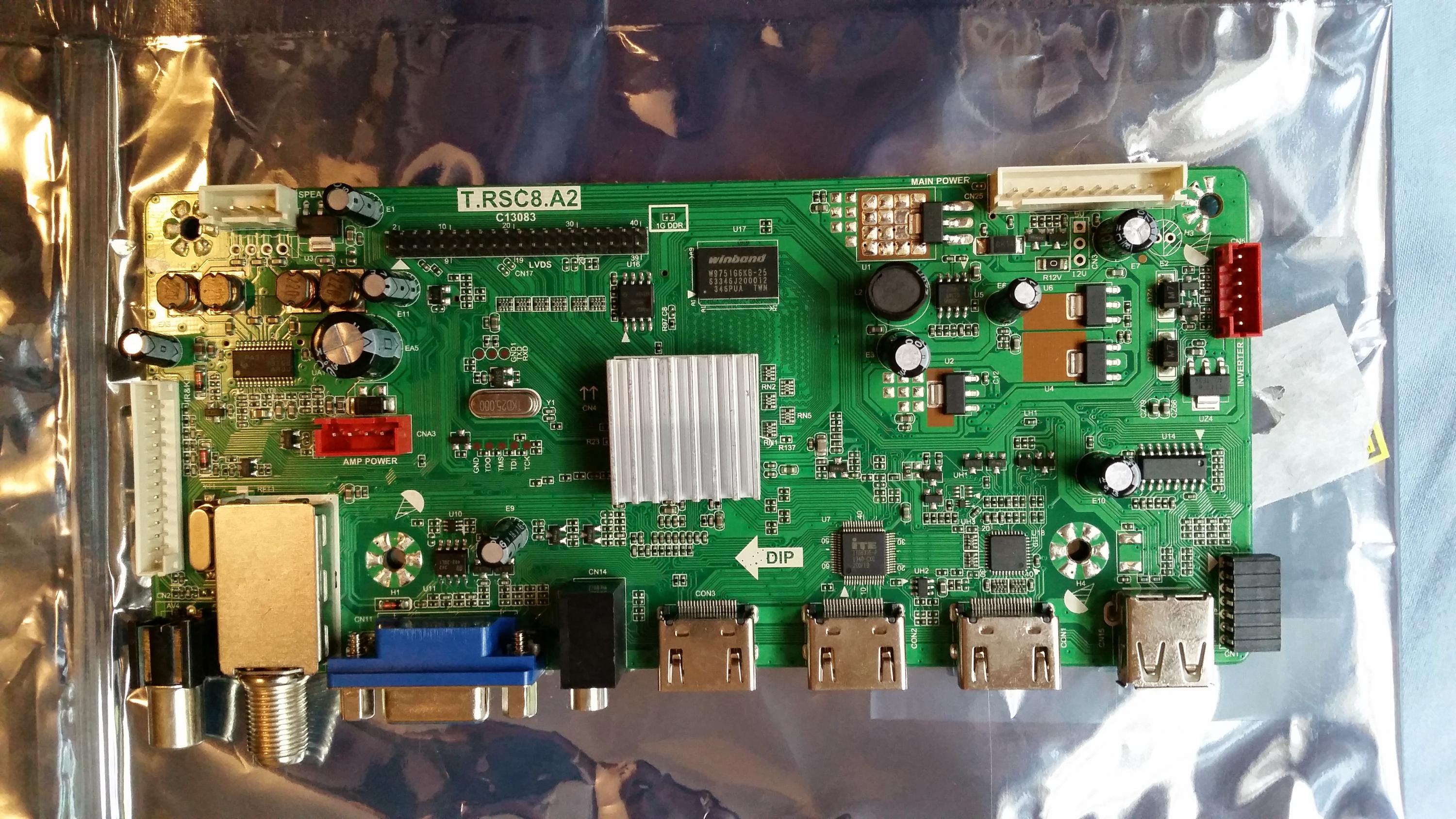

    I recently had 2 LEDs go out on the backlight resulting in no picture (however the LCD still had a picture when a light was applied to it) and I fixed the 2 bad LEDs (replaced them). Today I put the LED backlights in and they functioned correctly. However, now I don't get a picture on the LCD at all. All that comes on is the back-lighting. I've swapped out the PSU twice to double check.
    I'm looking for any possible ideas or something that may stand out.

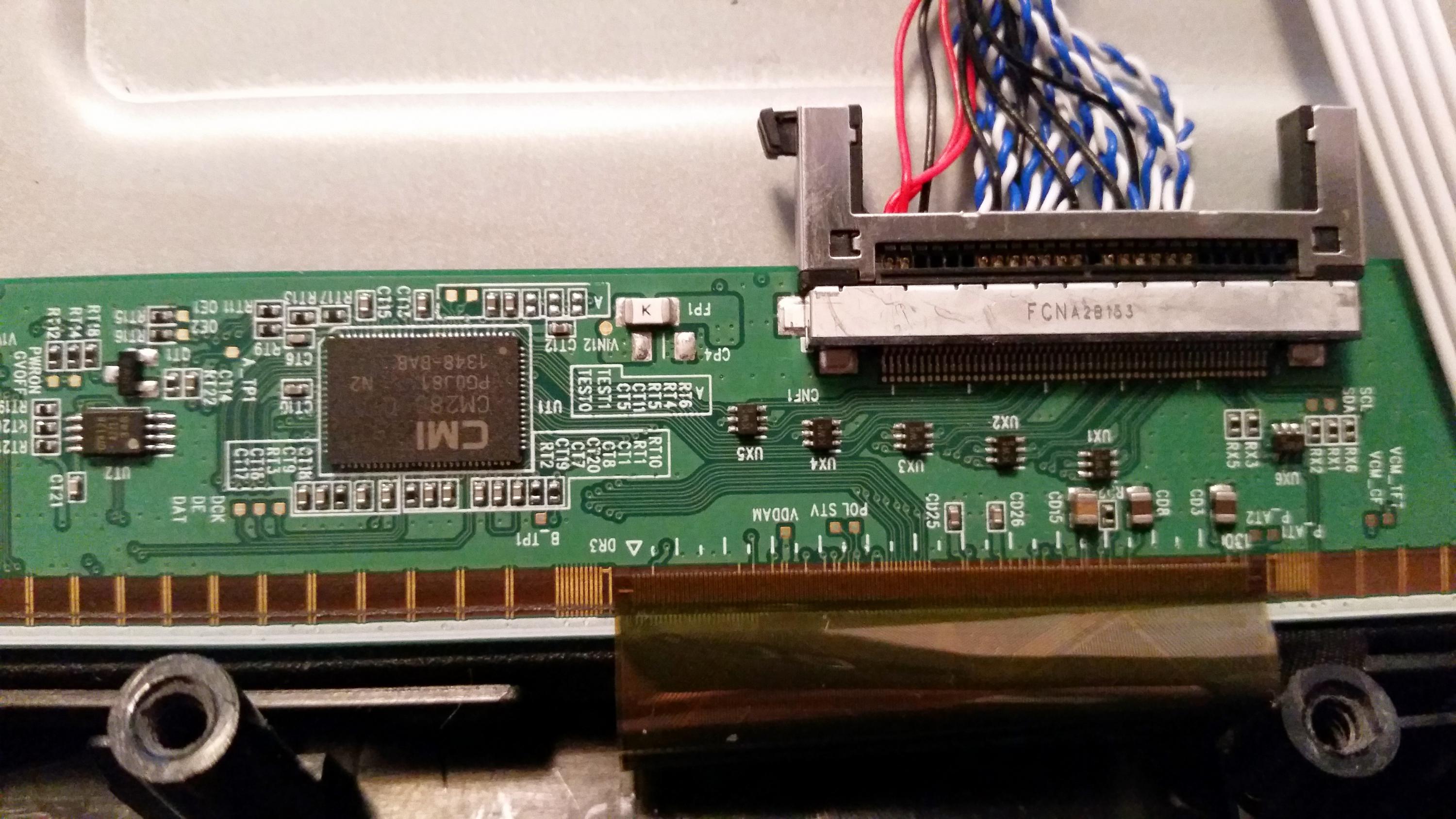

    Did you hook up the T-CON board, the ribbon cables, the LVDS cable back in place?

        Next thing then is to find out if you do have DCV on the SMD fuse (at both ends of the fuse) on the T-CON board with ref to the chassis GND.

          All cables have been triple checked. I checked the DCV at the SMD fuse and I get 13V on each end of it (picture 3).
          I'm just a little perplexed why it doesn't work now. I spent a great deal of time sourcing the correct LEDs for the back light and thought I was in the clear.
          I've attached photos for reference.

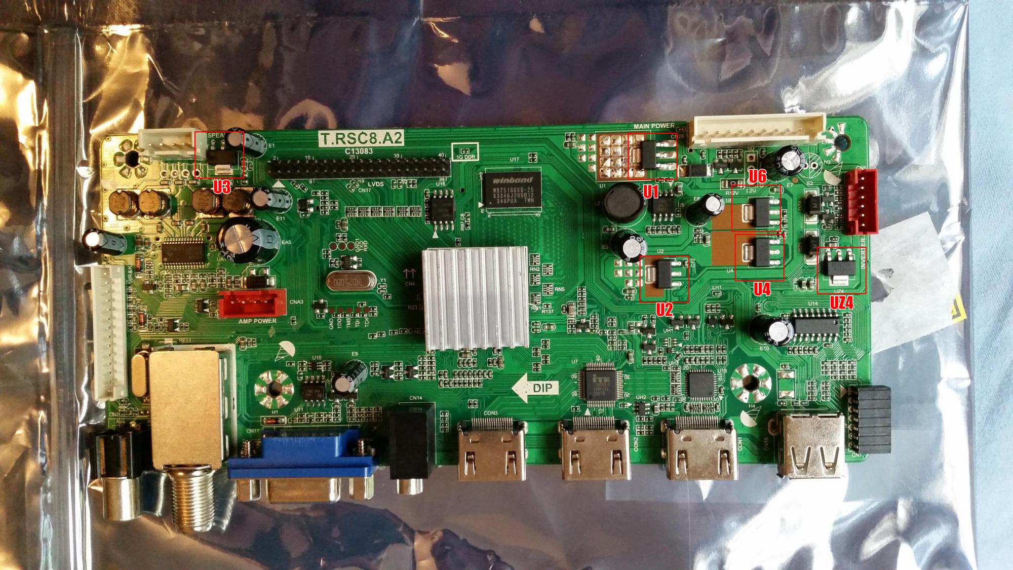

              check the voltage regulators, U2,U4,U6, on the mainboard.

                    Here are the readings of the voltage regulators. All I could find were generic datasheets for these particular ones.
                    Why would the LCD work before I replaced the back light LEDs and not now? Possibly just a coincidence?
                    U1
                    1117 B
                    AD 1E3K
                    pin 1 - 0v
                    pin 2 - 1.25v
                    pin 3 - 3v
                    U2
                    1117 B
                    33 0L3Z
                    pin 1 - 0v
                    pin 2 - 3.3v
                    pin 3 - 5.07v
                    U3
                    1117 B
                    33 0L32
                    pin 1 - 0v
                    pin 2 - 3.28v
                    pin 3 - 5.1v
                    U4
                    1117 B
                    AD 1E3K
                    pin 1 - 0v
                    pin 2 - 1.25
                    pin 3 - 3.28v
                    U6
                    1117 B
                    AD 1E3K
                    pin 1 - 0.58v
                    pin 2 - 1.82v
                    pin 3 - 3.28v
                    UZ4
                    1117 B
                    AD 1E3K
                    pin 1 - 0v
                    pin 2 - 1.25v
                    pin 3 - 3.8v

                      They look fine.

                          It could be a tab bond on the lcd that got damaged when you removed the screen to replaced the leds. Try flexing the panel slightly to see if any image comes up.
