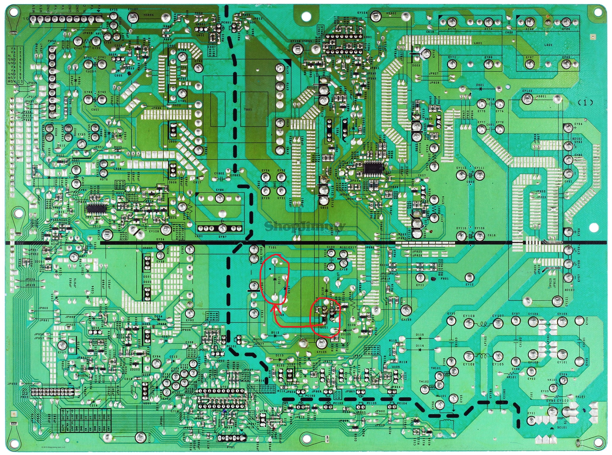

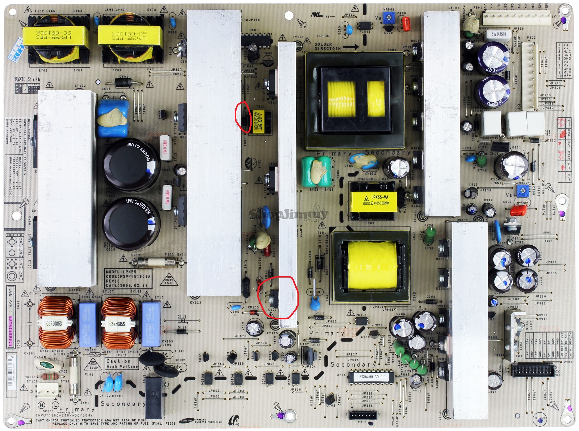

    I have uploaded a top and bottom view of the psu. I have circled a few components that I think are acting strange. On the top view I have circled an IC that i replaced from the kit I bought at shopjimmy. I have circled the bottom view as well. I have drawn a line along a circuit that, if desoldered, fixes the short. Moving down the line I removed the diode that is circled and it tested fine. After I resoldered the diode, the fuse was no longer shorted. However, when I went to screw the ic to the heatsink, the short came back. This makes no sense to me, but hopefully it will to you guys. Thanks for your time and help.

      is there a insulator pad/washer missing from the ic to heat sink?

        that ic appears to be a integrated fet and switching controller, did you install the entire repair kit? or just this single part? I would suspect those large transistors if your looking for a short (Q601, Q602, Q801, Q802)

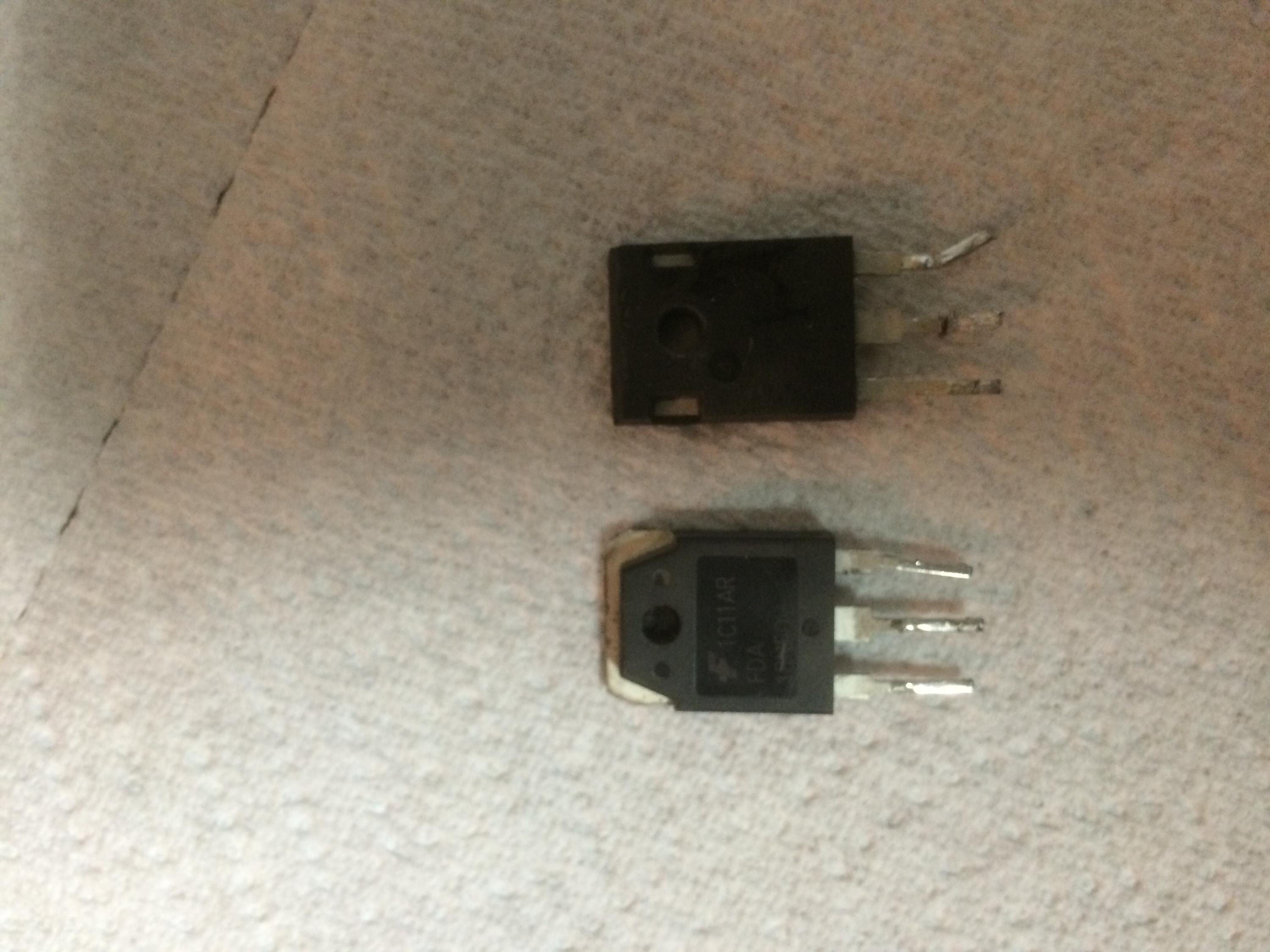

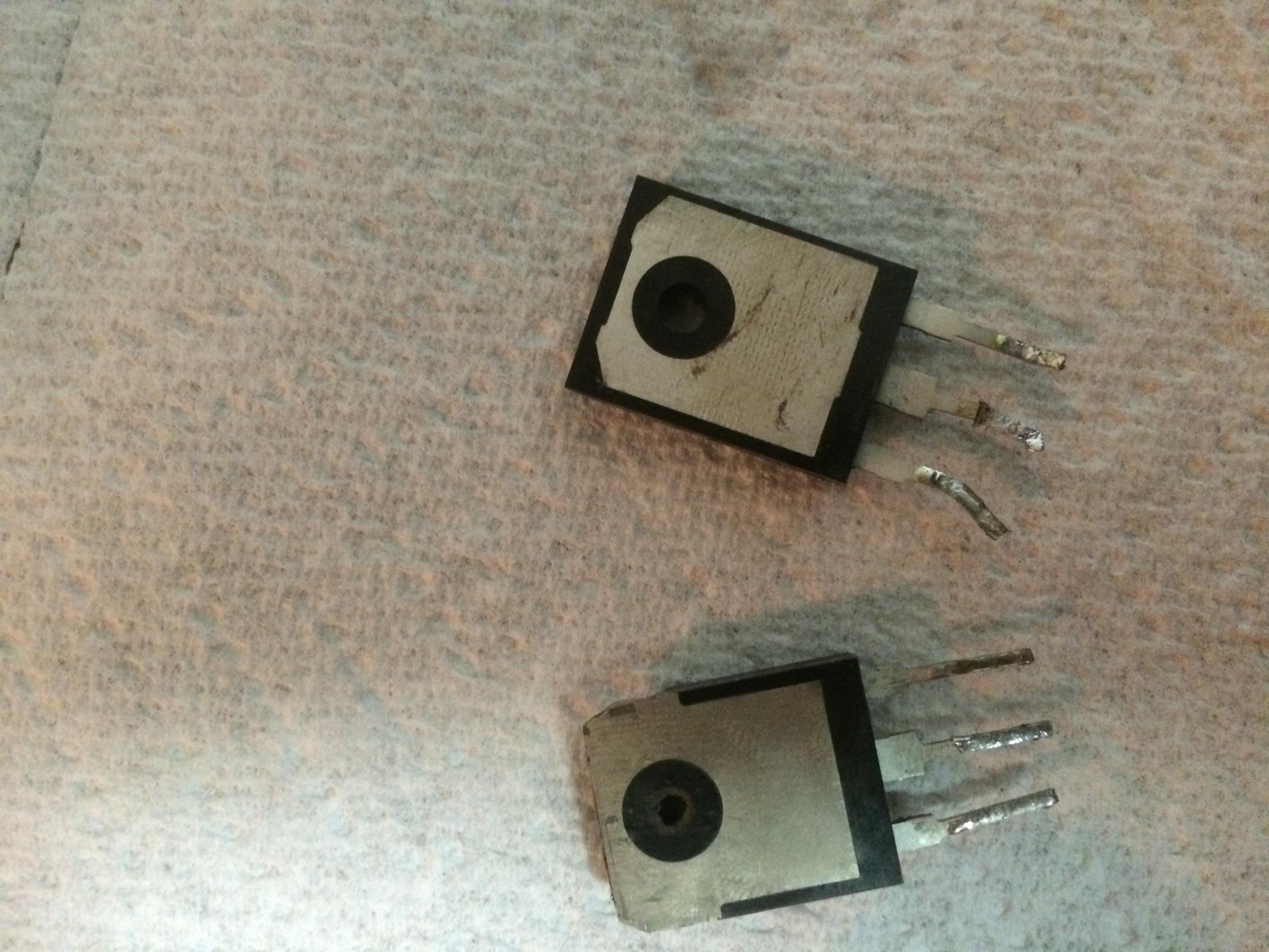

            "When I removed the resistors there was some tape that held them to the heat sink." Can we see the picture of this resistor? It sounds to me like the insulator sheet is missing.

              This is the front and back of two of the components that I removed. These both had the tape on the back.

                This is the front

                  They are not resistors, you need to put the insulator/thermal transfer pads back in place.
                  If you check the resistance between the center leg and the metal plate, it should show <1 Ohm.

                    I mistyped resistor. I haven't hooked it up since I replaced them. I just checked to see if the fuse was shorted. The thermal pads came apart when I removed the old transistors. You'd think the repair kit would have those with it. I guess it will be a learning experience one way or another. One of my philosophy professors once said "Sometimes knowledge makes a slow and bloody entrance".
                      Re: Lg 50pg20 secondary fuse grounded to heat sinks
                      They do not come with the kit because they are re-usable unless they are damaged, same for the mounting screws & nuts,
