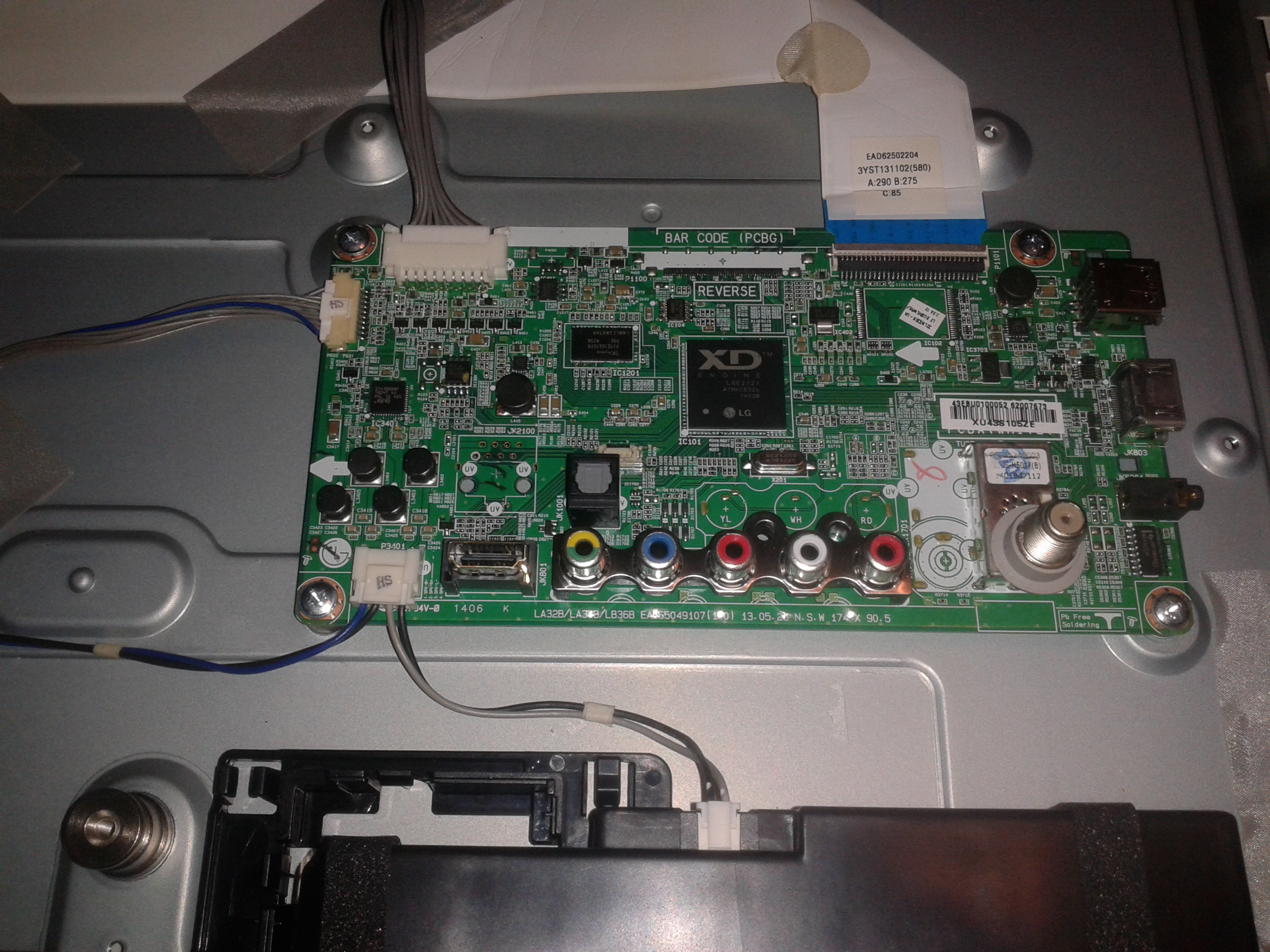

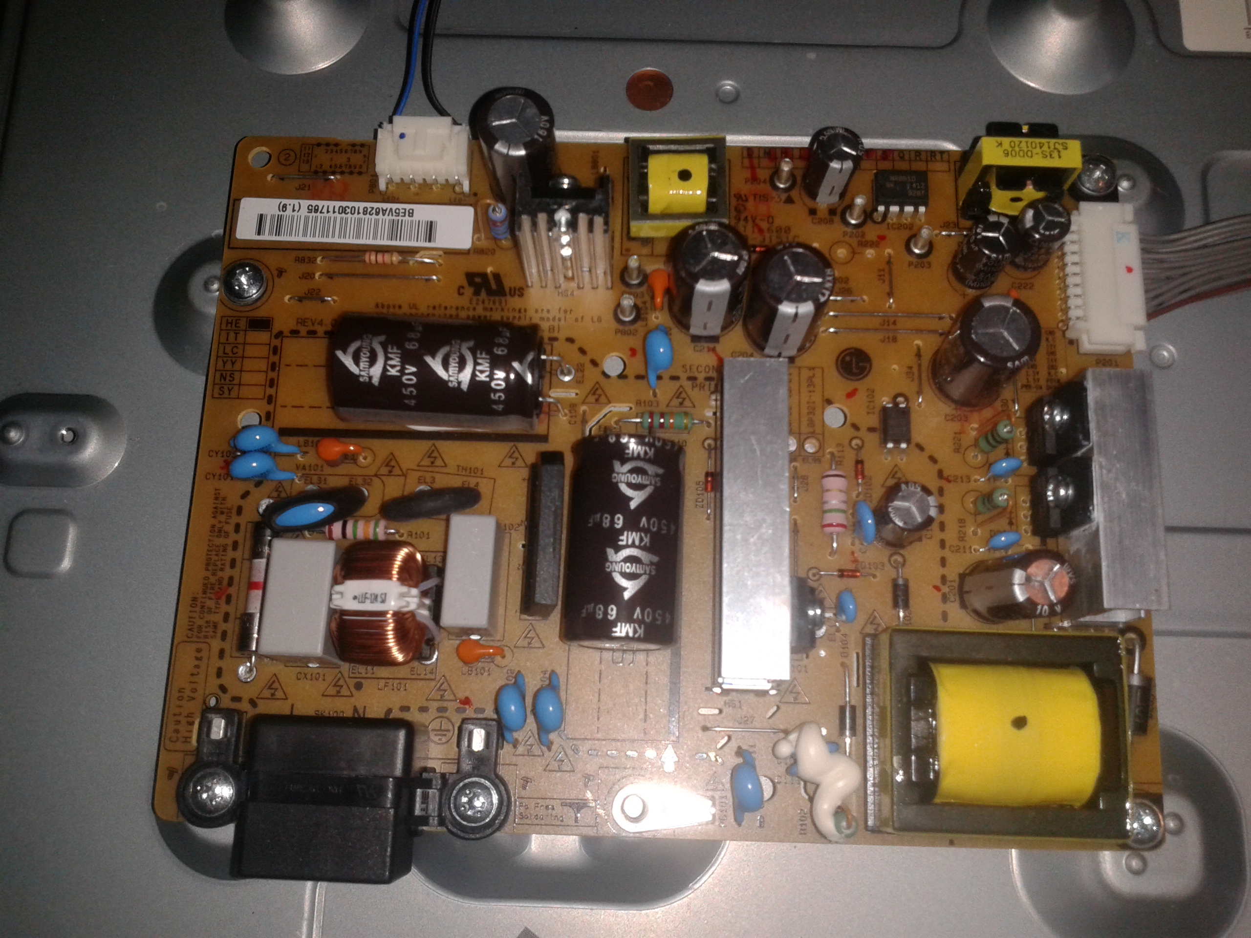

    hello all i new here
    i have an Lg 32ln530b-ua working on
    pb is eax64905001 2.6
    main is eax65049107 1.0

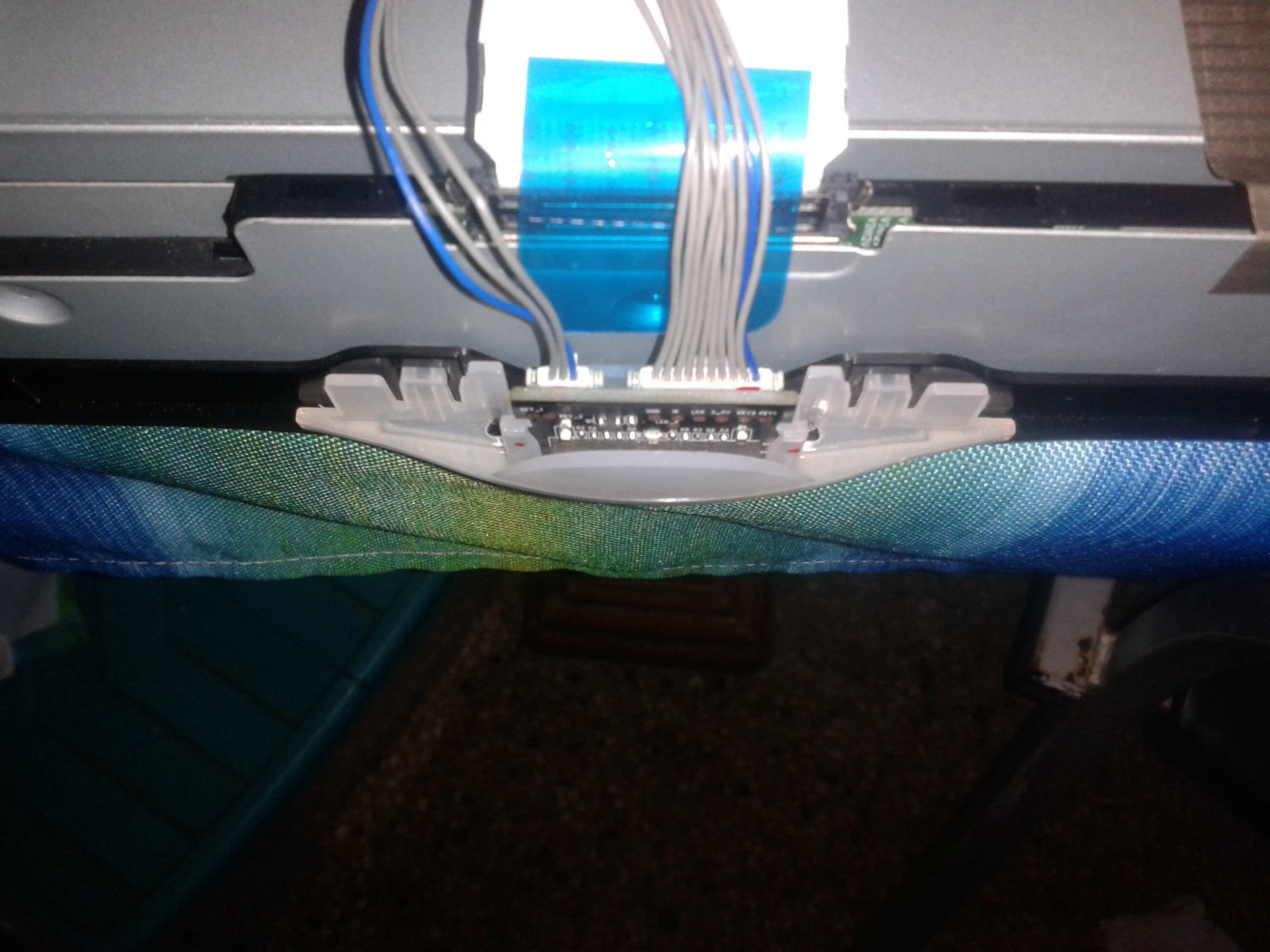

    my problem is this the stand by led are not working
    on the ir card i have the volts going to it 3.5
    when testing the pb i get 3.5 an 12 volts
    when pressing the on button nothing happens
    could this be the main
    could be the pb
    i replace both from shop jimmy an still same problem
    i get the volts 3.5 to stand by but no led light
    i have not replace the ir card
    how does the dry-on work on pb
    thanks brandon

    It could be the remote sensor and buttons.
    You could try jumping on then powersupply and backlight to rule out the powersupply board.

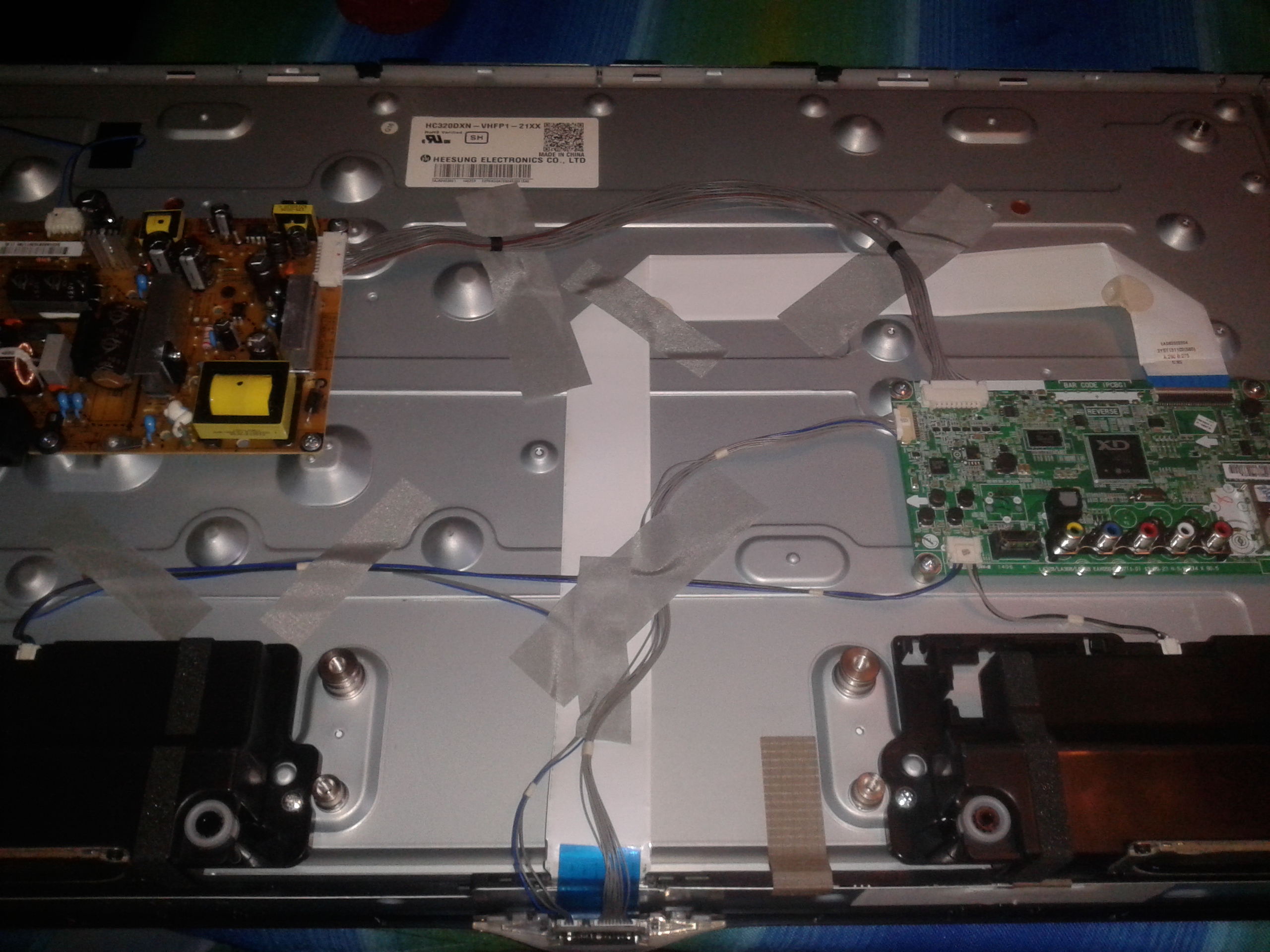

    upload some photos always helps.
      Re: Lg 32ln530b-ua
      Good clear pictures of the backside of the TV and the boards needed.

        Re: Lg 32ln530b-ua
        pics of set
        there is stand by volts going to ir card at bottom of set
        3.5 volts the led does not light up
        thanks for the help

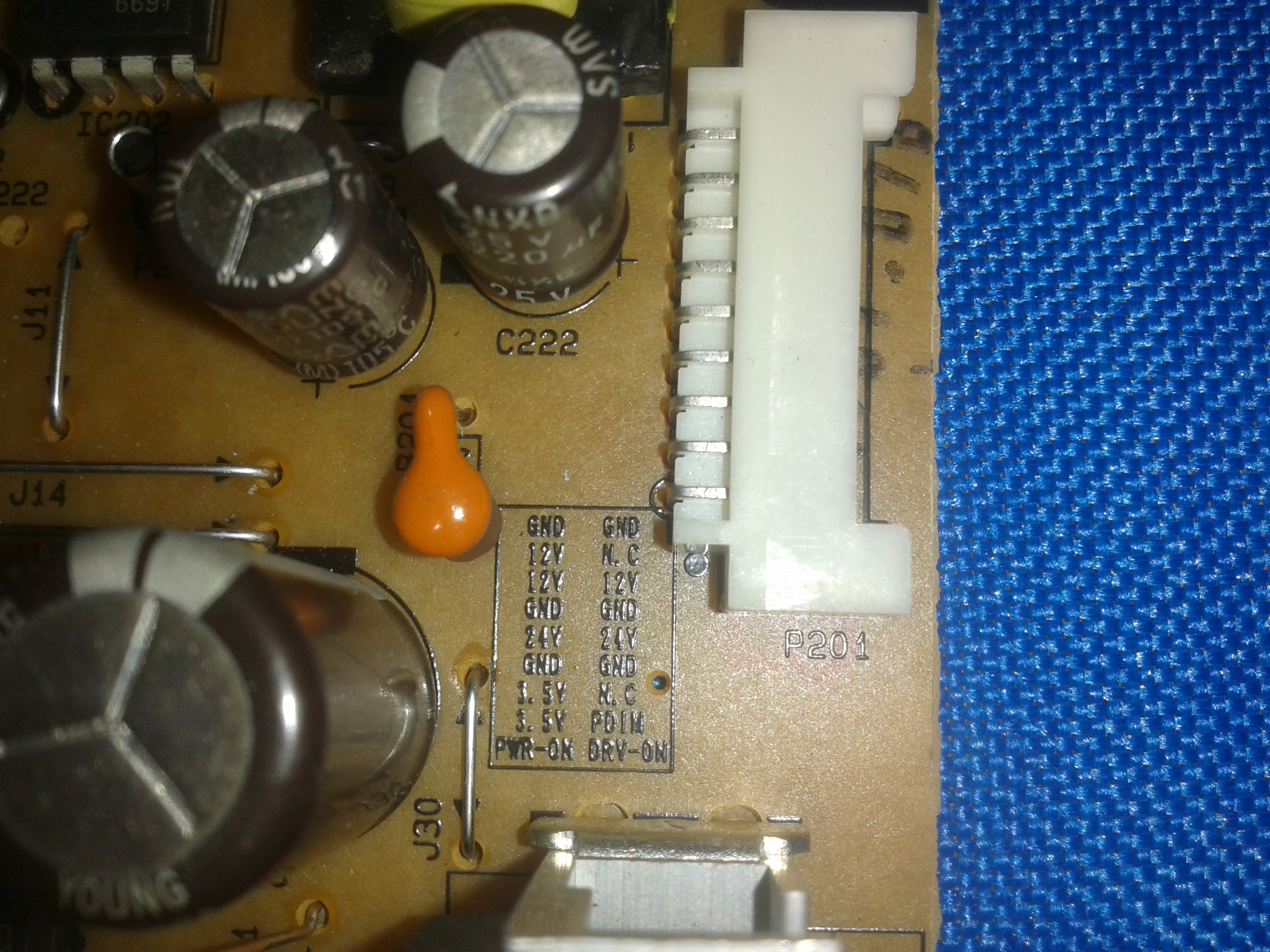

          Can you get a closer pic of the label near connector P201 please so we can read it.

            more pics for yall
            let you know volts coming out to
            ok nothing plug in to pb i get
            3.5 12 the no other ones
            the ps-on no volts should i test by putting ps-on to 3.5 right or ps-on to ground
            an whats dry-on for

              Re: Lg 32ln530b-ua
              i get 3.5 volts all the way just no led there is 3.5 at ir card

                3.3v to PWR-ON with a ~500ohm resistor then check voltages
                DRV-ON - Drive ON for backlights

                  ok ps-on jump get 3.5 12 volts
                  the 24 is there for an sec them i remove probe an back its there for an sec then gone
                  i removed all plug an retest same out come 3.5 12 no 24
                  i uesd dirffient ground points same out come
                  thanks for the help ALL OF YOU

                      ok here what i got so far jump ps-on an drv-on
                      i get back lights still no 24 volts
                      so what i say is the pb is not working right
                      now i have to trace down 24 votls to see why
                      i think this is right

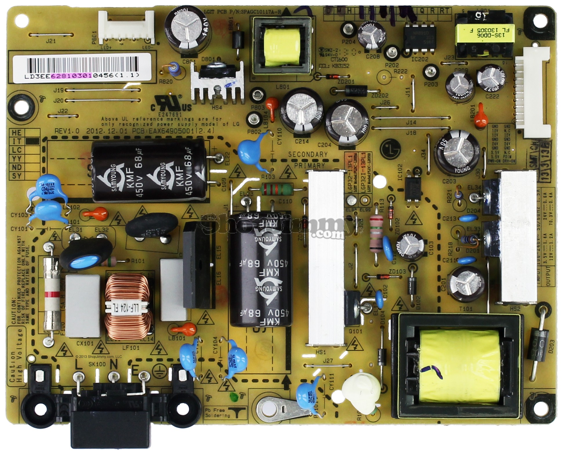

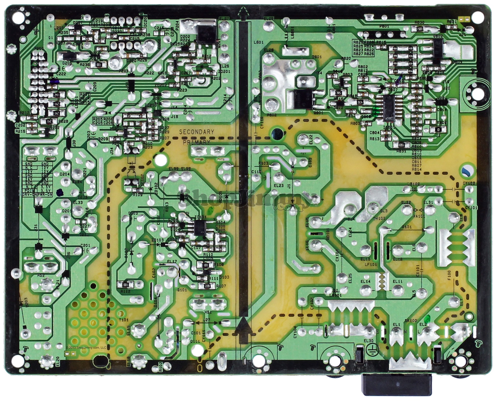

                        Re: Lg 32ln530b-ua
                        3.3 is generated by Diode D203, C201, LB201, and C209 form the Pi filter for the 3.3V. Please verify.
                        The 12V output is generated by buckconverter IC202.
                        Check the DCV on the two legs of the filter caps C203, C204 to see what you have, you should have about 24VDC which is fed to the backlight boost converter circuit to drive the LEDs.
                        The electronics switch SMD Q201 is turned on by the PS-ON to supply the Voltage to run the 12V buck converter Power supply IC202 and also feed the 24V output connector.
                        So for you to have 12V out put, switch Q201 must be working to supply 24V to run the 12V switching power supply.
                        Photo supplied by Shopjimmy.

                          no 24 vdc it there for an sec when i test it it reads13-20 for an sec then goes
                            Re: Lg 32ln530b-ua
                            But the 12V stays on? this done with PS-ON pin stays connected to the 3.3V pin through the resistor and no cable connected to the main board, right?

                              Re: Lg 32ln530b-ua
                              Can you also list the names of each pin and reading please so it makes a little more sense as to where you are testing these voltages.

                                Re: Lg 32ln530b-ua
                                yes 12 stays on with ps-on jump
                                yes testing with no cables just the powerboard
                                i get 3.5 12 an 70 for backlights no 24 i get 24 for an sec seems like when load down it goes away

                                    Can you list the connector pins P201 like this
                                    GND = 0v
                                    GND = 0v
                                    12v = 12v
                                    N.C = 0v
                                    12v = 12v
                                    etc etc
                                    Looking back at the initial posts.... You say you had the 12v present at P201 before jumping the PS-ON signal with the main disconnected??
                                    How are you testing the voltages?.. Red to pin Black to chassis?

                                        Re: Lg 32ln530b-ua
                                        ok
                                        gnd=0
                                        3.5=3.5
                                        12v=12v
                                        24v=none
                                        70v backlight = 70volts
                                        done with ps-on jump
                                        the 24 is there for an sec then gone when i put probe to it it is there but does not stay unload
