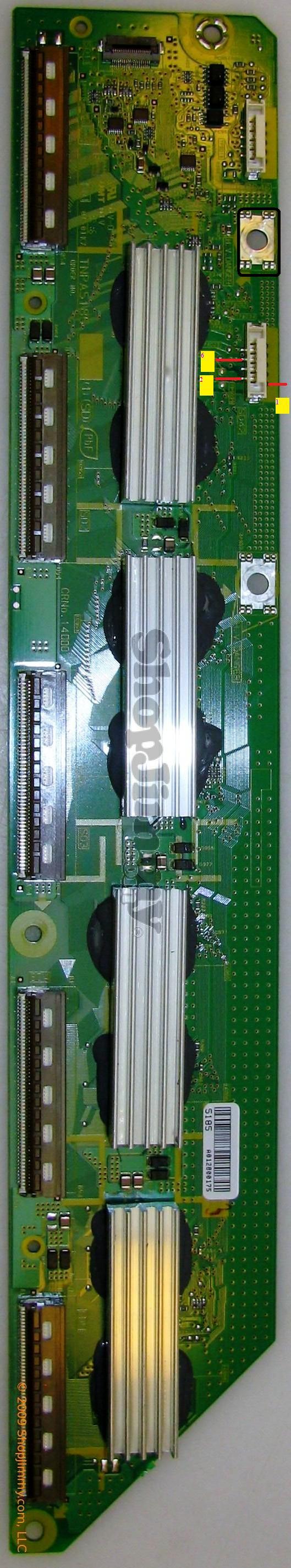

Panasonic tc-p65s2 dead 10 blinks
  • rageed
    • Apr 2015
    • 13
    Hello everyone I have a Panasonic that I am attempting to repair, when plugged in I can hear 2 relays , then nothing other red Led on front blinks 10 times , then repeats ,
    from what limited info I can find I believe that trouble points to the A board .
    Looking for any advice anyone can give
    thanks in advance

    you're going to have to take the back off and start isolating items to narrow it down.
    10 blinks could be just about any board. SC board comes to mind. Try disconnecting sc2 and see if it goes 7 blinks.
    avoid reconnecting the cable for 5 min as there can be 200v residual with the TV off.

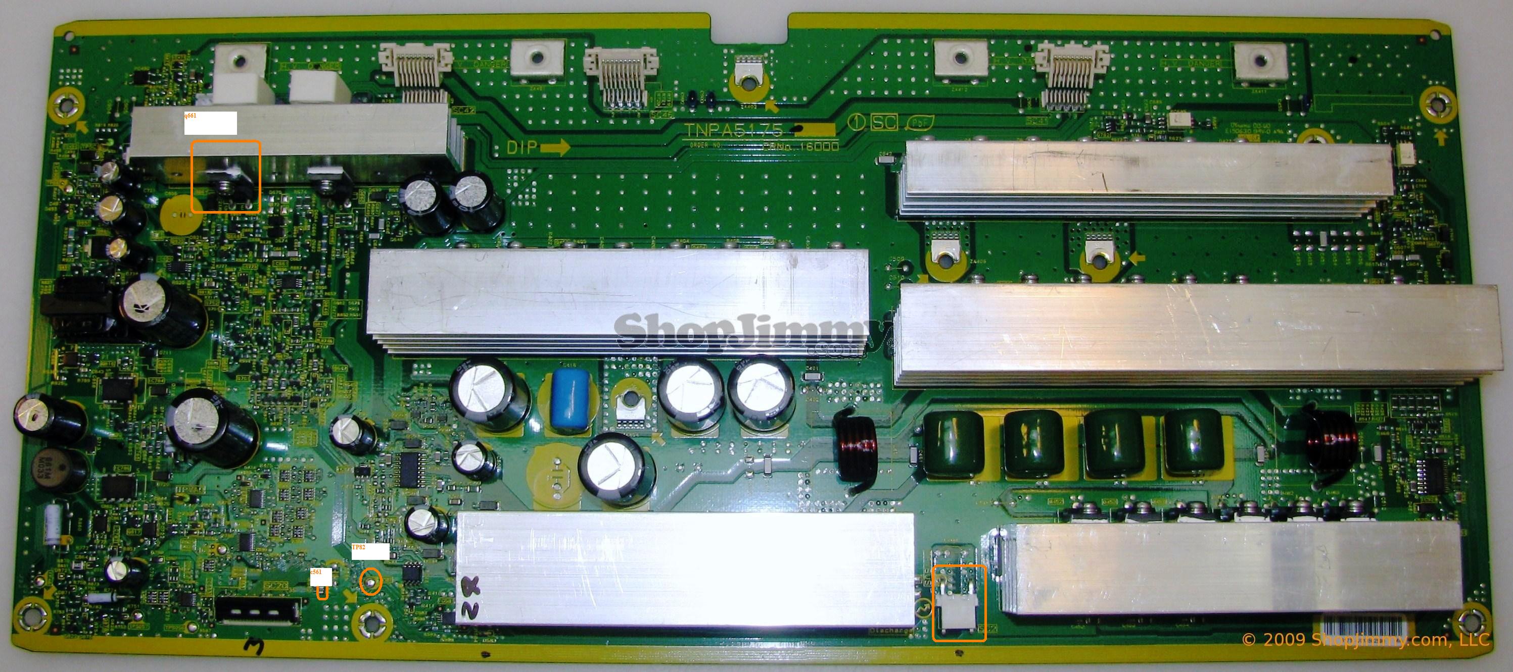

              Re: Panasonic tc-p65s2 dead 10 blinks
              Originally posted by rageed
              yes good multimeter
              tis good it's good
              expect shorted components
              try Q661 and see if shorted(there'll be others)
              measure resistance
              across SC2 pins.
              Then resistance, these are near SC20 ribbon connector
              TP82 - a gnd point on the board
              across c561 or TP16,17 - gnd(are underside, c561 is easier)
              On the buffer boards measure these, highest resistance up 6 meg with respect to the gnd plate. 1 phot is SD, other is SU, different pins.

                  quick check shows Q661 shorted and when looking closely Q423 is actually blown apart

                    So looks liker the Sc board is where most all troubles reside , would you suggest replacing whole board or replacing components ?? and where to get board ??
                    • tw2005
                      • Oct 2011
                      • 6458
                      not often youi get to seee a blown apart IGBT on these but I think you found your 10 blink.
                      Buffer tests , will need the values. This is so you know where you're at as far as repairs needed. getting parts for a 65" could be challenging.
                      repairing the board, achieveable or send it to Modus for about $100
                        What part number is stamped on Q661 and Q660?
                        • rageed
                          • Apr 2015
                          • 13
                          Q661 part # is RJP56F4Axxx082p shorted E to C
                          Q660 part # is RJK6026xxx0617
                          I will have to pull Q423 can not read part #
                          sorry I am new to this forum where/who is Modus repair ?? contact info

                            also i tested Q425,Q424, Q422,Q421 D 421 are all show shorted on board is this normal ??
                            • newtothis
                              • Mar 2013
                              • 1556
                              • england
                              Test them out of cct you will most likely find they aren't all shorted.

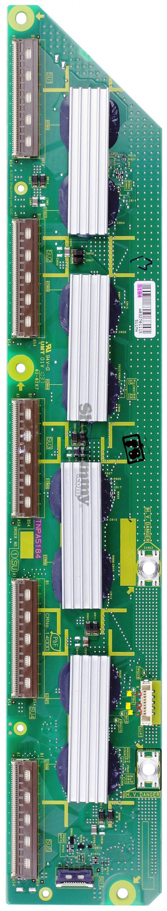

                                  Check the buffers too BTW, Ground the black probe in continuity mode (beep) and run the red down the buffer ribbon connections... If any beep that corresponding IC is shorted

                                    prefer you resistance check as per the photos, wiil need the values you get
                                    Often i find all DG402RP go short but that is on the smaller boards which usually only have 2 in parallel, you may get lucky. usually the diode survives.
                                    i would not pull the board apart unless you intend to repair the whole board yourself otherwise send complete to Moduslink PTS.
                                    there's normally a bunch of smaller SMD stuff that needs doing as well
                                    http://www.moduslinkptstvboards.com/TXNSC1MAUU/
                                    repair/return option

                                      finally able to get back to this !!! thanks again Tw2005 for all your great help !! just want to clarify some points before i send SC for repair.
                                      summery of where i am in respect to this tv.
                                      1) SC board is faulty plan on sending to Moduslink for exchange/repair
                                      2)wanted to ensure that SD and SU boards are not faulty , I am going to check that none of the pins on the ribbon cable are shorted to ground, but I wanted to ensure that I am talking about correct pins/ribbon cable.
                                      these are the cables that connect SD/SU boards to SC board correct ?? Currently I have Sc board removed and ribbon cable between SU and SD disconnected, I see pins on connector SD 46 (pins 3,5,7) are shorted to chassis ground(screw fastening board to chassis), rest of pins are at 30 Meg or so
                                      Faulty SD board as well as SC ??
                                      thanks
