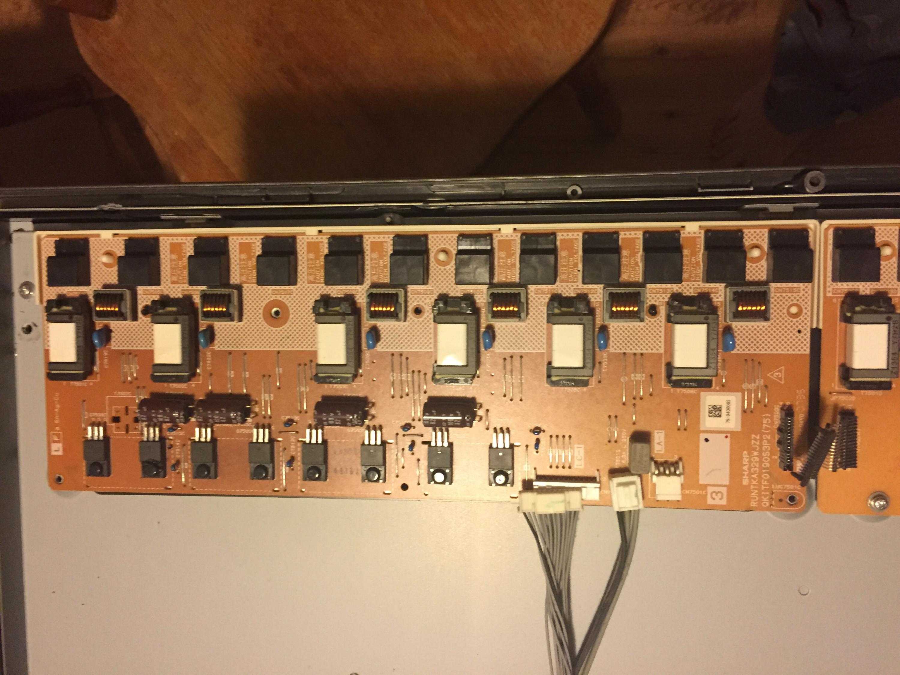

      Can you please show us the pictures of the black sockets on the board and how it connected to the CCFL ends?

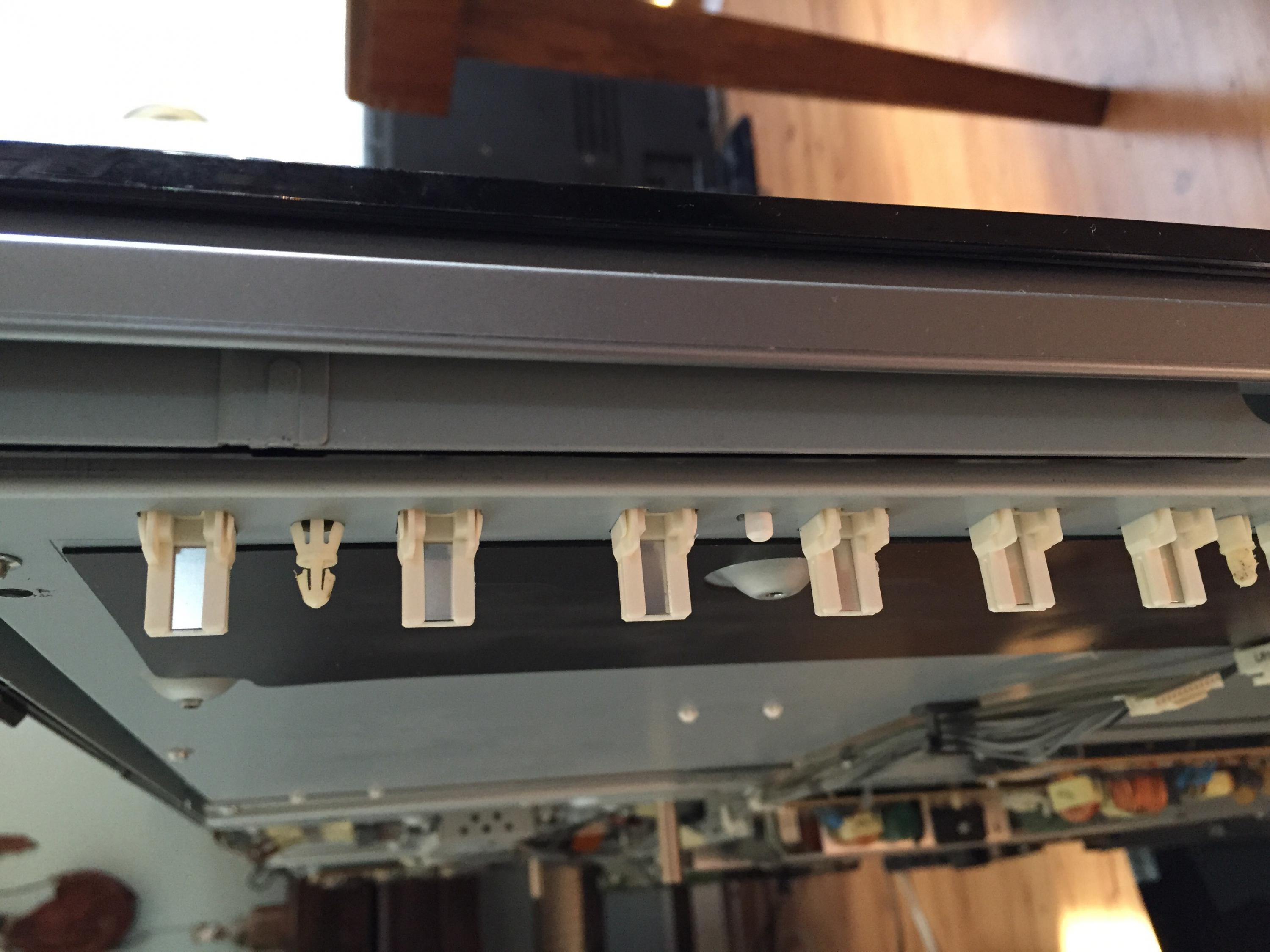

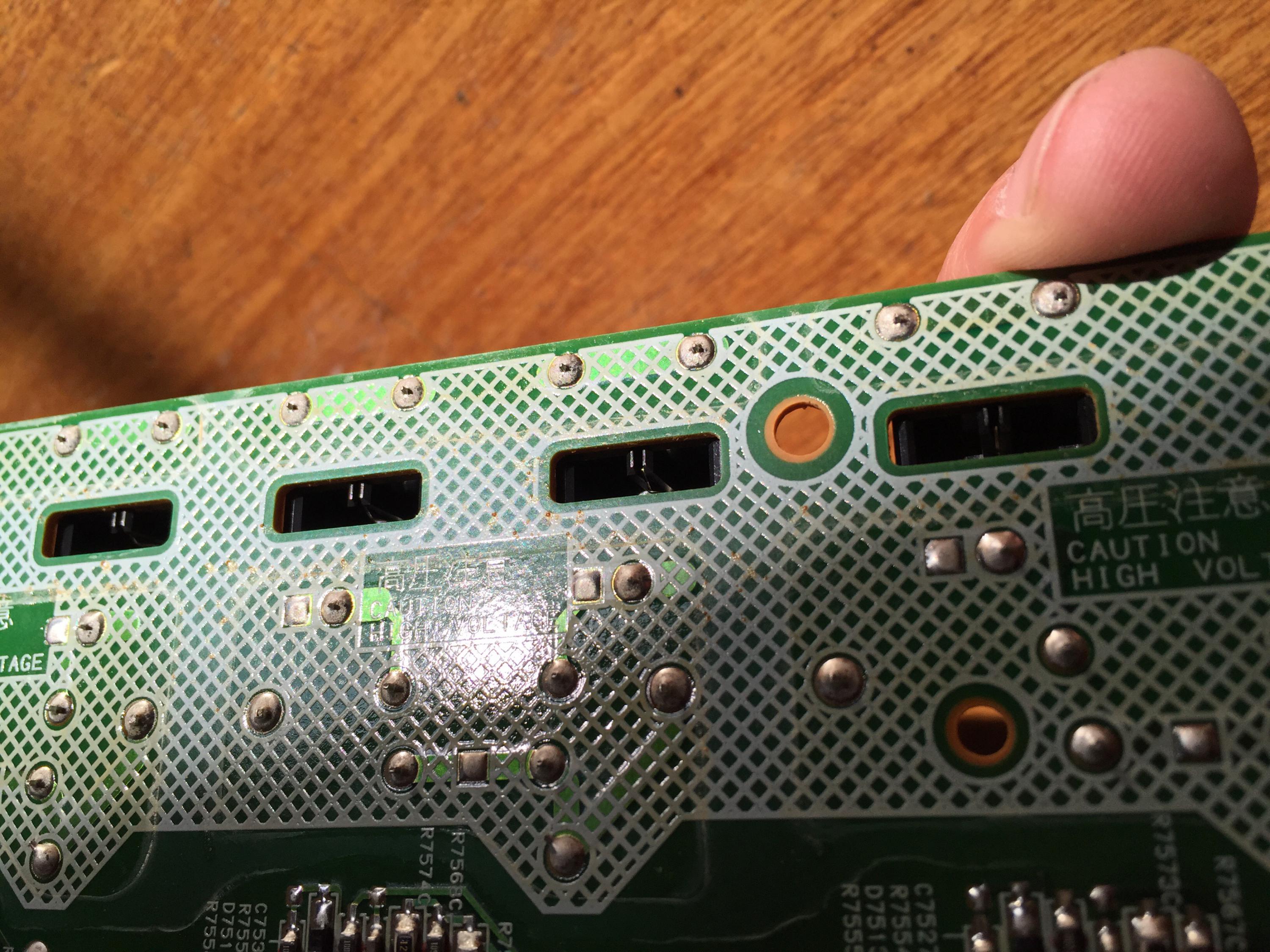

        Re: How do you remove the inverters from a Sharp LC-52D64U?
        Yes, I'll post pics when I get back into it. Basically, each black socket is a female part the snaps down over a male plug. There are three plastic clips holding the inverter and the white plastic shield beneath it to the panel. You squeeze the heads on the three plastic clips and the entire assembly lifts off of the panel.
          Hey bud, sorry for the delay. Here are the pics you requested.
            I can only post one pic at a time from my phone. This is the backside of the inverter.
