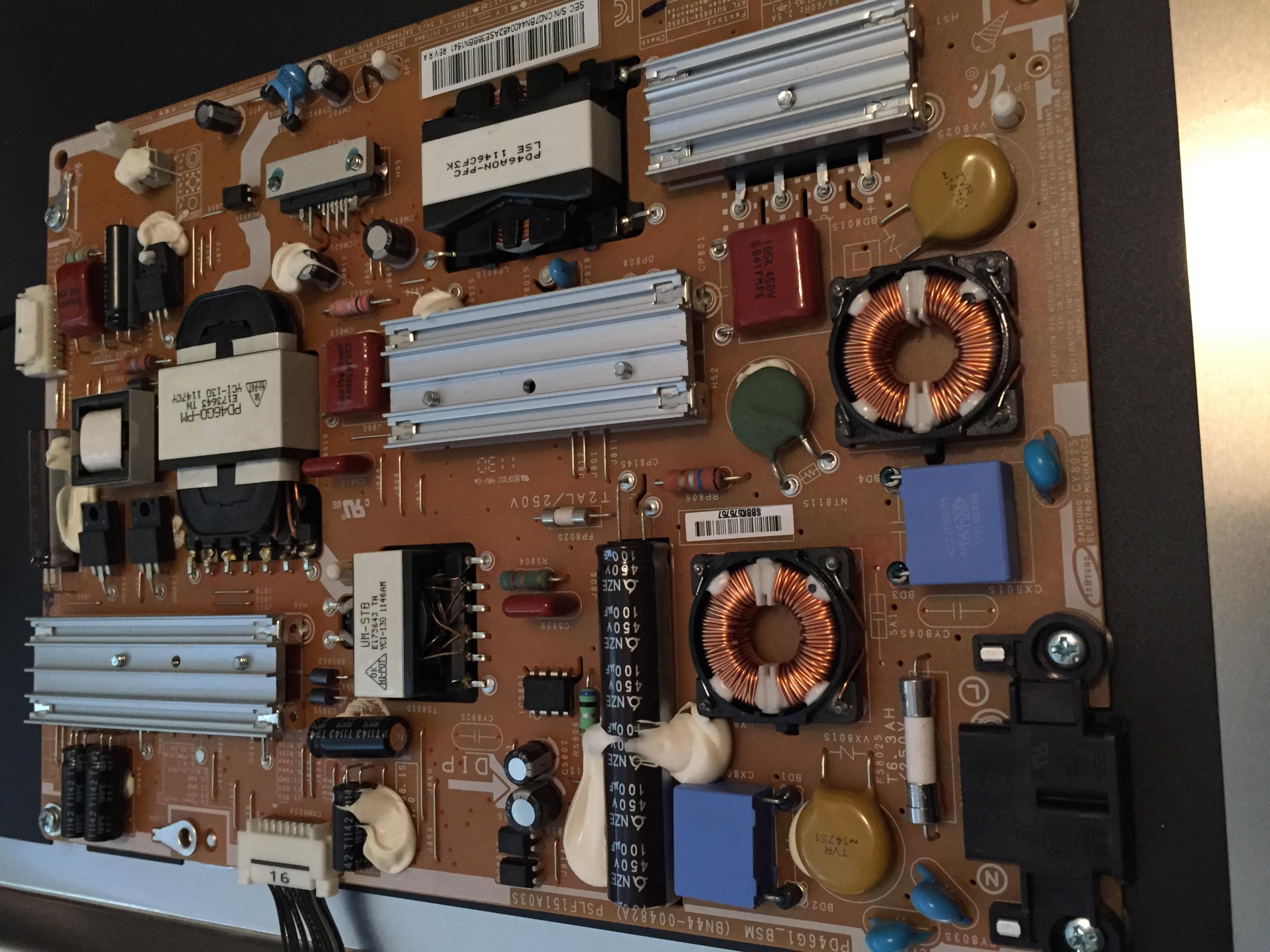

    I have a samsung led model un40d6000sfxza, that as of last night it simply turn off on its own and now it has no power and seems likes its trying to tell me something with blinking red light code.
    The sequence goes like this: on, on, very slight pause, on, on, very slight pause, on, on, very slight pause, on, on, very slight pause, on, on, after this 10th count it goes to a longer pause like its starting all over with the 2 at a time blinks sequence up to 10 counts again and starts all over.
    I removed back panel and visually the power board looks good, I see no burnt components, no leaking/bulging caps but thats all I currently know what to do. Im not a tv tech but I can solder and swap boards and take tv's and electronics apart just not alot experience in electronics in terms of testing parts with a meter and such. I do have a volt meter btw.
    But with directions from someone maybe I can follow if told how too. Anyone know what the blinking lights mean or know whats up? thanks

    Posting pictures of the back of your tv showing the boards with clear pictures may help you more with fixing your problem

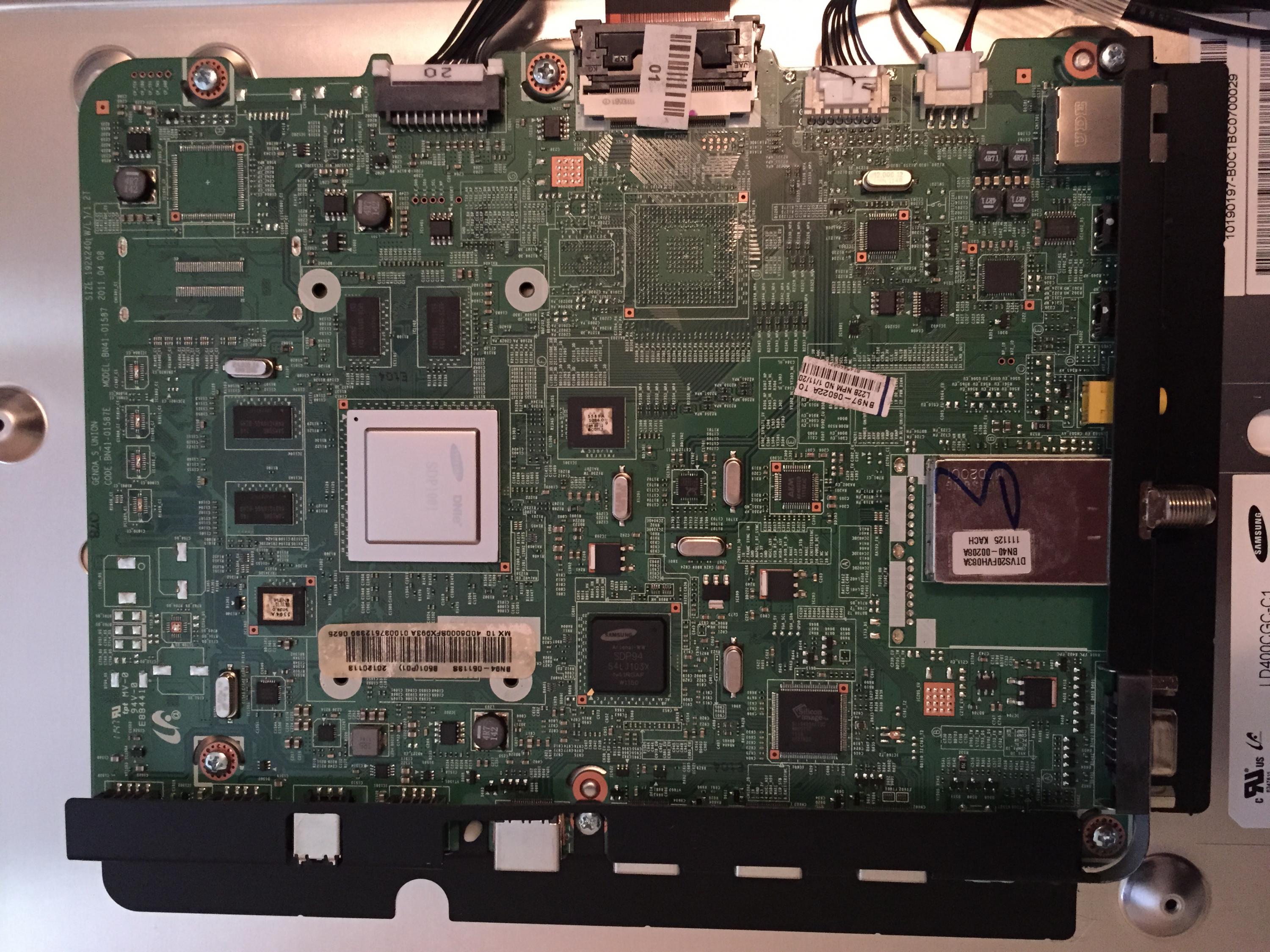

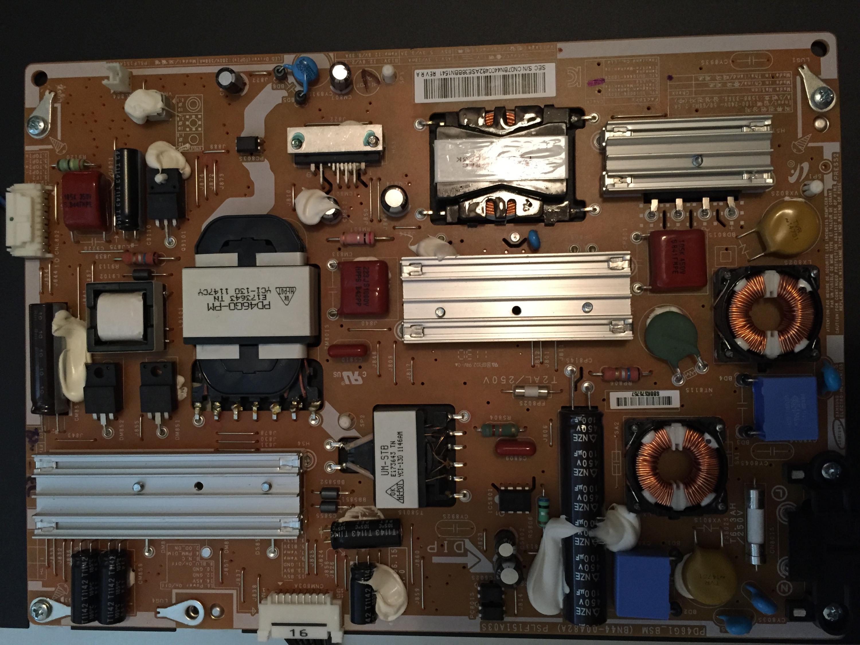

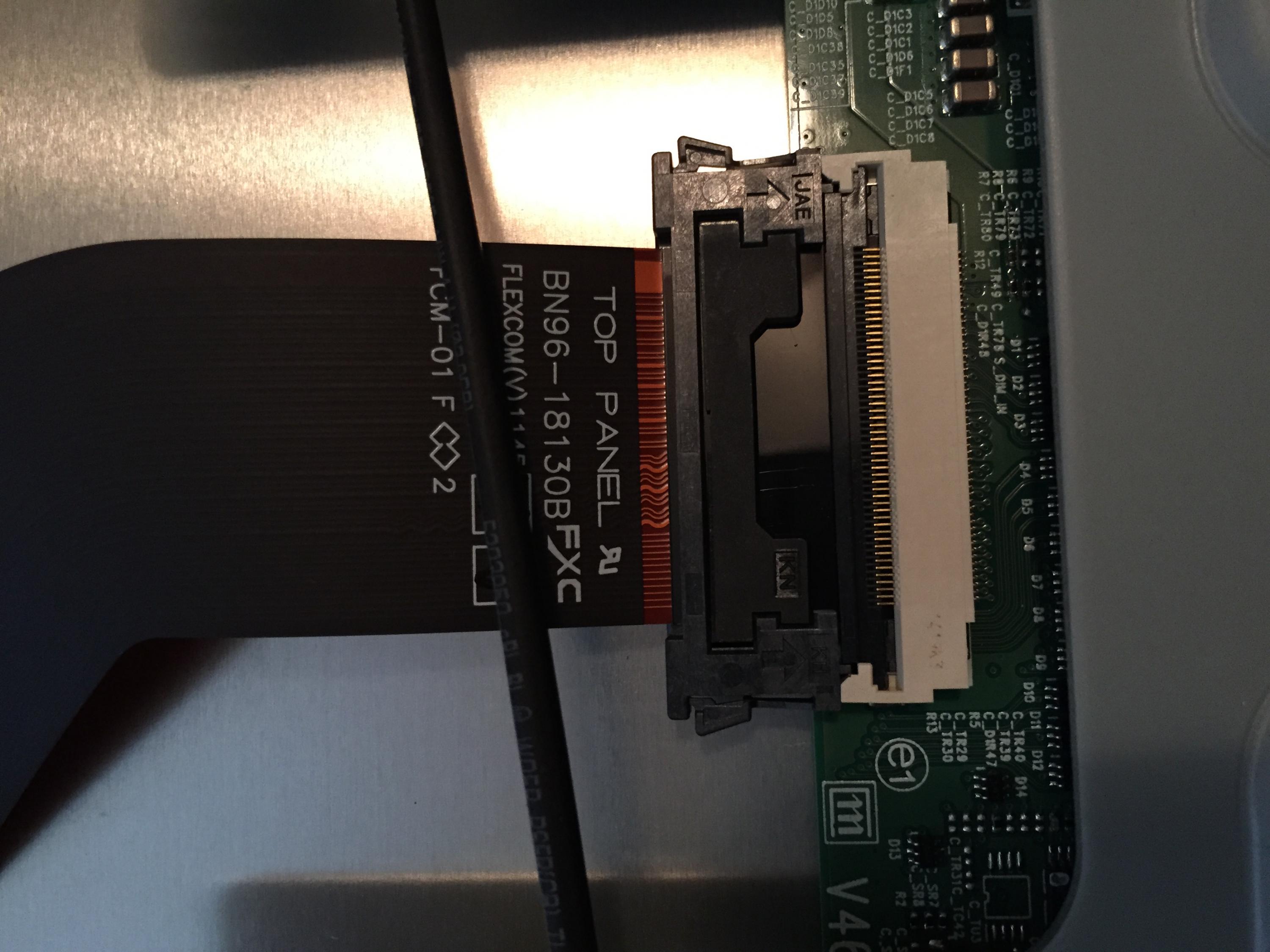

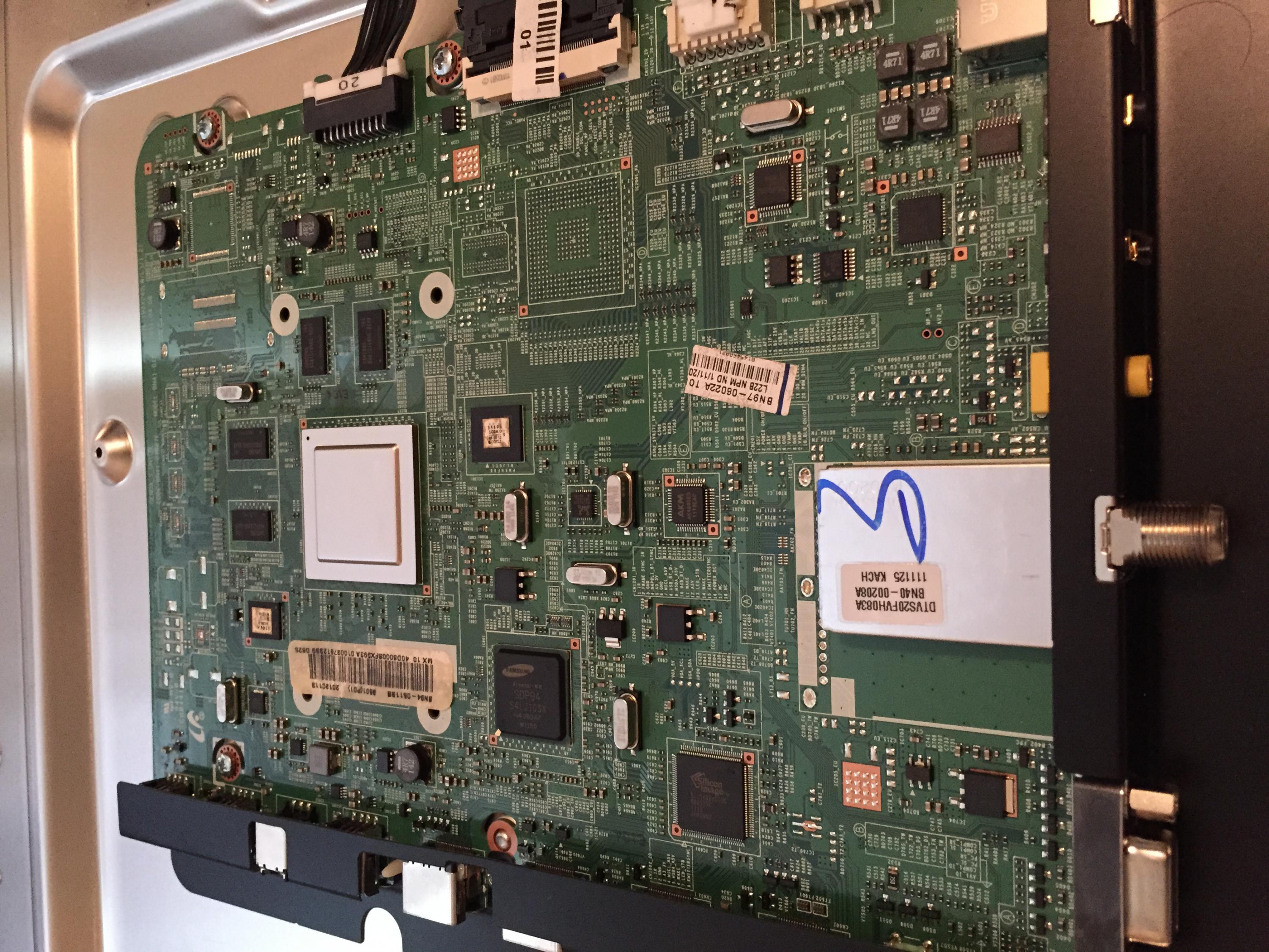

      heres the pictures there's 2 each for the power and main board, and one for that tcon cable I think that's what its called.
      Also got a question about fuses I see typically in tvs like this those cartridge white ceramic type fuses like this power board has how would you know if they are bad it will have a burnt black appearance to it right? It wont be mighty white right? Thanks

            Well we will go through diagnosis of the PSU first anyway.
            As to testing fuses you would use ohm setting and check by testing across the fuse, >1ohm bad and <1ohm a good fuse.
            Ok set your DMM to DCV and test each pin on connector CN1. List the results like this :
            STB - 0v
            5vS - 5v
            etc
            etc

              Sorry forgot to say, Black probe to chassis (screw will do) and red probe to each pin in turn

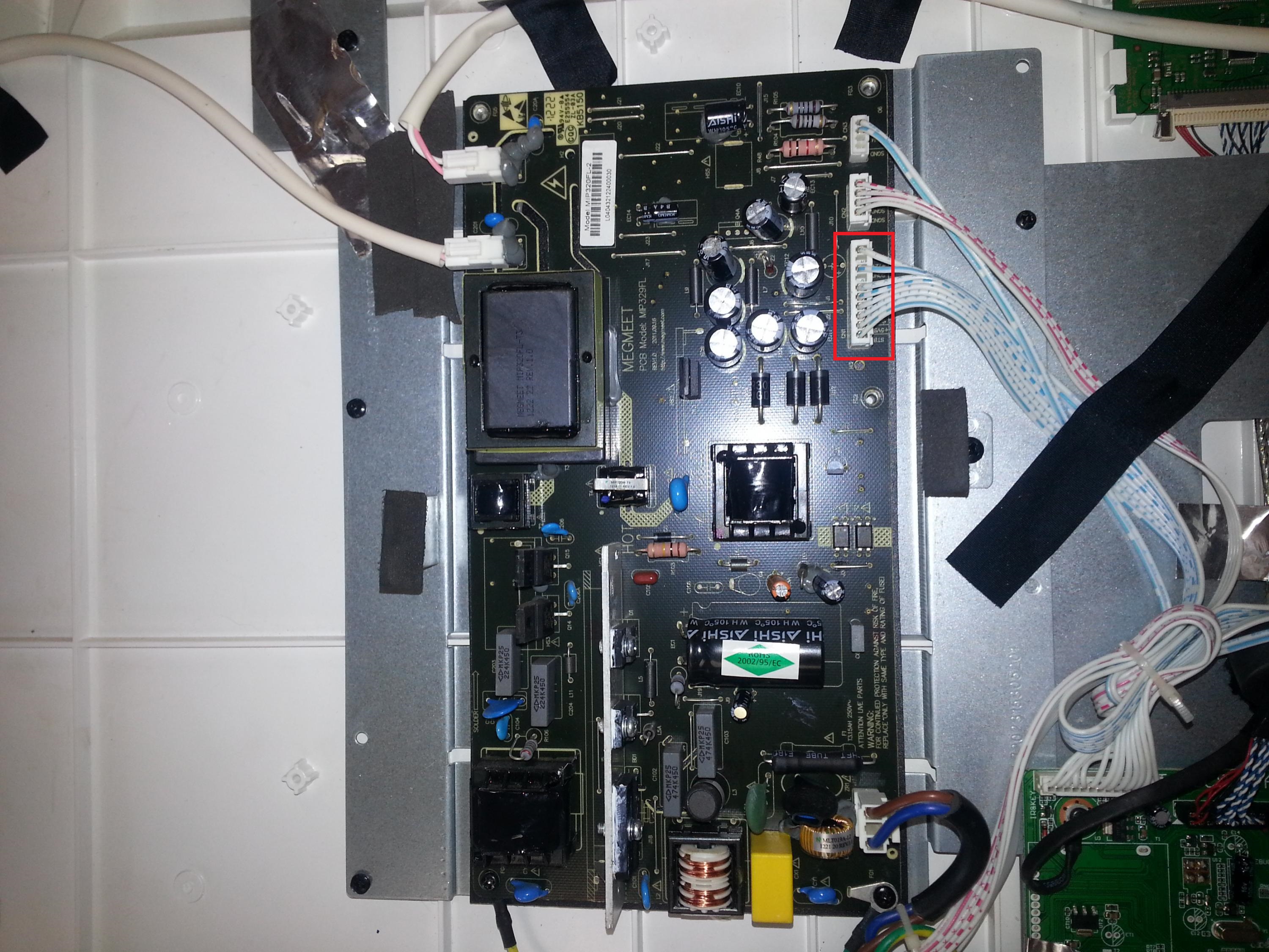

                Hmm so Im looking for a component on the power board that says cn1 right? I don't think I see one

                  Outlined

                    Sorry the tv has to be plugged in and with the red front lights flashing right? btw the picture you posted is not the board i have not sure if your helping someone else and you thought I was them.
                    In the picture you gave me I see a similar connector on this board but it doesn't say cn1 says another number and in writing it has voltage readings of 1,3,5,7 etc pins it should be reading Im assuming, nothing that says stb like you said.
