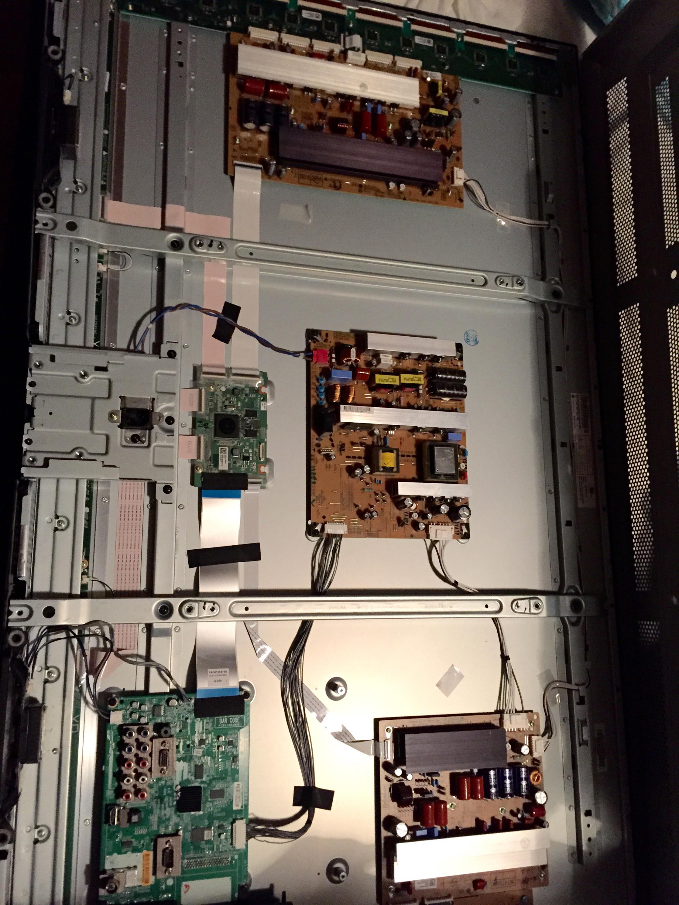

                        please can you post a picture of the back of your tv showing all the boards etc we can highlite what to disconnect etc and test
                        • Anh116
                          • Apr 2015
                          • 8
                          Re: LG50 PA6500 Plasma no pic/sound
                          Picture of the back of set.
