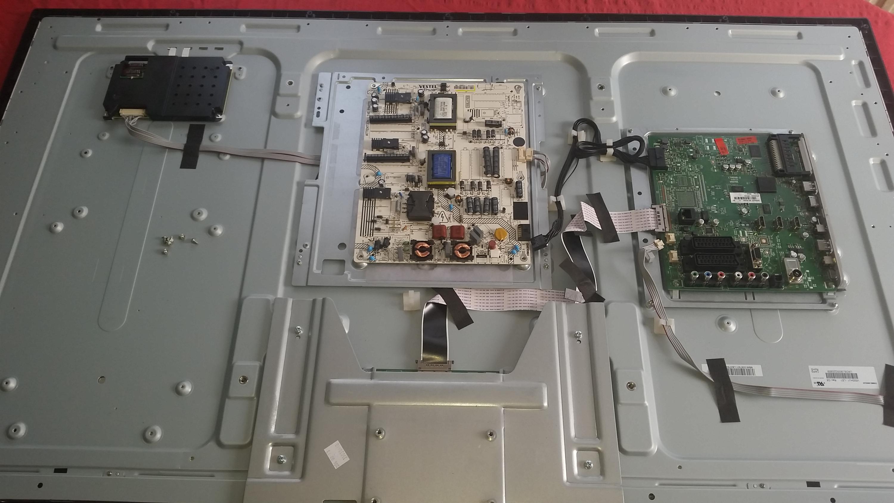

    Hello
    tv will not power up

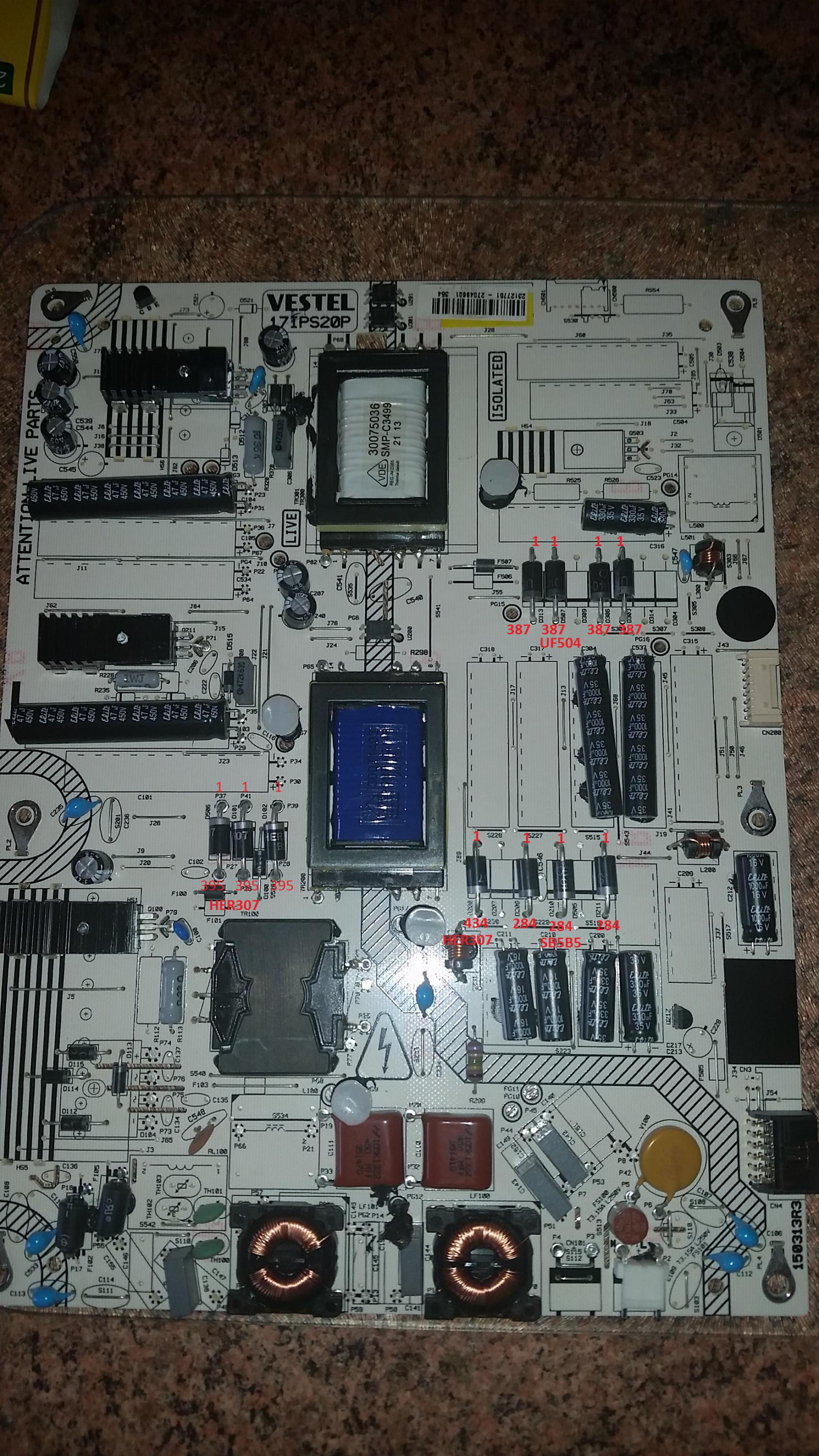

    upon testing the power supply i found 3 diodes i tested in circuit with giving readings both ways,so i thought they was blown but once removed they are fine SB5B5 5amp with readings of 290 are the readings low ? and could this still be the fault ?
    thanks
    Re: Finlux 50F8090S-T STANDBY FLASHING WONT TURN ON
    If they read different forward to backwards they're probably OK.

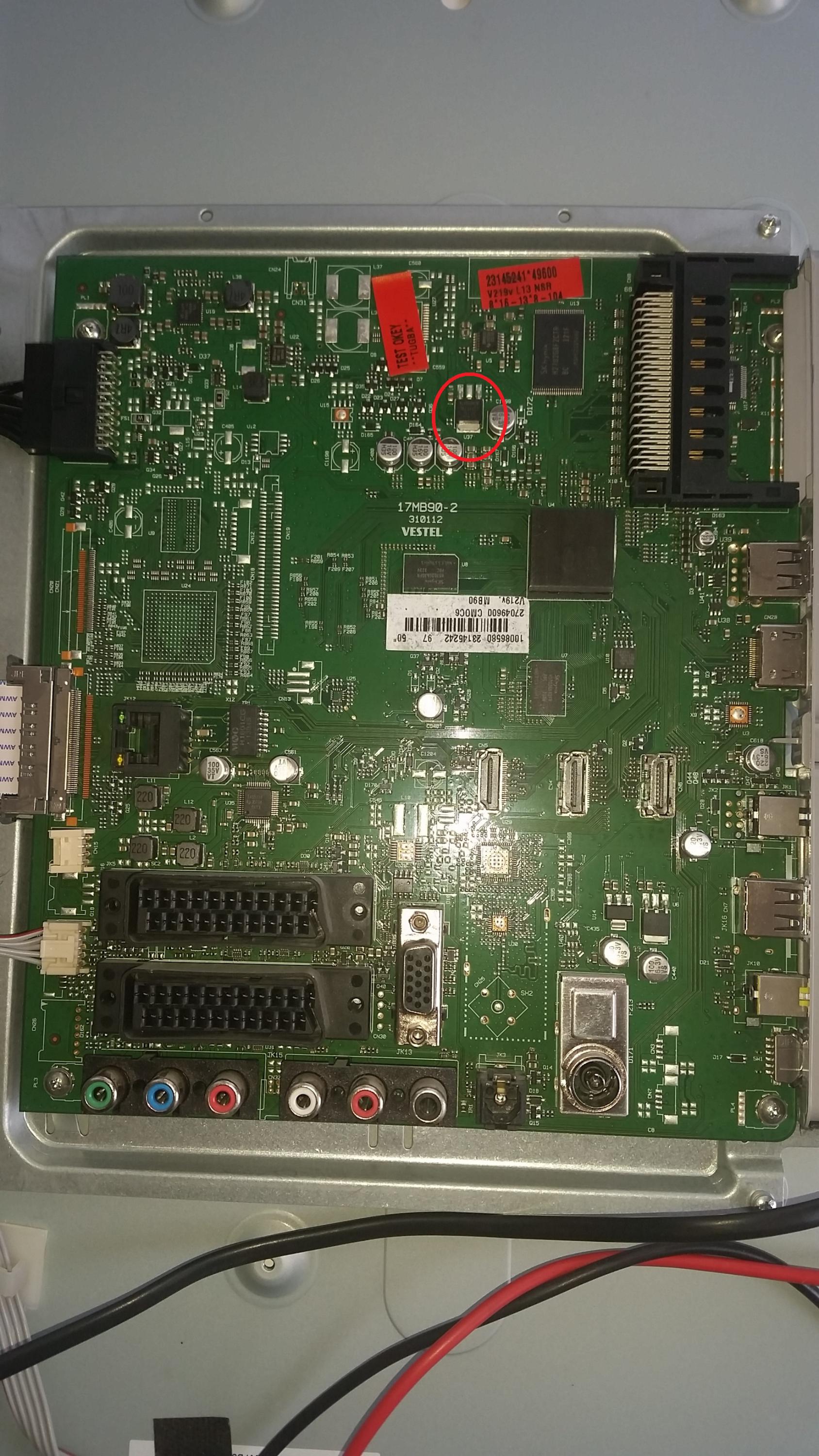

        ok ill check that post out but i cant get a reading on voltages for U37 regulator its fluctuating or could the diode be doing this ?
          I think I jumped the gun, don't know. just saw the vestel PSU part number 1 below yours and thought it had the answer but thinking I'm just confusing things.

              sorry tom still going through the power supply even the voltages are fluctuating on the Psu so ill check all the diodes first

                tested diodes i cant any shorted
                  Just to make sure. A good diode reads one value one way (150-700mV) and reads open (O.L. or single "1") another way. That's what you're getting?

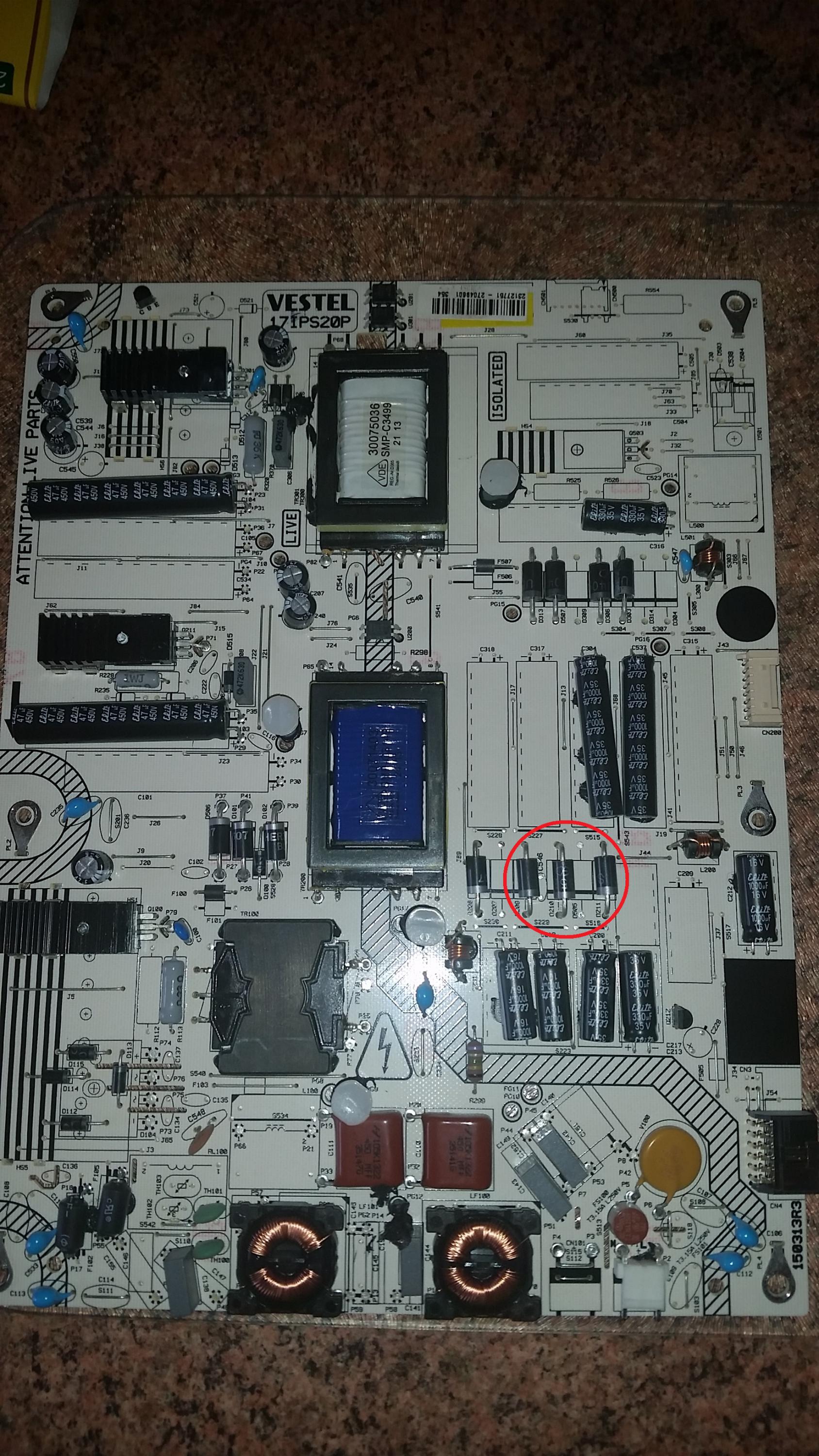

                          diode values as in attached picture diode HER307 have different readings compared to the one diode next to the SB5BS diodes not sure if that matters though ?
                            They are different types of diodes, so it is fine.
