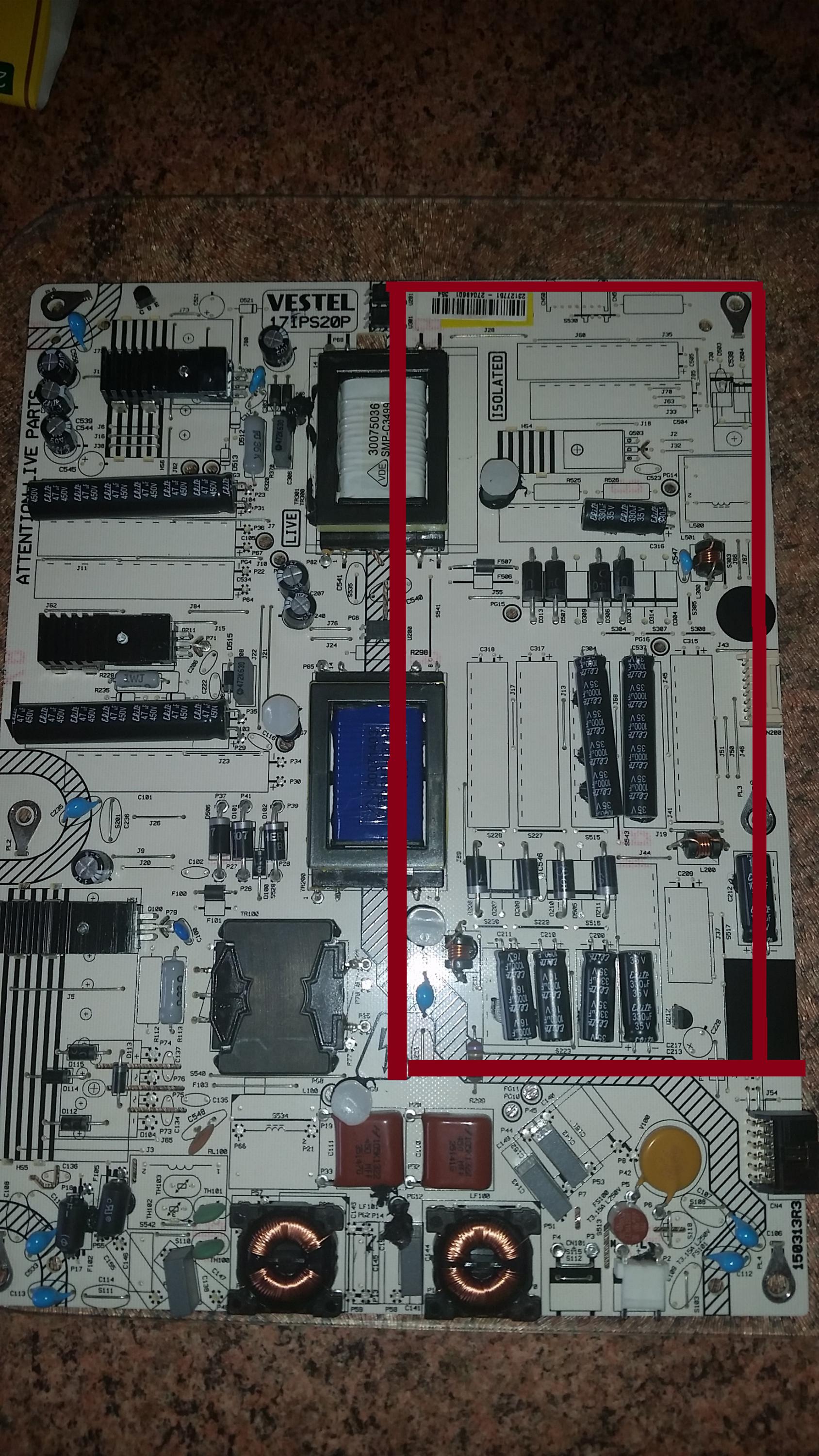

                          Re: Finlux 50F8090S-T STANDBY FLASHING WONT TURN ON
                          Any reason why the area highlighted in red all voltages are really low ?
                            #33
                            That's a rather general area... which part in particular?
                            • sordids999
                              • May 2013
                              • 2161
                              • uk
                              #34

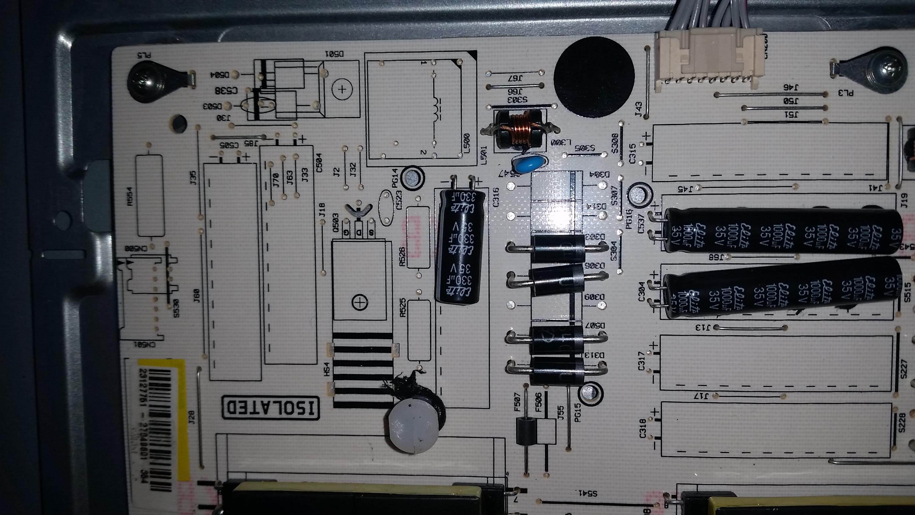

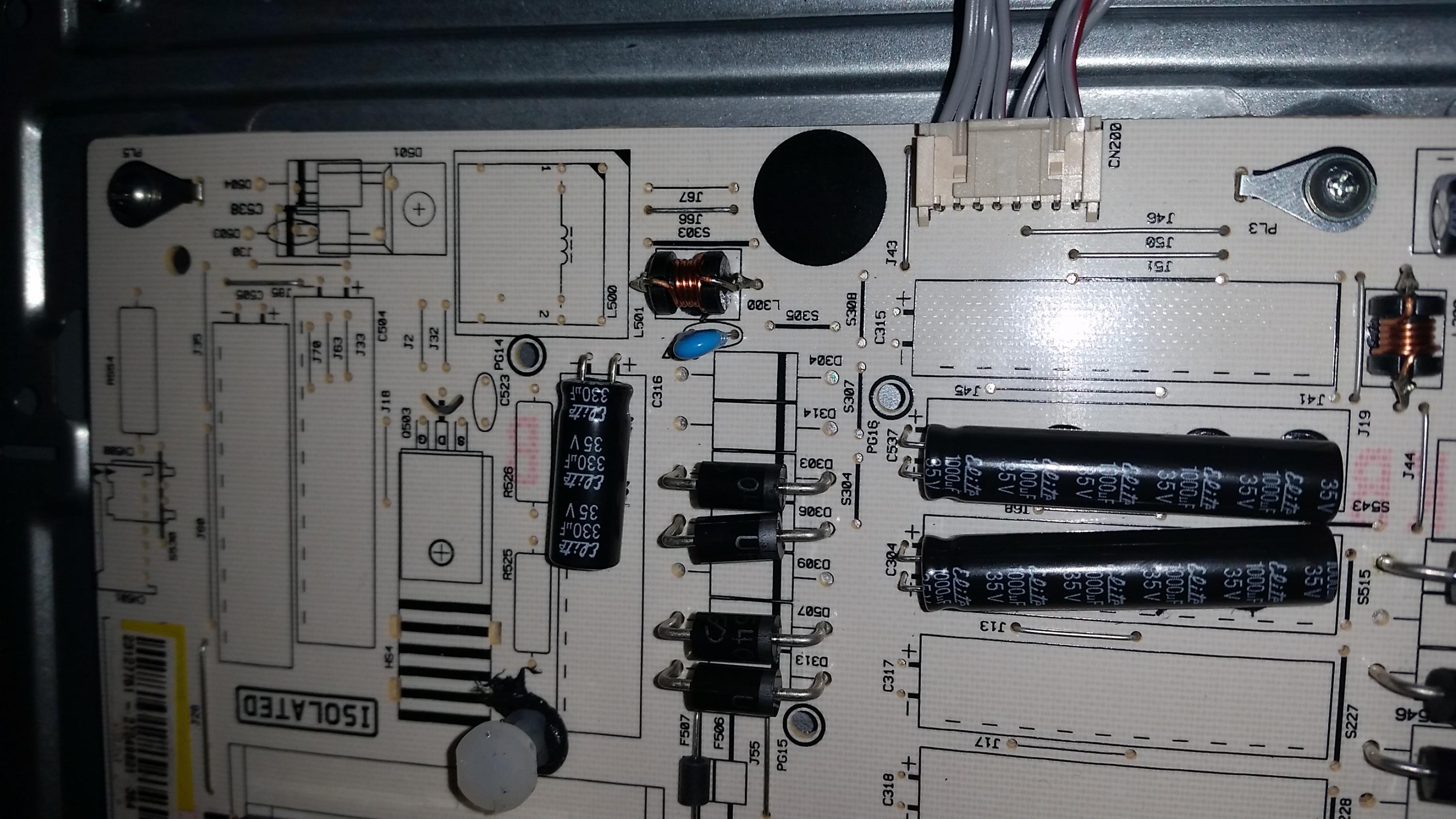

                              with main board disabled
                              UF 5402 x4 diodes reading 0.06 volts
                              x1 35v 330 UF cap reading 1.5 volts
                              SB5100 x3 11.8 volts
                              x2 35v 1000 UF cap 1.5 volts
                              x2 35v 330 UF cap measuring 24.7 volts 23.1 volts
                              even with main board connected the voltages are only slightly higher but fluctuating
                                #35
                                What do you get across C505 or C504?
                                • sordids999
                                  • May 2013
                                  • 2161
                                  • uk
                                  #36
                                  There is no C505/504 capacitors
                                    #37
                                    You got D501,D503 or D504?
                                    • sordids999
                                      • May 2013
                                      • 2161
                                      • uk
                                      #38
                                      no tom
                                        #39
                                        Is that CN200 in the right of the pic?
                                        • sordids999
                                          • May 2013
                                          • 2161
                                          • uk
                                          #40
                                          yes tom
