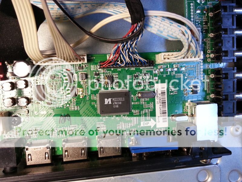

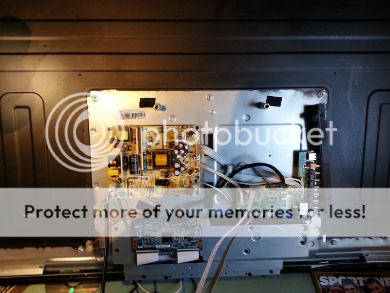

    I'm trying to repair this RCA LED tv. It is a weird model as I could not get any information on it anywhere.
    I have stand-by light (red) and when I turn it on, the blue light will come on steady (no blinking errors), but nothing shows up on the screen and no audio come out.

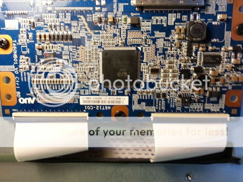

    I opened up the cover and checked the ps...and all the voltages are coming out properly. I have disconnected the tcon board (both to the main board as well as the ribbons to the screen)....no difference.
    I'm suspecting the main board, but I need help diagnosing it.

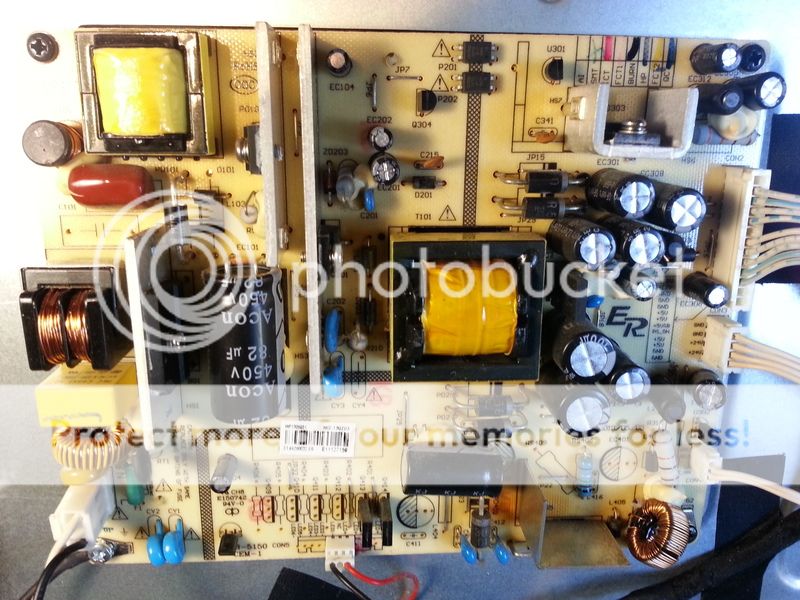

    On the long white connector on the PSU you have 5V and 12V? And 24V on the smaller one?
    Where is the pic of the inverter? Is the backlight working? What are signals going to the inverter board?

      Also upload the pictures of the whole back side of the TV so we can see how all the boards are connected together.

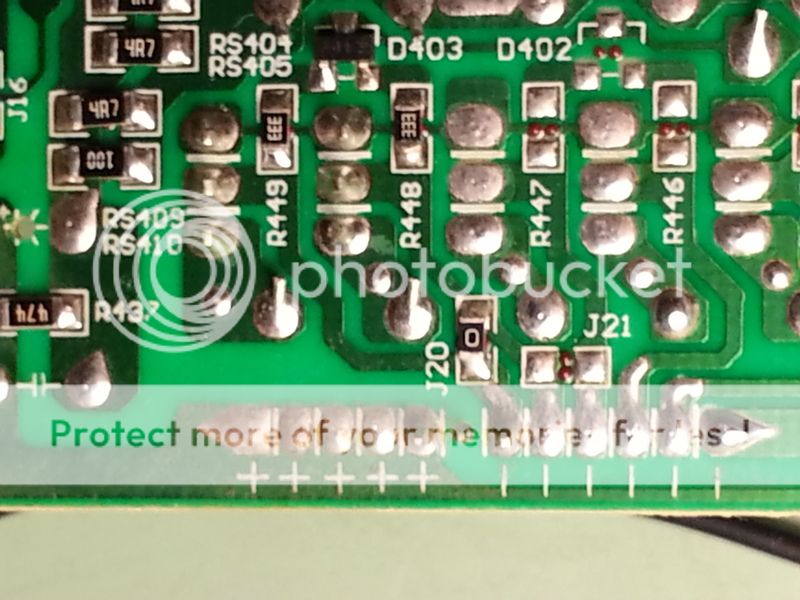

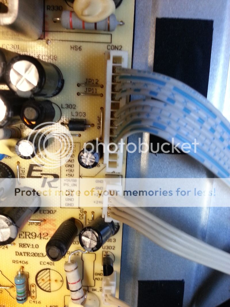

        I am attaching a picture of the connector and pinouts. The following are the reading on the meter:
        24v reads 24.8v
        5v reads 4.9v
        5vusb reads 4.9v
        12v reads 12.1
        PS_ON reads 4.0v

          How about the BK_ON (bl-on) pin of the smaller connector?
          How about the connector with RED, BLACK wires on the power supply board? It looks like it is for the LED strings.
          What DCV do you have between chassis and Red wire, chassis and Black wire?

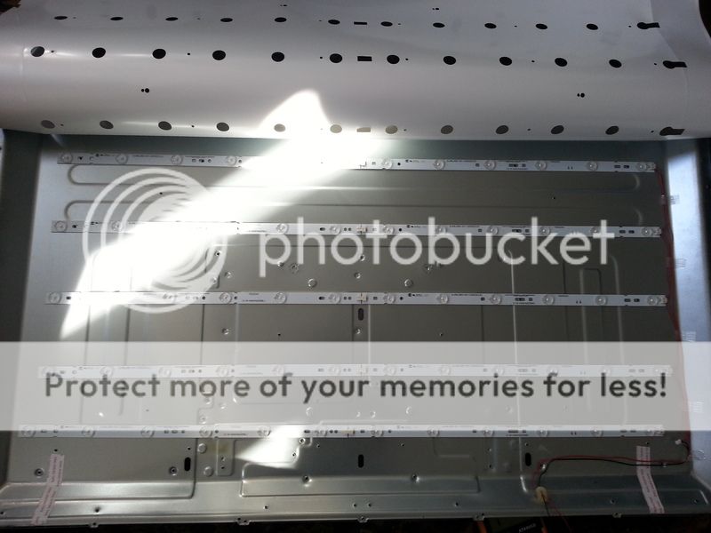

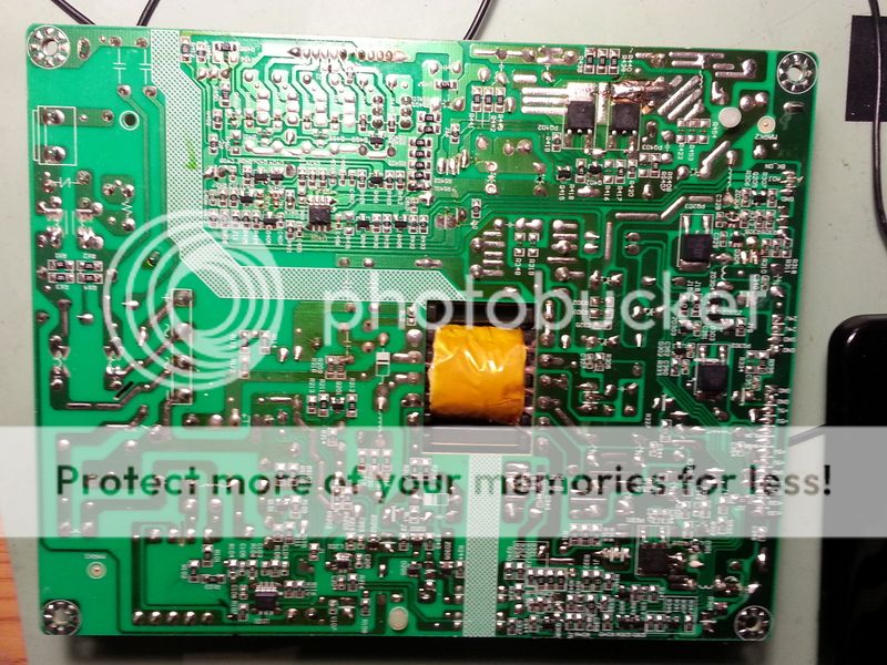

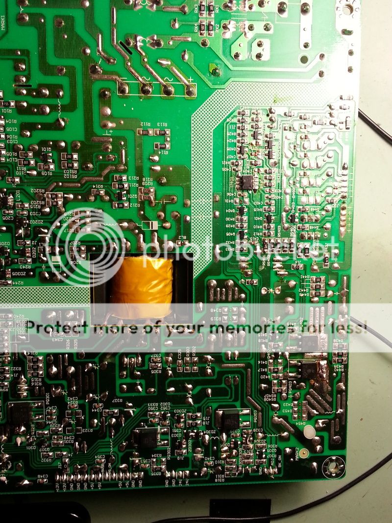

                      Can I see good clear pictures of the bottom side of the power supply board, especially around the LED connector?
                      You are going to have to open up the LCD panel assembly to get to the LED strings, not going to be fun.

                        Here are some pictures of the backside of the PS. the close up is of the LED connector (one pin on the negative and one pin on the positive.
                        I guess I will start the display disassembly tomorrow.....how do I start diagnosing the LED lights?

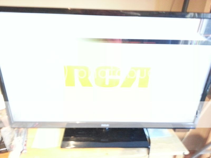

                          Okay...after taking the display out and finding out the LED light that was bad.....I bypassed it and got the light to come on......BUT....while putting everything back....I CRACKED THE SCREEN!!!
                          the tv is toast now...posting it for parts.
                            Re: RCA RLDED4633A-C 46 LED tv - no video, no audio
                            Oh too bad! So how many LEDs were bad?
                            I would keep the LED strips & boards for repair or for testing, and at least now you know how to figure out if you have bad LED drivers or bad LEDs.

                              Only one LED was bad, so i just bypassed it....with the tv on, I can't tell the difference.
