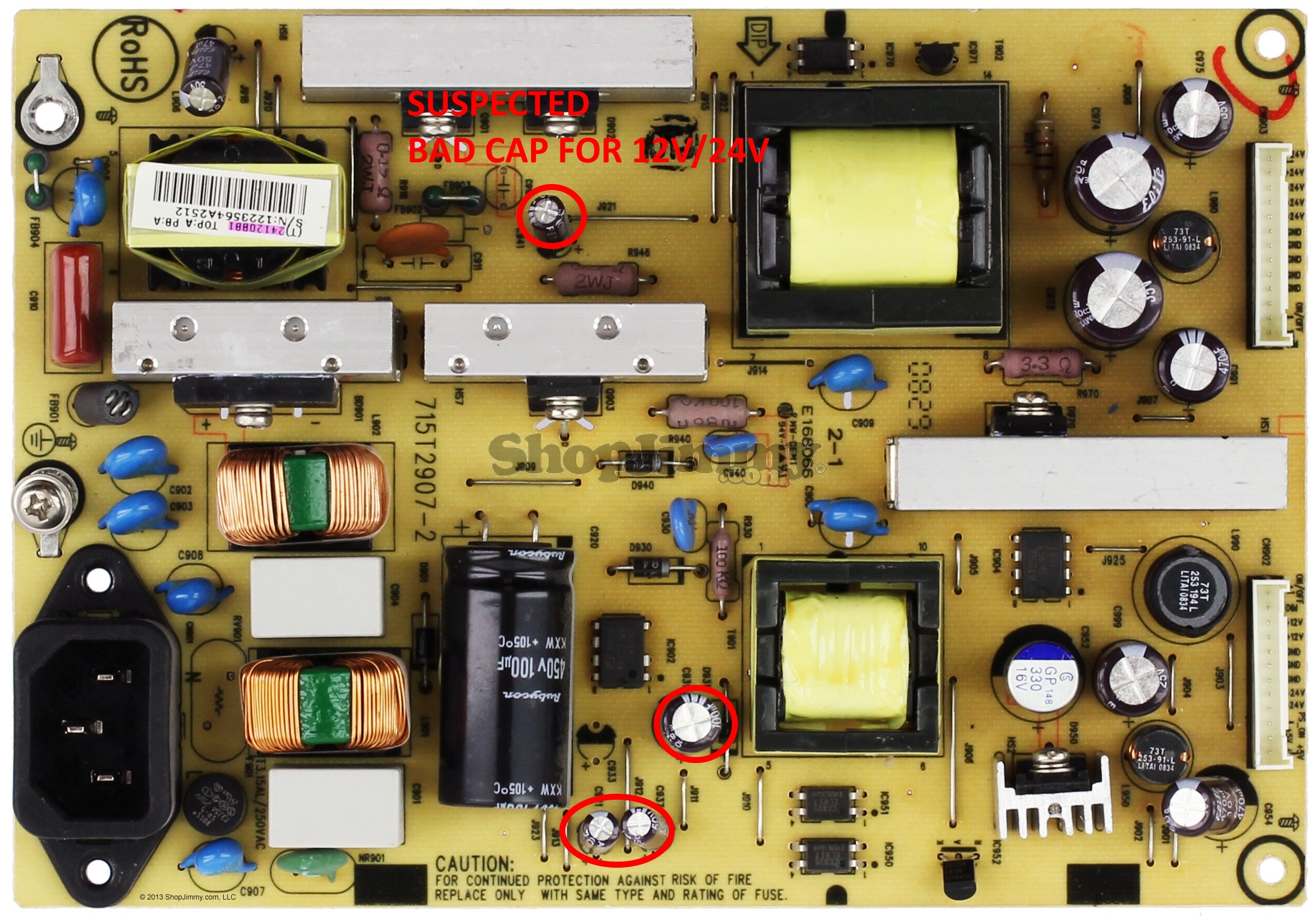

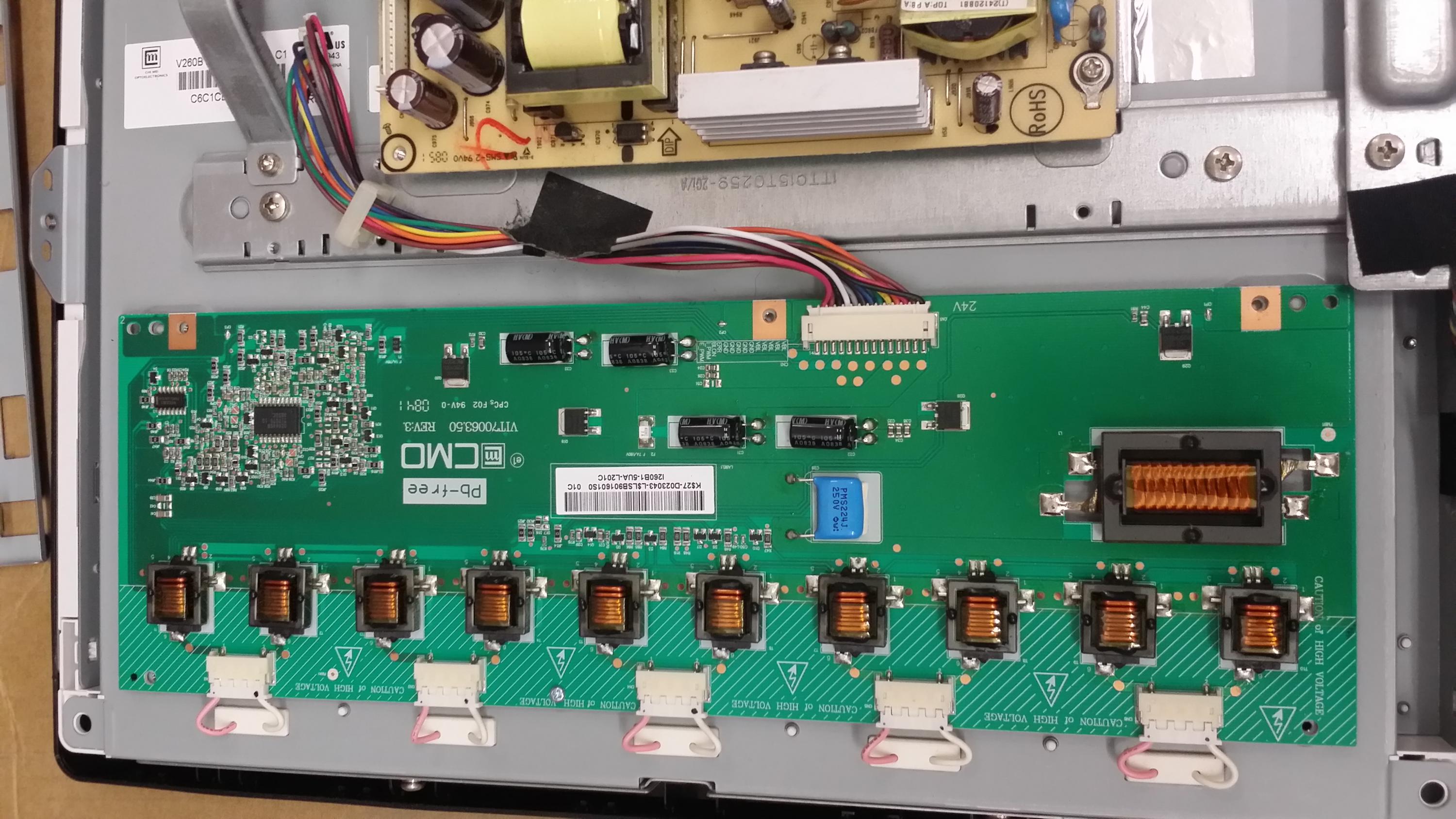

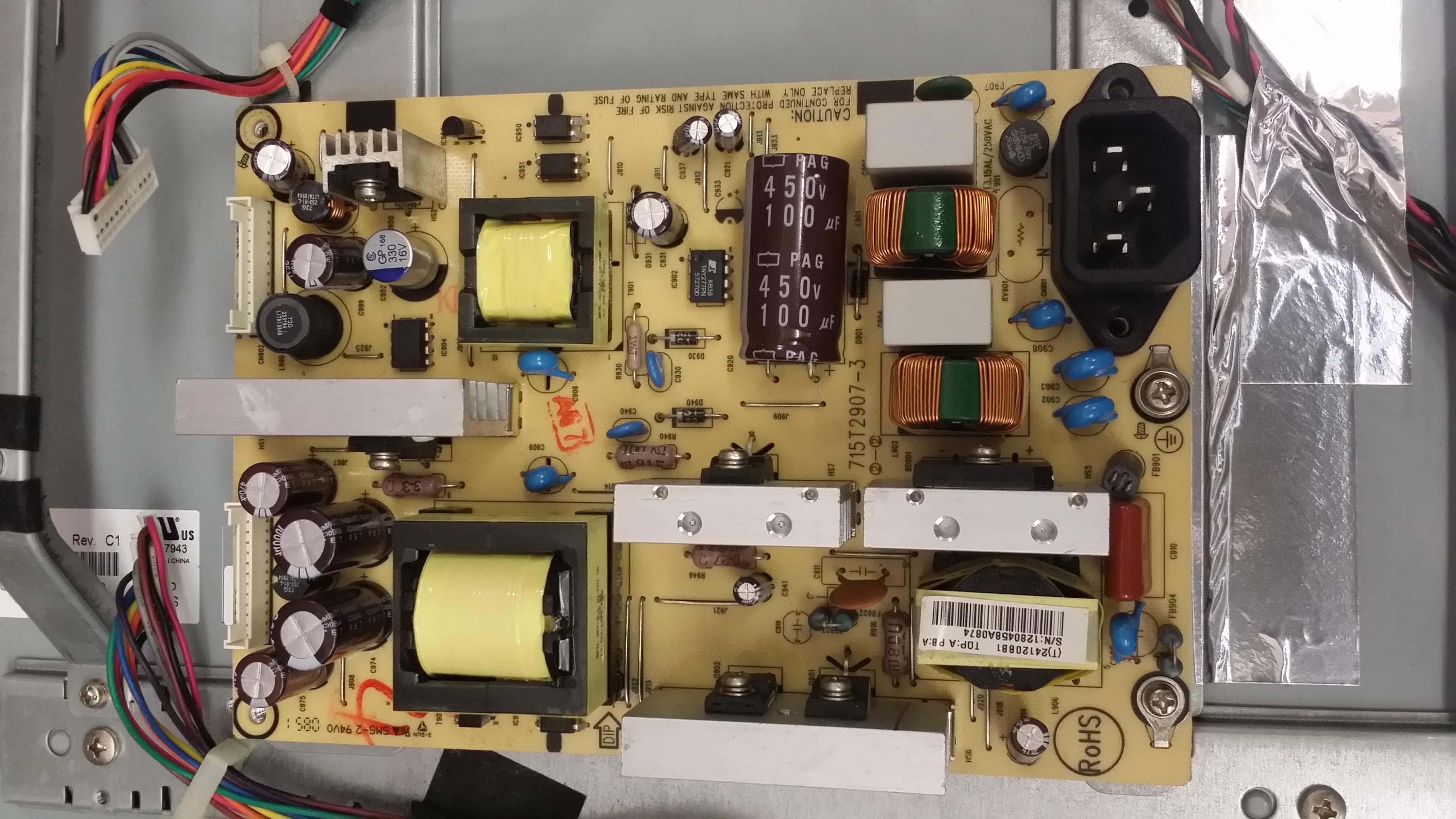

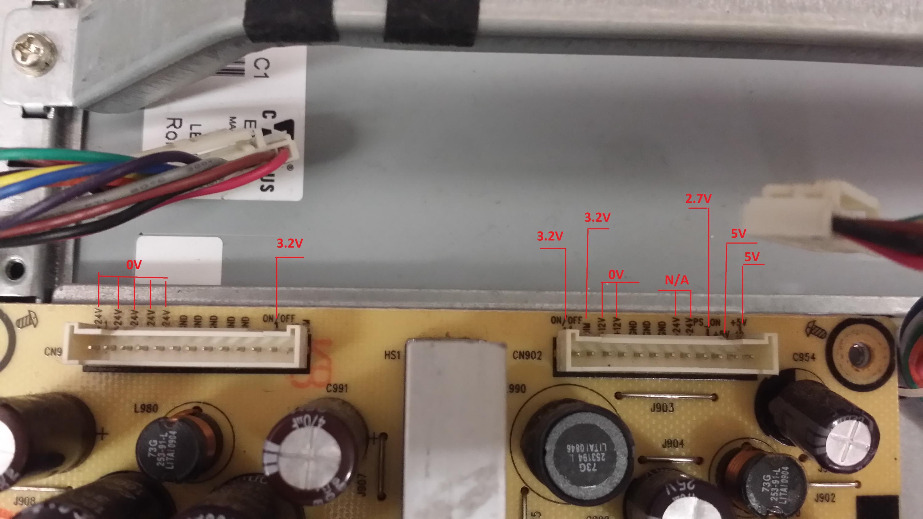

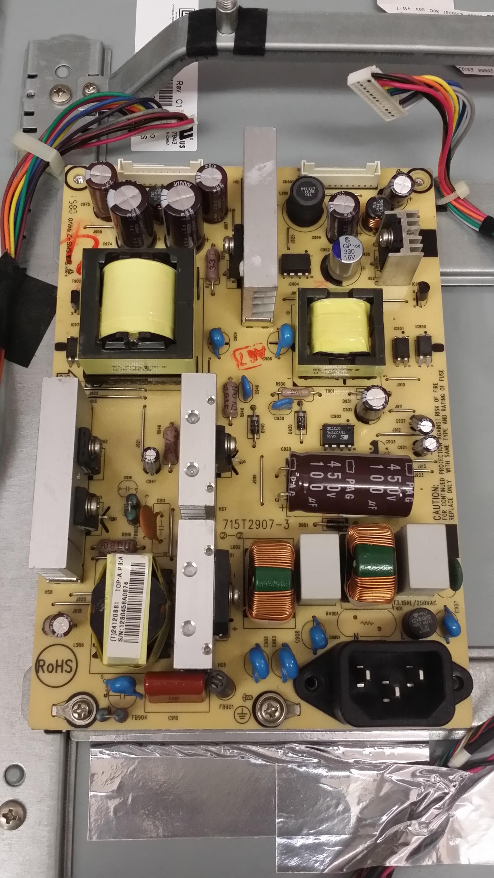

I Have a Dynex unit, as soon as i plug the power cord up i get 6 blinking red light then when i press the power button it turns green and screen stays black.. I dont hear any clicking from relays.. i tested all diodes and resistors everything looked good.. VCC tested ok
But the 12v reading isnt solid, i get a high reading then it starts dropping. could be the cheap multi meter im useing.. but i cant seem to find the 12volts
any help in guiding me in the right direction would be appreciated alot thanks
