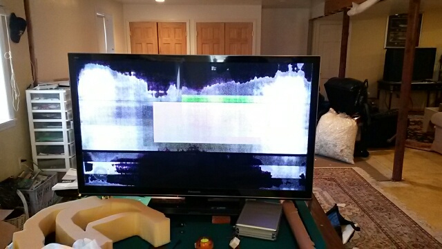

    Panasonic TC-P50GT30 screen washed out
    I had 7 (not 10) blinks, and replaced the SD Buffer card, turned it on and the TV powered up!
    But this is the new problem, below:
    any chance for survival, i will search some...

    Re: Panasonic TC-P50GT30 screen washed out
    SS voltages?
    • djw43
      • Mar 2015
      • 95
      SS11 vsus 214
      SS11 P15V 15.55
      TPVe 170
      TPVsus 214
      TPSOS8 3.7
      TP065 196
      TPSS1 153
      P5V 5.03
        Ve looks way too high... Are you sure it's that high? Can you adjust it to 120-140V range?
              Definitely 170 v but I honestly have no idea how to adjust it

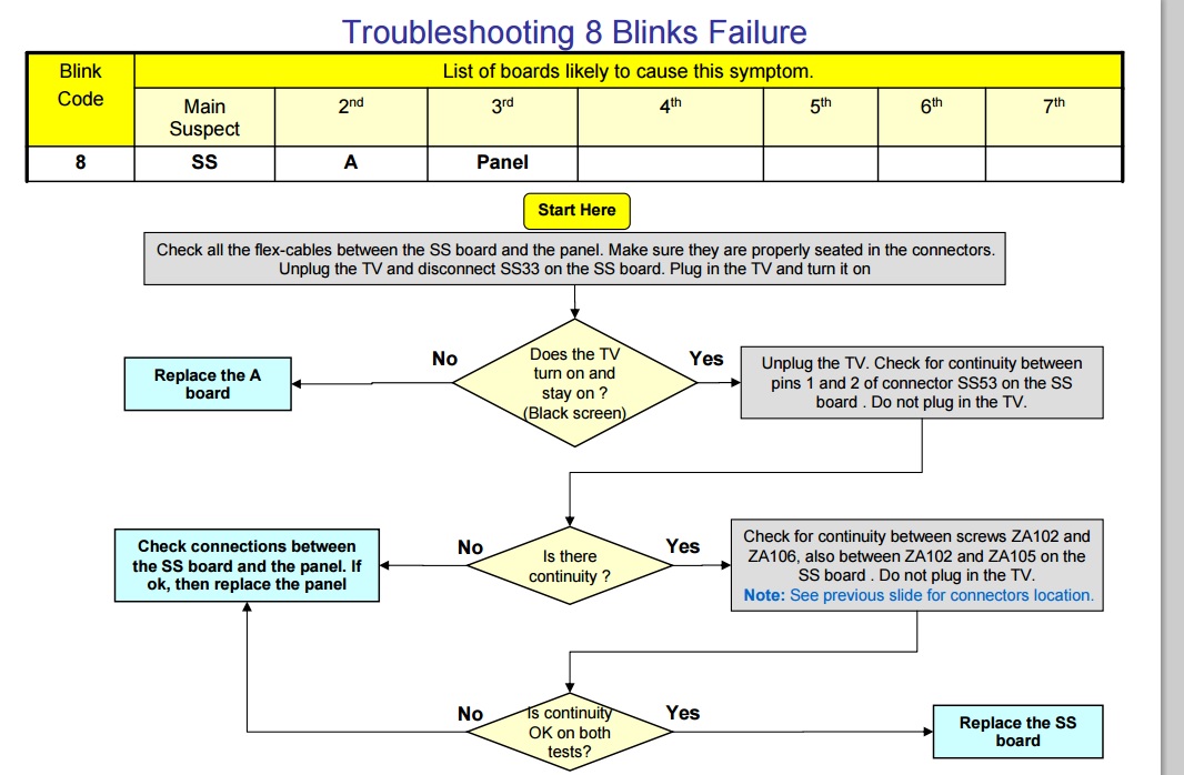

                        i'm am getting somewhere, the set clicked off, 8 blinks, disconnected SS53 and tv powered up blk screen, then i shut it off, reconnected SS53, and found continuity at SS53 pin 1 and 2, also at ZA102-ZA105 and ZA102-ZA106 points to SS as you guys suspected.
                        I ordered one for $25, and I will be back....
                          TPVE should be 165V on the 50"
                              have this guide
                                Not sure on your test method.
                                Fault looks like SS board anyhow - I bet if you repeat test with new board, it'll do the same and read the same...
                                      Originally posted by tw2005
                                      have this guide
                                      yes, that is where i got the 8 blink diagnostic
                                      and yes probly, i will check that when it arrives.
                                      thanks guys, i hope to get a picture with an SS
                                        last question on this TV this week, could the SS cause the blah screen?
