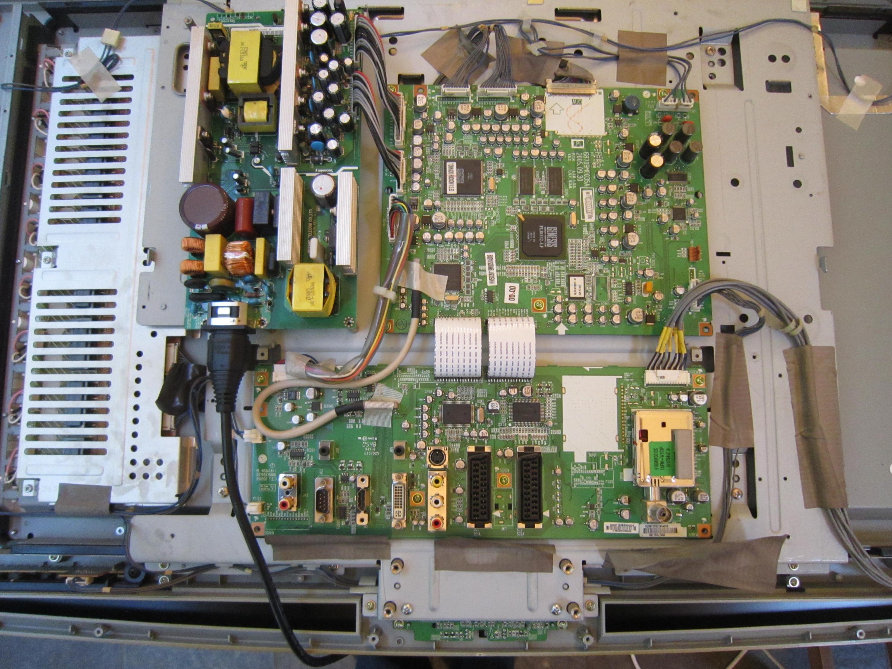

    My very first attempt at fixing a TV (LG 32LX2R). The 5V SB is present and when I short this to ON, the relay clicks and all voltages are present and correct. When I reconnect the power board to the logic board, the SB voltage drops, but no relay click or standby light.
    All of the Caps on the TV look ok but I can't test them until my ESR meter turns up.
    The strange thing is that yesterday when I first tried shorting 5V SB to on and the relay clicked, I reconnected the power board and everything worked and I ran the TV for 4 hours switching it on and off several times and I disconnected the mains several times.
    I left it disconnected from the mains last night and this morning it was dead with no standby.
    Can I assume that the power board is ok and if so I am unsure of the next steps.
    Any help would be gratefully received

    Posting pictures of the back of your tv showing the boards with clear pictures may help you more with fixing your problem

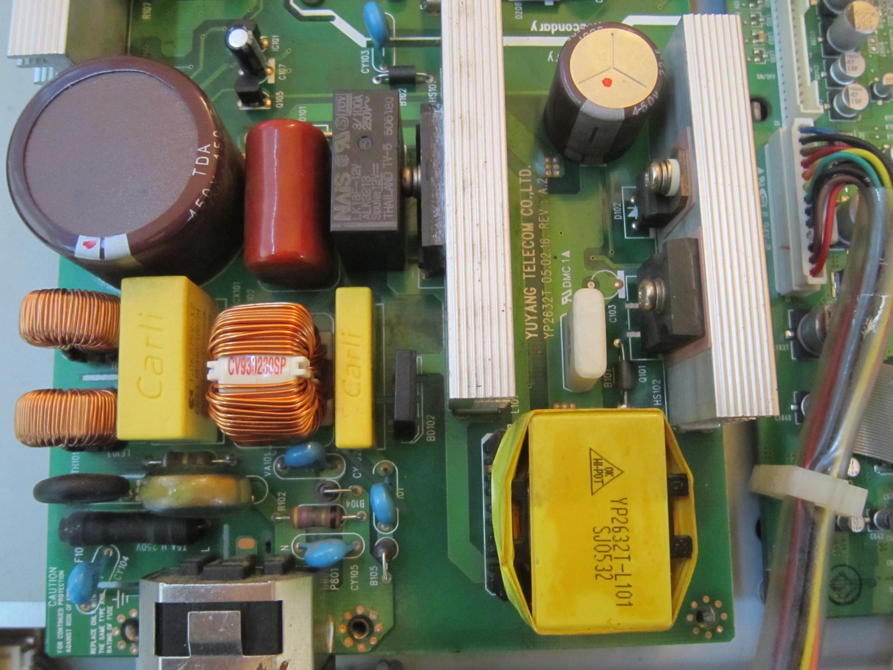

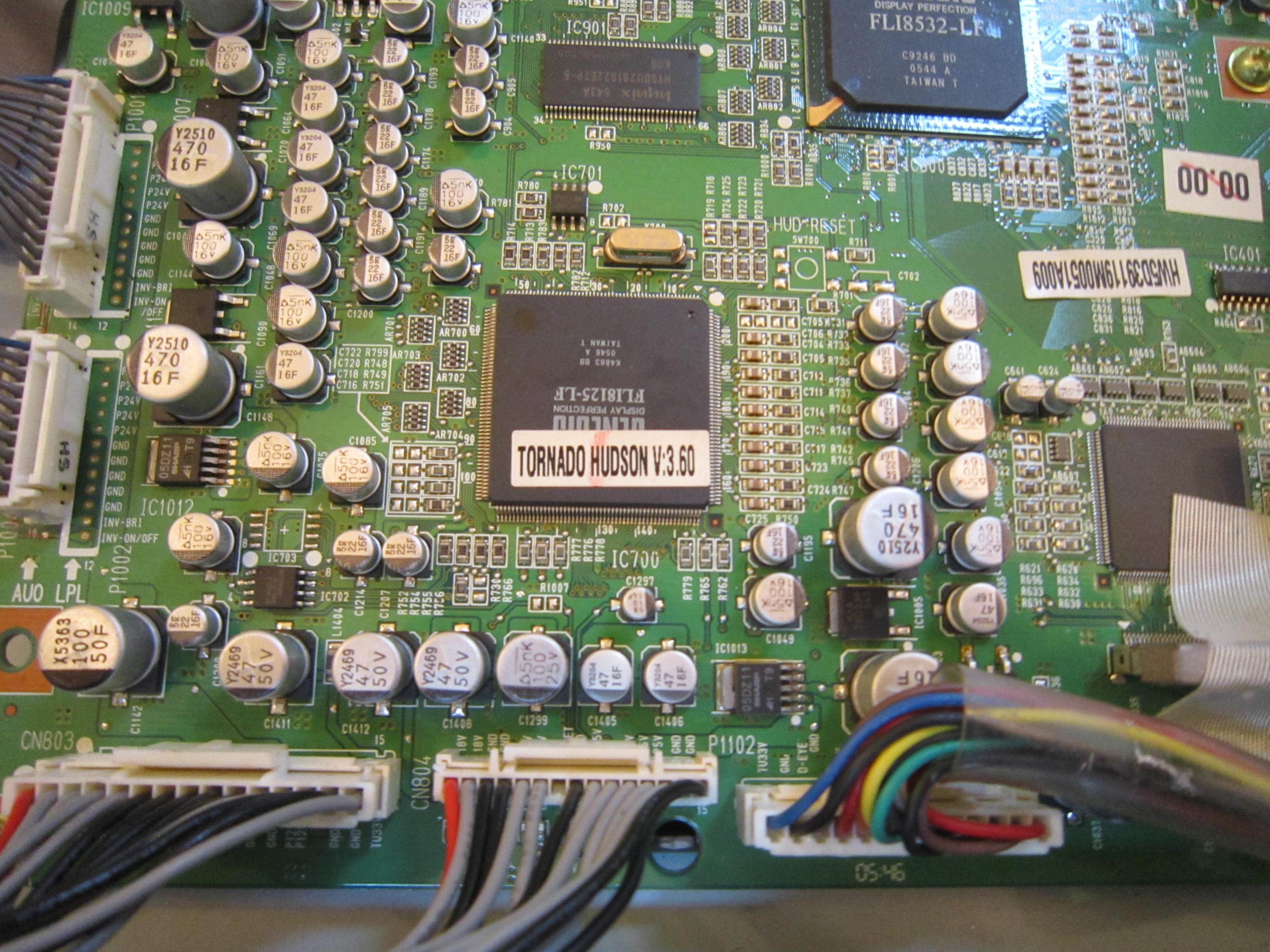

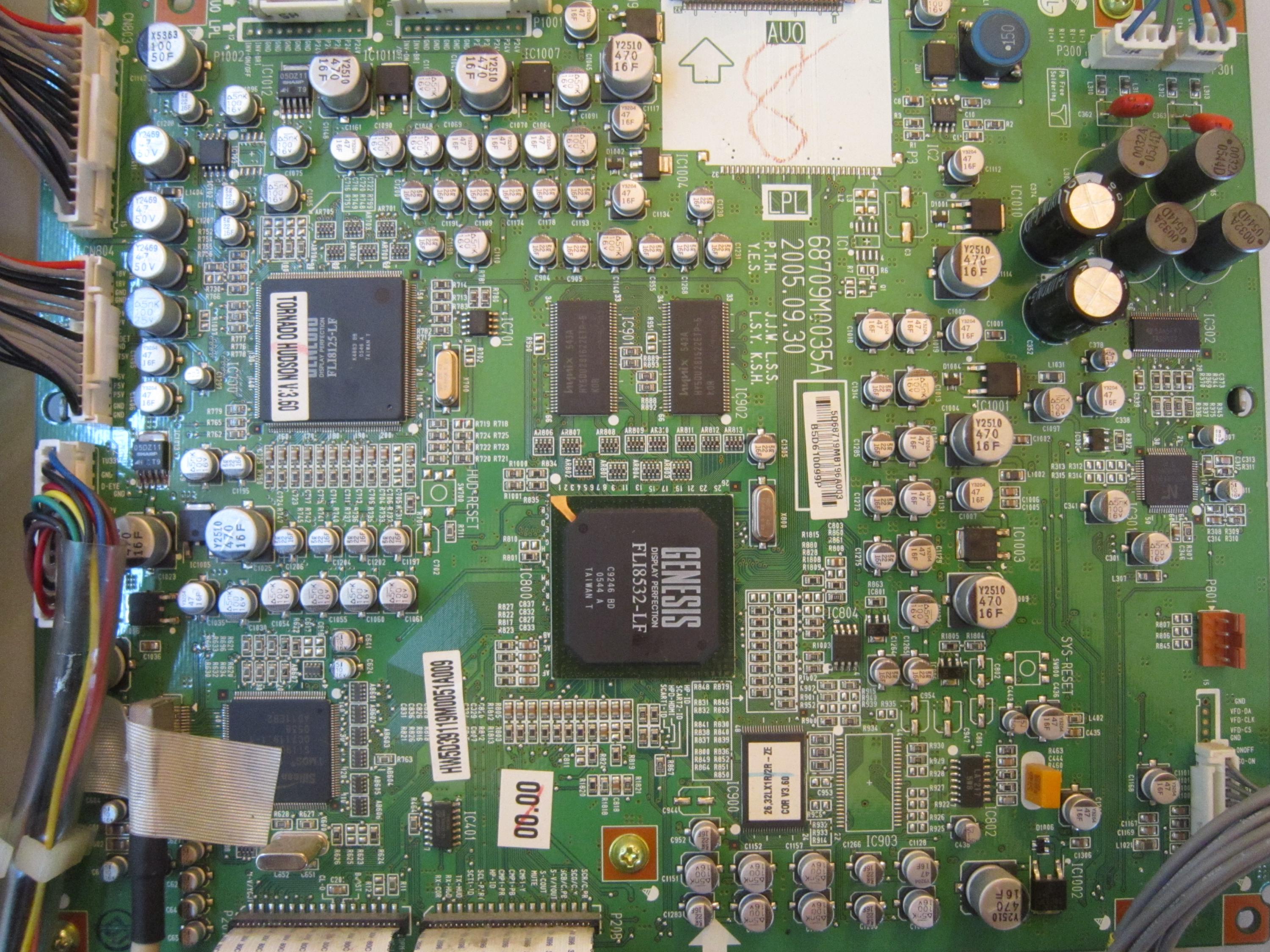

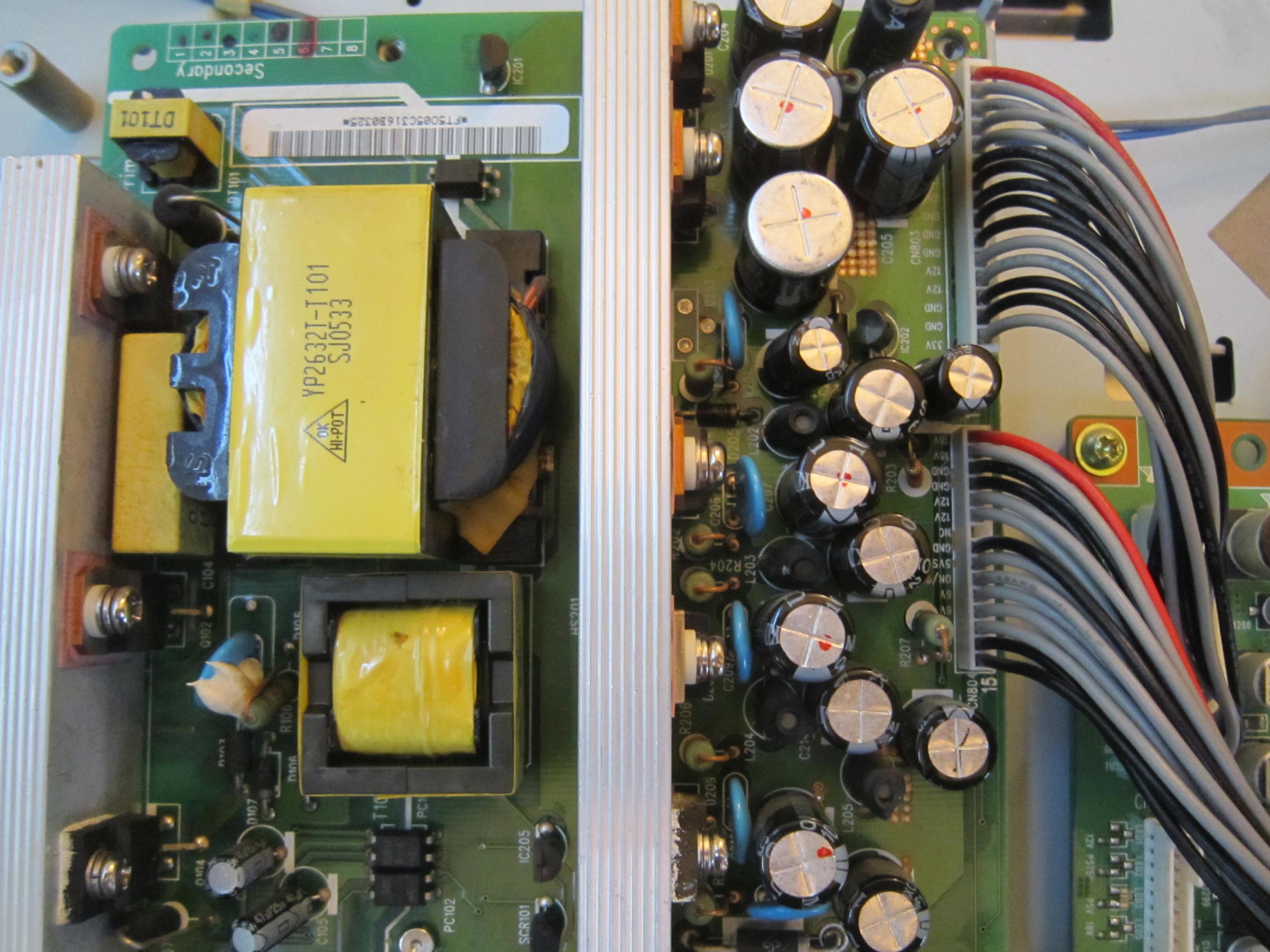

      Thanks for the guidance. Photos of the Power and logic boards attached.

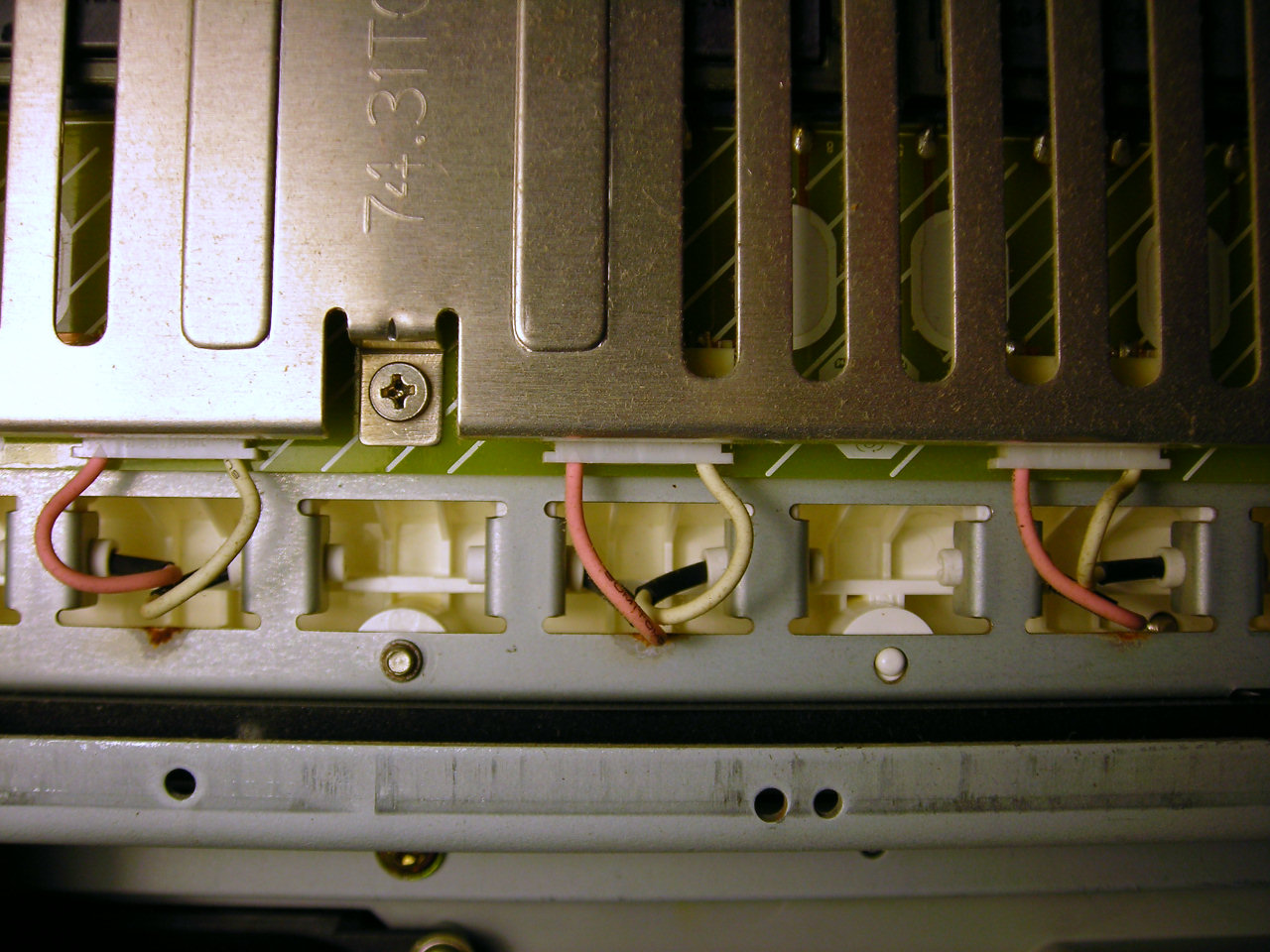

        Same here. No signs of life. Disconnecting PSU from MAIN, 5V STBY shows up. I've replaced C221 and C222 (1000uF/10V, related to 5V standby) and it has been able to start. I've read reports that all caps from secondary must be replaced to do a good repair, even if they're not bulging. ESR from C221 and C222 isn't bad at all, but neither good.
        I guess that C221 and C222 are the minimum ones to replace in any case, because this part of the circuit is alive as long as the TV is plugged to mains (this means always, for most people). Then, other caps degeneration will depend on active usage of the TV.
        On the other hand, as soon as it's turned on I've smelled ozone. This means arcing on CCFL wiring. I've detected that 3 middle lamps wires are touching the metal frame. Rusting can be seen in the point were the cable was touching the frame. One of the cables had damage in its sleeve. Other lamps don't have this problem, because there's a plastic shape that (unintentionally) prevents wires from getting close to the metal. I'll insulate this to prevent further problems, but it seems that all sets will have the same problem.

          Replace the capacitor on the 5 volt stand by rail first of all , in every set I have done it looks o.k but has dried up .

            Also replace ALL the 47uf 25v caps on the primary side of the Psu they are also very common to cause no 5vstby.
