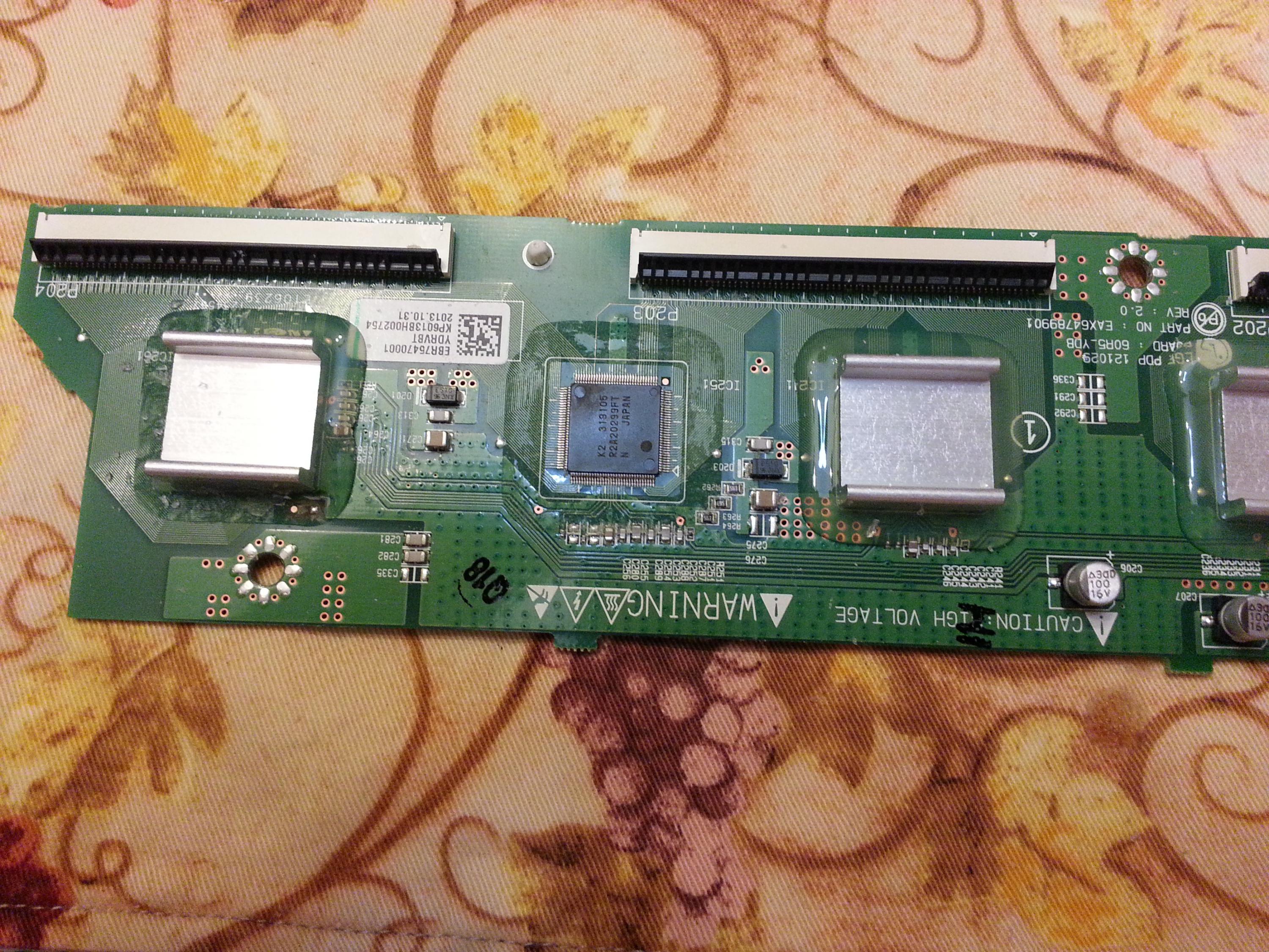

    Have a 60PN5300-UF which i cannot seem to find the service manual for.
    The power supply only provides a VS(200v) a VA(60v) and a 5mv(5v) to the z sustain.
    Then from the Z sustain we have a connector that jumps over to the Y sustain.
    Problem is my 15V line is only producing 5V(5.45v) i have other lg service manuals that show the 15v being supplied from the Y sustain but those models are directly connected to the power supply, which in this model it is not.
    anyone know the source of the 15V on this model?
  • football0062
    • Dec 2011
    • 98
    Re: 60PN5300-UF with 5v on the 15V line?

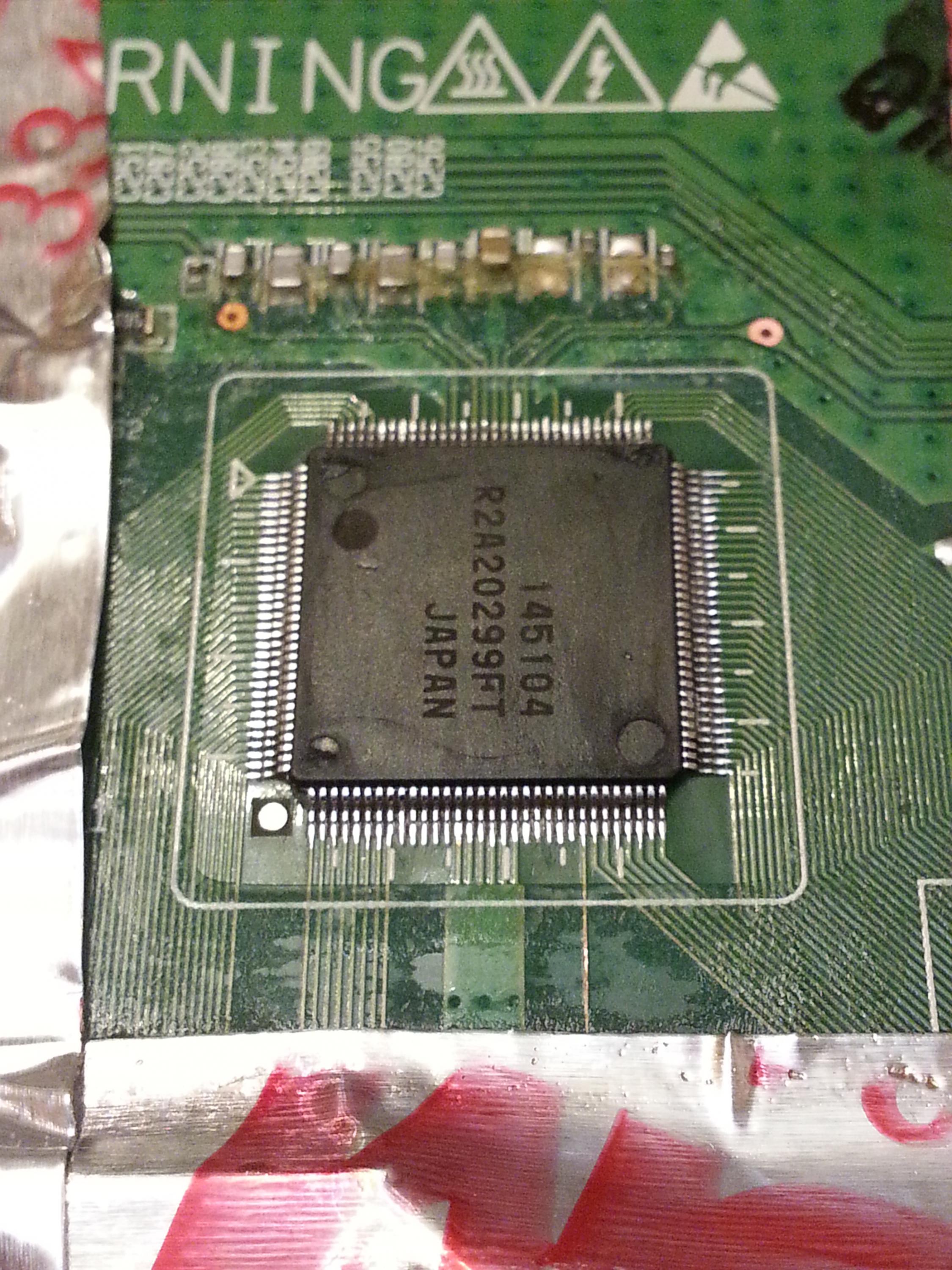

    The 15V is actually produced on the Y sustain still and is sent to the Logic(which i dont believe the logic board uses) and Z sustain board.
    The problem was that one of the buffer IC's had gone bad causing excessive load on the y sustain. luckily i had the correct IC around and replaced it. Tv is now working perfectly.
        Really ! I will quickly order for spare parts (IC251 R2A20299FT)
        I don't understand, u didn't have ( BGA rework station with Optical Alignment System). How could u solder so neat !!! Am I talk to a robot???

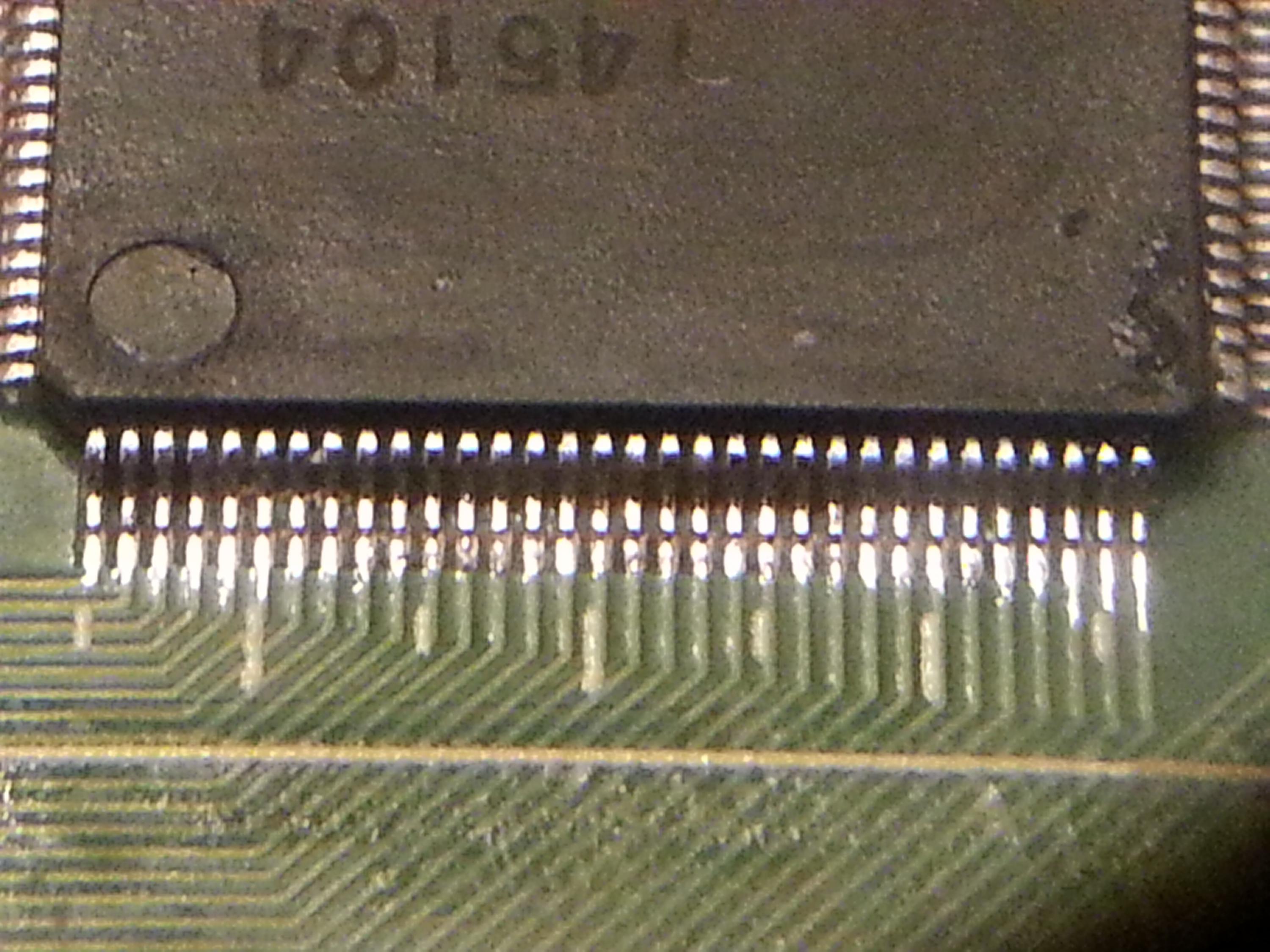

          im sorry i meant M5V not 5mv, as labeled on the board. i know the 50" panels go bad because of the cable being so close to frame screw and have already had to scrap 3 unit due to that. but this 60" model looks ok. a little more space.
          just used a hot air gun from hardware store and no clean flux paste and my weller PES51 with a ETS tip. oh and a 10X loupe
              Thank you for your Tips , Indeed.
              TQFP 100 Pins ICs ,they use robot to put in place and solder the IC chips.. I mean you as good as robot .Hop! you don't misunderstand,My Apology!
              This is the best investment I ever made, before I use paint-strip-Killer-heat-gun.
