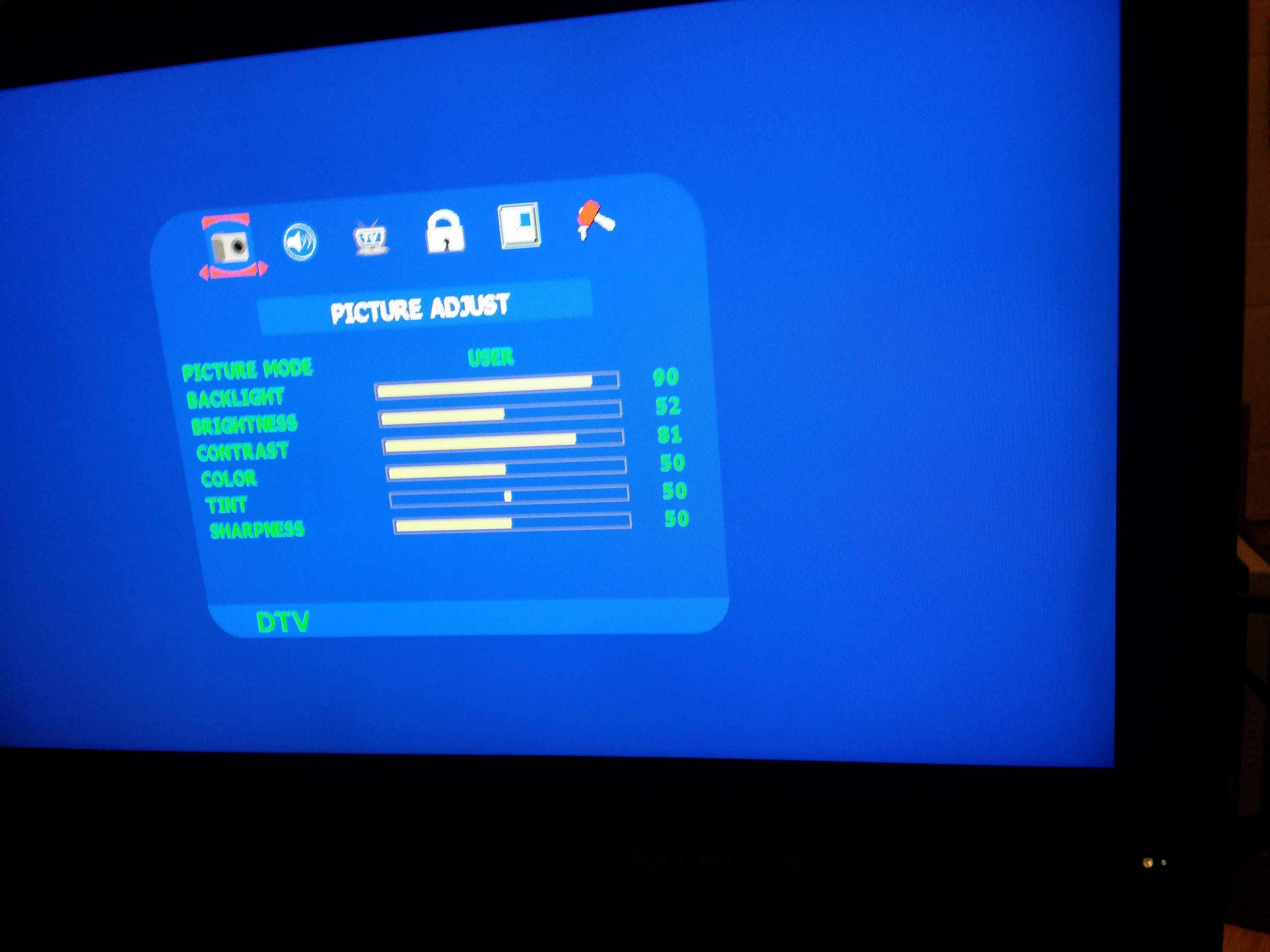

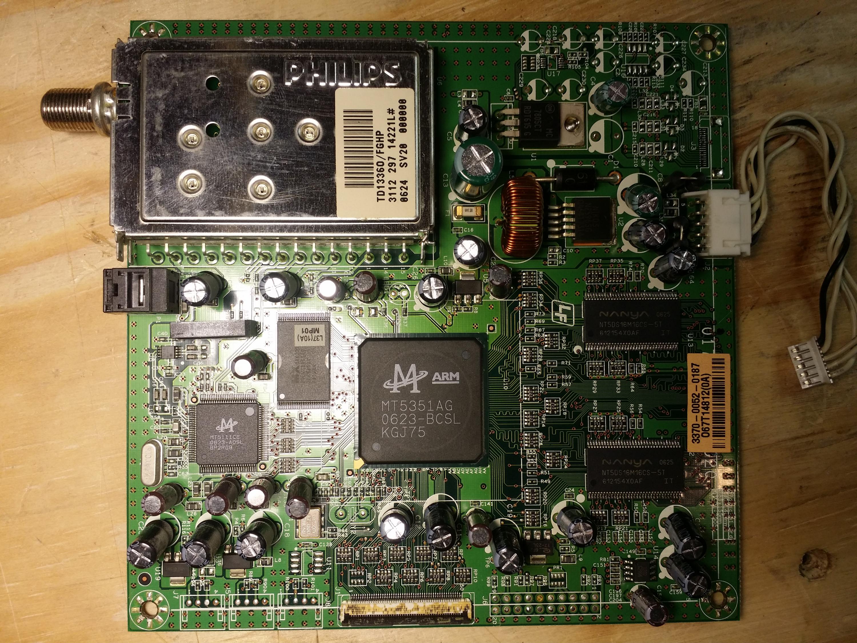

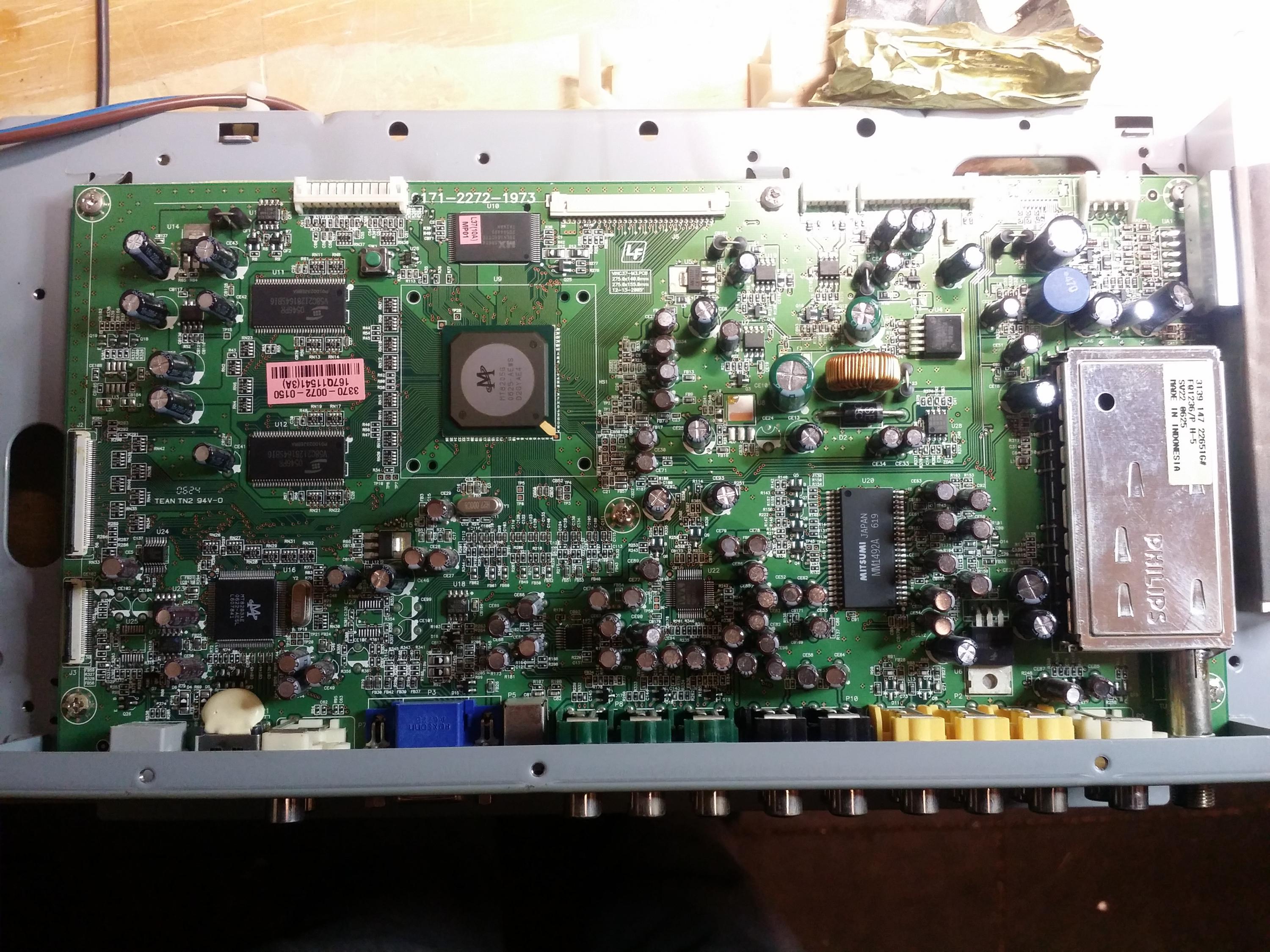

    So i picked up this Vizio from the dump today. It turns on and works except for the HDMI and the DTV. the weird thing is when i go to the menu and attempt to do a channel search the OSD goes away and the TV is unresponsive but i can still turn it off. All other menu options work until i get to the Channel setup sub menu. I've checked the voltage regulators on all the main board and the digital board and they all are ok. Any Ideas? The Main Board P/N: 3370-0072-0150, Digital Tuner P/N:3370-0052-0187

    I would at least check the Voltages of the regulator ICs to start with.

      I checked all the 1117 voltage regulators on the main board and the digital board. they all seem fine. I'll check the smaller ones tonight. I need to figure out what controls the digital portion of the TV. there is a separate sub-menu for that portion. that's where it locks up

          A solutions/recommends are:
          1. Acquire and update the Firmware.
          2. Replace the Main Bd. if available.
          I would go for the 2nd option, as it may be easier.

            I picked up the set, picked the "dtv" option from the input source. Went to the menu to select "tv" option the screen goes blue and the menu disappears. Can not get the menu back unless you turn the set off.
            Tried to find the firmware update on the Vizio website but no luck finding it.
            I considered replacing main but if the board does not have the latest upgrade I'll be back to square one.
            Asking to see if someone on the list would know where to get the upgrade(if one exists).
