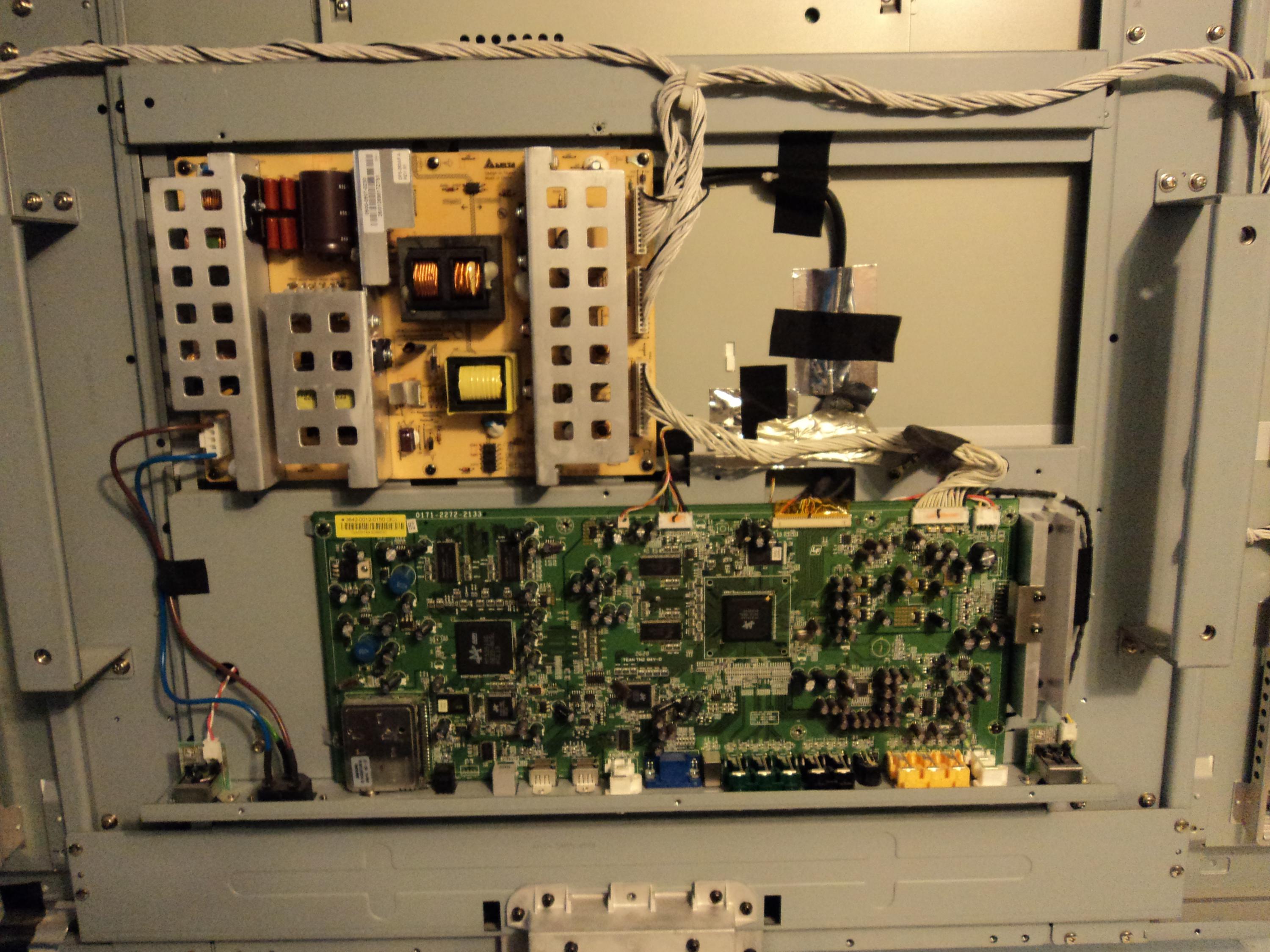

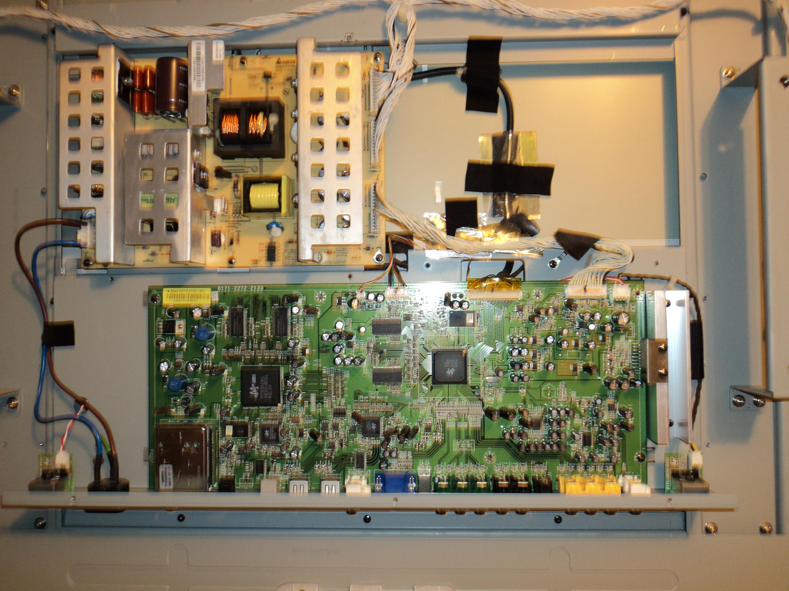

Hi,i have vizio 42" hdtv,with no picture or sound,when you turn it on the light turns white then yellow and does nothing else.one day it just stopped working,no pop or anything.I opened it up,the main board is 3642-0012-0150,there is no visual damage anywhere,do not know how to test,its about 7 years old,any help would be apreciated,thanks

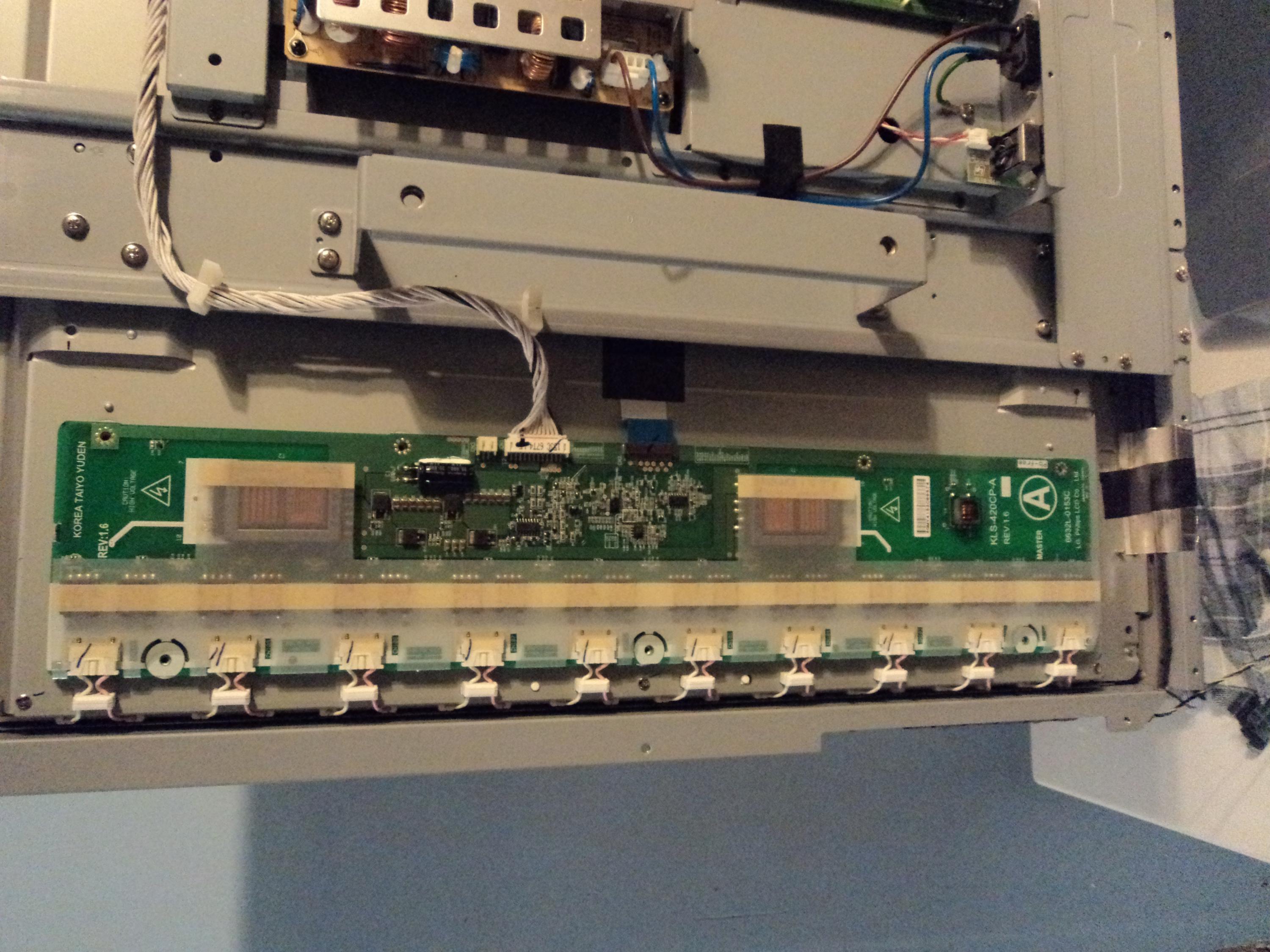

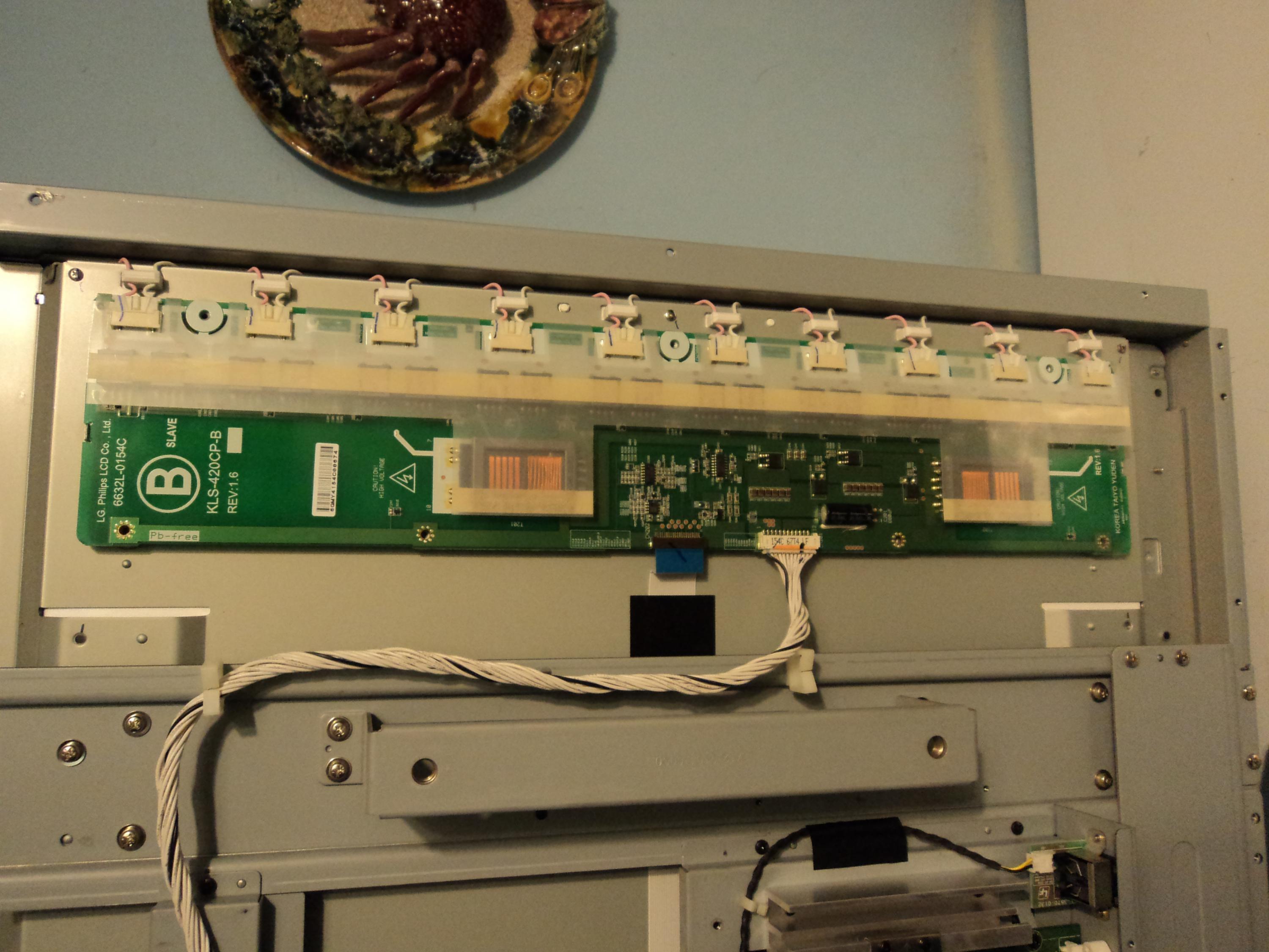

You can start by up loading good clear pictures of the whole back side of the TV so we can see all the boards and how they are connected together.
It may be just the fuse on the main board or bad regulators.Never stop learning

The large white connector (that goes to the power supply board) to the left of the small white connector on the top right of the main board, there are two white fuses just below the large white connector that you need to check the resistance and the DCV on both ends of the fuses using chassis for the meter black lead.
BTW, the pictures are not very well focused at all.Never stop learning

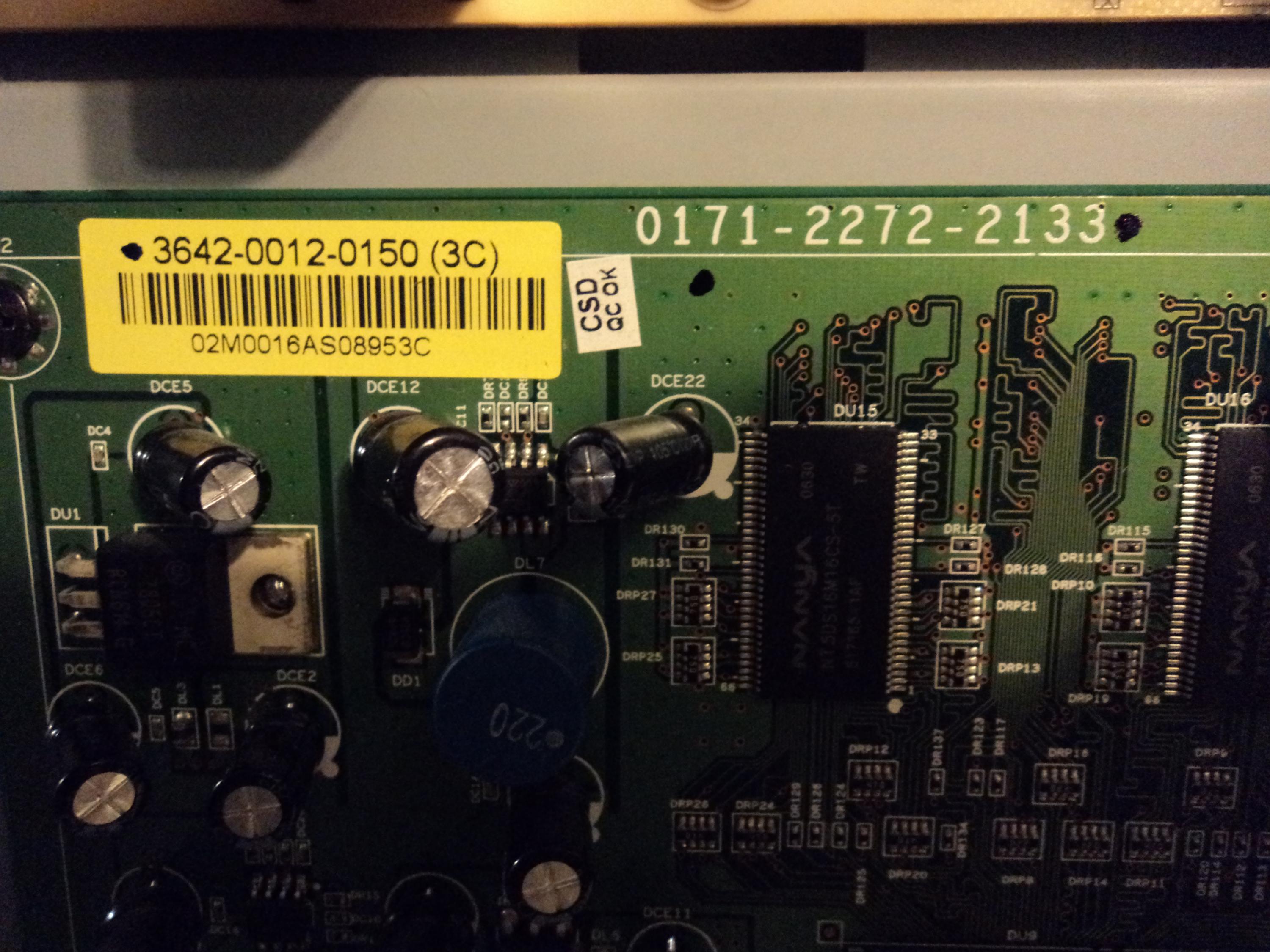

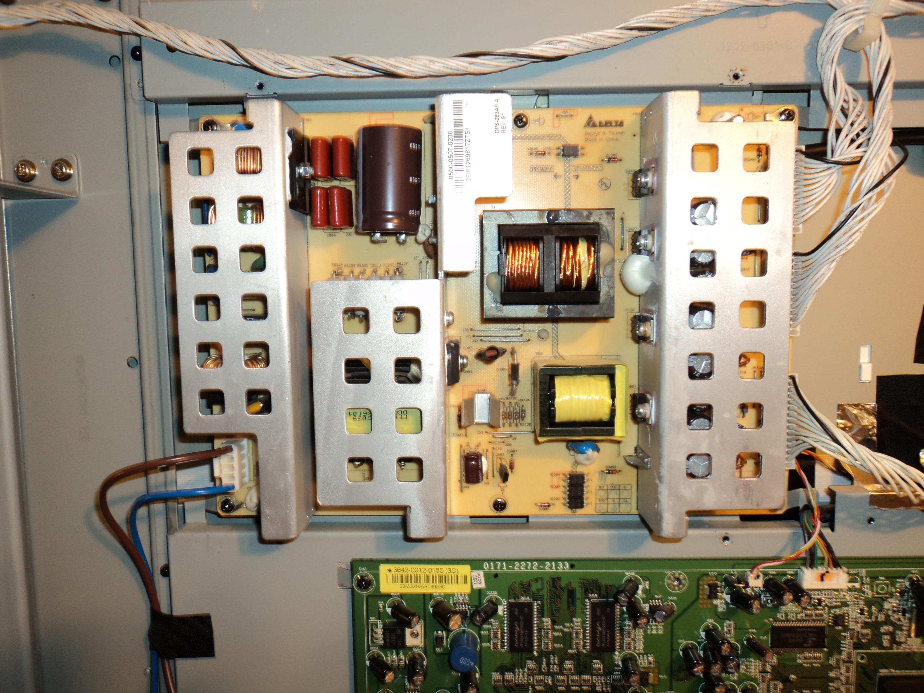

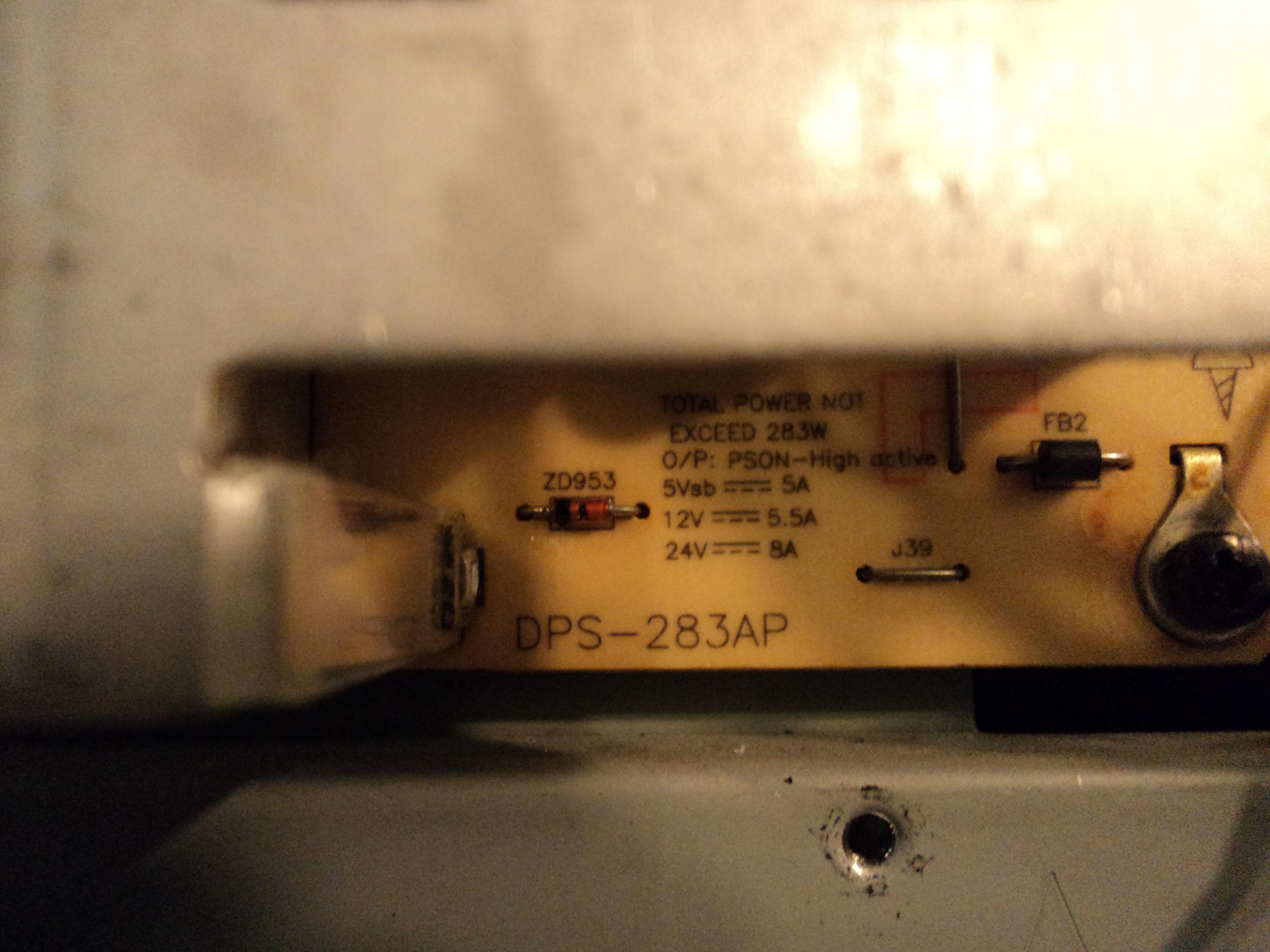

What are the P/N as printed on the barcode stickers on the power supply and the main board?
This is your main board?
http://www.shopjimmy.com/vizio-3642-...-gv42lhdtv.htm
The power supply is DELTA DPS-??????Last edited by budm; 03-24-2015, 03:22 PM.Never stop learning

here are some more pictures i hope they are better,thanks for your help,,i tried to test the two small fuses on the main board,these are my readings,on one i got 1.459 and i believe i think you call it the resistence 1.302and on the other 2.86 and 2.63,thanks again.there is also the barcode of the main board.Comment

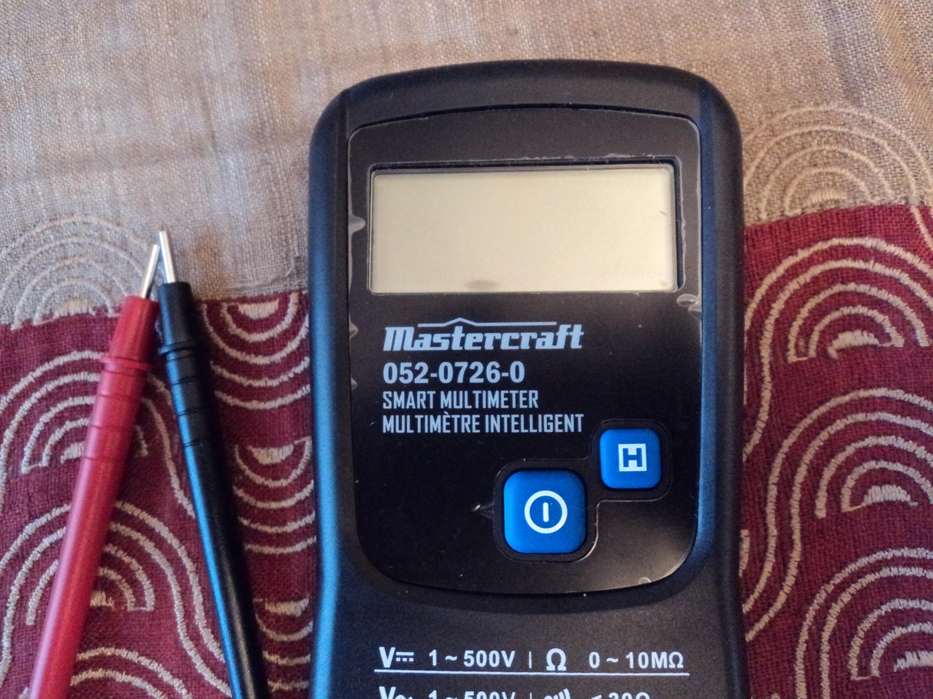

If your not sure how to carry out any tests etc we ask you to do just ask we can advise you how to do them also a picture of your multi meter may help if your not sure what setting you need to have it on.Comment

I do not know how to set your meter function to DC Volt mode for testing the DC Voltage so read you manual and then try measuring a 1.5V battery to see what shows up on the meter. When you make the Voltage measurement you will put black probe on the chassis and the red probe for probing each pin of the IC.
Just make sure to report the reading in the format as shown in the link, that is very important so it will not cause confusion and wasted time.Never stop learning
