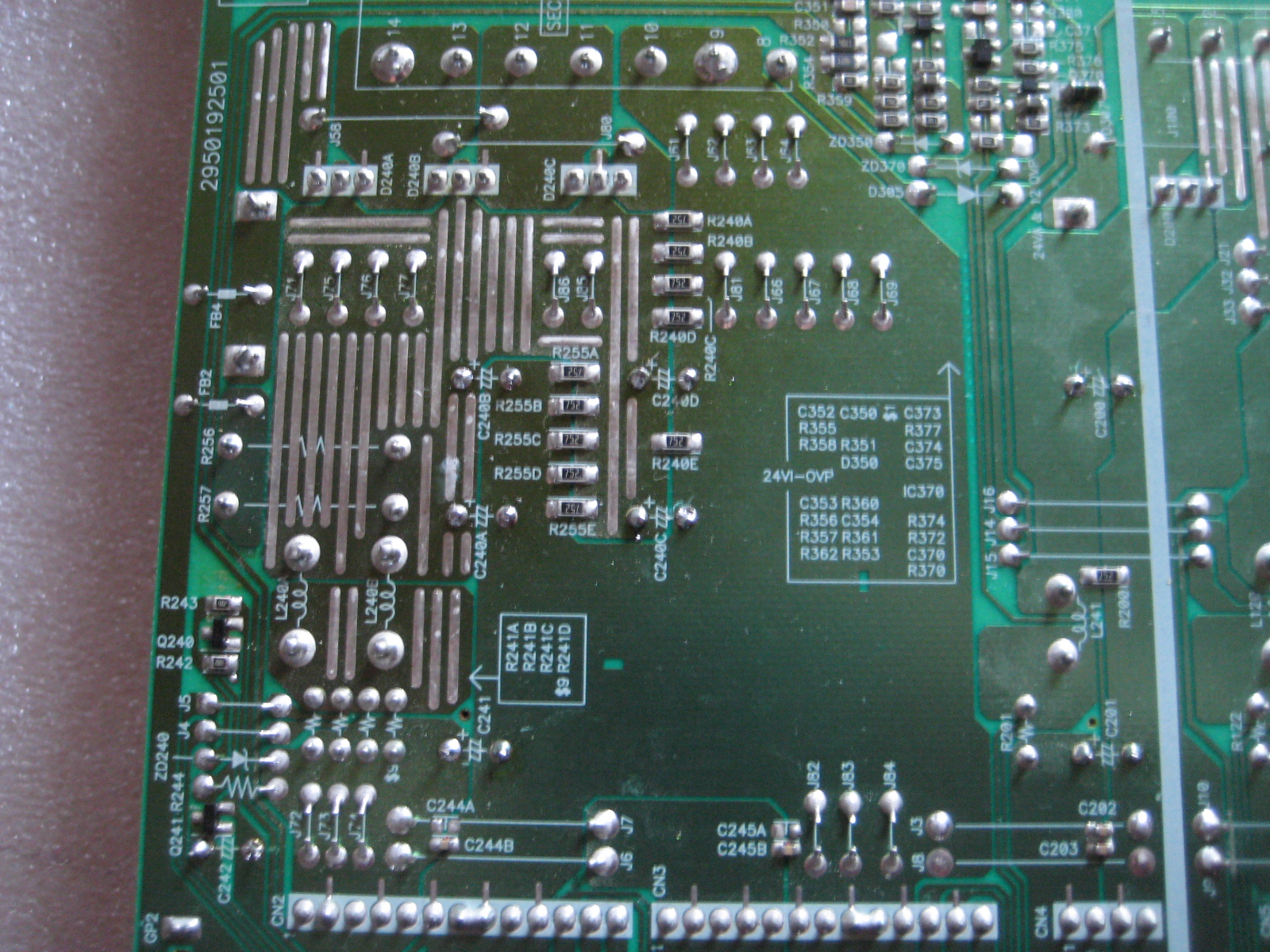

    Vizio 47 vo47l power supply DPS-433BP
    in left lower side, C241(below arrow) is 470uf, 35v, always blow out after replace it. I know some components are bad. no idea which? Hope someone help me. after blowing out, tv is still working normal. I have some tech skills, but need to learn a lot. Thanks.

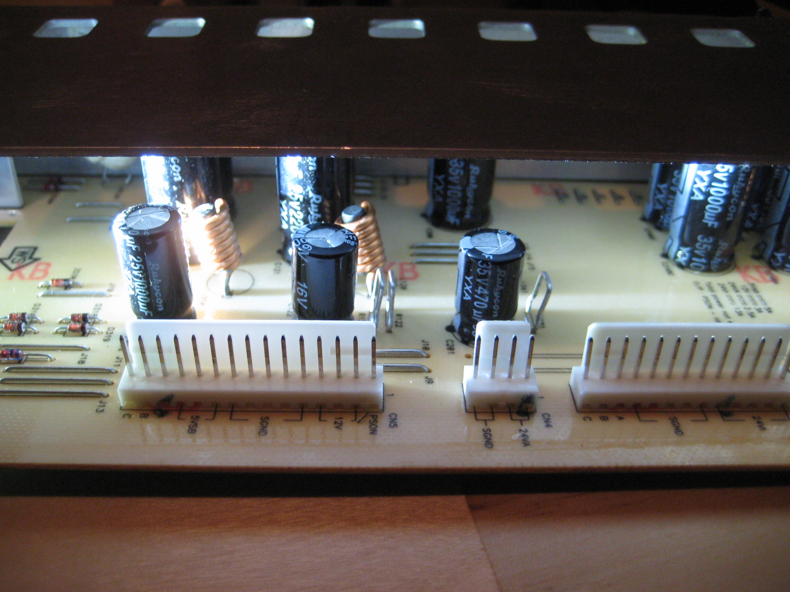

      Re: Vizio 47 vo47l power supply DPS-433BP
      can you make another picture from the other side of the board? Those caps have to be installed correctly, other than that, they will blow, as budm already mentioned. With the cap removed, maybe put your DMM in DC and see how much voltage is there where the + and - of the caps go.
        please check pictures, thanks.
            I can see that the cap C241 is installed correctly, so the new one has domed top and blow up after a minute, I would would expect the other 4 caps (C240A~C, 1000uF 35V) caps to be damaged too if the Voltage had gone up way pass 35VDC since these 3 caps are part of the Pi filter.
            Can you verify the Voltage on the caps to see what it is?
            Notes: now I see that the pictures show the original caps not the new caps in place.

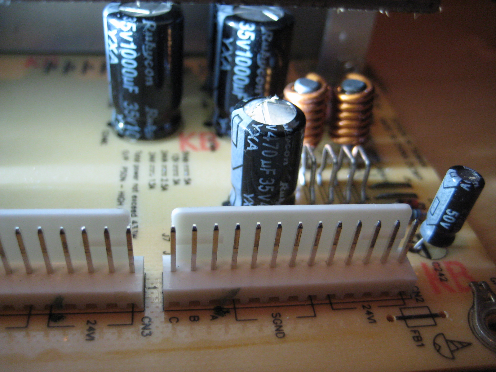

                    Cording to the pics, the cap is installed correctly. So what voltage do you get on CN2 with the 24V pins to SGND? That's where the blown cap is in between those points. May be worth looking with an oscilloscope to see the ripple on it.
                      no, these pictures are new caps.

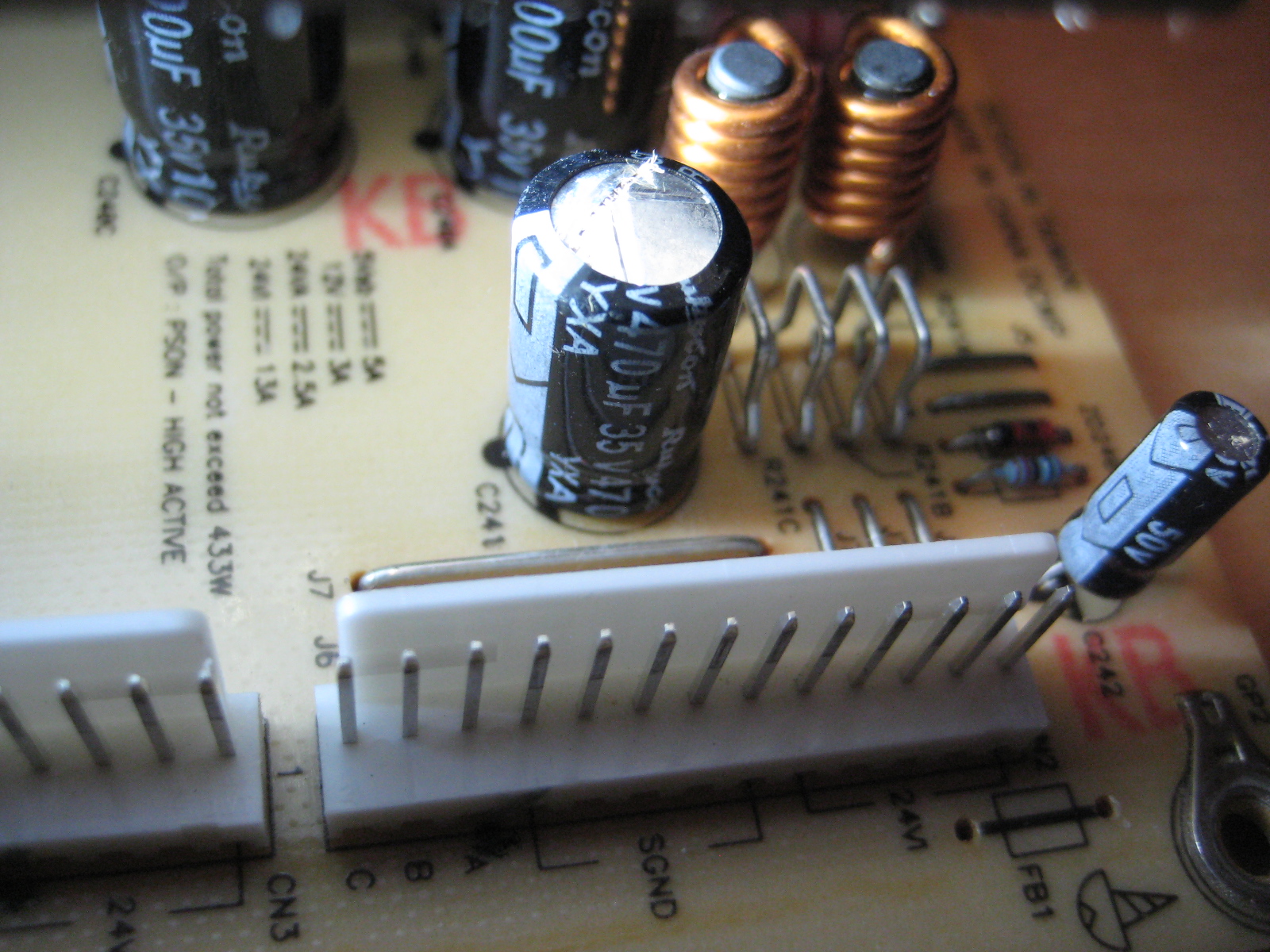

                                  all of the caps(C240A-D, C241) are 24.01V or 24.02V. I replace C241 with 50V, 470uf. TV is working now a few hours, now is ready to blow out. voltage is ok, I think if current is problem? Thanks.
                                    Is that a Rubycon XYA series? Coming off ebay I wonder if it is a fake. Does the cap get hot? Did you check the ripple on that cap with and oscilloscope?
                                      I bought this 470uf, 50V from local store. it's esr is 016. maybe half an hour, it bulged. replaced with another esr 0.09, 470uf, 35v cap, in 30 seconds, it bulged. only this cap bulged, no others, and voltage is 24v. why it bulged again, again? I think it bulged so fastly, should not be because of esr, it is something else. yes, the cap got very hot. sorry, I don't have oscilloscope, only have multimeter and esr meter.
                                        Did you replace the 24V rail filter caps? If you have a true RMS DMM, you could try to measure the AC component on that cap that wants to blow up all the time. If your meter is not true RMS, try to put a series cap on there. Other than that, I am running out of ideas.
