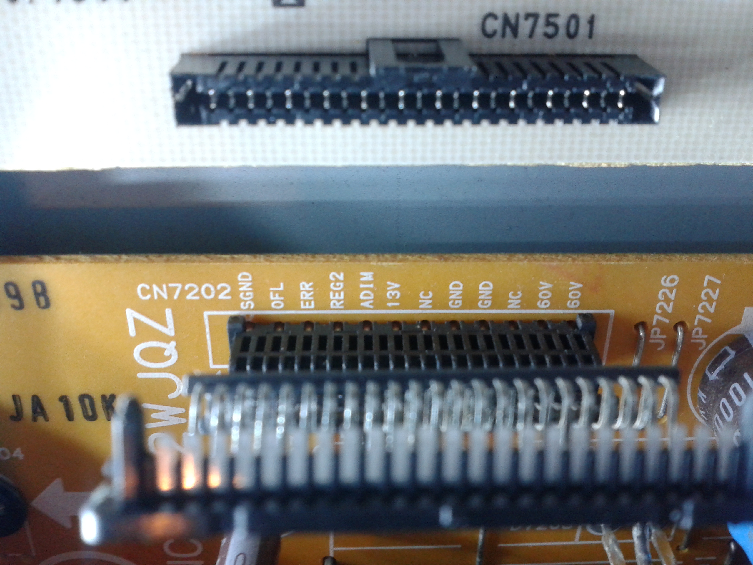

          I mean the little bridge between the power board and the inverter is disconnected.
          yes, there is labeling on the inverter board connection from the PSU. see attached picture.
          Getting 64v on the 60v pins.

            Re: Sharp LC37SB24u won't stay on
            Looks like we can see only every other pin out, not all of them. There is more behind the connector
              Please list all the pin names.

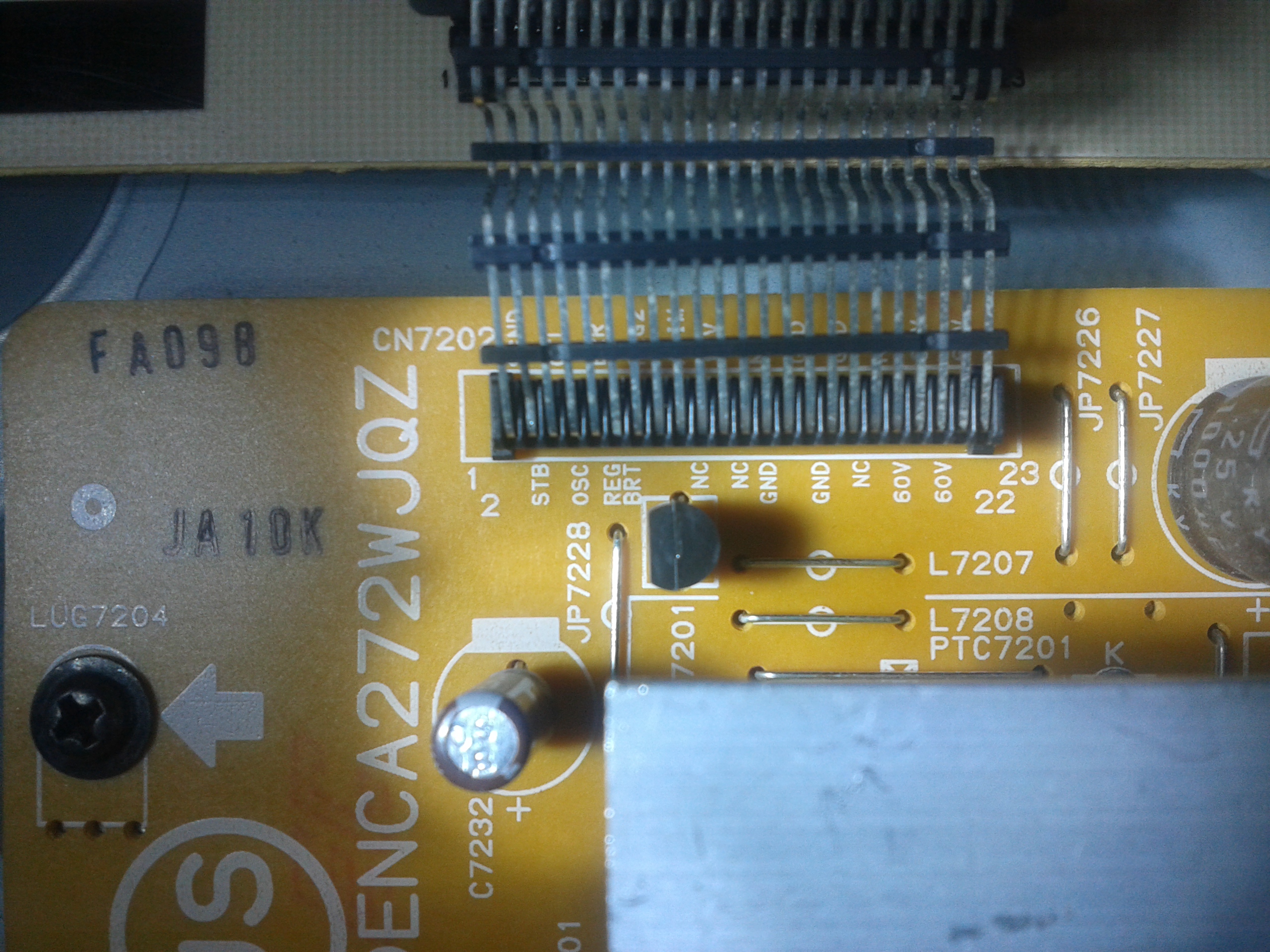

                Oops, I missed that. Here it is.
                    I get voltage after power on until it goes into protection mode. Here is the pin out to the inverter board:
                    GND 0
                    STB 3v
                    OFL 0
                    OSC 0
                    ERR 0
                    REGBRT 0
                    NC 0
                    ADMIN 0
                    NC 0
                    13V 13v
                    GND 0
                    NC 0
                    GND 0
                    GND 0
                    NC 0
                    GND 0
                    no label 0
                    NC 0
                    60v 64v
                    60v 64v
                    60v 64v
                    60v 64v
                      if you disconnect the inverter from the PSU, does the TV work normal less the back light?
                        It does per post 1.
                        I do not see the BL-ON signal pin on that list of the pin out.
                        Also the dim control signals and other signals also showing 0V which do not look right.
                            Yes, good observation Bud. I wonder if the pin without a label might be BL-ON.
