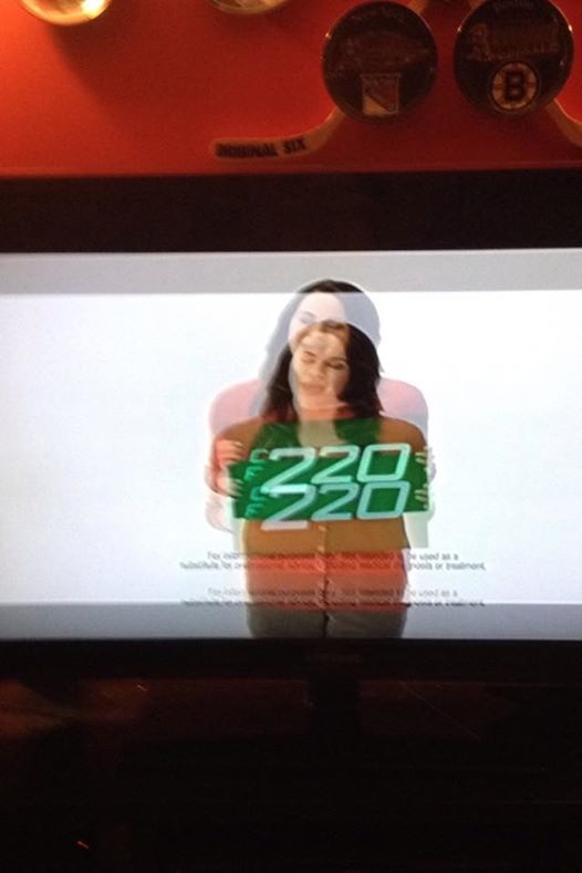

Sammy LCD ghosting. Is this a bad panel?
  • sugar_ray
    • Dec 2012
    • 121
    Was sent pics of this Sammy so not sure of model # yet? Its ghosting the picture. Everything else works great. What should I be looking at boys?? Tcon?? Or bad panel?

    Re: Sammy LCD ghosting. Is this a bad panel?
    Does the picture get better if you gently try and twist the tv frame or press at the top of the tv because it might be bad tab bonds
      Not sure as the tv isn't in my possession yet. They just sent me that picture and wanted to know if it's saveable? Other then a bad tcon or LVD cable?? Will have to see when I get it
