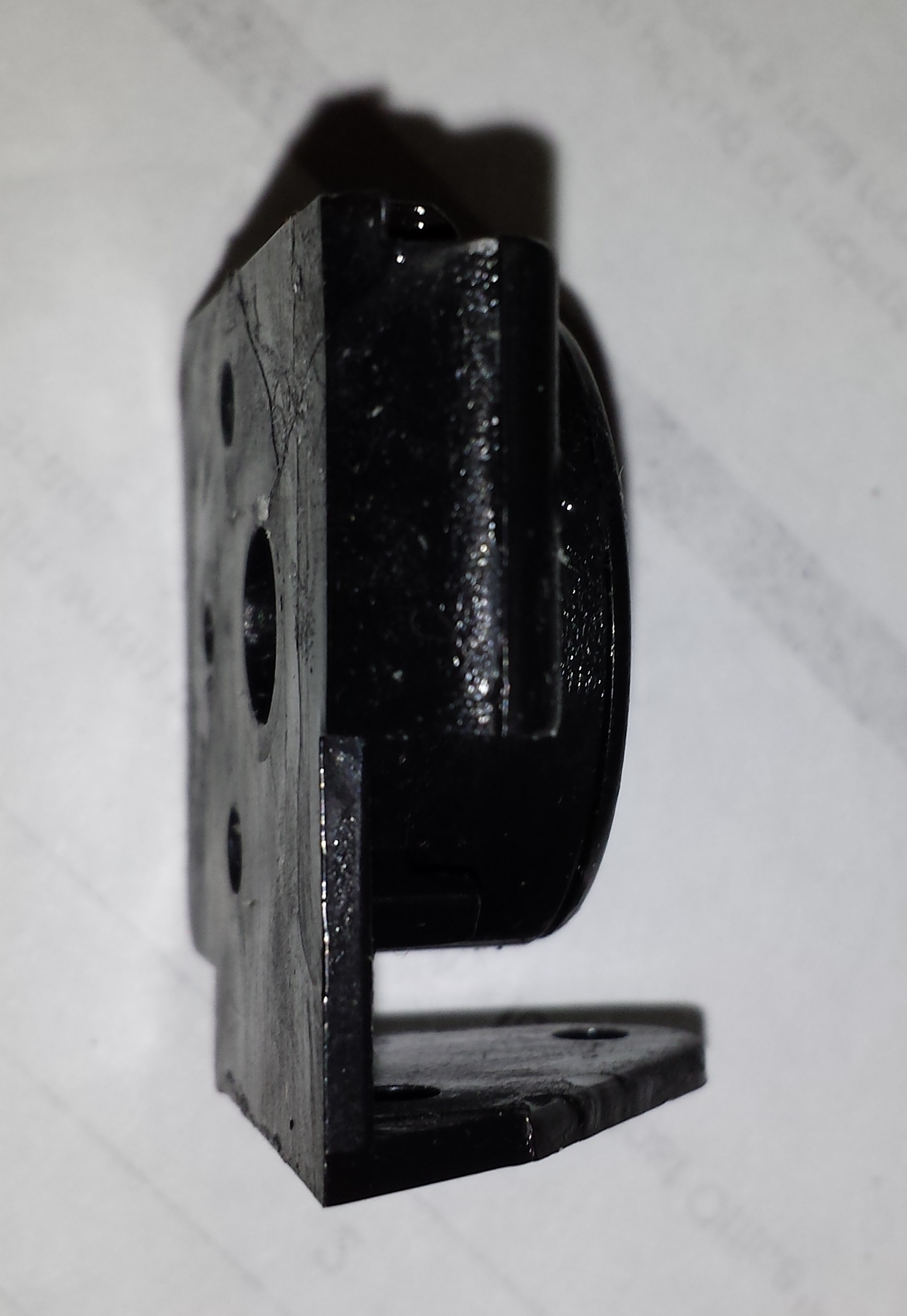

    Decided to fix this one more time. I'm going to turn the temp down to 350°C and see if it will last. It's obviously a terrible design if you can turn it up so high that the element will burn out. I'm wondering if they screwed up on the sensor circuit and it's not reading right. I should probably get a tip temp tester and then, if it isn't reading accurately, I could probably modify it.

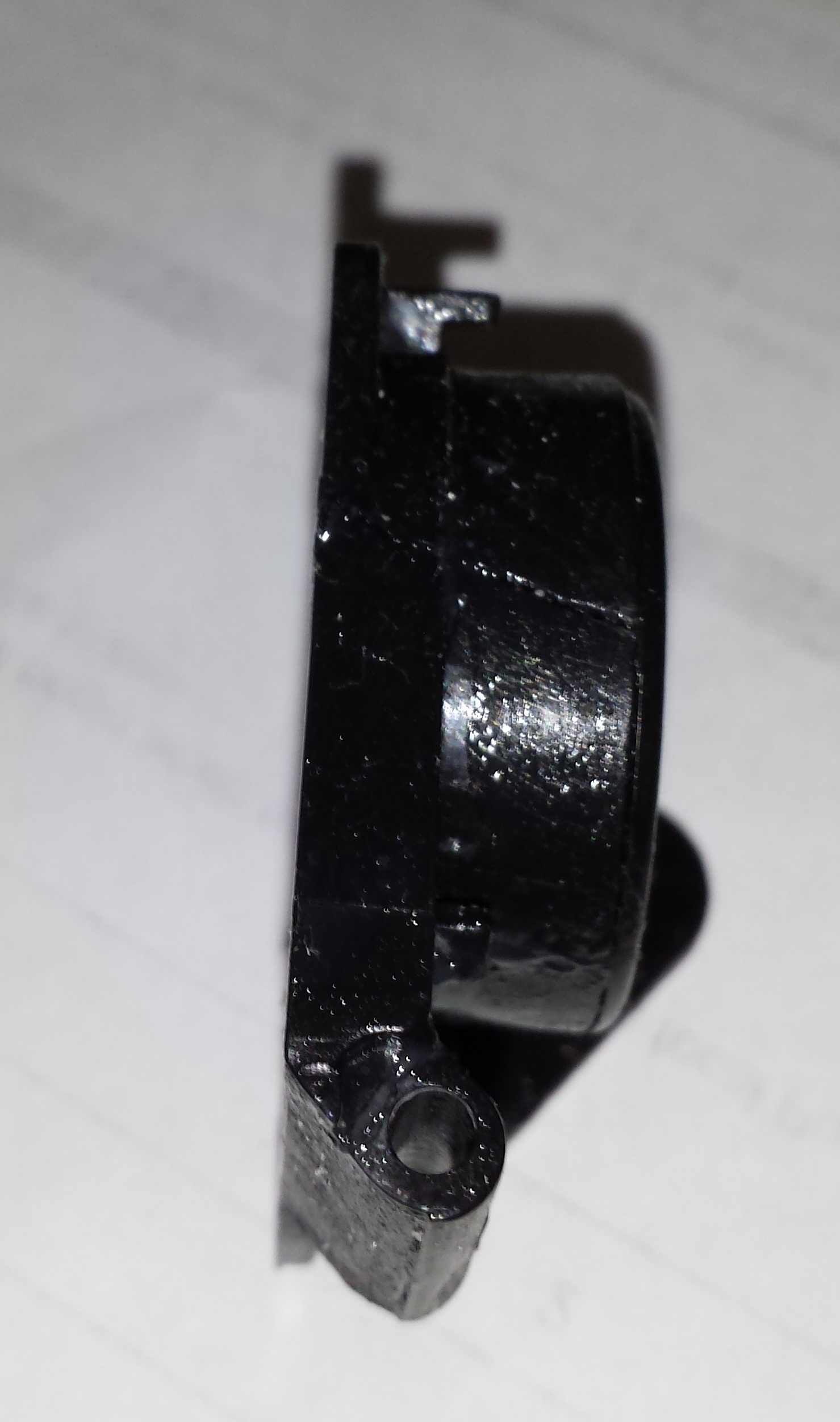

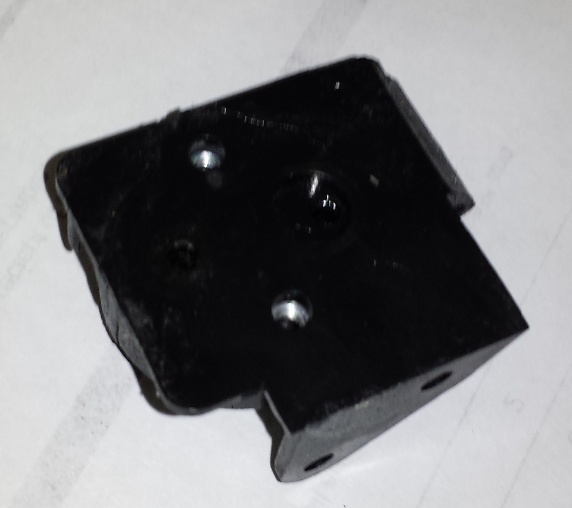

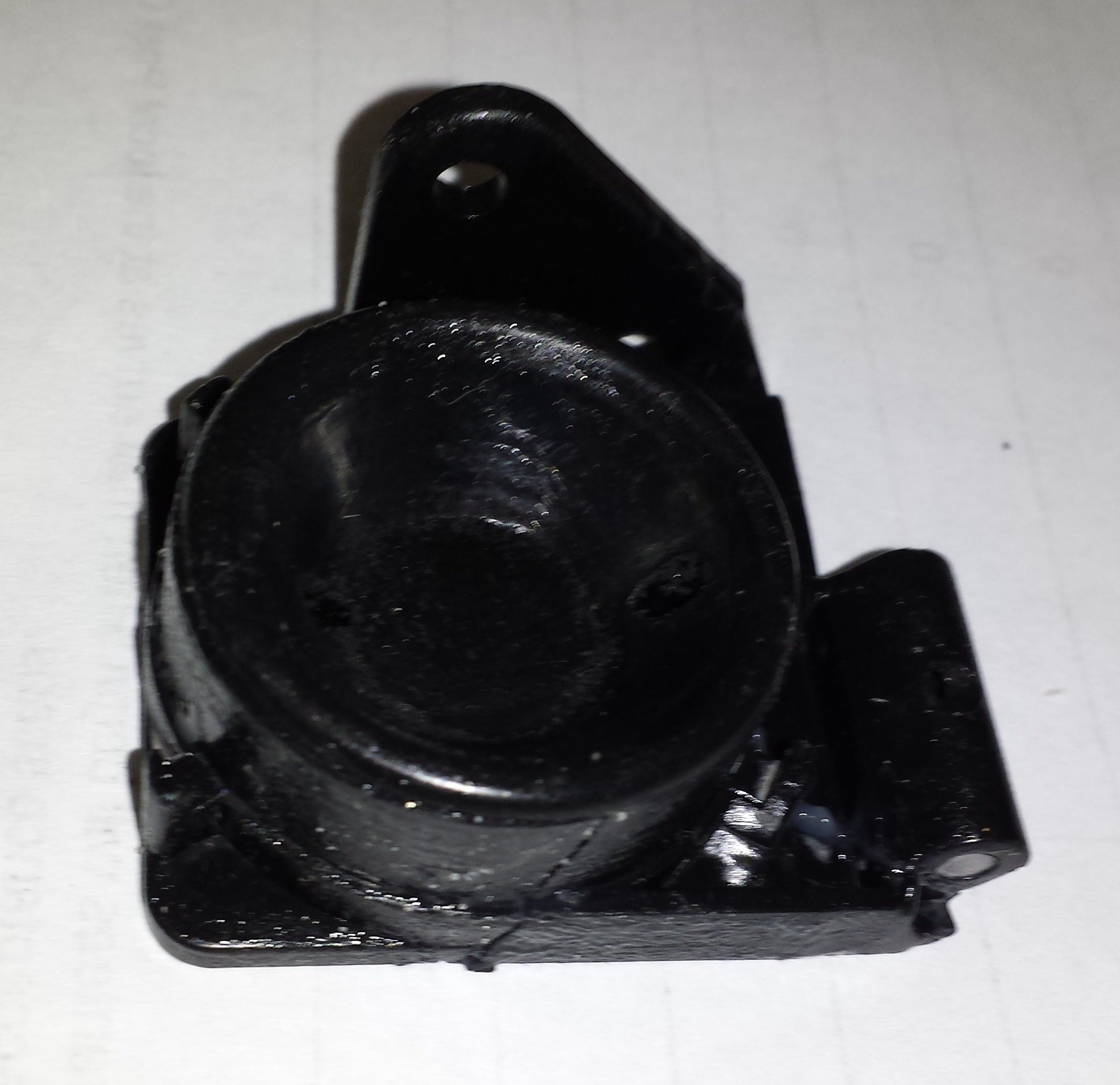

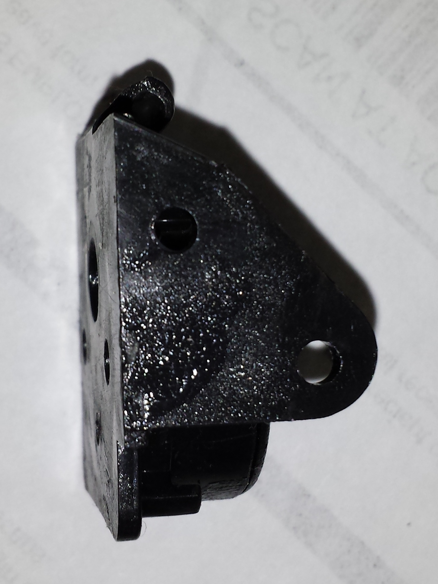

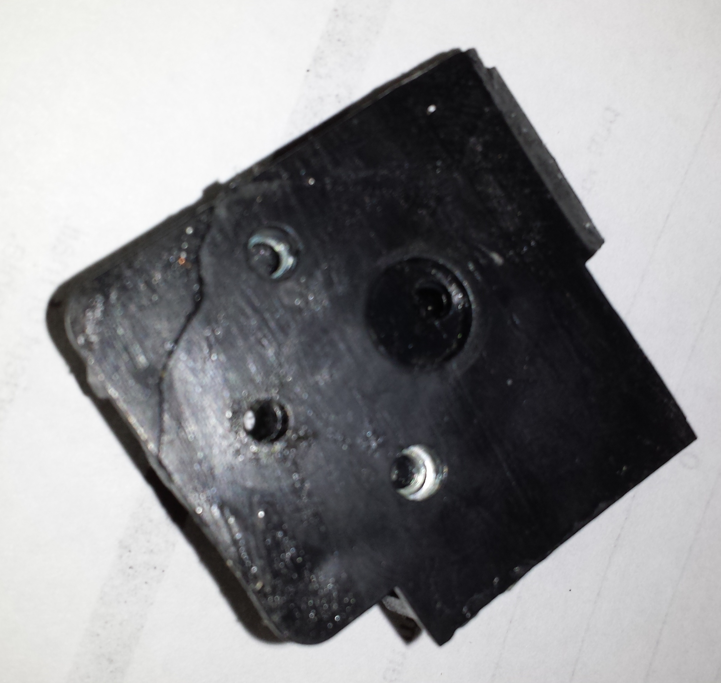

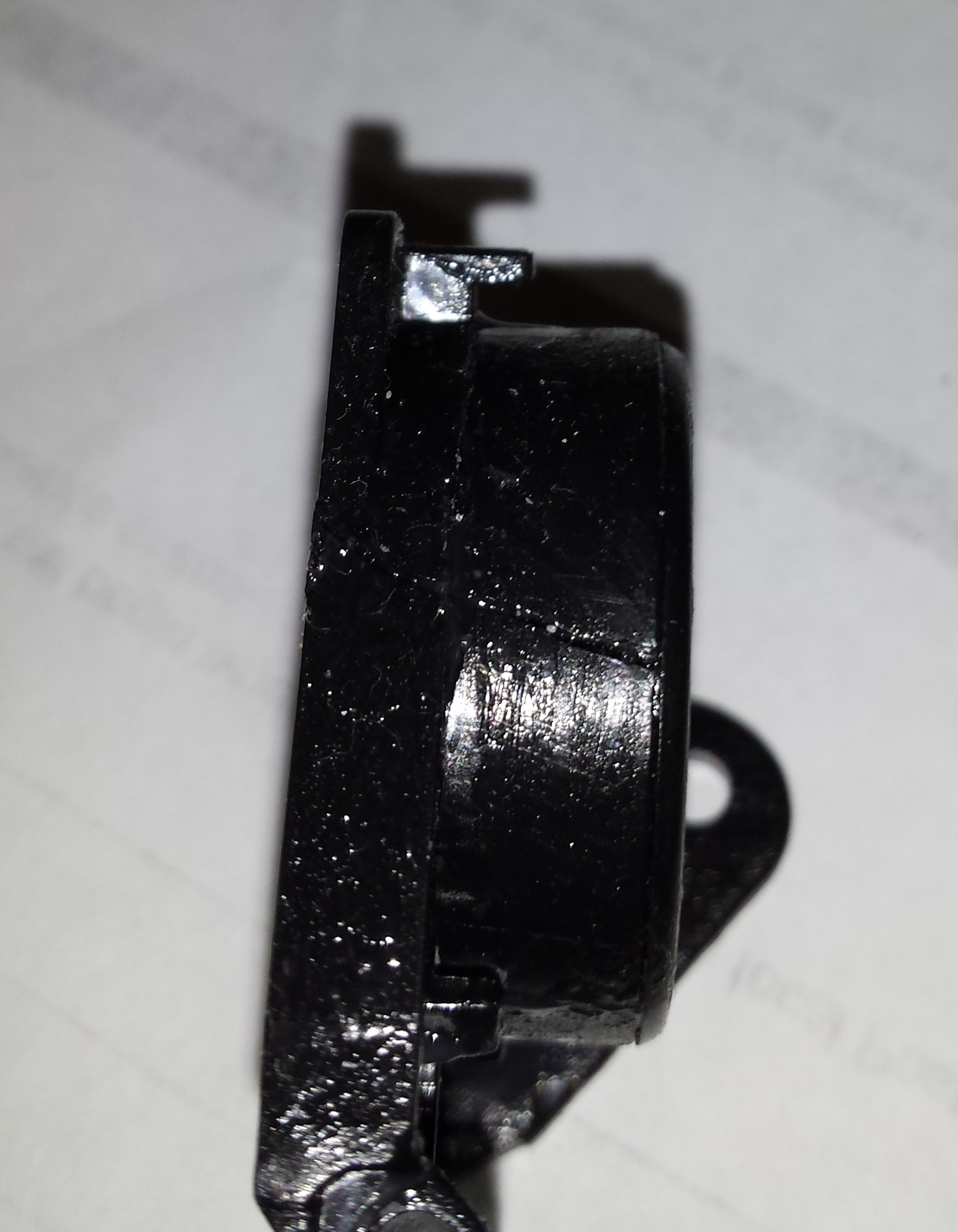

          Re: New tool, Aoyue 8800! Desoldering just got easy!
          I got it heating again, but no vacuum. I forgot about the cracked pump housing. Can't find a replacement. Might have to modify it and add an external pump.

            #145
            patch the housing with rubber compound - you have nothing to lose trying.

              #146
              I tried using silicone adhesive. It might work. Too bad I don't have a 3D printer. The thing that really pisses me off about this is that the typical repair parts which a person might need are not available. I'm still going to buy the Hakko one, but right now I have other obligations. I'll coat the entire thing in silicone if I have to.

                #147
                can you post a foto?
                btw if this the the clone type with a pump in the base, i'v seen spare pumps sold cheap.

                  #148
                  I'll do a teardown this weekend and post pics.
                    No wait!
                    Contact Aoyue support via skype:
                    http://www.aoyue.com/en/contact/
                    they have ALL replacements for this unit (not only what you can see on their website!)

                      #150
                      Here's the pics of the pump. I don't have time to do the full tear down like I wanted to.
                        Originally posted by alex987
                        No wait!
                        Thanks Alex. I'll contact them tomorrow and see if they have it. Although it would have been cool to mod it into a station instead of a portable. Easy too. There's already a port on the bottom of the handle for the vacuum hose, and if the 24v for the motor comes from the power unit (I think they do), it would just be a matter of splicing the motor wires in the unit, and cutting them in the power box to connect to the motor. Unless the 24v is rectified and filtered in the gun, then it would require either making a board to do that, or adding a pair of wires from the gun to the new external pump. Either way, still easy.
