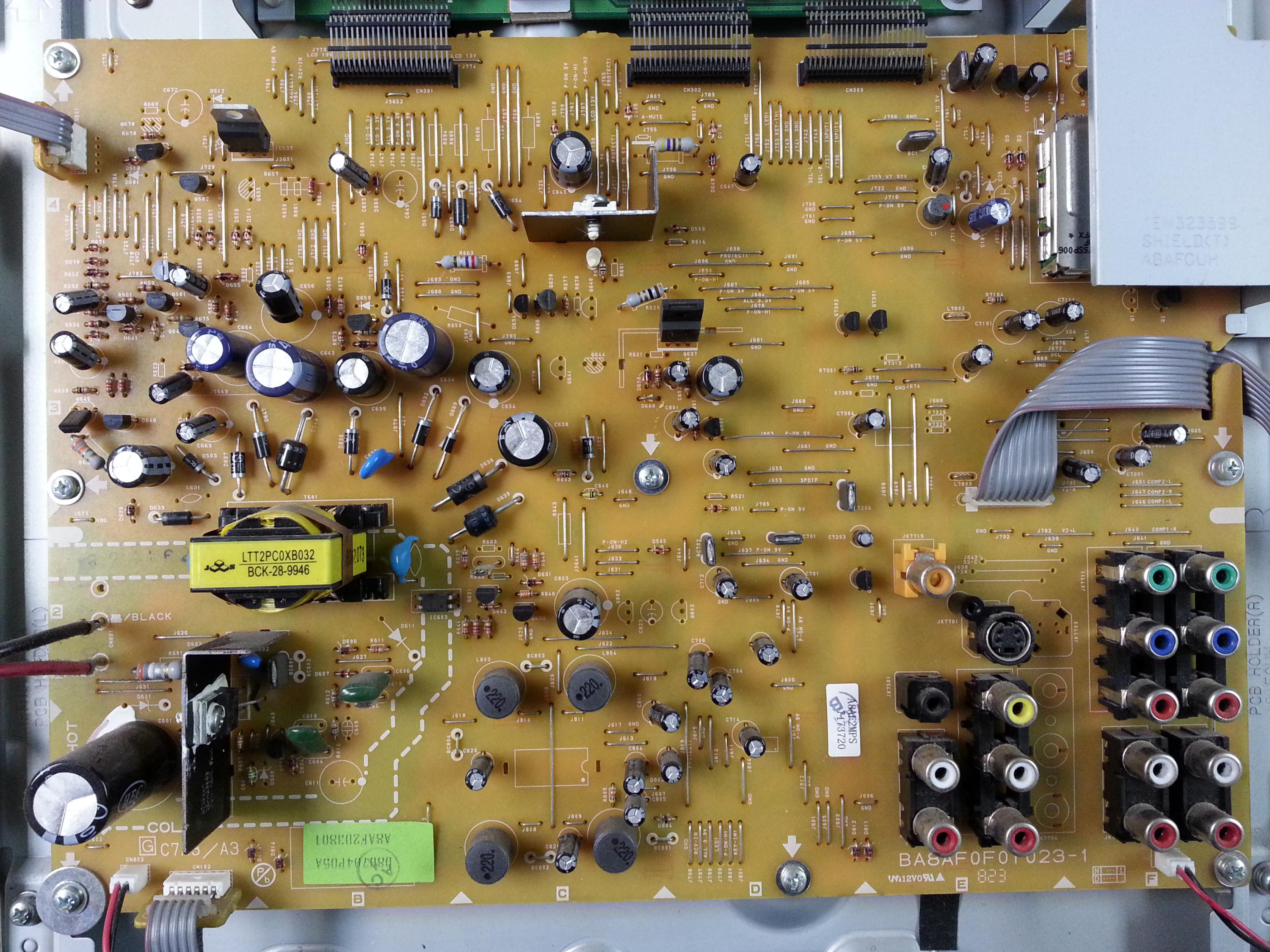

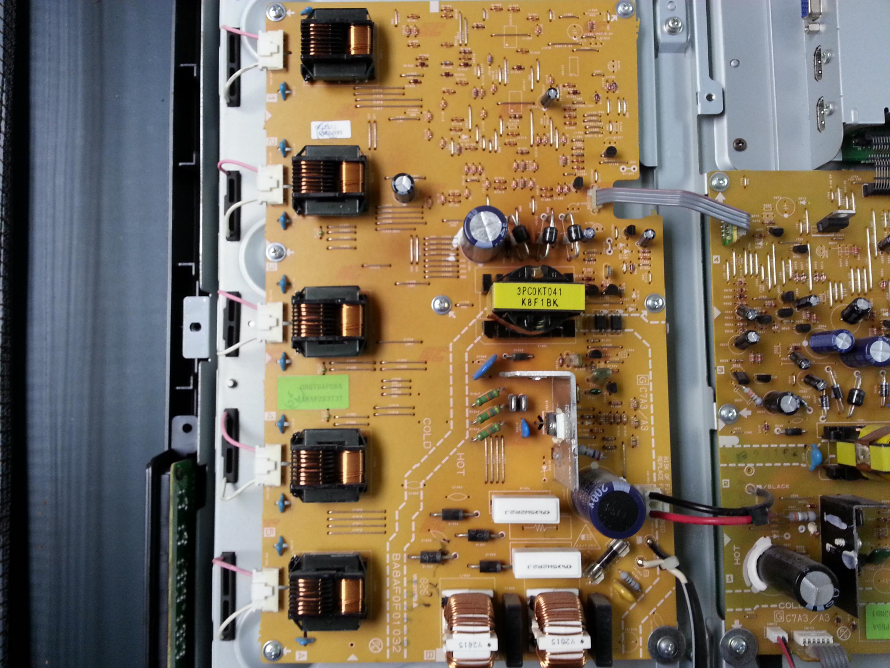

    This Magnavox 32MF338B 32" LCD television recently stopped working. No power light, nothing. Further inspection revealed the fuse by the mains input on the MUT board was blown. I can't see any obviously damaged components on either that or the MTS board. It's kind of tricky because the power supply stuff looks like it is split across the MUT and the MTS. Any ideas as to how to nail down where the problem lies?

    Disconnect the red/black cable between the main power supply/inverter board and the sub power supply board, then check the resistance between the Source and Drain pin of the power MOSFET mounted on the heatsink and the main rectifier diodes of the main power supply/inverter board (where the main AC fuse is) to see if it shows low resistance.
    Then check the S and D pin of the sub-power supply board power MOSFET.

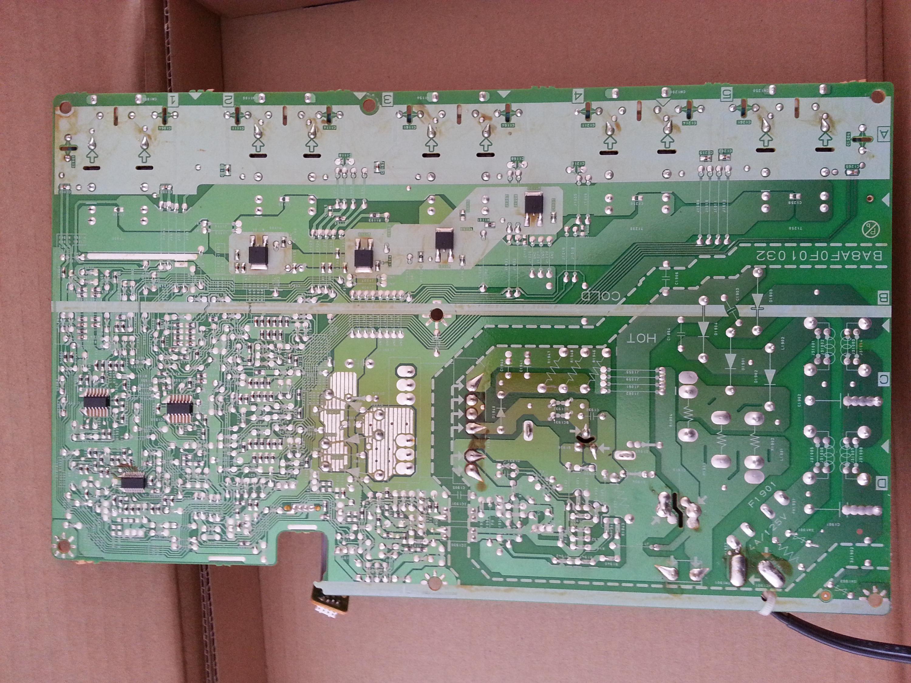

      Don't forget to look at the back side for SMD diodes that might be shorted at the secondary.

        I checked the four diodes at the bottom of the board, and the one at the bottom right does indeed appear to be no good, while the other three test normally. I was able to rule out the possibility of problems on the MTS board by checking with a second, working MUT board on the television.
        Finally, I tried to test the MOSFET. I attempted the instructions shown in the "how to test MOSFET" videos online where you put the black lead on the right leg of the MOSFET, the red lead on the middle one, touch the red lead to the left one, and then check the reading again on the middle one, but got nothing. I got the same thing on the working board though, so maybe I'm just not doing it right (I did look up the documentation for the component to make sure the legs were in the standard GDS order).
        TL;DR? Bottom right diode was bad, MTS board was confirmed good, MOSFET test was inconclusive.

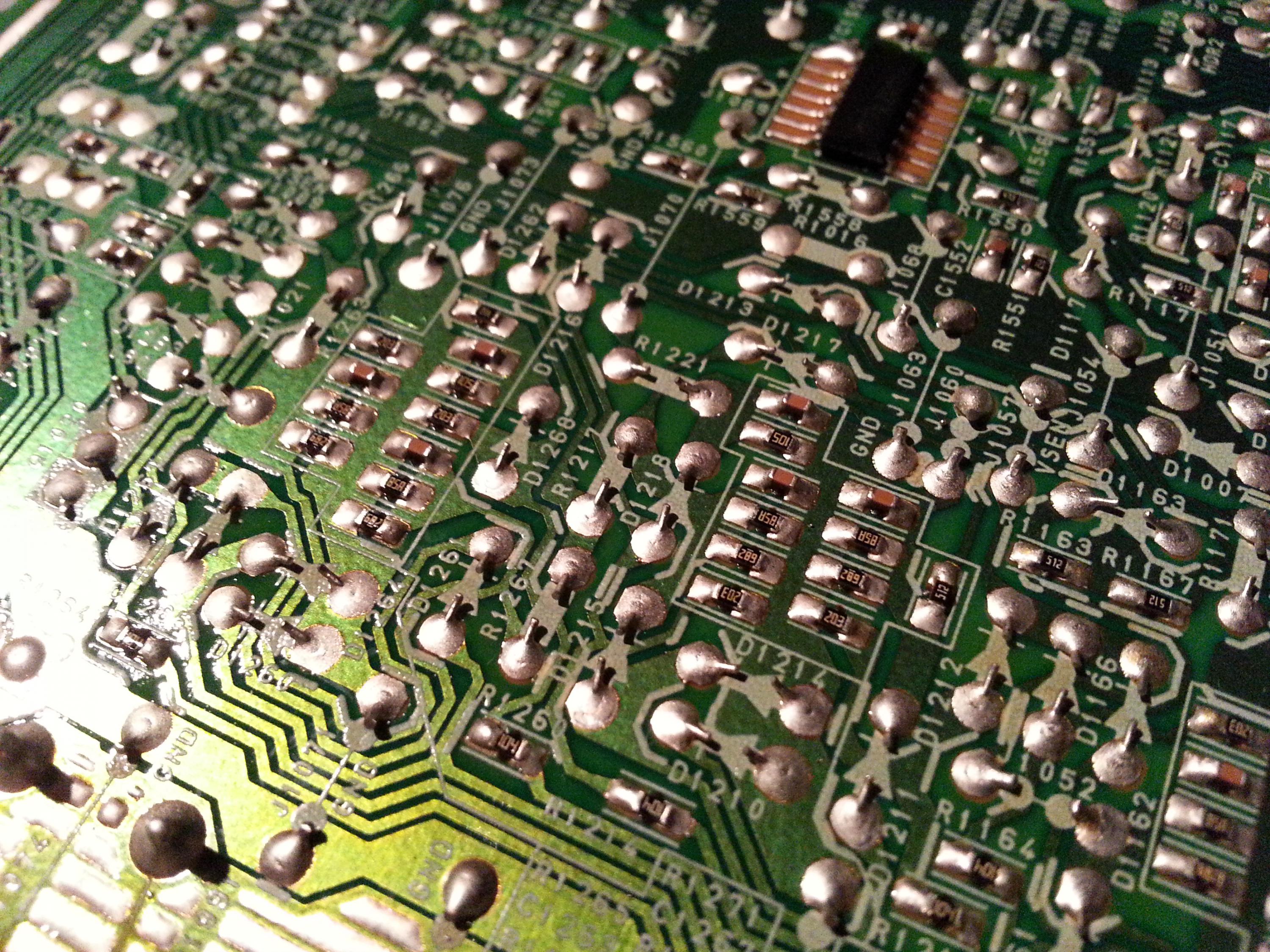

        I didn't see any, but I'm not real familiar with what they look like. Are the components in the picture labelled "E02", "289", and so on examples of surface mount diodes?

          There are non on that pic.

                  The one in the bottom right of the cluster of diodes toward the bottom of the board.

                      The first picture in post 1; I should've been more specific.
                        Re: Magnavox 32MF338B/F7 has no power, blown fuse
                        Those 4 rectifiers by the white power resistors (fusible resistors) are the bridge rectifier for primary side of the circuit.
                        So the power MOSFET on the heatsink next to the resistors is OK, no low resistance between S and D for sure because that is the commonly failed mode on this two transistor cheaply made switching power supply.

                              Hopefully we can get to the bottom of it. Here's a photo of the entire bottomside of the MUT board in the attachment.

                                On the backside of the board, measure the 4 diodes on top center for shorts. Other than that, you have to start lifting stuff at the primary until the short is gone (that is the primary objective right now), then verify other components if they are still good.
