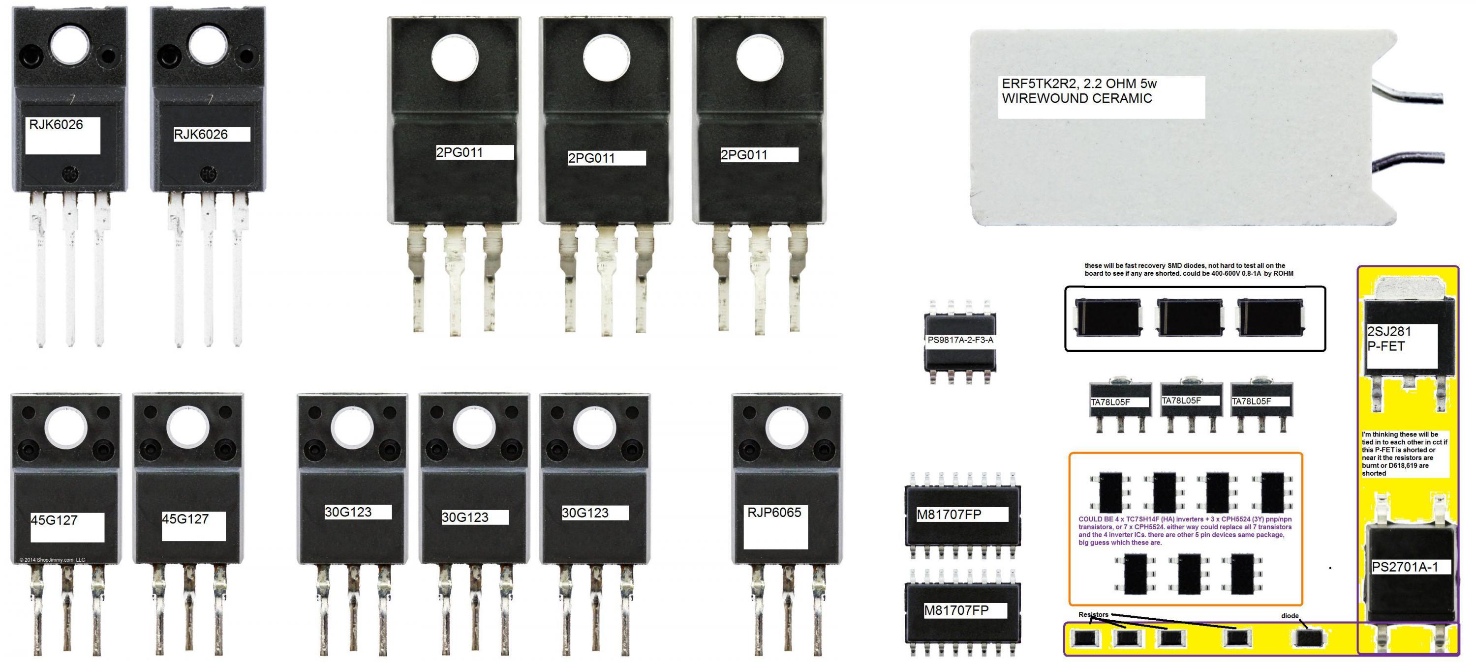

    presume you're asking about the SC board. SC failure is pretty common with these TNPA4782, repair of that board is about the only option. not cheap but looks like shopjimmy may be going to do a kit just none available but could probably work out the parts included.
    easiest way to confirm bad sc is to disconnect it from the buffer boards( 3 connections), then the 4 earth screws on the sd/su are removed(2 each) they are the ones hat attach to the sc. then on the sc there is a 2 pin sc50 connector, jumper those pins together. turn the TV on and see if still 7 blinks or turns on no error.
    if no error then just the buffer boards, if error then sc board and still need to check buffers.
    I think $140 or there abouts for sc repair.
    if you search tnpa4782 or your model or P50g15 , p50g10 you're bound to find plenty to read

        sounds like they bailed due to cost, it's possible to get the parts, just hard to be sure self repair will be successful but a few guys have managed to fix these boards.
        yes if jumped and errors bad sc but checking the buffers is essential if you decide to repair the sc. I'd check them anyway so you know where you're at.

          Re: Panasonic TC-P50S1
          this is an image I've marked with some guesses of what this kit contains assuming all this can restore a TNPA4782
