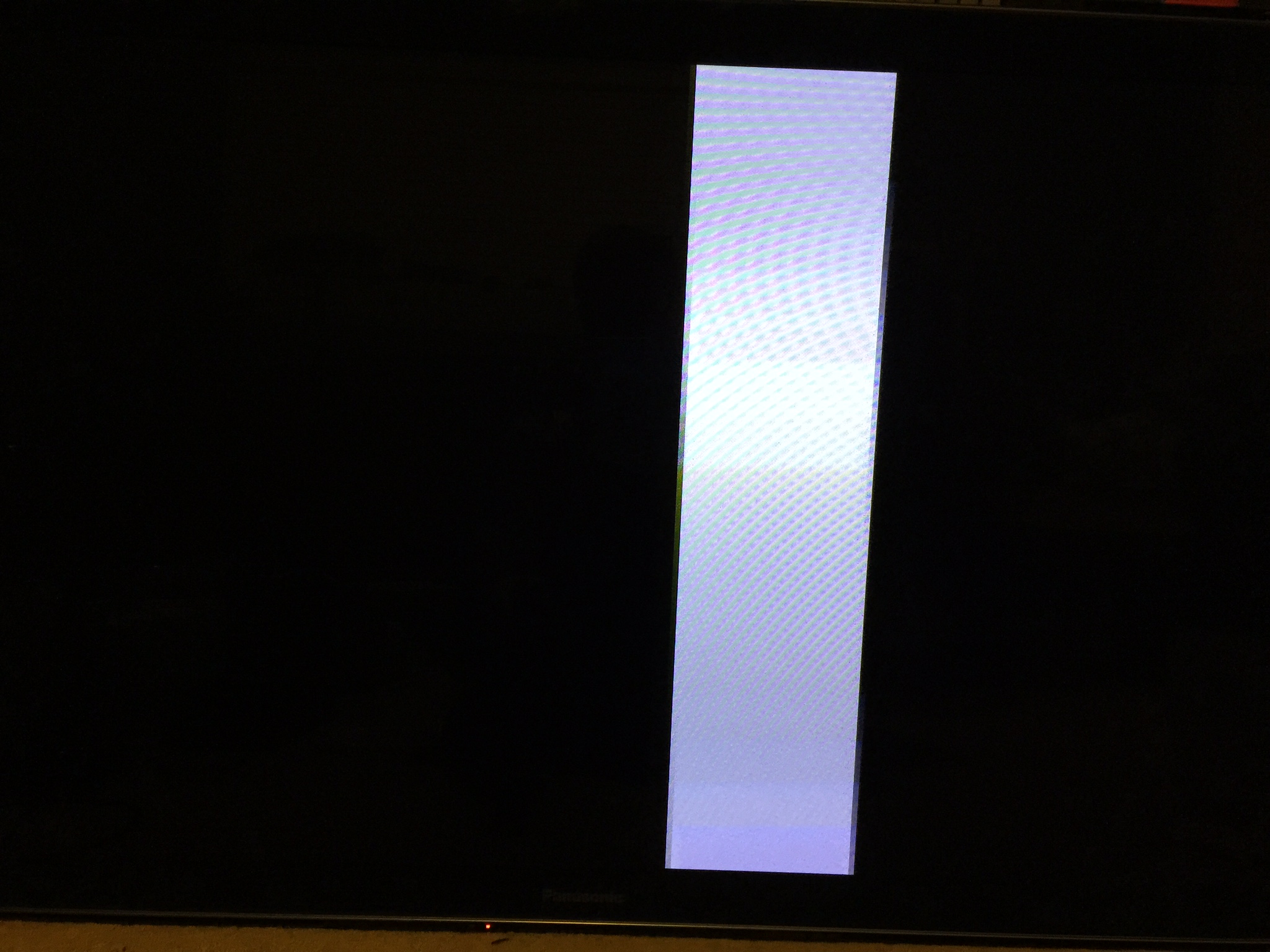

      • Shinju
        • Mar 2014
        • 1239
        Re: Panasonic TC-P55VT30 7 Blink Troubleshoot log!
        One thing I will note, cold panel the maldischarge was blue on scrolling bar.

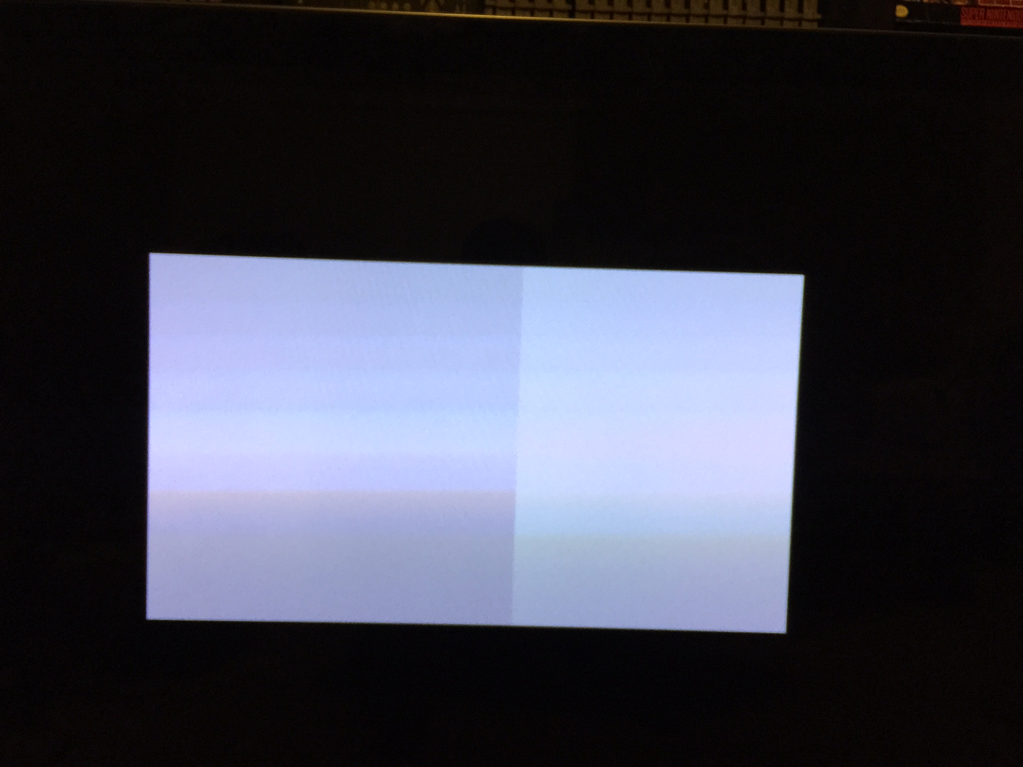

                    • Shinju
                      • Mar 2014
                      • 1239
                      #30
                      This is what I got for voltages, I don't think the VSUS test is meant for voltage testing as I was getting very low readings as soon as I switched to the full white test patterns the voltage was super high after adjusting the VSUS pot on the VSUS TEST menu.
                      VSUS test HIGH VIA SERVICE MENU OPTION.
                      VSUS FROM BOTH P11 ect 201.7
                      SC TPVAD 184.9
                      SC TPVSUS 201.7
                      SS TPVe 135.4
                      SS TPVSUS 201.7
                      VSUS TEST OPTIONS IN SERVICE MENU.
                      Capped POT at 206.8 VSUS HIGH
                      Capped POT at 201.7 VSUS LOW
                      Test pattern white (capped pot 215.1) adjusted to 210.5 VSUS on high
                      TPVE 135.5
                      TPVAD 184.9 (spec says 200? See photo attachment) adjusting the VDA pot made no change.

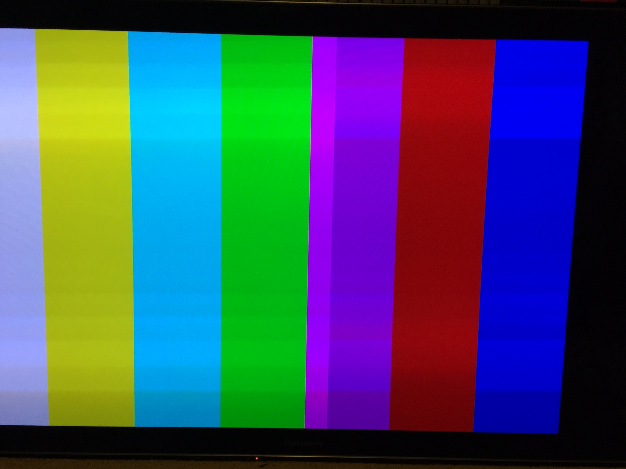

                              Gotcha, is there a Voltage TP for VDA so I can see what its showing? I put the pot back were it was I had it marked.
                              As far as picture quality goes, the full white test screen shows no missfire at all, in fact nothing shows any issues outside of the top of the scrolling bar with minimal pink/redish sometimes blue pixel storm. I can try to take a video but each pass of the white scroll bar the pixel storm/maldischarge goes away to where it only shows up in the top right corner or top left corner (kinda random).
                              I did however seem some strange stuff with the TV in Standard mode (in the service menu) and I dont know if CATS is on by default with Standard when in sesrvice mode but the picture was really grainy and darkish and the test patterns were doing strange stuff. When I am in normal TV operation mode outside of the Service menu I turned CATS off and the picture was fine.
                              I will post photos of that here in a few.
                              But as far as the TV goes I calibrated it to C-Nets post 222 firmware settings on Custom picture setting 100 IRE and it looked freaking fantastic.

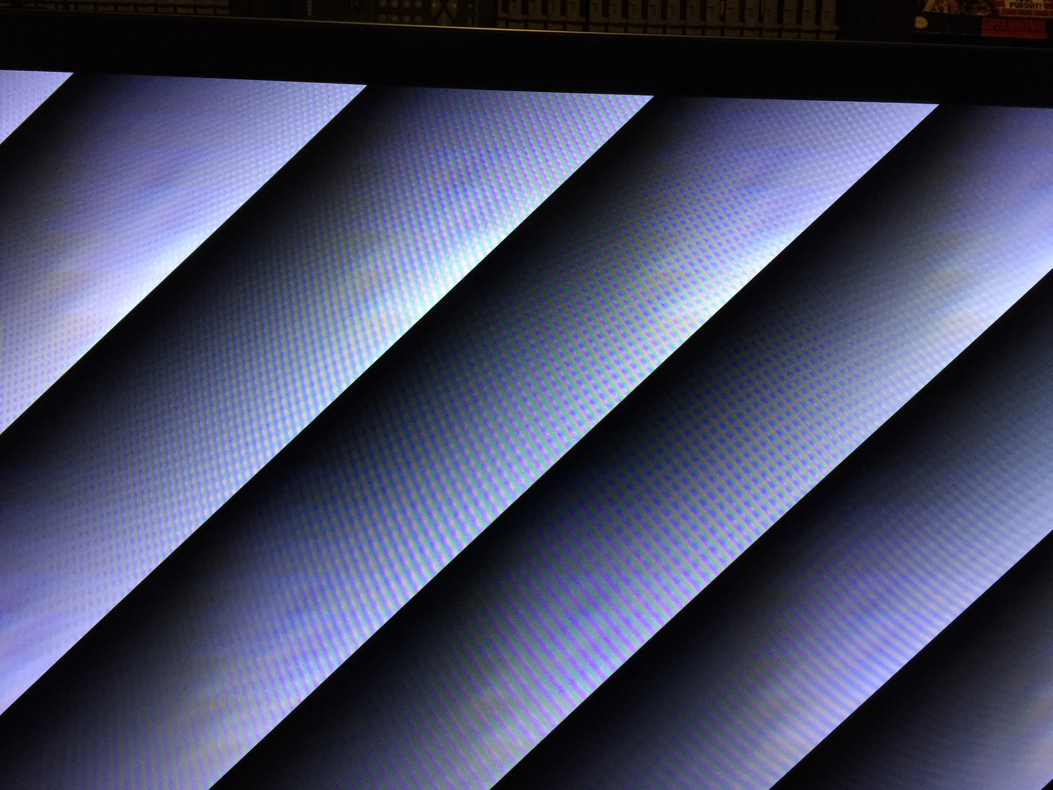

                                This is what I am seeing with TV set to Standard in Servie Menu Test Pattern mode.
                                The patterns eventually look normal in about 2 seconds so I am not sure what to think of this, this issue is ONLY applies for Standard Picture setting, no other picture setting is affected like this.
                                I don't know if CATS is on by default for Standard picture mode in the SM but CATS was on in normal operation mode and I turned it off, the picture in normal operation mode with CATS on was horrible, dim and grainy and when I turned it off the picture quality improved a lot and the grainy look was gone too.
