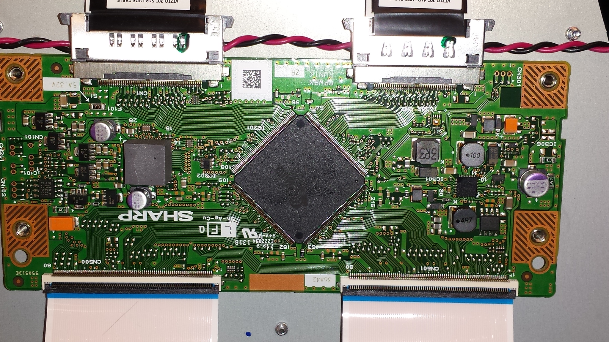

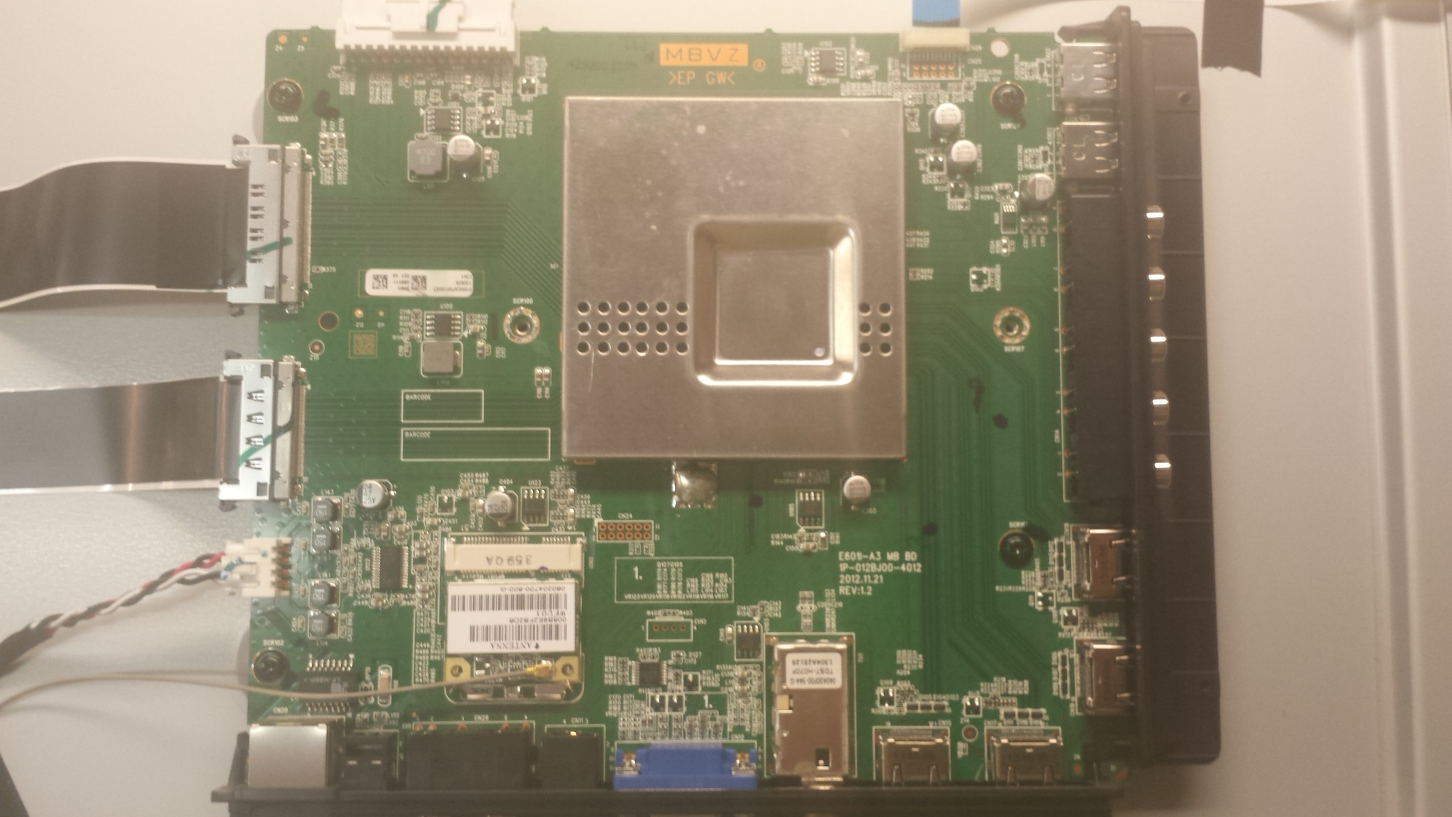

        Back is off finally. T-Con fuse F101 was good. No menu. Have volume control manually. HDMI 1 and 2 have sound. Bad Main board or T-Con? I could not find a service manual.

          Does anyone have a T-Con schematic for CPWBX RUNTK5261TP ZH. There are some small test points near the ribbon cable inputs on the T-Con that come from the Main Board. If the inputs are good then it should be the T-Con. If the inputs to the T-con are bad the it should be the Main Board. Shop Jimmy info on these two boards are misleading.

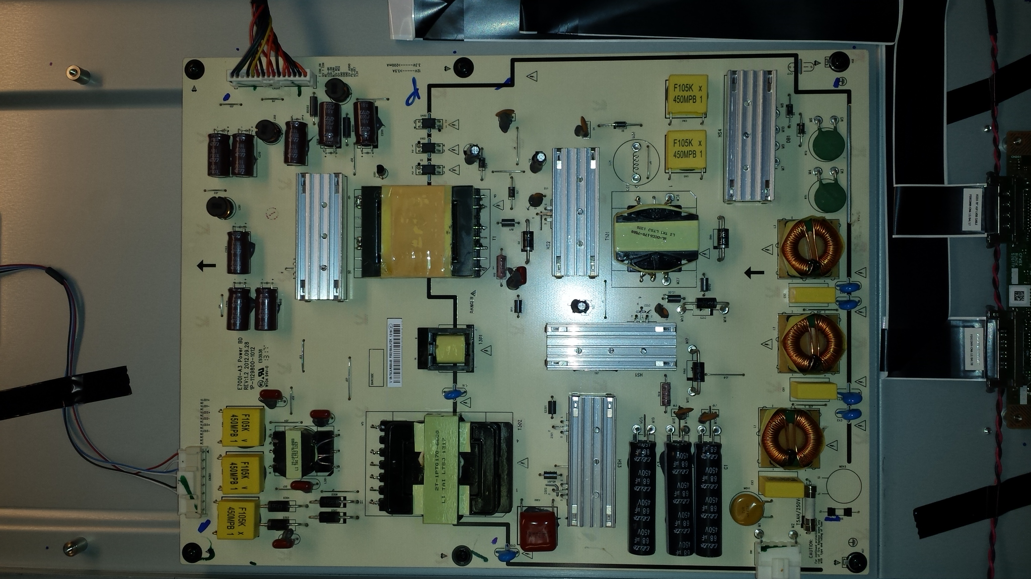

          The voltage was good on both sides of the fuse. 12.5 vdc.

            I see many M.B. 1P-012BJ00-4012 for 70" sets. The part number shows up for both the 60 and 70 inch set searches.
            Will a board from a 60" work on the 70"? With menu setup changes?

              your problem is most likely to be the T-CON, since you are getting sound, back-light and the TV turns off/on. Vizio model # E601i-A3 and E701i-A3 are known for having T-CON board failures.

                I agree on the T-con being the issue. And, neither the T-con nor the Main are interchangeable between the 60" and 70".

                      thing is, im trying to fix my friends tv which has the same problem of blank backlit screen with sound. it's the VIZIO E701I-A3 which came with the ZH stamp on the t-con but i didnt notice that when i ordered the ZE one by mistake which i guess is for the 60" tv. are we sure that the result of a mismatched but functioning TCON and panel would result in the same backlit blank screen? or would you maybe see a corrupted image of the wrong size?
                      what volts would you expect to see on the ribbon cable connecting the tcon to the panel? and how do you measure them without touching two of them together with the probe? the pin pitch is so tiny.
                      edit: great and it turns out i ordered the wrong motherboard too.
