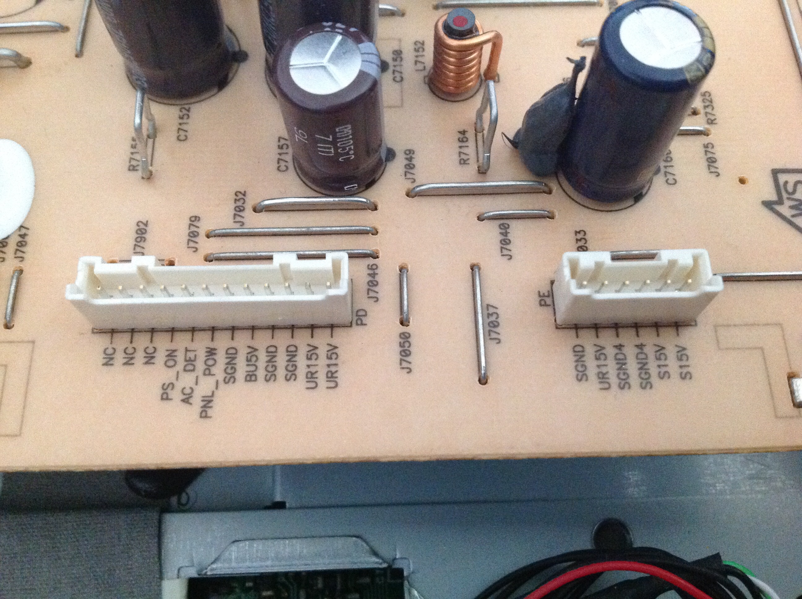

      Ok, Soltys, please check the voltage across the 450V capacitor.
      This is a large capacitor on the PRIMARY (DANGER) side of the power supply. Your volt meter will need to be on a high DC voltage range, red probe one end of cap, black on other end.
      Do not touch the two leads together and do not touch anything on the primary side with any part of your body...
      We are expecting around 320V in standby, ~390V running.
      We got 322v in standby, when plugged in it peaked at 355v

        Is there a way we can force the psu on and test it with out the mainboard connected, nothing tests shorted in the pfc section, here is a photo of the connectors.

          The PSU is being turned on by the main board already, if you want to force it on you could do so with a ~100-470 ohm resistor from 5V STBY to POWER ON.
            Re: Sharp Aquos blinking error help needed
            Ok we will try it and see if the other voltages come up thanks.

                  Just an update we repaired the tv by swapping the power board as we had another on-hand, the tv came straight back to life will try to diagnose the old board and get that one running. Thanks everyone for the input.

                    replace R7832 , R7833 , R7834 , your PFC voltage is too low. Value must be correct 511k.
