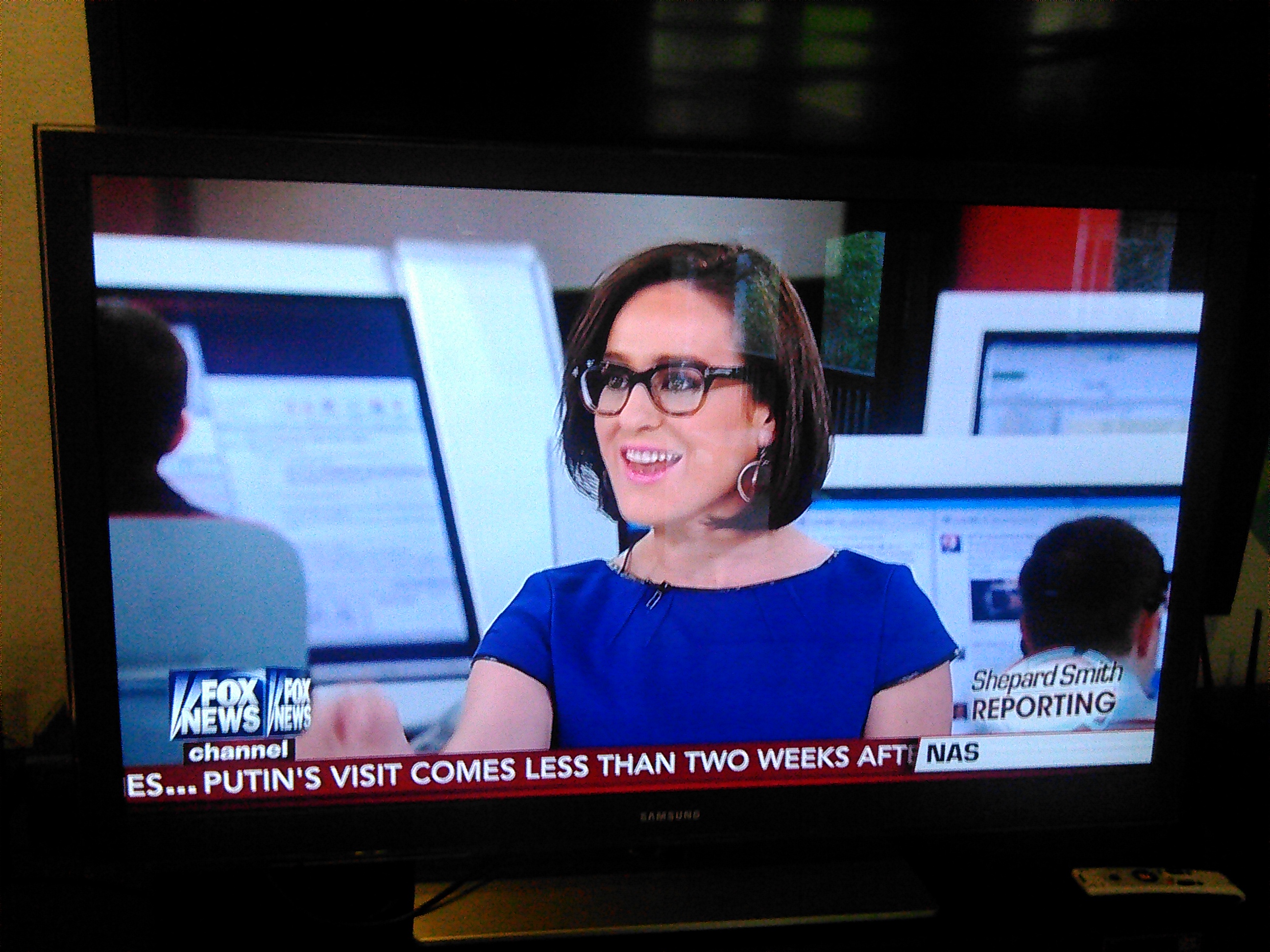

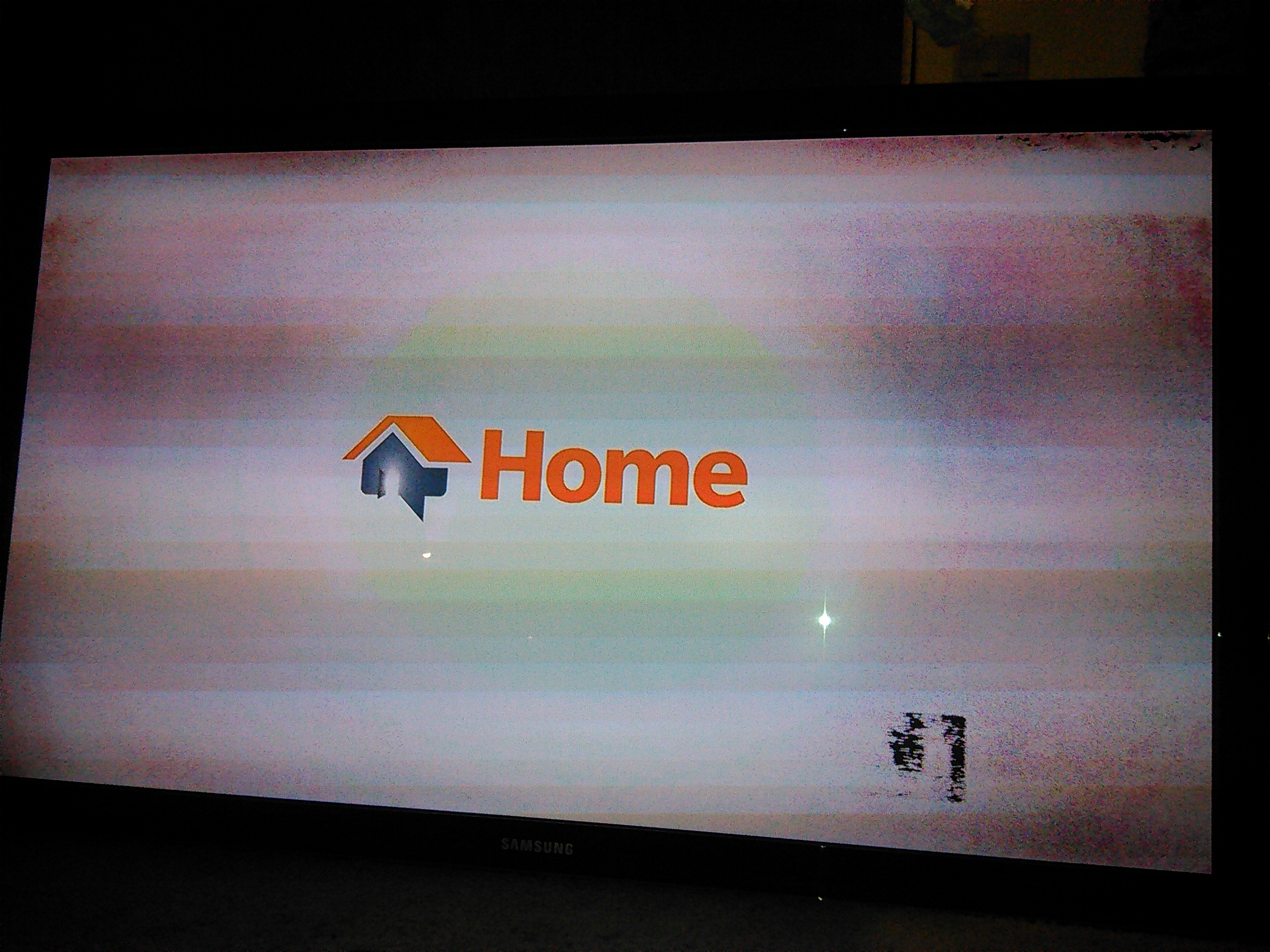

    OK so I got in another 58 inch plasma TV today. This ones a PN58C8000. White screen produces pink bands from inadequate power supply I believe. ok seems to be a lot of talk about this issue on other forums and Google searches come up with a lot when you search pink banding issues. I know I can clear this up by adjusting up the vs voltage but why? It's running at its optimal 210 Volts. What's the deal? Seeing this a lot more lately. if you see I have another thread open about the other 58 inches I have but that one the banding was so bad it was dropping out pixels like as in a bad Z sustain but it was not.
    Could it be low amperage? Not so much the voltage? As in increasing voltage ups the amperage also.
  • freakaftr8
    • Oct 2012
    • 3743
    Re: lets talk Samsung plasma pink bandung issues..
    OK this TV runs 210 for vs and -200 for vscan. So I noticed the power supply was low and vs was running at 206. Bumped it up to 210 and cleared up mostly. Still a little banding. Had to bump up to 215,and looked great except a few sporadic sparkles in dark areas. So I found that I had to also bump down the vscan from -200 to about -183 to achieve a near perfect picture.
    Also I was correct that the panel us the same as the PN58C680,as it uses the same sustain boards but different power supply. Now on to seeing how long it lasts as people complain that after Samsung authorized repair techs crank up vs and after 6 months it's back to doing the same thing...
    I would also like to add that the other TV that had the black patches on the screen was the result of what happens when the purple banding or the pink banding issue goes far beyond and adjustment as that one appears unrecoverable with vs up to 218 with just a little mal discharge still.
    also both of these TVs seem to have issues when placed in movie mode under screen preferences. quite a bit of mal discharge and the screen on the other TV almost fades away completely in this mode. It seems to be the hardest on the panel for some reason you would think it would be the easiest since its darker but it doesn't look that way. I think this seems to be becoming a more inherit issue with these newer Samsung 3d Plasma TVs
    BTW also Vsch needed a small tweak because when I would flip channels I would see a few green and red sparkles as the screen refreshed.
    Also VA was low. Supposed to be 55v it was operating at 50v.

            Here's what I got now. And what I had before adjusting.

                                So poking around the internet I have come across a control board update for this issue that is supposed to change the drive dynamics to accommodate panel aging. Thus is a proprietary Samsung [3D58] logic.bin file. Anyone know where I can get my hands on it? Apparently need a to be loaded via service remote but I found the service remote program as long as I can do it over LAN. Tom back in 2013 you had a lot to say about this issue on another forum I noticed so you know about this issue. The banding only seems to affect a certain number of models all using this same panel.
                                  See, I'm not really sure you're seeing the same issue.
                                  The pink banding typically manifests after around 2-4 years of typical usage, and it appears when bright, mostly full white images appear. Like this:
                                  https://www.youtube.com/watch?v=28UxYb6_vSQ
                                  This is because under load, the Vs reaching the SUS boards and panel drops (the wires, transistors, panel, buffer ICs all have internal impedances, peak currents are high, so you'll see fairly significant droops under load.)
                                  Generally, setting "CELL LIGHT" down will hide the fault. Adjusting Vs up by around 5V nearly always cures the fault because you're overcoming the energy otherwise lost in the panel.
                                  What you're seeing is plain-as-the-day maldischarge. Something is actually WRONG with how your panel is being driven... unfortunately, it's pretty hard to say exactly what is causing it without seeing the sustain waveforms. Plasma panels require nice initialisation pulses before they emit light - if those go wonky or disappear altogether, the picture will not be very good although you usually will still see -something-, which is a lot like what you have.

                                      problem fixed. Tarnished connections on Z sustain ribbons going into the panel. Watch out for this they started getting pinkish colored like what happens when copper sits in water. I clean them with an eraser and problem solved perfect picture. Never seen this before!
