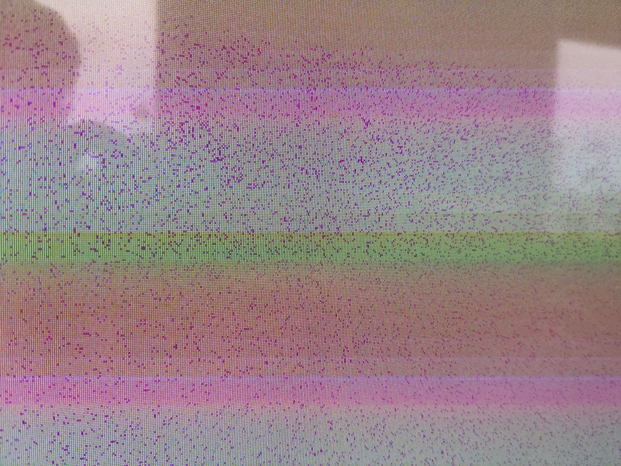

    My parents' Panasonic P42S30 died recently, and they asked me to have a look at it. I was able to identify the SN-board as the culprit, as it was shorted. After removing Q401, Q402, Q421 and Q422 the short was gone, so I replaced these components and that got the TV working again. However, when testing the tv a bit, I noticed quite bad pinkish sparkles on some colors. For instance the greyish bar on this forum seems to trigger it quite badly. I made a fullscreen test picture with only that color, with the below result.
    Click image for larger version  Name:	PXL_20240725_181605673.MP.jpg Views:	0 Size:	868.4 KB ID:	3316613
    There is about a 5cm high region at the top without any sparkles, immediately below that it is the worst and then it fades out towards the bottom. I don't really know if this was already present before the repair, because it's not my tv and with normal content it is not super noticable (and my parents' eyesight is not the best anymore). The image retention also seems quite bad, but I haven't had a plasma for a while, so I don't know if it is normal. Finally, there is a test pattern in the service menu that is listed as 'LOW STEP WHITE' which is just black with a lot of red and green sparkles on this tv.
    I read on this forum that this might be Vsus related, so I measured it and it was 211V. The service manual said it should be 215V, so I turned the Vsus pot until it was at 215V, but that did not make a noticable difference. I also set Vsus to high in the service menu, also without result (apart from the brightness increasing a bit). I then tried to see if any normal settings would make any difference, and found out that setting the Intelligent Frame Creation to Max, the sparkles were reduced a lot! I could just leave it at that, but I would rather have an actual fix for this. Any ideas what might cause this?

    Oh yeah, I also tightened all screws and reflowed the solder on the screw holes on the top and bottom.

      Sustain problem, there's something still damaged on the sc/sn board, maybe a resistor or diode damaged after the current surge, or fake IGBTs.

        If the old mosfets, drain, source shorted to gate then the drive circuit is likely bad, check the resistors in the gate circuit of the mosfets, if the resistors are bad the drive ic's are likely bad, if the resistors are ok, the drive ic's could still be bad and not driving the mosfets

          I suspected it might have been fake IGBTs, they looked a bit suspect. When looking for different ones, I found that a replacement board was not that much more expensive (less than €30 on Ali), so I went for that. The first one was a DOA (got my money back), so I ordered another one that worked like a charm. I was quite surprised how many of these boards are offered there, there must have been at least 30 different sellers.
