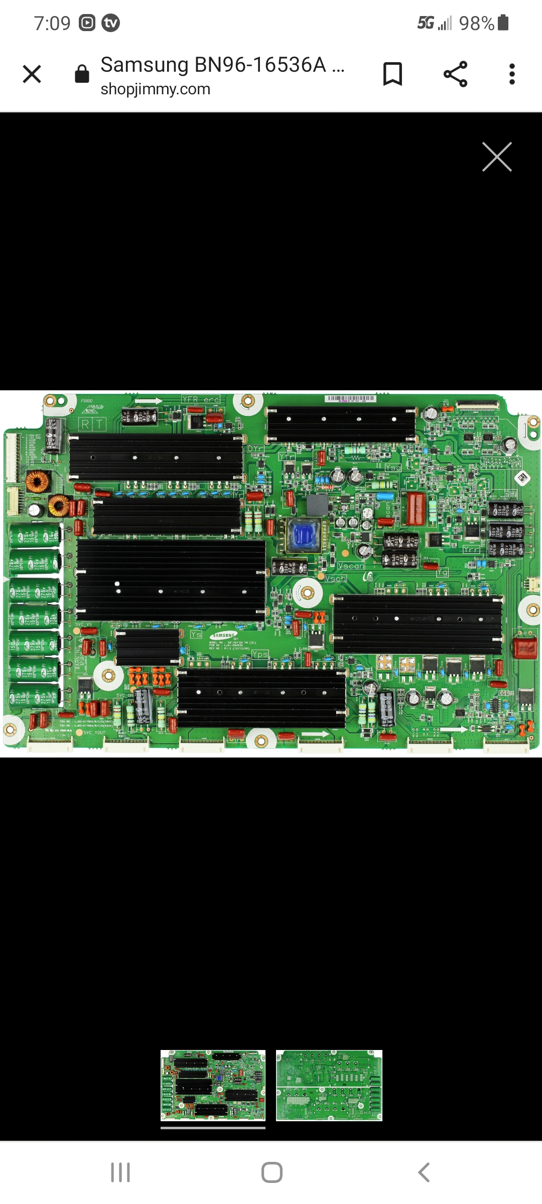

    Hey all, i have a Samsung PN59D6500 that I rescued from the dumpster and I'm trying to fix it. So the issue I am having is that the TV isnt turning on at all. I have VS,VA,VSC,VE at all the appropriate voltages. I have 3.3V at the PS-On, and 5V also. Whats happening is when i press the power button on the remote the TV has has the relays click, some pixels flash on the screen and then it seems to turn off. It repeats this until the TV is unplugged. I know that the Mainboard has a problematic EEPROM but this seems kinda like a power regulation issue. Anyone have any ideas?

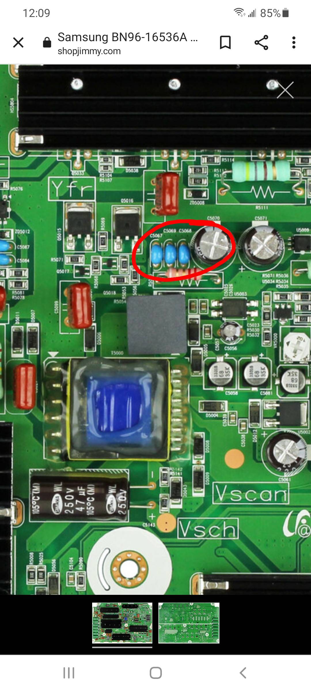

              I have a feeling that all that is wrong with your set is the 3 "c106" little blue capacitors on the ymain board.

                Interesting, I will test and respond with the results. The weird thing with the Y Main is that the VScan voltages are perfectly fine. Do you recommend a test point I could try? Or just test those caps? And since I'm trying to use this as a learning experience, could you tell me their function possibly?

                  Ok I did some digging. All small blue capacitors ohm’d out fine, as well as had a 15vdc. I am including a video/pic of the most apparent issues I have found. On Ic1302 (which I am thinking is the issue) there is a burnt pad. The data sheet says this is pin 48 which is not internally connected to anything so I doubt it has any effect. What I’m wondering is how it burnt down like that. Maybe desoldering issue? Regardless I’m just curious what your input on these symptoms would be. I attached an Imgur link, the attachments wouldn’t show up
