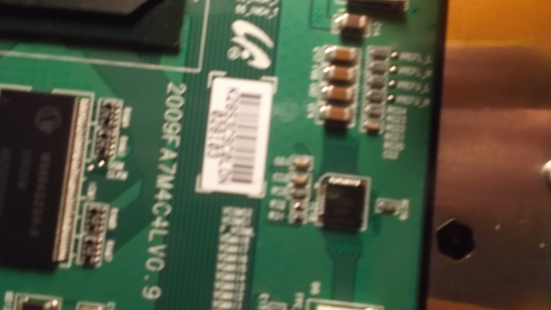

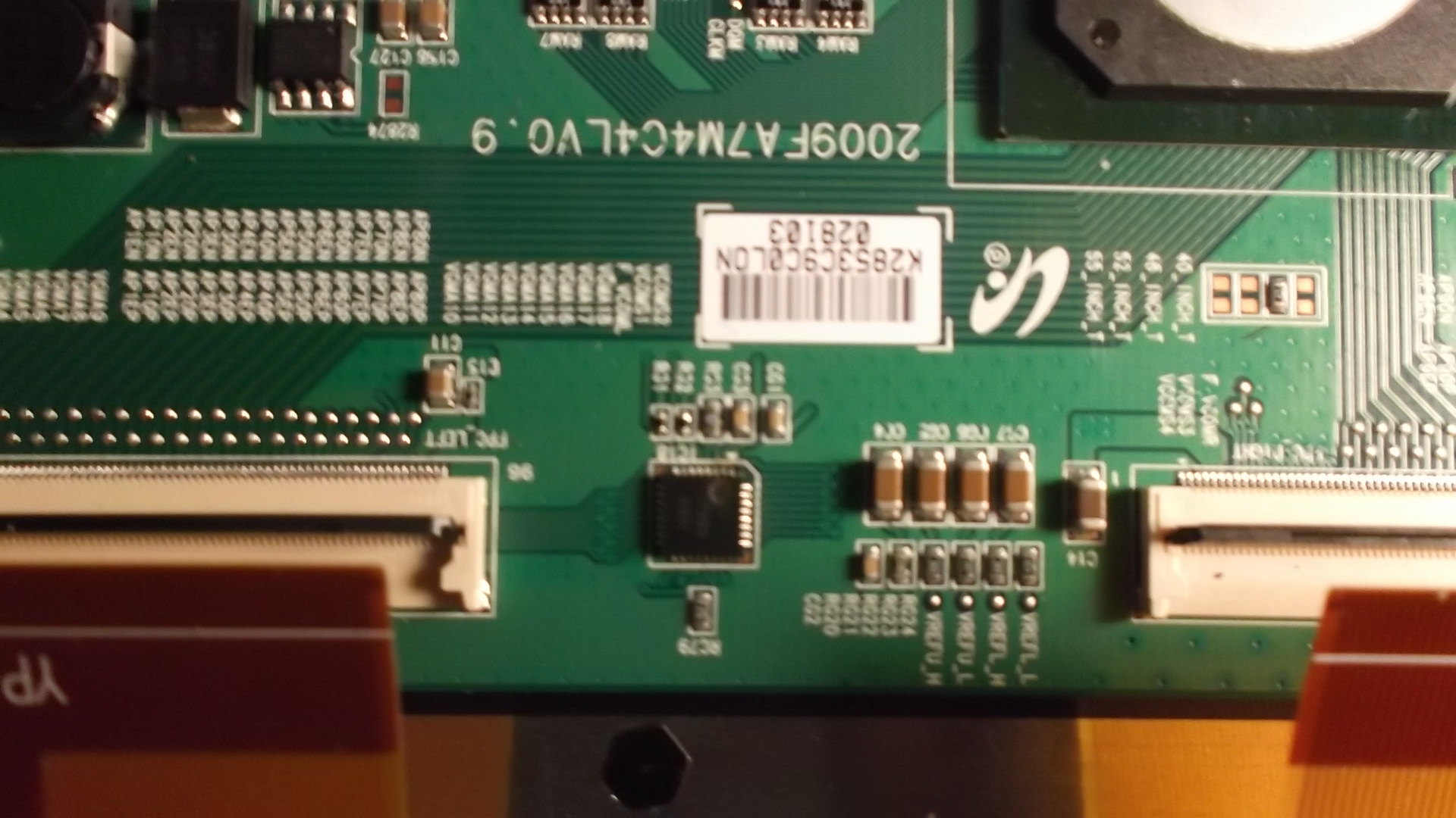

    I have a Tcon board, 2009FA7M4C4L V0.9, out of a 46B7020. I got the TV with a fault and managed to repair it however I noticed some thin horizontal lines. So as I was trying to reposition the cables from the Tcon to the LCD an IC let out the magic smoke!
    I'm having trouble identifying it. The markings on it are 17989 A851 and it has 32 pins. It's between the 2 ribbon connectors that go to the LCD and marked as IC18.
    Any help identifying it, and/or suggesting a replacement would be appreciated.
    Apologies for the not so great photos!

    Seen this issue with lines before on these sets, If they are black and run left to right with equal spacing I am sure the panel is faulty.
    P.S just get another TCON... Unless you are very competent on soldering fine pitch components

        I think it's i7989

          Thanks. That's very helpful. I can't seem to find any data on it or figure out what it does.
          Maybe a gamma buffer? I'm new to LCD repairs so still learning.
          I did find a few for sale on aliexpress though.
          I think I'm going to buy this one and try it out,
          http://www.aliexpress.com/item/I7989...025687676.html
          It would still be useful if anyone has any opinions on the youtube video I linked to in an earlier post. I couldn't clearly see what he was doing with the tape. I think it was just to apply more pressure to make the connection, but it seemed like he was covering some of the contacts which seems counter intuitive. I blew the original part as I was trying to reposition the ribbon while the TV was on and it must has shorted the chip. Any ideas?
