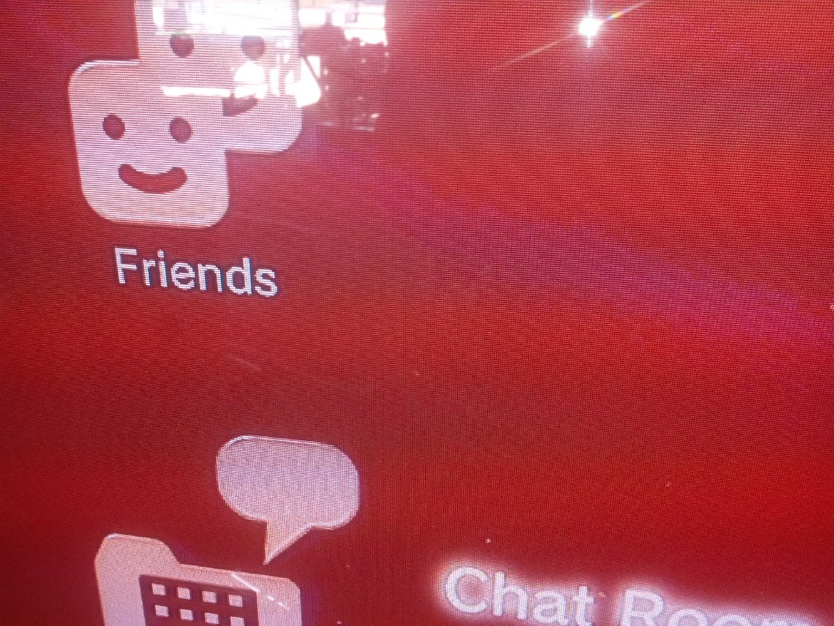

    Well, the news isn't ALL good with an LG 50PK540 I have been working on..
    https://www.badcaps.net/forum/showthread.php?t=43537
    I put everything all together, hooked up a PS3 and noticed a very slight shimmer at boot up..
    Not sure if it's just a setting issue, but wanted to run it by the experts...
    Re: Slight Off-Color Shimmer LG 50PK540
    Looks like dithering - it's normal for plasmas, it's how they work. Shouldn't be visible at 6-10 ft.

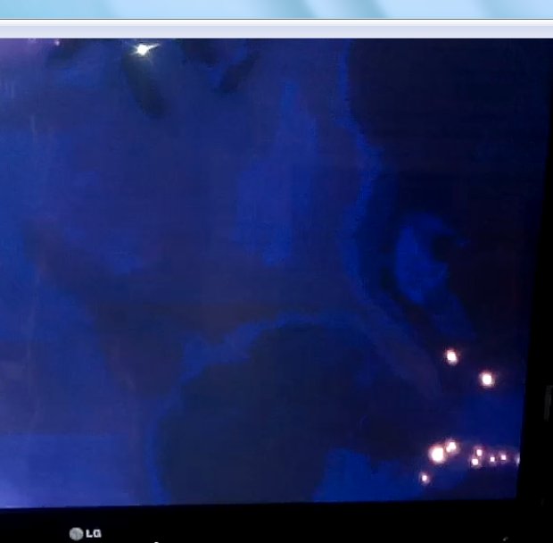

      I was just reading your thread about plasmas and sparklies..
      https://www.badcaps.net/forum/showthread.php?t=18542&
      Especially the part about adjusting the voltages..
      Was going to do that and see if it improves..
      I attached another pic that shows the sparklies more clearly... It's from the EMP screen of the HOMEFRONT game...
