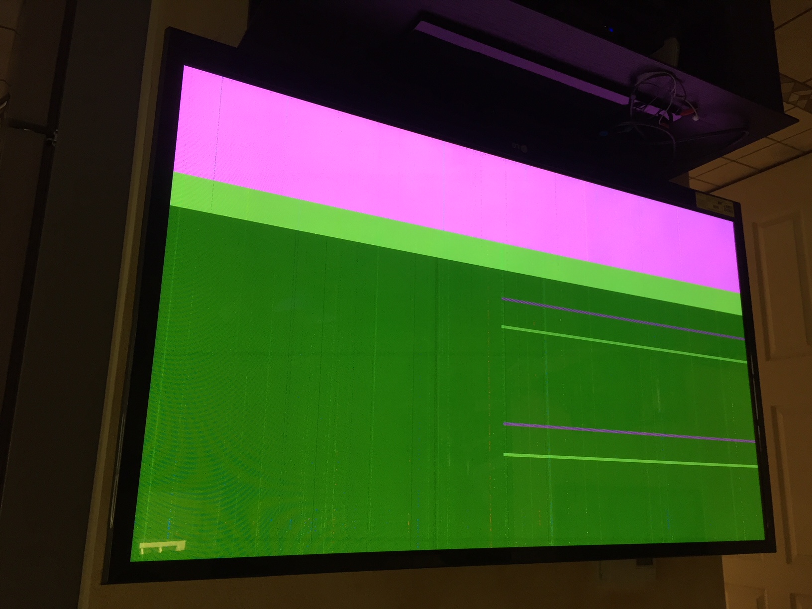

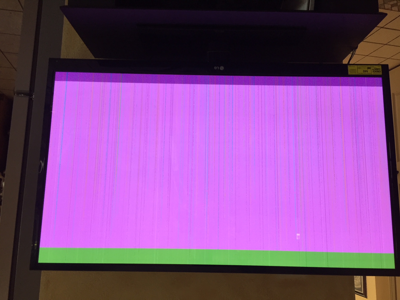

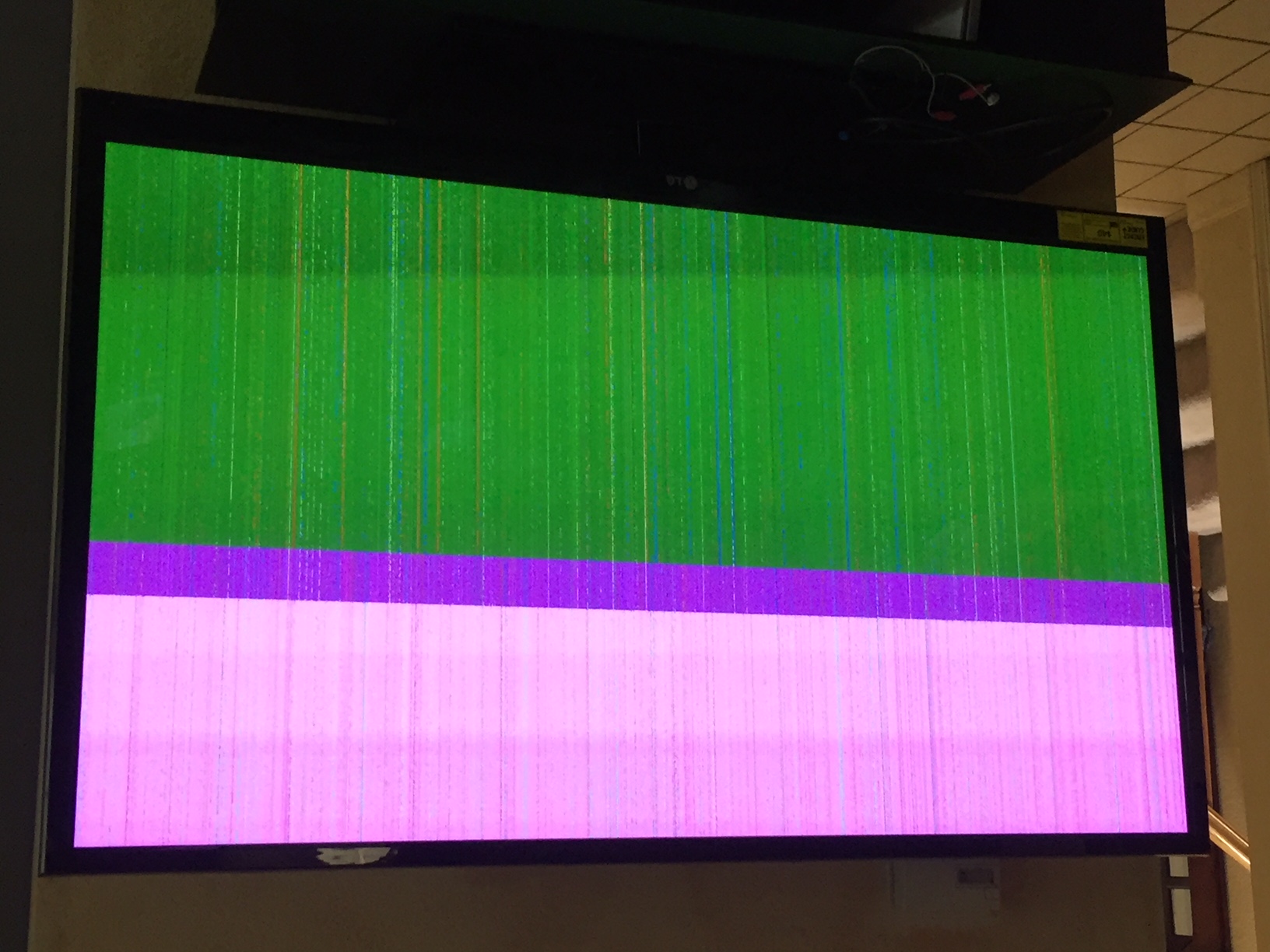

    I picked up this 60" LG the other day and it has the following signs / issues:
    1) Displaying a primarily pink and green screen that alters its look on occasion and particularly can change if the set is turned on and off (see picture set below).
    NOTE: All of the pictures uploaded upside down, and I could not correct it. So, please view them as such. You can see the base stand at the top of the photos.
    Pic #1 ~ How it looked when I first picked it up.
    Pic #2 ~ The first time it changed shape, of its own accord, after about 3 or 4 on/off cycles I performed as I was trying various things. Suddenly, it just altered itself.
    Pic #3 ~ The 3rd time it shape-shifted, again after an "off and back on" I purposefully performed.
    Then, about 20 minutes into all of these attempts, it unexpectedly went back to the original look (see Picture #1 again), and this time of its own accord once again.
    So, as you can see, the generalized pink/purple/green look of it stays constant but the particular pattern can and does alter.

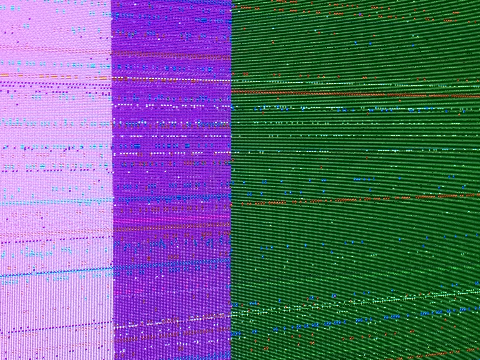

    4) The lines on the pink/purple/green screens are exceptionally still and stationary. I have seen other sets with vertical line issues similar to this where the pixels tend to shimmer or to flash on and off ..... or appear and then disappear only to (perhaps) reappear again. None of that is going on with this particular LG set and this scenario. It is as if it is a still photo, no matter which iteration of the pink/purple/green screen it takes on. See Picture #4 below ~ a close-up of what I am describing .... knowing that this photo was turned 90 degrees upon uploading to the Badcaps site. So, the lines displayed are really VERTICAL lines. You can match it up with the Green to Purple to Pink pattern you see in Picture #2 as proof of this.

              Took out the Zsus and saw no visual evidence of cracked solder joints, but touched them up anyway along with several other smaller ones. No change when I put the Zsus back in the set, as I kind of expected at that point.
              DID get the test patterns to show, however, when I next tried the jump between the auto_gen pins. All patterns look to be in good order and the screen shows no visual signs of fault at this juncture. Test patterns are: Full white screen, full red, full green, full blue, full white again, followed by a short series of black and white horizontal and vertical scroll tests. Then it turns full white once again and the pattern repeats itself over and over from there.
              So, it looks like it is definitely the Main Board, then?
