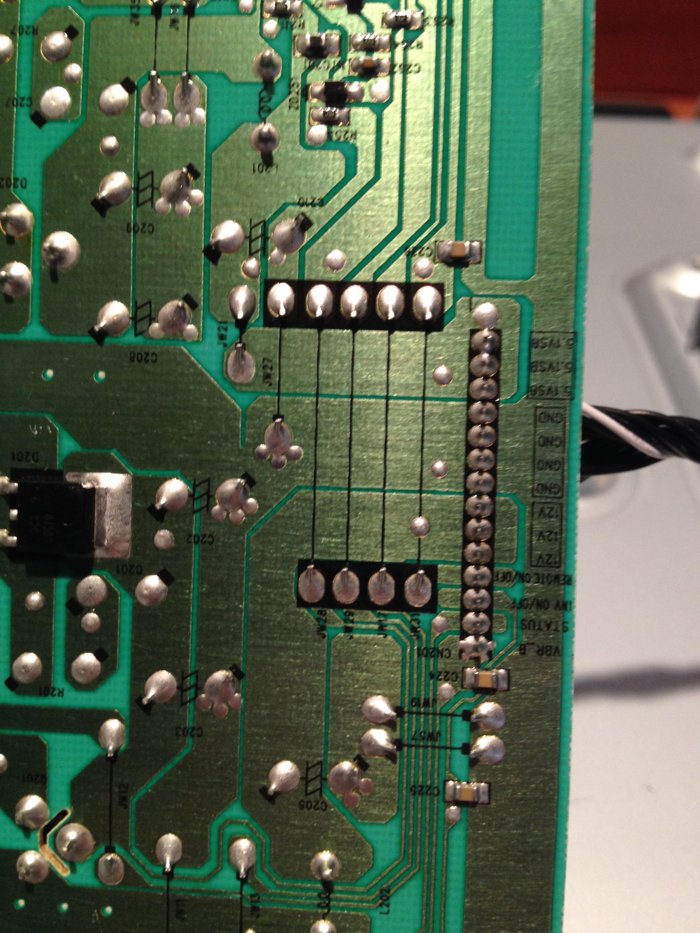

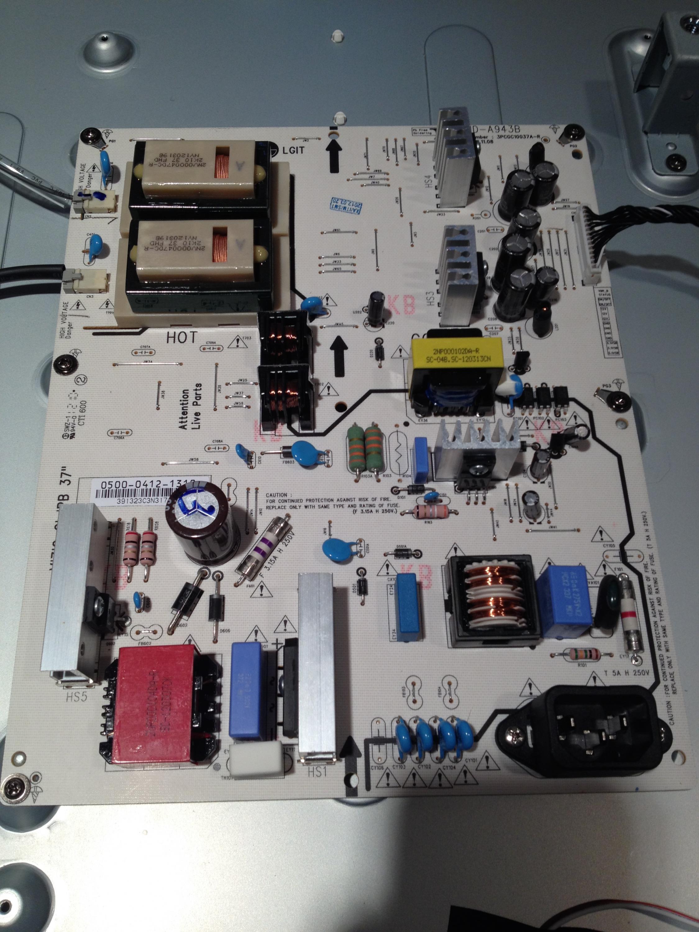

    I have two Vizio E371VL tv's that were among 4 TV's that went down after a nearby lightning strike.
    When I plug the set in, the Vizio logo glows orange. When I power the set on, the logo turns white, but there is no picture or sound. I do not see the backlights working either. The only way to turn the set off is to unplug it.
    Fuses all test ok.
    I measured the large Cap, and it had 391V, all the capacitors look fine... in fact I don't see any heat damage or any component damage at all to indicate a problem...

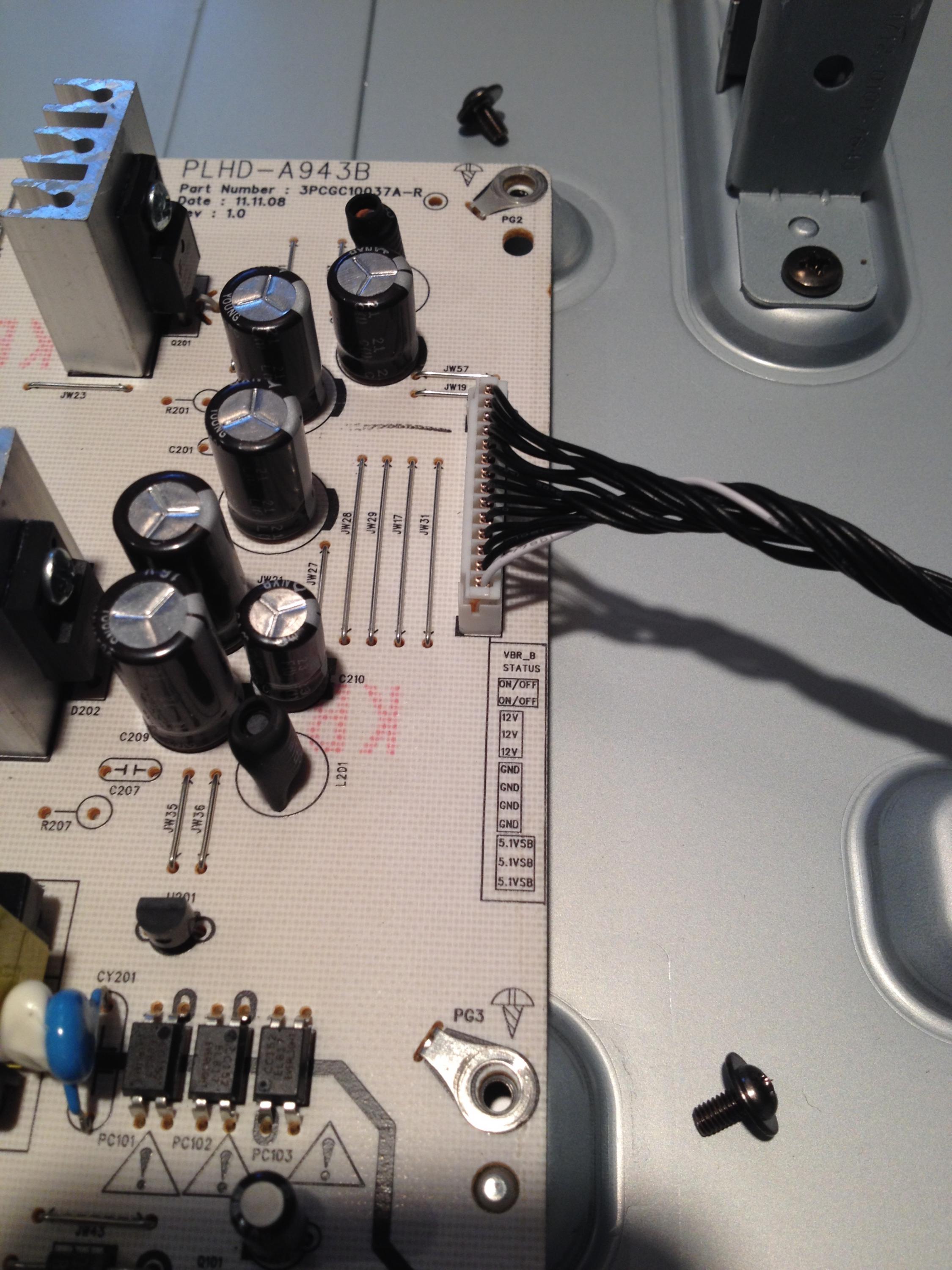

    On the ribbon I had
    VBR_B....................3.23V
    STATUS...................0.0V
    INV ON/OFF.............0.0V
    REMOTE ON/OFF.......3.23V
    12V.........................12.08V
    GND........................0.0V
    5.1VSB....................5.0V
    It seems there is a problem in the inverter somewhere, but what should I look for and on which board? as best I can tell it doesn't appear to be the EEPROM problem that seems to come up, or the Capacitors getting fried, but I could be totally wrong...

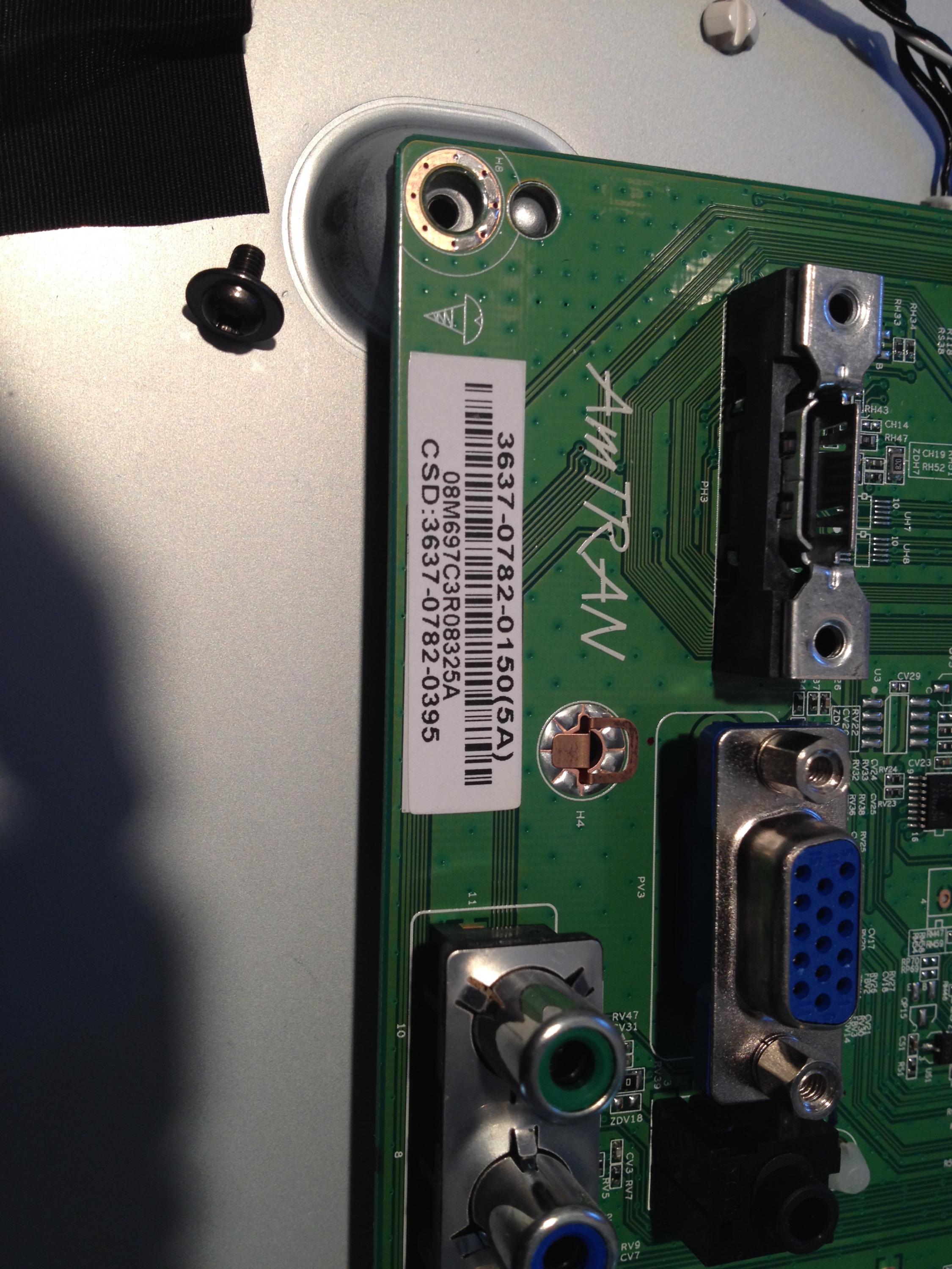

            Re: Vizio E371VL power or inverter issue
            What numbers and letters are printed on that U13? There are more than one 3-pin Voltage regulator CIs on that board that should be checked.
            We need what are printed on the ICs so we can tell what the Voltage output should be.
            SJ sells EEPROM for this model so that can be the problem.

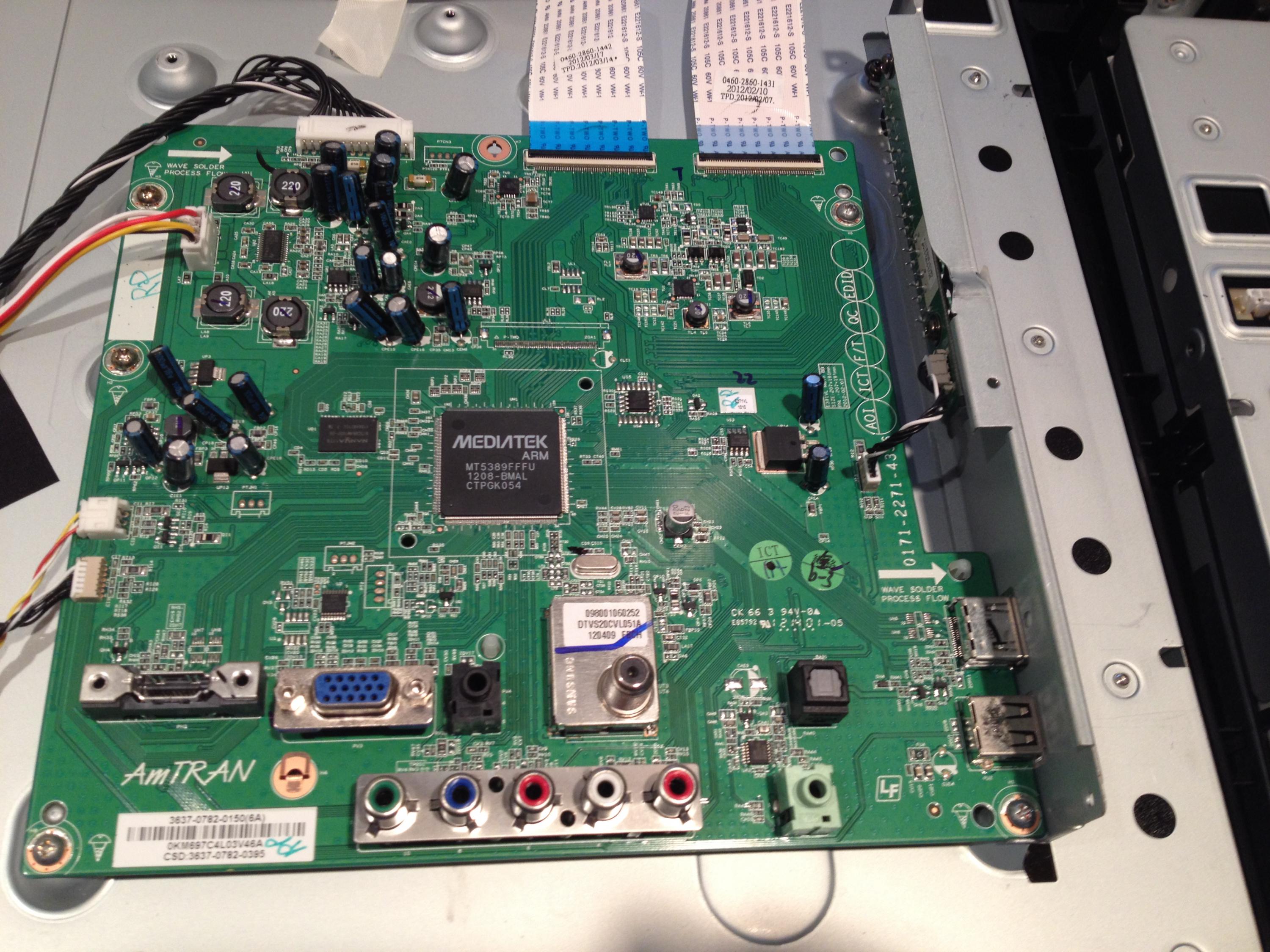

              I see 3 regulator IC's on the main board...
              UP13...AX1007
              -12
              2051
              IN.....3.29V
              OUT...1.19V
              ADJ...0.0V
              tab....1.19V
              UP3....AX1007
              1462
              IN......3.28V
              OUT....1.48V
              ADJ....0.23V
              tab.....1.48V
              UP14...AX1008
              12101
              IN.....5.15V
              OUT...3.29V(this tab not connected to board, seemingly intentionally)
              ADJ...2.04V
              TAB...3.29V
              I looked up the Datasheets, and if I understand things correctly, then it sounds like UP14 is definitely good, and either UP3 or UP13 is bad... and I'm guessing its UP13...
              Does that make sense? And if that is the bad one, is there something else I should look for that goes with it or, just replace UP13?
                U13 (1.2V fixed reg) = 1.2V, OK (you are getting 1.19V)
                UP3 (adj reg) = 1.25 Vref + 0.23Vadj =1.48Vout = OK
                U14 (ADJ REG) = 1.25Vref + 2.04Vadj =3.29Vout = OK.
                So it is not due to these 3 regulators.
                • johnnyospot
                  • Feb 2015
                  • 14
                  Hmmm... I don't think it's the EEPROM, or at least not just the EEPROM, as the backlights are not working at all, and they should be working if it was just the EEPROM...
                  Looks like more testing to be done...
                  Or is a reflow a good next step? I've never done it before, but I do have access to a high end oven that I could try it...
                  Any suggestions as to where to get best/most detailed directions? is it better to try with a heat gun, or oven?
                  From what I've read, it looks like wrapping the thing in foil except for the main processor in the middle and doing it in the oven might be the way to go...
                    Well, if you understand what the TV needs to have the backlights comes on then you will understand why I am saying you have main board problem.
                    Right now the main board is not sending the ON command to turn on the backlights, if the EEPROM is corrupted (which you have no way to test that EEPROM), or the processor is bad, or etc. then you will not get the command signal.
                    You need to have PS_ON, BL_ON, PWM dim or A dim.
                    Post 1 "INV ON/OFF.............0.0V" So how do you think you will get the backlights when the command signal is at 0V?

                              To update anyone interested,
                              I finally got my hands on a replacement Main Board. I tried to reflow the main chip, just to see what would happen, but suspect I need better equipment to do that, as it didn't help any. The new board fixed the problem however, so the challenge is finding another for the second TV. Thanks to all for the help!
