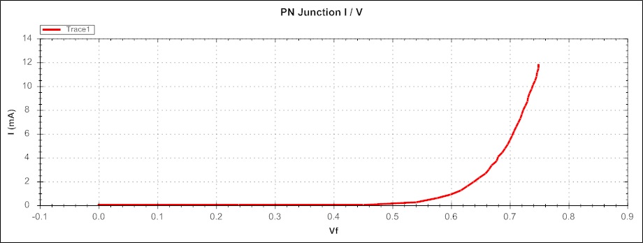

        Re: Zener DIODE HELP D6 - Element F0V87C
        Here is a graph of the DAMAGED DiodeClick image for larger version
          Think your right...4148 don't think will work. Testing..my old one goes to 1 volt on the test. Any ideas? If I missed a test..please explain.

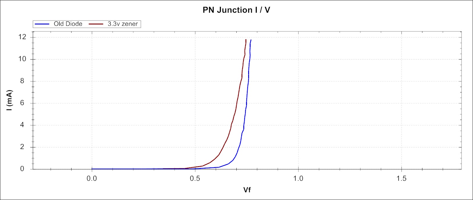

            I tested a 3.3v Zener next to my SO CALLED DIODE ( program confirms ) and they look close.Click image for larger version
              Your program does not show reverse bias, (a zener works as a normal diode forward bias, but has a low and controlled reverse breakdown unlike a normal diode)
