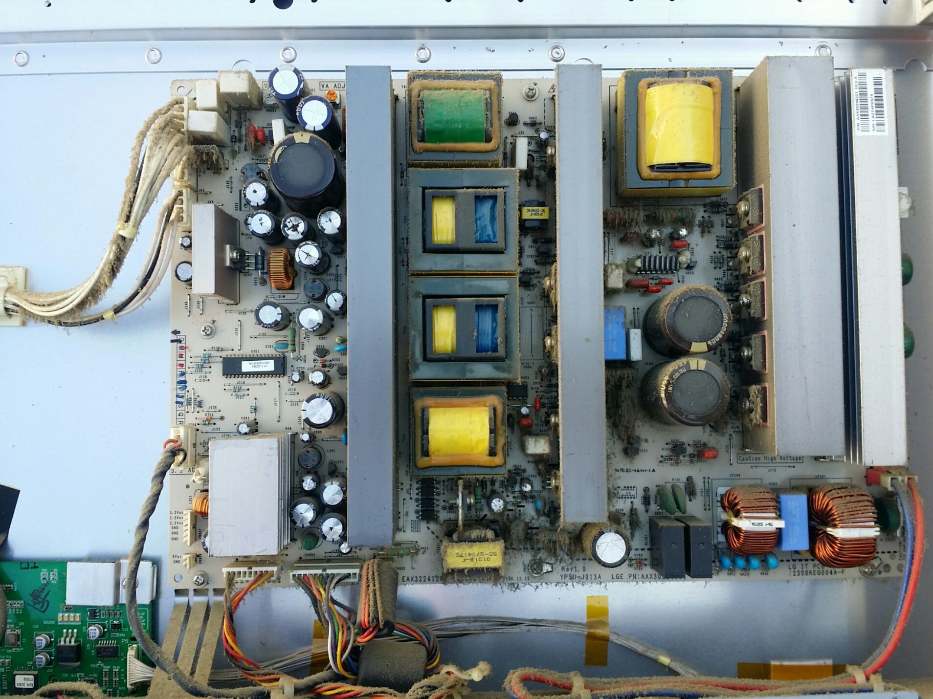

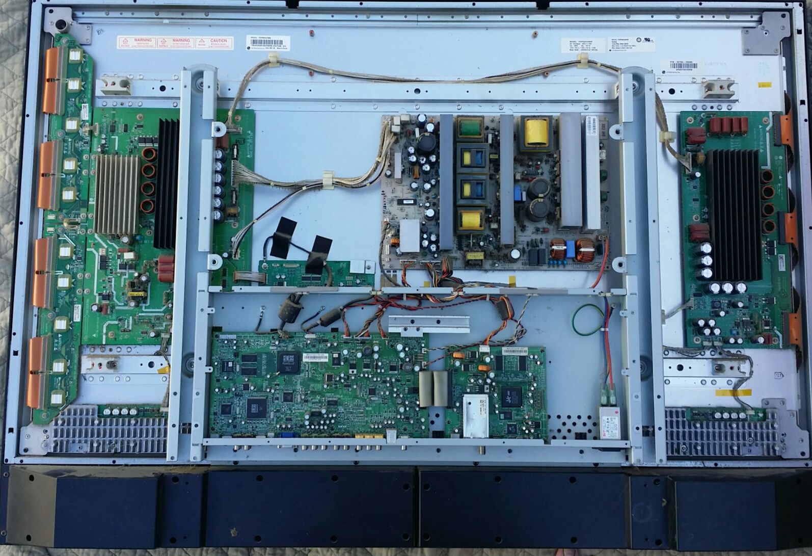

    Hi, I am new but have read extensively through the FAQ and watched videos. Last night I replaced 11 bulging caps. All seemed to be securely soldered and properly oriented. When I plugged it in, the amber LED lot immediately along with a single click. The LED then alienated green for a few seconds and returned to amber. Upon pressing the LED changed to solid green accompanied by another single click. The screen remains black, and there seems to be no sound (I connected an antenna, and cycled the input switch). Historically this TV was bought from Costco, the date of mfg is May of 2007. It did have some odd symptoms from time to time, (pink band, turning itself on, etc.) resolved by unplugging and holding the power button for 30 seconds then restating. The last time I that it worked, I lost picture and shortly after I lost sound. No attempts at resetting helped. Does anyone have ideas for what to try next? I have attached a picture of the layout of the TV and the board itself. Thank you for your time and willingness to share your knowledge.

    You will have to replace all of the caps except for 4. I think there are 25 or so.
    The 2 large 450v 330uf,1 450v 68uf and 1 250v 820uf probably wont need changed.
    When psu is working correctly, when first plugged into AC power psu will click once in about 5 seconds then 10-20 seconds later will click again. PSU will now be in stand-by mode. Front LED should be orange.
    There are 4 different standby voltages present on PSU on separate connectors, you will need to check them after the recap.
    Edit..... see post here about standby volts and where they are on psu.
    https://www.badcaps.net/forum/showpo...9&postcount=14

      Re: Vizio VP50 HDTV10A Replaced 11 Caps No Sound / Black Screen
      Thank you. So, just to be sure, I need to go back and replace the remainder of the caps (except the big ones) and then check 4 voltages with the tv in standby mode. I just reread my post. When it clicks the light goes from amber to green and stays green until I shut down
        Yes, check volts at connectors listed in other post. The connectors are labeled for volts @ each pin. All checked without turning TV on.
        Just to clarify. Before pressing power button......Does your psu click twice within 30seconds after plugging into AC?
          Just one click. LED flashes 6 or 7 times then turns solid green. No second click. I will have to order at least one more cap. A 10v 330uf. Not in my kit. Thanks again.
            You can use a capacitor with a higher voltage if you have one. Say a 25v instead of a 10v.
            UF has to stay the same or might cause issues with the circuit it's in.

                    Hey I fixed my TV! A first for me, but it is the second TV that I worked on. What?
                    Okay. Here is where we stand now. My Vizio VP322HDTV10A died while I had the VP50 apart. I couldn't be without a working TV in the house for much longer or there might be a mutiny.
                    I sent for the parts, and after communication back and forth we determined what I needed for the 50" as well. The kit for the smaller TV VP322 arrived Saturday, so I immediately went to work. I had the job done in about 30 minutes. It works great, maybe better than it has since we have owned it (inherited from mother in law a couple years ago).
                    So then I read more, and followed the link you gave for testing instructions, reread and printed it. I then looked at the whole thread. The other guy had found a bad solder joint (and in fact a bad part as well), so I took my extra strong magnifiers and put it under a desk lamp for close inspection. I found a problem. I had installed a capacitor (C262) offset so that one lead was in a hole for the capacitor and the other in an unused hole. I desoldered it and placed it properly then resoldered it. It was in the right place, but it was loose. I resoldered it a couple times with the same result. I then cleaned the tip of the soldering iron on a wet sponge and scrubbed the area of the board for built up flux, etc. I soldered it in and now it was solid.
                    I plugged it in and immediately got one click and a few seconds later a second click. The amber light came on right away, after the second click it began alternating green and amber several times eventually going to solid amber. I then hit the power button and the light turned green but no click or any other action. The green stayed on until I pushed the power button again but there was no click just the LED alternating amber and green several times finally settling to amber.
                    I haven't checked the voltages yet because I need to get thinner probe tips to fit in to measure them.
                    I should have some more Caps coming within a couple of days. What do you think?
