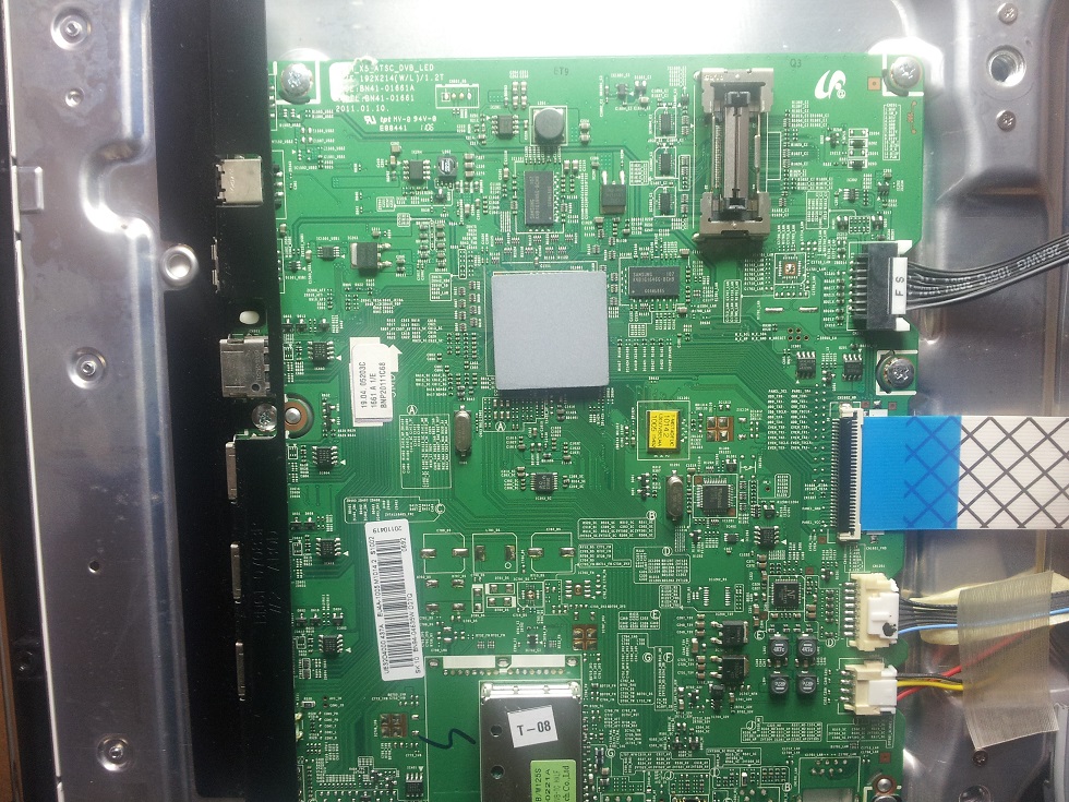

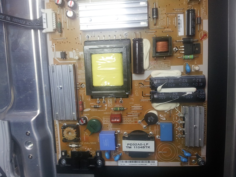

    have a Samsung UE32D4000, the Power LED flashes 2 times and dont power on.
    Anybone have this tips ? I need code to led flashes
    I have some service manuals but dont have electric shematic is this manual dont have code to flash !!!
    BN41-01661A - motherboard
    BN44-00421A - source power
    Someone can help me?

        Re: Samsung UE32D4000 not power on
        UE32D4000NWXXC
        PD32A0_BSM Power supply
        BN41-01661 Board
            Originally posted by Kilroys
            Start with the easiest
            Reset TV
            Press and hold "Exit" for 10 seconds
            BN41-01661 Board
            I Put pictures
              I Reset and same problema , chnaged al capacitors from power supply ... and blink 2 times !!!!
              • CapLeaker
                Leaking Member
                • Dec 2014
                • 8352
                Seems like there is no schematic for that board available. Measure the DC voltages on the power supply. There is a ribbon cable from the PS going to the main board CNM803. Check all the voltages there and report back.
                You can take the power supply out and check the diodes and transistors for shorts.
                Or you can buy a new one for $60. Depends on how far you want to go.
