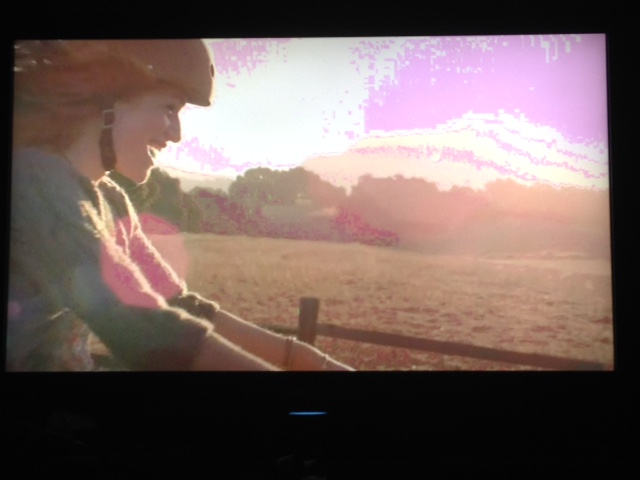

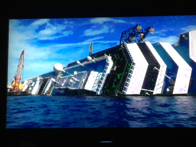

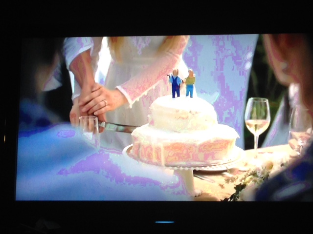

    Greetings, a little back story replaced the caps after a failure a little over a year ago now there seems to be something new going wrong. When first powering up the set I get at first a ghosting effect in the back ground with a slight pixalition of red on some areas, this goes to a green pixalition on black areas, this varies in degrees of picture noise for the first thirty minutes or so before clearing up. I suspect the t-con board but wonder if something could be going on with my original repair. On powering up I do hear a click and the red led light flashs three time prior to coming on. I am new to this forum and to troubleshooting lcd televisions, so please bear with me, any help would be greatly appreciatedClick image for larger version

    That looks like an AS15 IC has gone bad on your tcon board. If your not fluent in pcb board repair order a new tcon board for the tv. This is the small board at the top center of the tv. Connects to the panel. If you have a volt meter we c an help you take.some readings to confirm

                Tracked down a replacement T-con board, installed friday and wow, better picture then before the failure. FYI, double check the cables, prior to buttoning up or better yet power up unit if possible before putting the back cover on. I had a cable ever so slightly work out of its slot. Repair took less then an hour thanks for the help
