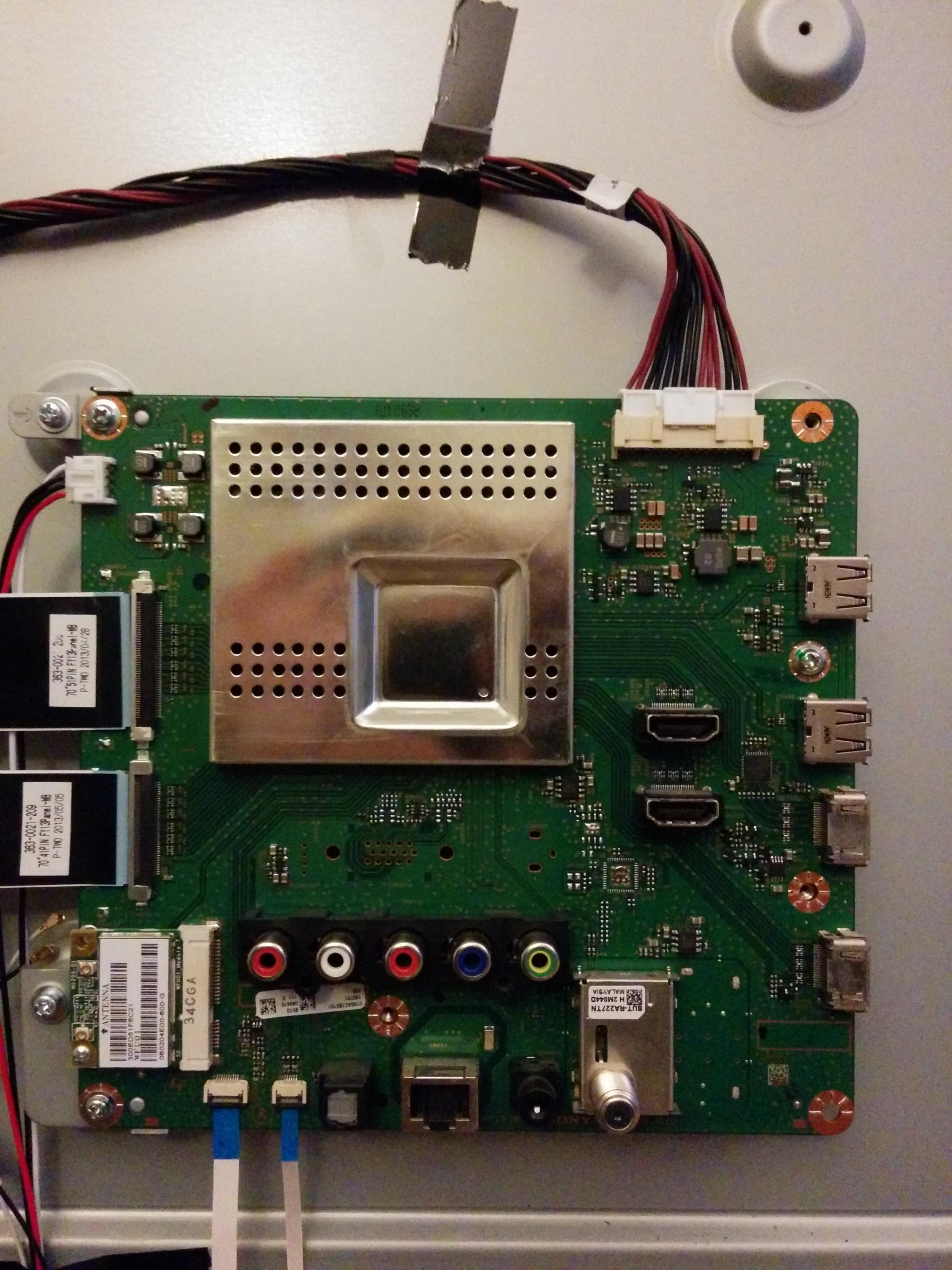

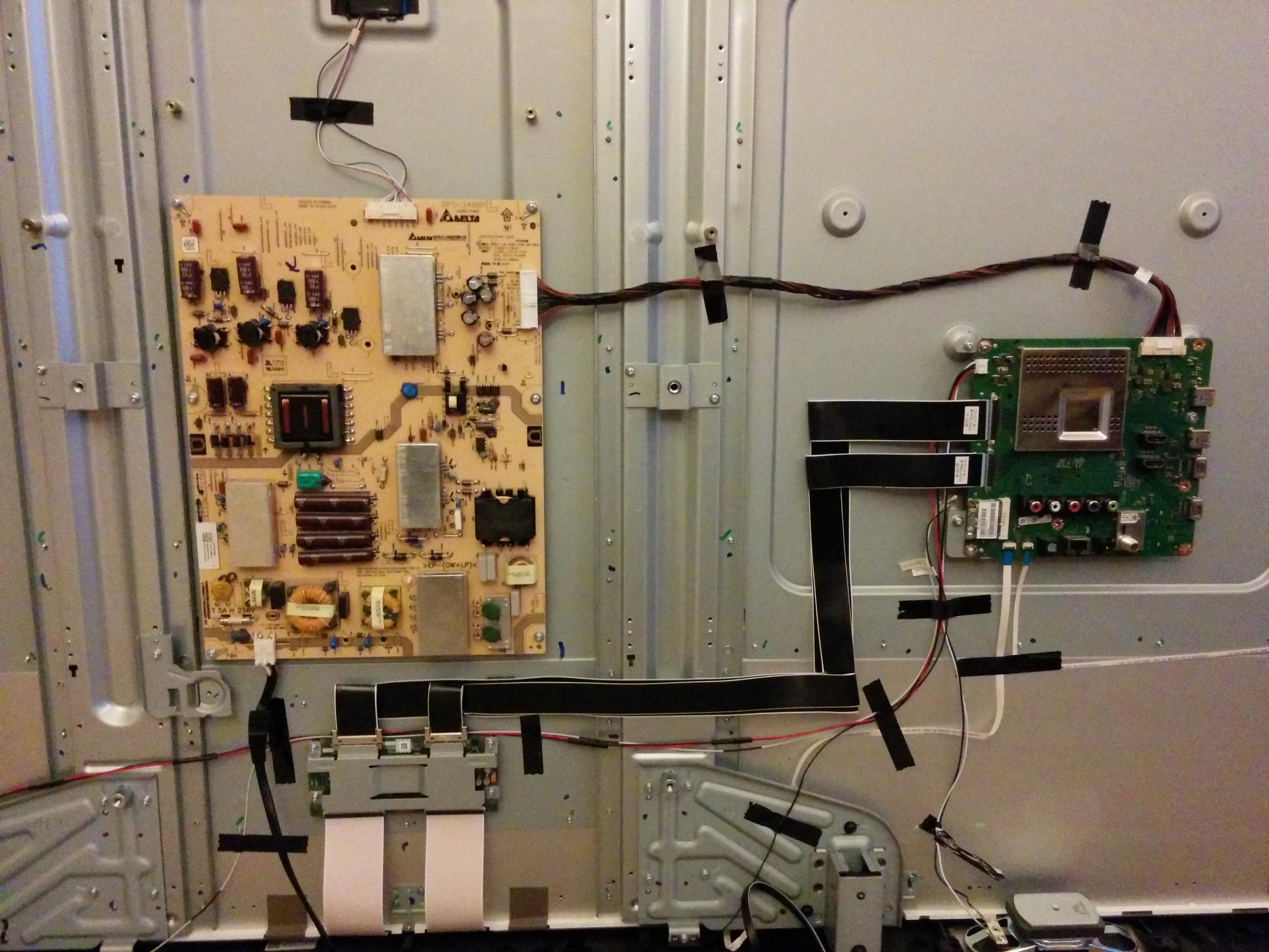

    Hello all!
    I am trying to fix my Sony 70R550A LED TV.

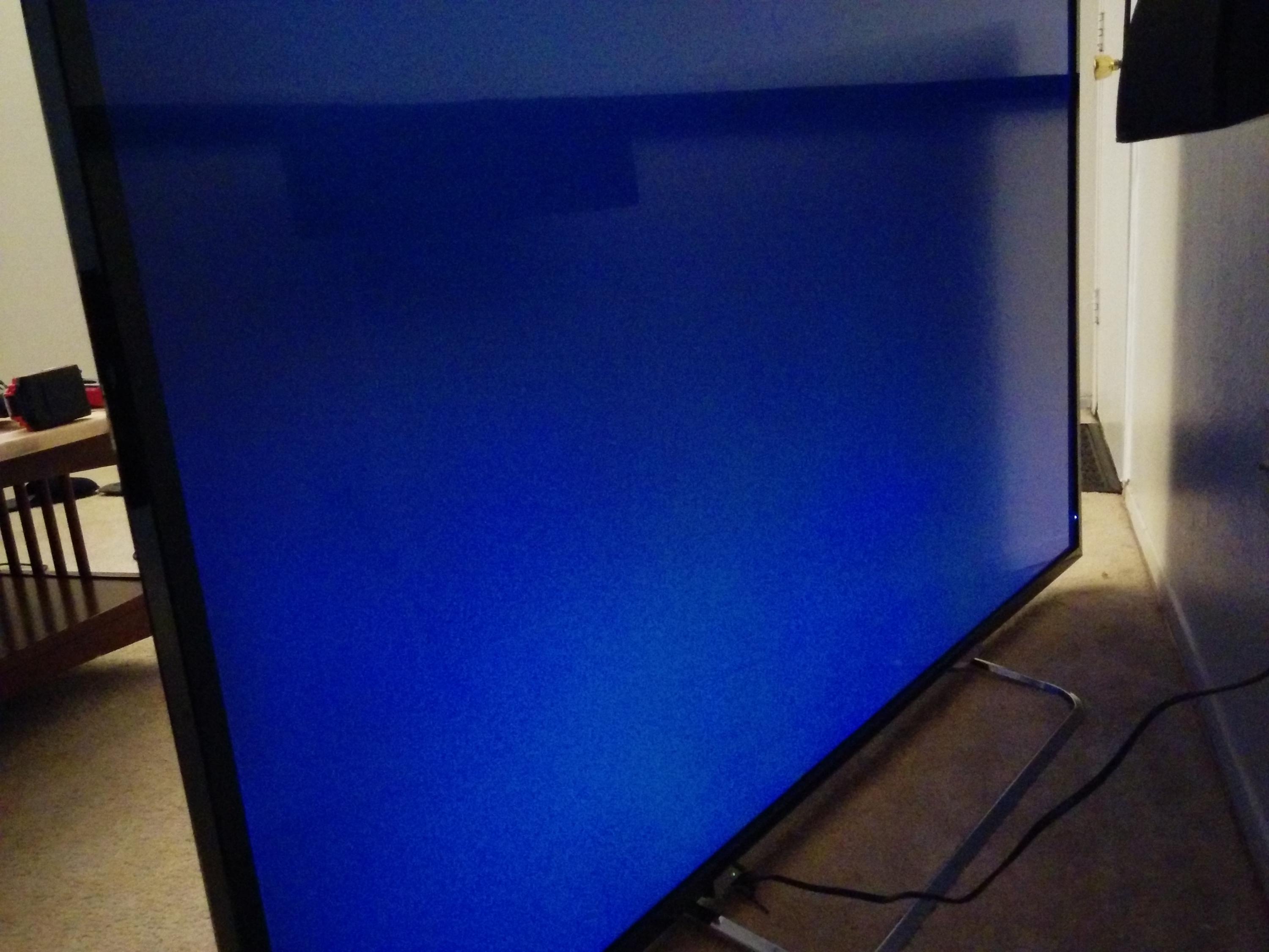

    1: TV had no picture, and no sound, but backlight came on and status light stayed green.
    2: If I removed the Tcon from the TV, the symptoms didnt change.

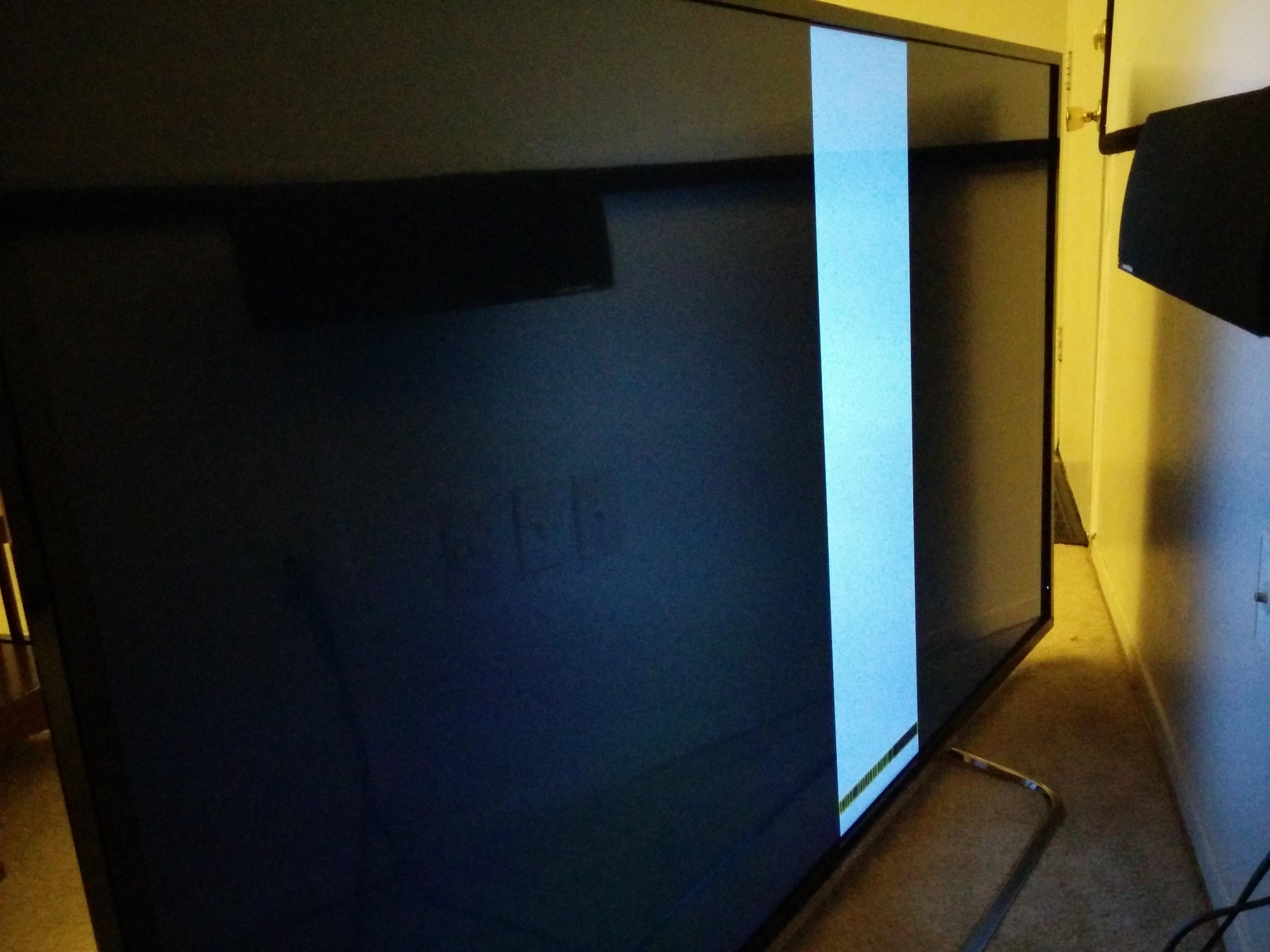

    3: If I unplugged only the left ribbon from the Tcon to the LCD, the display
    would show vertical lines where the logos would be (see pictures).

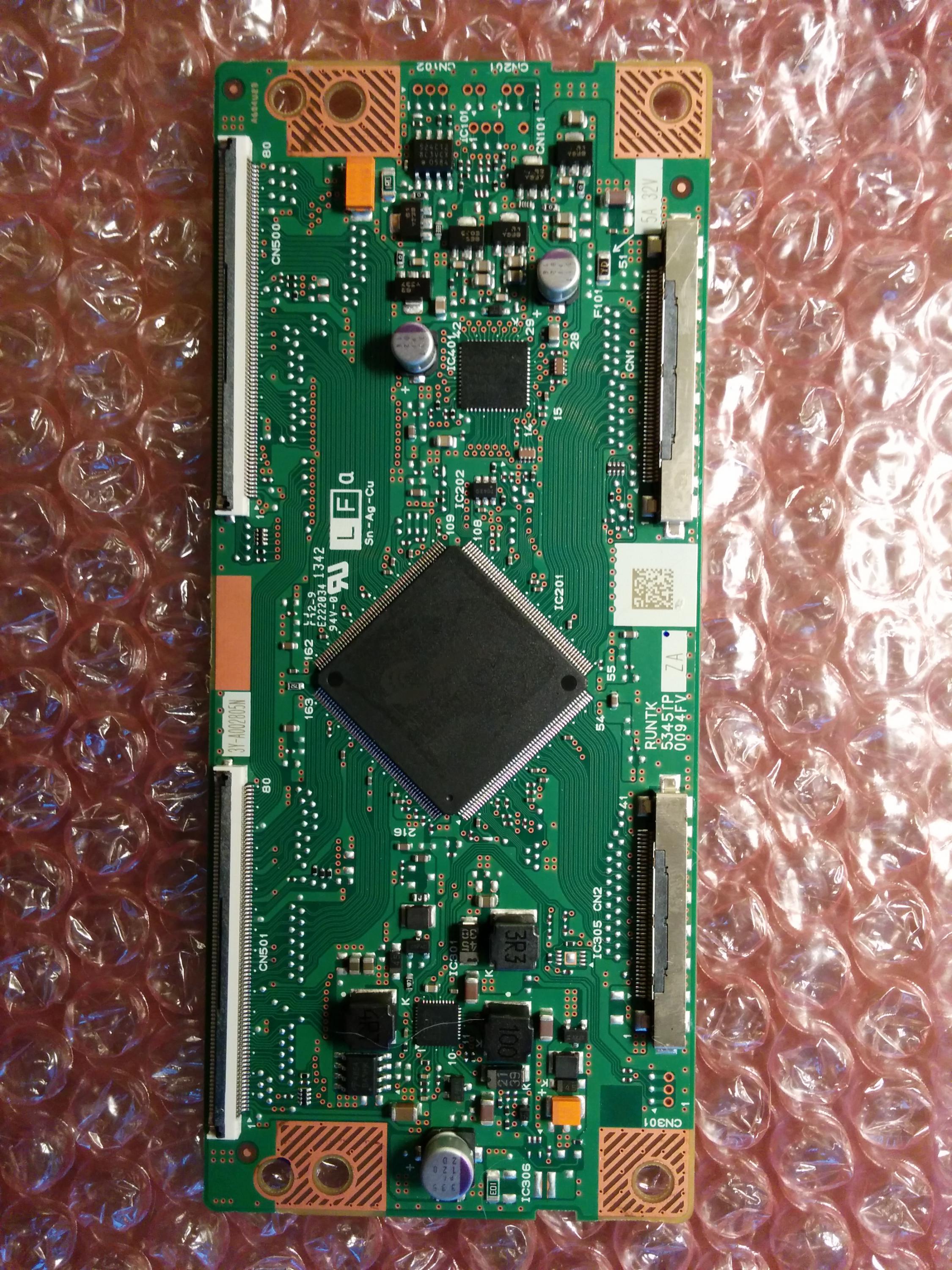

    4: I ordered a new T-con from Sony Parts. My Tcon is a RUNTK-5348TP-ZA and they sent me a RUNTK-5345TP-ZA, which according to google is for a Vizio M601D. The shipping label says "Part ordered - RUNTK-5348TP-ZA, Part sent - RUNTK-5348TP-ZA". ShopJimmy lists it as a substitute part for the 5348, but i'm not sure how much I can trust that.
    5: When I installed it, the TV now shuts off and blinks 5 times.
    6: If I unplug both Tcon-LCD ribbons now, the TV stays on with a green status light but no picture.
    Is the part I recieved wrong? Or do you think the panel itself is dead?

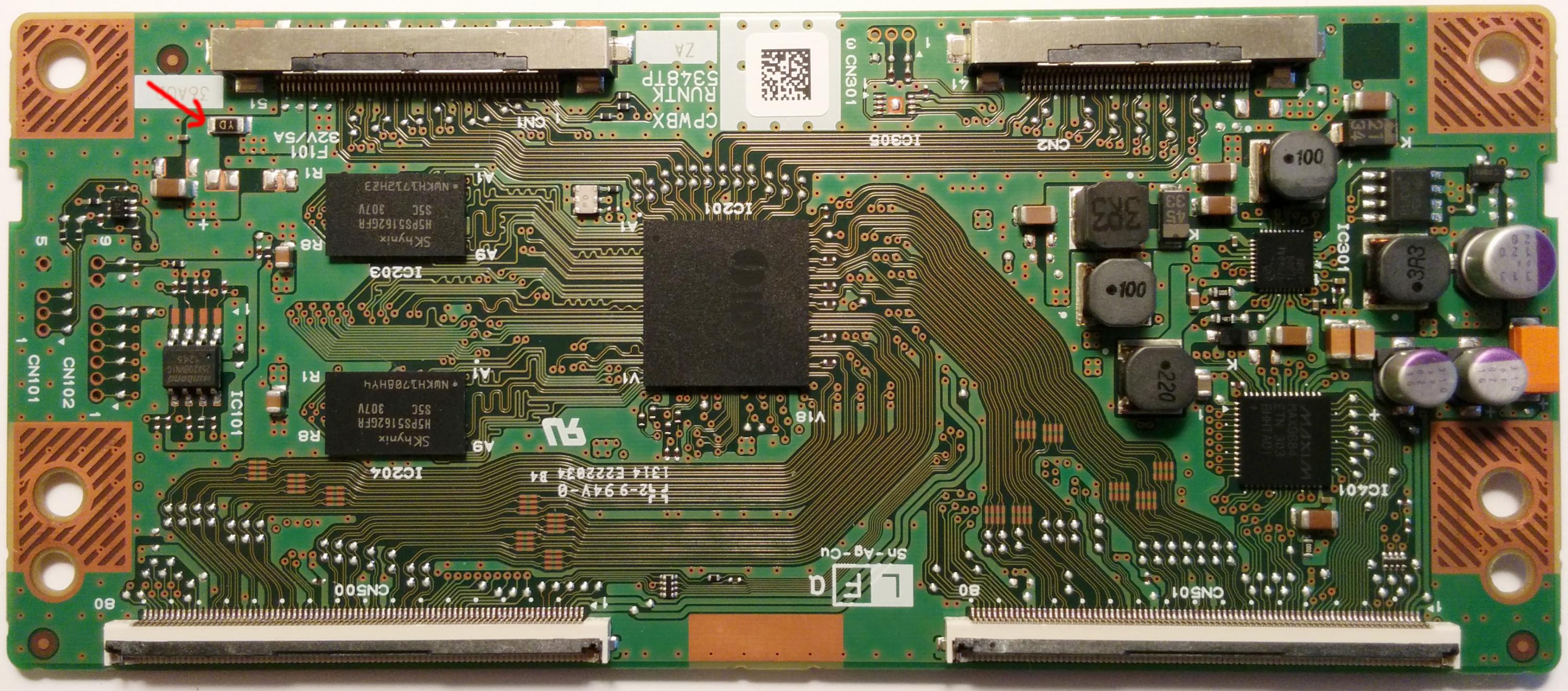

              Re: Sony KDL-70R550A 5 Blinks
              If you remove the cables between the LCD panel and the T-CON board then the TV stays on then it sounds to me that it has bad driver ICs or component on the LCD panel, this is the same on the other thread, right?
              The bad thing about this T-CON is that the test points are not label for us to check VGH, VGL Voltages.
              https://www.badcaps.net/forum/attach...4&d=1421452245
              IC301 is more likely to be the one that generates the Voltages.
              You may be able to look up the spec sheet to do some Voltage checking.
