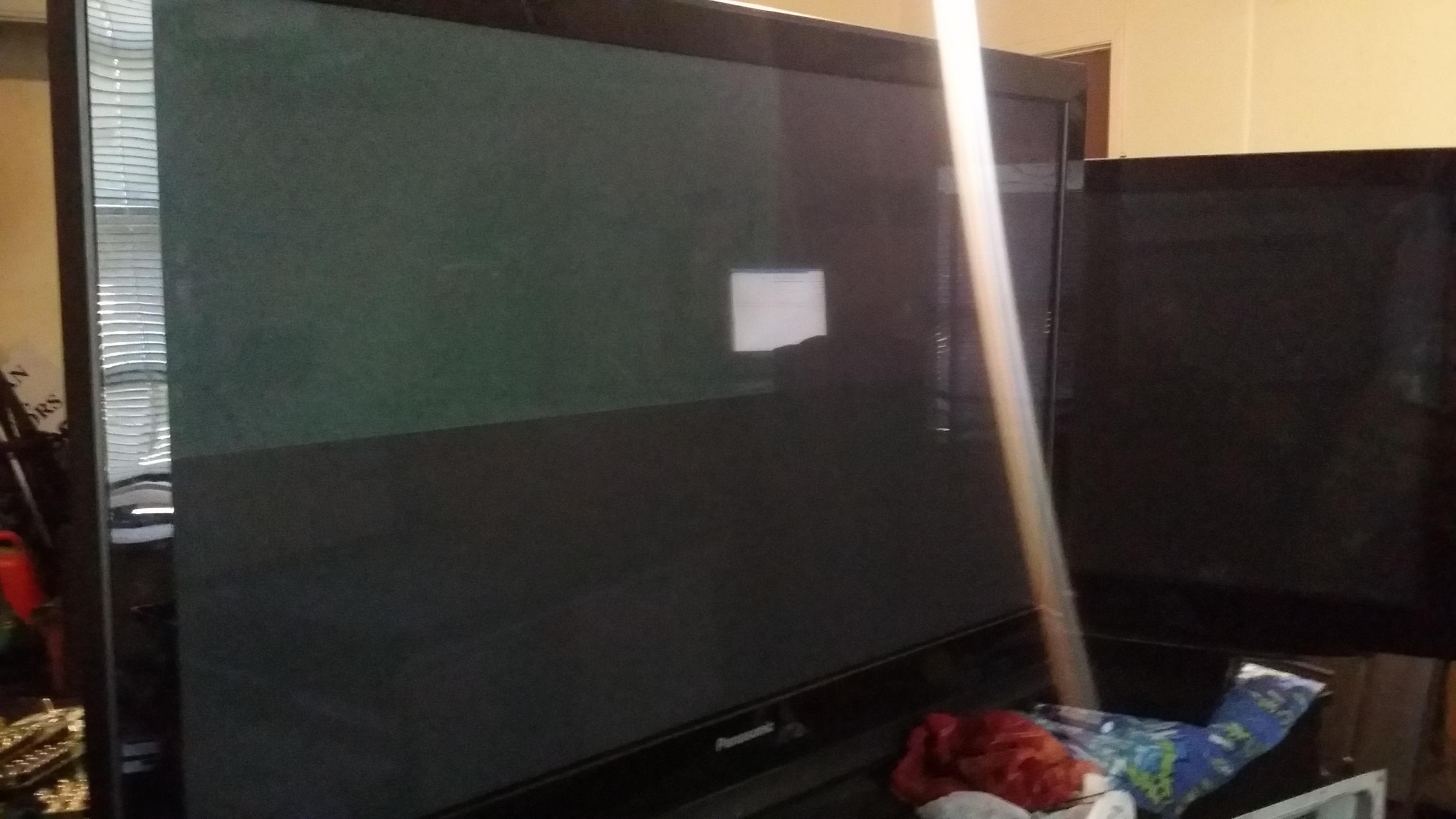

              Okay following the next steps I removed the SU board and tried powering it on, nothing still 7 blinks, however when I removed the SD and powered on the tv the top half came on, oddly split it half and 2 different colors. But its on! I am relieved because I was beginning to think the panel had gone south on me.
              Attached is the pictures of what I got, I assume the SD board is bad and will order a new one, however is the screen up top being two different colors like that normal? Is there maybe another issue causing the screen to look this way?
              Thanks for your help guys I was really going for broke on this tv, ordering so many parts with no change ect.

                  turns on, shuts off, but what code? unfortunately it may be bad panel or both buffers were bad and potentially inadvertantly killed the SC?

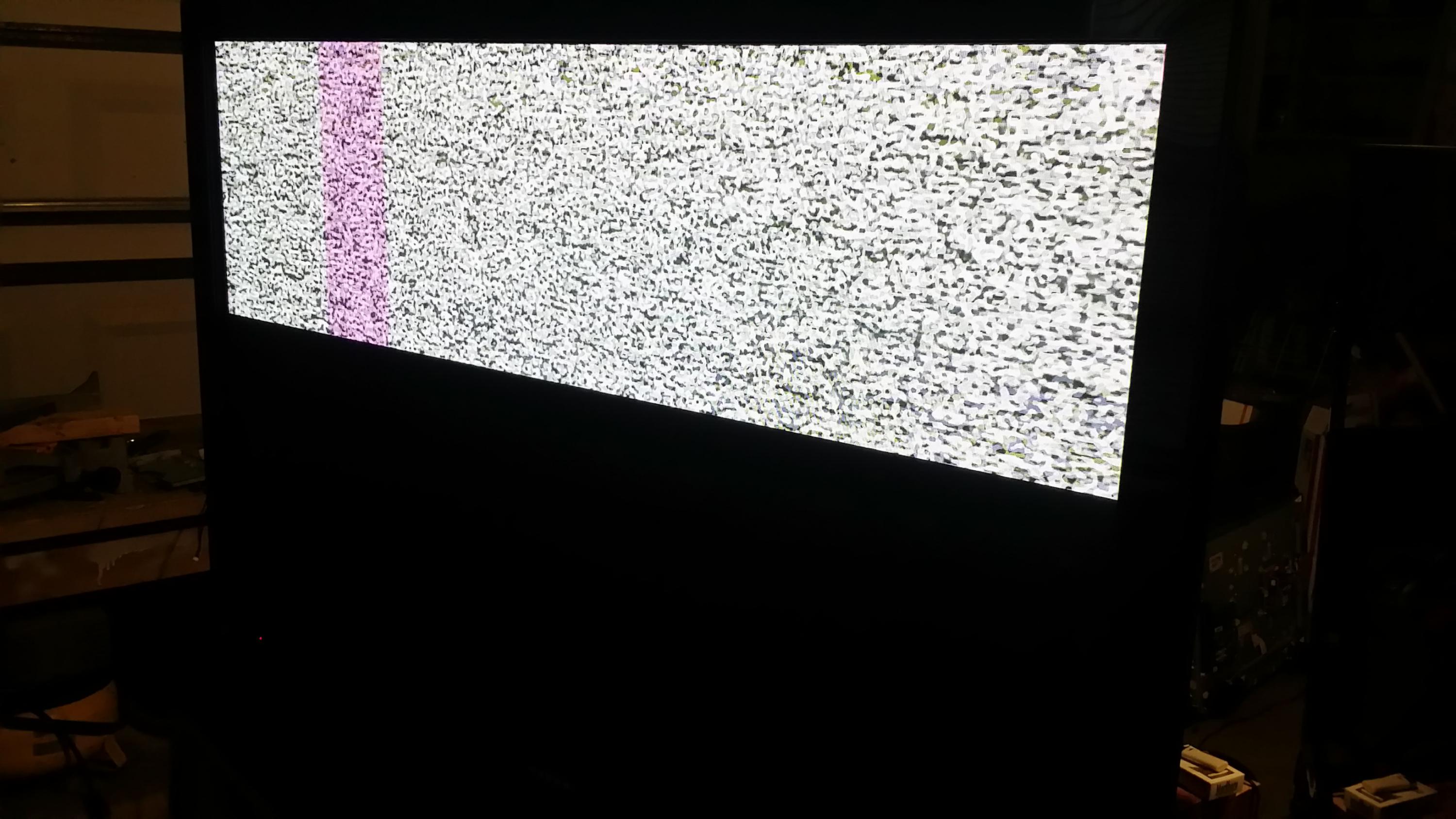

                          Okay, I reseated some ribbon cables and the purple lines are gone. I just ordered the SD board from ebay for $20. It should be here by next friday. I will keep you guys posted with the progress.
                          How weird the tv gave me so many different error codes, and the problems started acting differently. Either way the new part, and the 4th board I have ordered so far on this tv is on its way.

                            I got the replacement SD board in today,
                            First I verified that the top half of the the tv would still work, and it did just as I had left it. Then proceeded to replace the SD board, plugged everything in and turned on the set. The entire screen powered up for a fraction of a second followed by a bright flash more concentrated on the bottom of the tv and then the good ol' error codes started flashing at me.
                            Im at a loss here guys what could this mean, what else could I dump more money into to fix this problem?

                              Any ideas, I unplug the SD board and it goes back to the top half of the screen working. Plugging the new SD board back in it goes back to the 7/6 code error. Is it possible that part of the lower screen is broken where I cant see it causing it to short out the SD board as soon as I power it up, because I feel like the SD board is shorted out now but Im not for sure.

                                To me it seems you have a fracture to the panel resulting in a short
