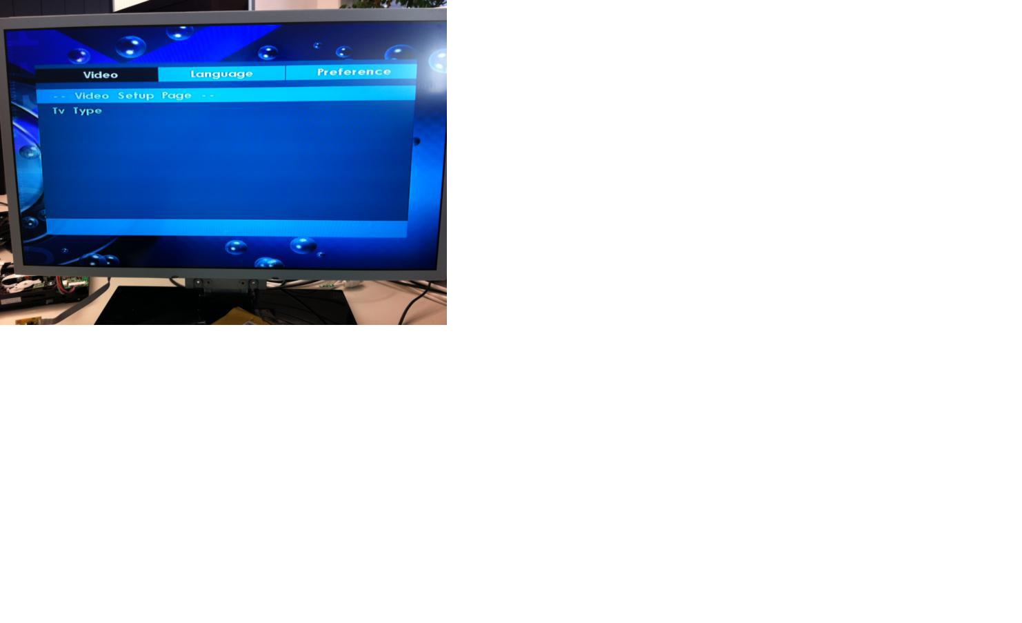

    Hey guys,
    I have an alba tv with built in dvd, everything is fine other than the dvd player is playing dvds in black and white, even the dvd screen when there's no disk inserted is black and white, I thought it might be regional settings but I don't appear to be able to change those.
    Any ideas?

        Re: Alba LCD32947DVDHD black and white picture on dvds
        Try this
        First go to DVD Setup Menu then press the remote control code 1357.
        The DVD service menu will appear
        Change VIDEO to CVBS
              Click the "DISPLAY" button on the remote
              you should now see the DVD Menu.
              Make sure to the screen shows the tab “Video”.
              Press the consecutive numbers “1”, “3”, “5”, “7”

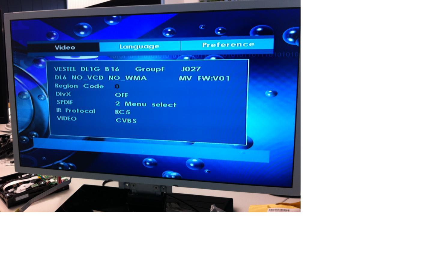

                  There should be no disc when you hit the button.
                  No luck ?
                  then the DVD eeprom is corrupted, changed the image to black and white,
                  but also change the IR protocol,
                  therefore you can not use your remote to control DVD

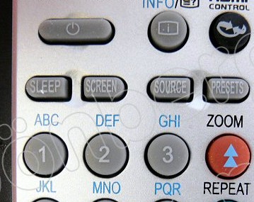

                        Is it the sort of remote where you have to press a "dvd" button (as against a "TV" button )first to access the rest of the dvd buttons.
                        Is there a light on the tv that flashes when you press a button on the remote?
                        Is it an original remote?
                          No button to put it into DVD mode, theres like a sectioned of square at the bottom for DVD controls, it appears to be the original remote, I'll do a quick google search to confirm it.
                          Yeah it is original.
                          http://www.amazon.co.uk/Genuine-Orig.../dp/B00B7GWIY2
                          If you're interested in seeing the remote.
                            You must have a button to change between
                            scart, hdmi, dvd, vga
                            How about the SOURCE button ?
                                  As I said, there are two IR protocols.
                                  One for television receiver as you look through the 4725 Code,
                                  the other is for the DVD.
                                  If it is not the same as for television,
                                  the buttons for DVD will not work.
                                  A link with the same problem, the same remote control,
                                  the same card and a solution.
                                  http://www.tv.quuq.org/forum/index.php?topic=9587.0
