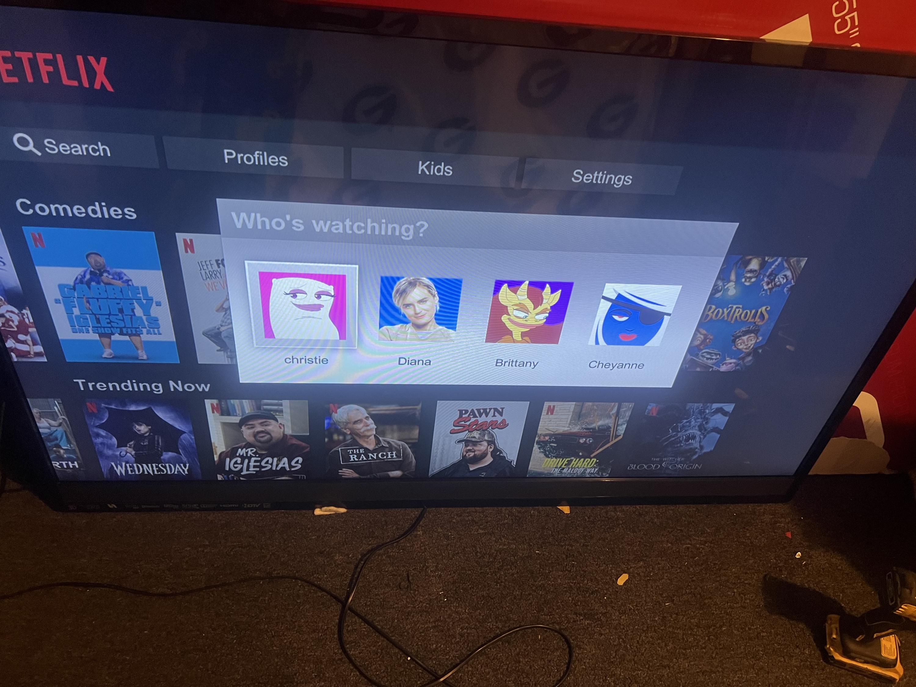

    HI everyone Pick up this 55" VIZIO tv that only plays in black and white picture doesn't matter what inputs HDMI or apps, but all the menus are in color, if you're on Netflix everything in color until you play any show. I'm thinking main board if so, can the board be reflowed to try and correct this?

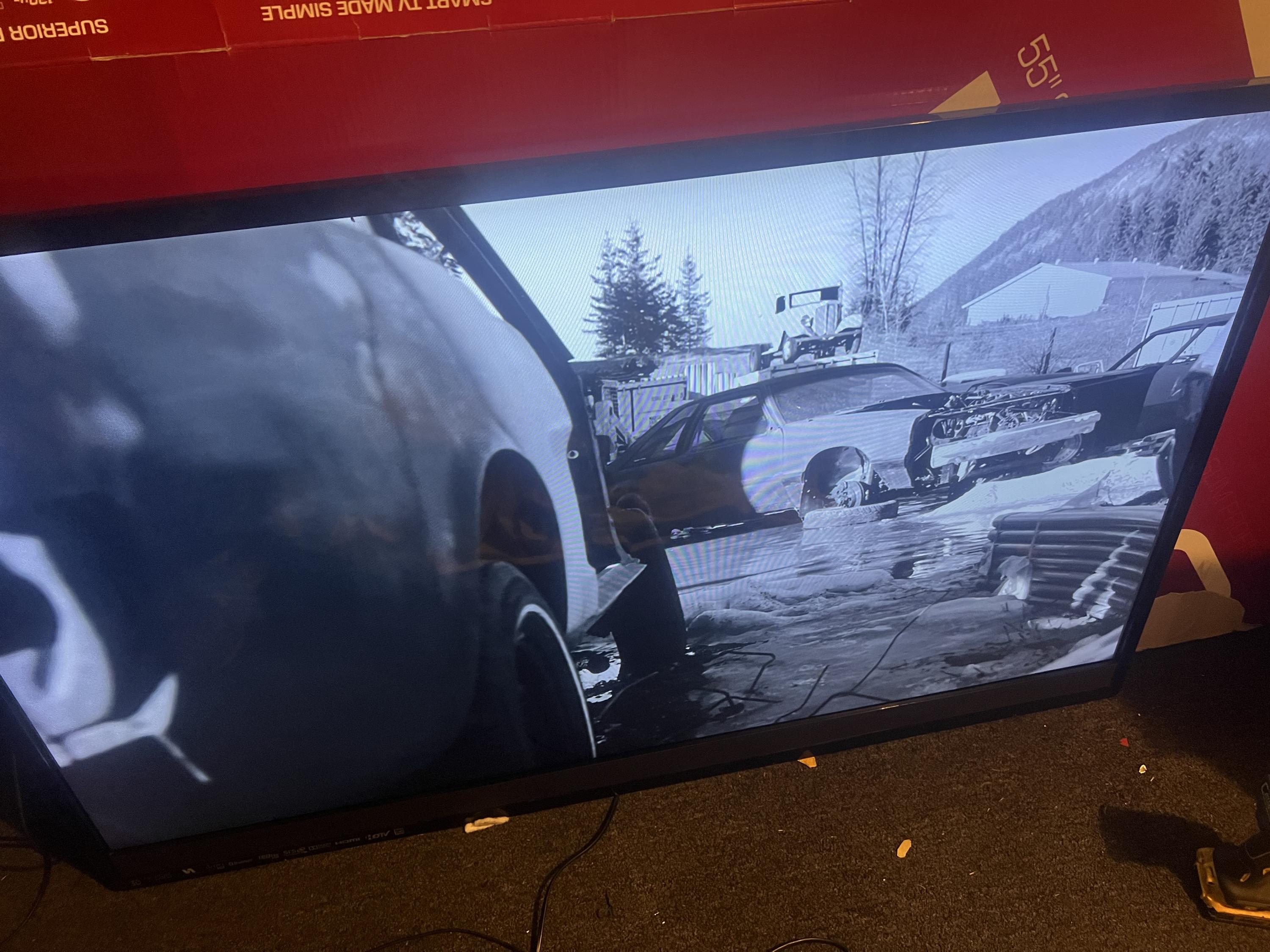

    Re: vizio M3D550KDE Black & white picture
    Here some pictures of how it's doing.
                              Yes Netflix thru the app and any app on the TV is in color you can scroll through the menu apps in color but as soon as you play a program it turns to black and white
