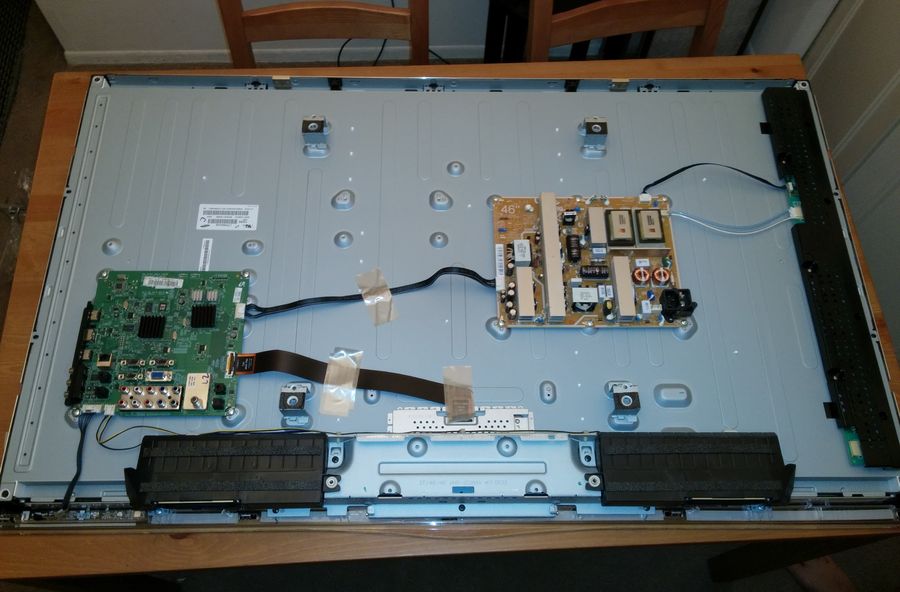

    I am beginning to think I have a SamSung curse.. Every time I touch one, it won't fix...
    Samsung LN46C600....
    At first I thought it was a plasma because it's A)Heavy and 2) Has metal back...
    But, nope.. It's an LED/LCD...
    I get sound, but no display... Read thru available LN46C600 threads...
    https://www.badcaps.net/forum/search...archid=4308173
    Strong flashlight shows display is present, so it's a backlight issue...
    One post from BudM stood out...
    BN44-00341B from TOM66. This board has pull-up resistors, so if you unplug the cable between power supply and the main board, the backlights should come on when you plug TV into the AC outlet.
    On this set, I unplug the main board from the power board and plug in.. Don't get any kind of light, flicker or anything....
    Before I tear into the unit down to the bare backlights, I was hoping there was something else I can check first...
    In reading thru the afore mentioned threads, I read about the guy who invoked the wrath of Zues when checking the large caps...
    Want to avoid that if at all possible..

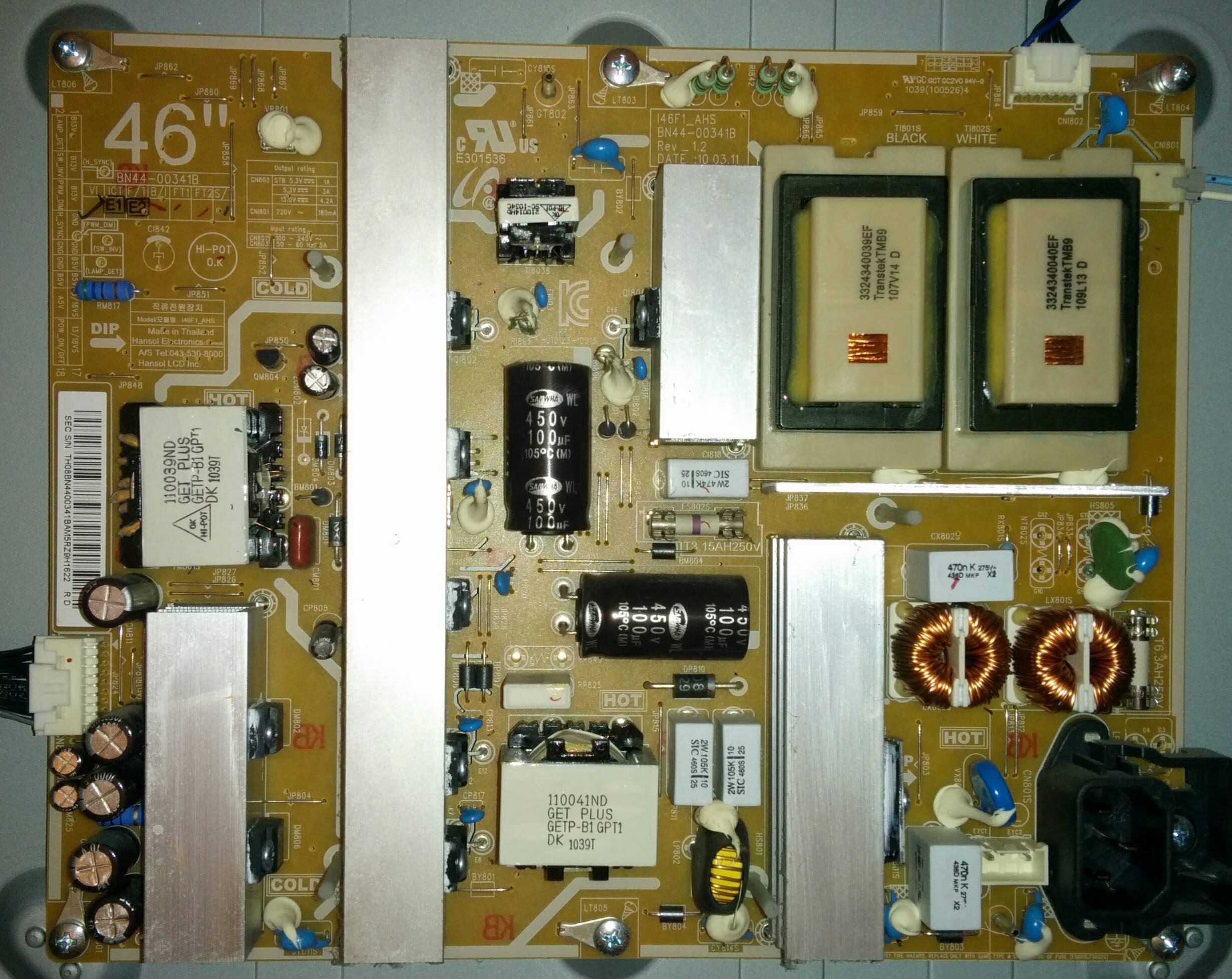

      OK, without cable between the main board and the power supply board, check to see if you do have standby A5V, if you do then check and see if you do have >360VDC (you need to have this Voltage) on the main filter cap (check the DCV right at the two legs of the cap), if you do, then check the fuse FS802S.

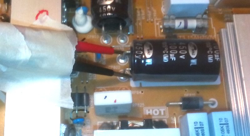

        FS802S checks out...
        I do get 5v on the standby A5V when the cable between the main board and the power board is disconnected..
        I am working up the courage to check the big 450V capacitor..
          Re: Another Samsung Another Audio-But-No-Display Issue
          just do not touch anything with your hands or body, and do not let the probes slip out on you.
          • Michale32086
            • Nov 2011
            • 1453
            That's my plan..
            OK... With my son's help... After he finished laughing his arse at my skittish-ness....
            393V +/-
              get some alligator clips for those probes, problem solved!
                  Originally posted by Michale32086
                  That's my plan..
                  393V +/-
                  OK, PFC is working, now I need to look at the inverter circuit section next.

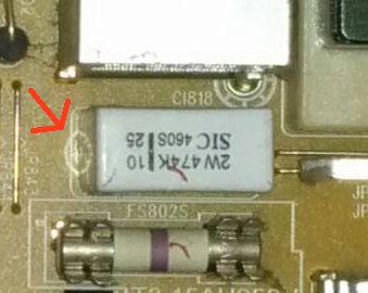

                      OK, check CI818 capacitance, it is 0.47uF 450V Poly cap.
                      • Michale32086
                        • Nov 2011
                        • 1453
                        I assume that the arrow points to the Negative??
                        The access to the pads is somewhat limited... Is there any special trick to checking it??
                          It is non-polarized cap. You will have to remove it to check the capacitance.
                          BTW, you never did see the backlights even flash on for second?
                            OK, just to clarify.. I need to remove that cap and then check the capacitance on the empty pads??

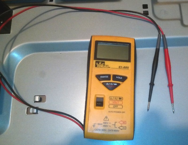

                                OK That's where I think I am going to be tripped up.. I don't have a meter that checks capacitance....

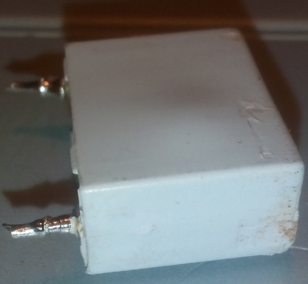

                                  On the other hand, I pulled the cap off and there is a slight pimple/bulge on either side of the cap...
                                    It looks bad. Check the capacitance.
                                      May be its time to get Cap meter that can do capacitance and ESR testing if you are going to do more repair works.
